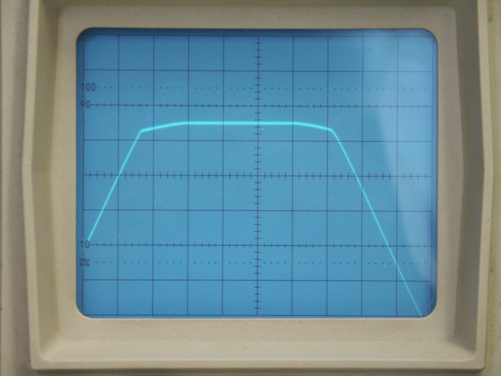

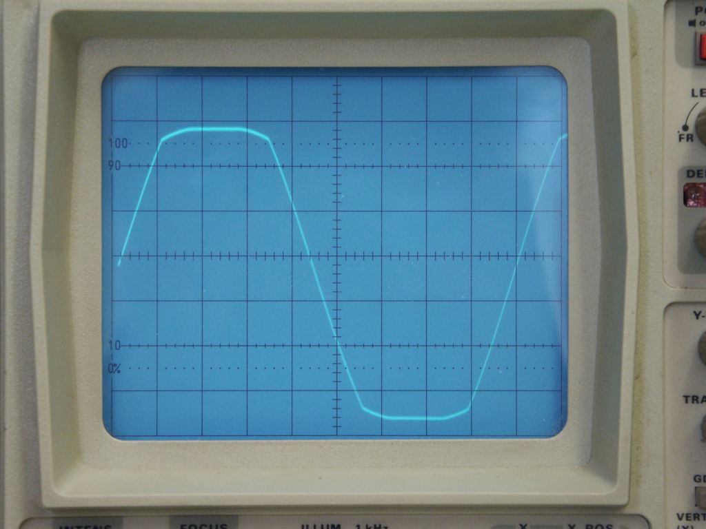

By well applied antisaturation diodes at VAS aren't any problems with clipping and recovery...1 kHz:

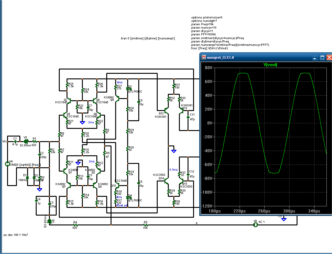

I just ran a simulation on a balanced VAS amp and put it into clipping. Result:- No collapse of the VAS standing current (I run at 30mA).
Another good reason for balanced drive topologies in my book.
Another plus to the fully comp. is the almost "soft clipping" characteristic it exhibits (at least on my soon to be actually completed CLX - below 1)
I can't wait to actually clip this voltage stage on my 40V rail OPS to see whether LT "lies" ... 🙂

But the end user is not always prudent , so higher than needed rails in addition to "crippled" gain ( less than would be needed to create clipping at 2V inputs). I have a input switch on the rear of the amp to halve the input signal , keeps the kids from blowing woofers with their dang movies... 😀 With the amp below , I would not be as concerned except for the obscene amount of power you would actually be AT with 140V p-p !!
OS
