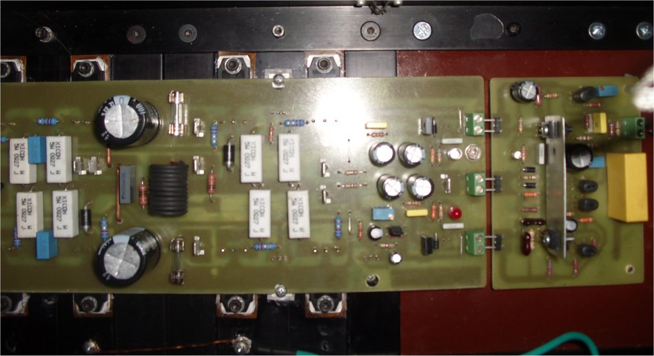

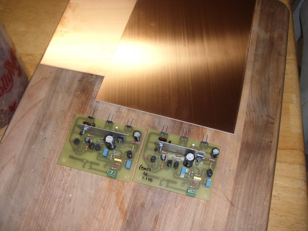

Short of somebody building 2 complete amps just to do this comparison, I have just the setup (below 1) . I also have some expendable FR-4 , new scope probes and a -107db source (my soundcard). On 2/5, I can whip up another batch of AX's (Bob's textbook example amp) with universal TPC/TMC capability. I don't have enough KSA/KSC's (1845/992 1381/3503's) now.
I can make the boards now (pix 2) .. I got the FR-4 free. 🙂 , and I already have the TMC prototypes. I have a feeling , at ppm distortion , that the outcome would be almost too close to call (listening wise).

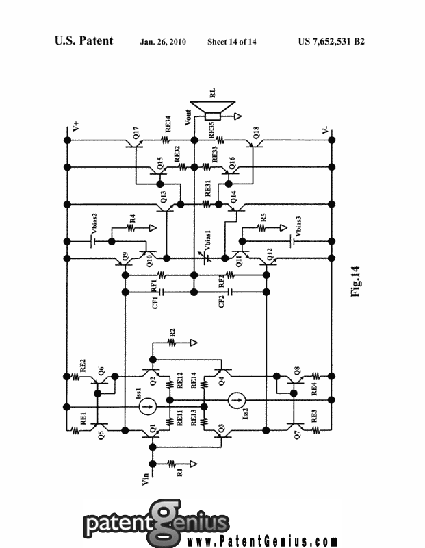

To all,
Please have a look at: US Patent 7652531
Those pirates have stolen my baby!

As far as I can tell, the US patent office will grant anything. I understand that the invention is not required to to be useful or to actually work, but apparently they don't even bother to check that the idea is new and not easily derived from prior art.Please have a look at: US Patent 7652531
Those pirates have stolen my baby!![]()
On a lighter note, have a look at some of the "preferred embodiments" in this patent.😀
Figure 11 is just TMC applied to that Slone topology with the undefined bias.
In figure 14 they're not even giving the poor thing a fair chance. Burn baby, burn!
An unexpected reinvention of the (low cost) two-pole filter served with a lot of rubbish talk.
