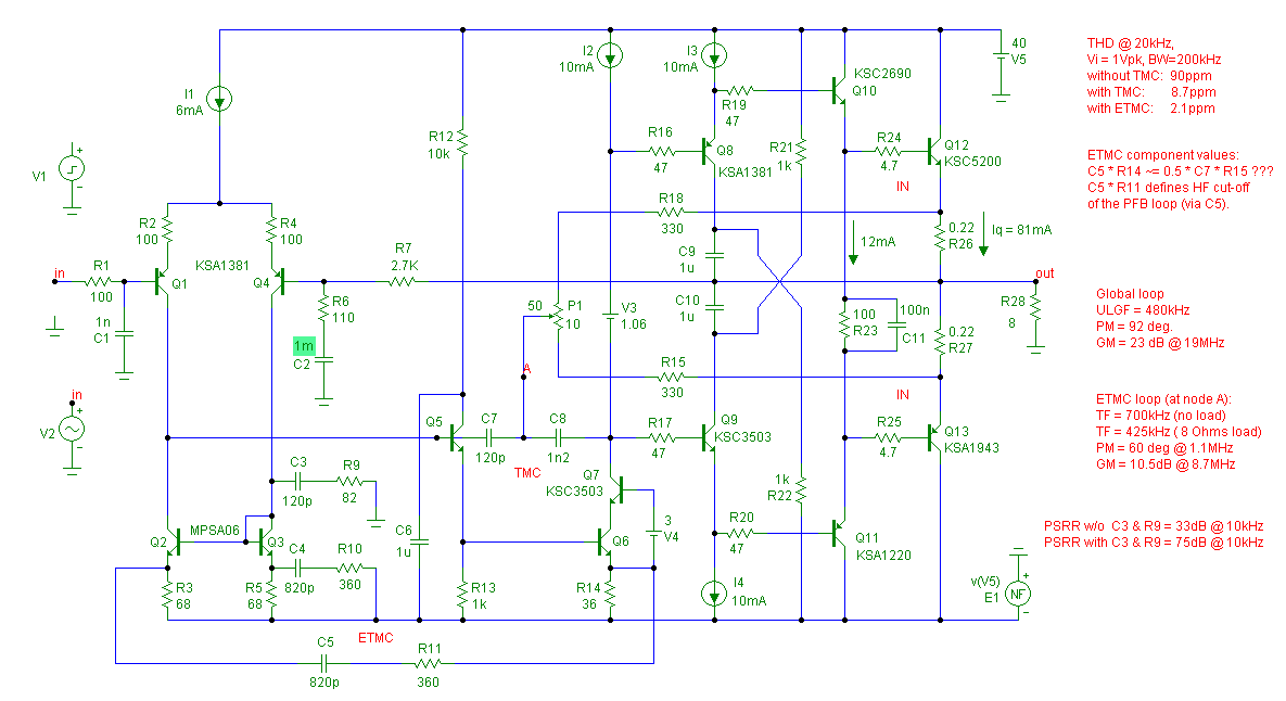

"As a present for this new audio forum I'll give away my latest secret.
As you all already know, TMC stands for Transitional Miller Compensation. The preceding E is new and stands for Error correction (or Extended). Just like TMC (and HEC!), it only reduces the distortion produced by the output stage. This means that to be effective, all other stage must be perfect (well, almost). Additionally, the input impedance of the OPS should also as high as possible, otherwise this trick simply doesn't work. So you will be warned.
Here's a simple implementation on a basic amplifier:
see pic below.
The TMC respectively [additional] ETMC components are encircled*. As you see, this error correction scheme uses only one extra active component (Q5) and a few passive ones. If applied to an amp with a common mode control loop (CMCL), then the active components are already there and only two additional C's and R's are needed.
The result (see schematic text) speaks for itself. If I have more time (next week) I'll elaborate on this topic and answer questions.
Edmond."
* So the complete ETMC circuit comprises both encircled components.
NB: This information may not be published in part or whole (either on-line or in print) without written permission of the author.
IOW, no more hijacking of my ideas, please!

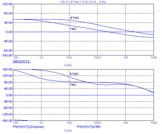

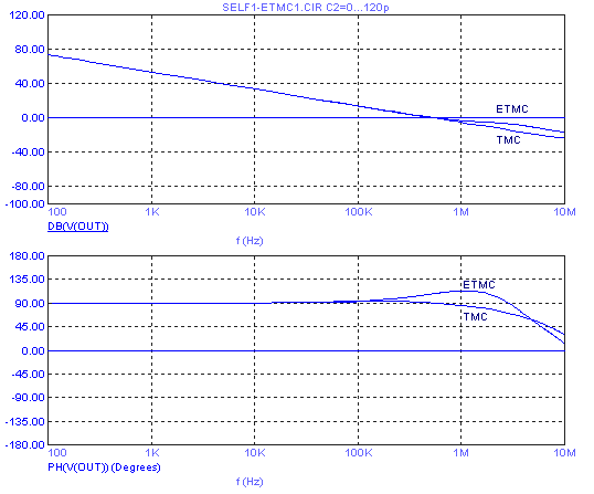

In general, the ETMC seems to be a good trick, but also it seems to be raising the speed of the open loop in general, thus being a little bit dangerous for the closed loop stability IMHO (I didn't make the simulation nor mathematical analysis - this is a "first glance impression" only indeed 🙁 basing on my experience with the "lead compensation" according Otala many years ago).
I don't see a direct connection to Otala's lead compensation, though I agree with you that the stability is affected (a little bit). As I already said (see post 3011), any arrangement of error feedback will impair the stability.
In case of ETMC, the BW of the local FB loop (via R12) is indeed increased, see 1st pic below. So the circuitry around this loop does need careful attention (base stopper etc.). The global FB loop however is almost unchanged, i.e. same ULGF and slightly higher phase margin. See 2nd pic.
Disclaimer. The schematic as shown on page 3002, depicts only the basic principle. It's far from complete. If built without the utmost care to potential pitfalls, it will certainly oscillate.

Here's an alternative approach of ETMC, courtesy of Dimitri who co-invented this mod.
All 'unnecessary' connections to gnd have been eliminated, except R9, as this one has to be tied to gnd.
As for the positive FB loop, now the signal is taken directly from the VAS emitter and fed to the emitter of Q2. This mod saves one tranny, though at the cost of two more C's and R's.
In the meantime I've also add some more base stoppers and modified the diamond buffer. This version is less prone to oscillations. The TMC resistor, originally tied to the output, has been replaced by two resistors (R15 & R18) tied to the emitters of the OPS. As a result, the TMC transition frequency is (slightly) less dependent on the output load. With these two resistors already available, I couldn't resist the temptation to also add my magic tinny pot (P1). Does anybody remember what it is for? Hint: it can save you a PCB re-design !!!
C4 and R10 restore the CMRR of the IPS (which was disturbed by C5 & R11).
For more details, see the text inside the schematic.
E.
@Jan: With this example, I hope it's getting clear that the improvement in PSRR is no specific feature of ETMC, rather a feature of C3 & R9 (in the previous schematic C2 & R8, which just happens to be also part of the ETMC stuff)
