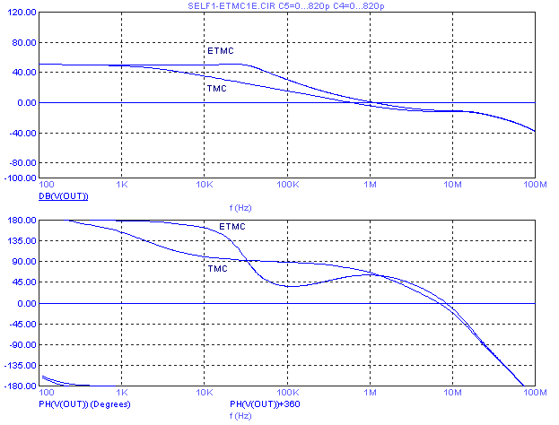

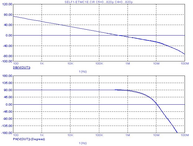

I forgot to drop the gain and phase response of the global FB loop (via R7, 1st pic) respectively local FB loop (via node A, 2nd pic). Finally, here they are.
Regarding the global loop response, notice that opposed to the previous example, the gain and phase bubble around 1MHz has gone.
E.

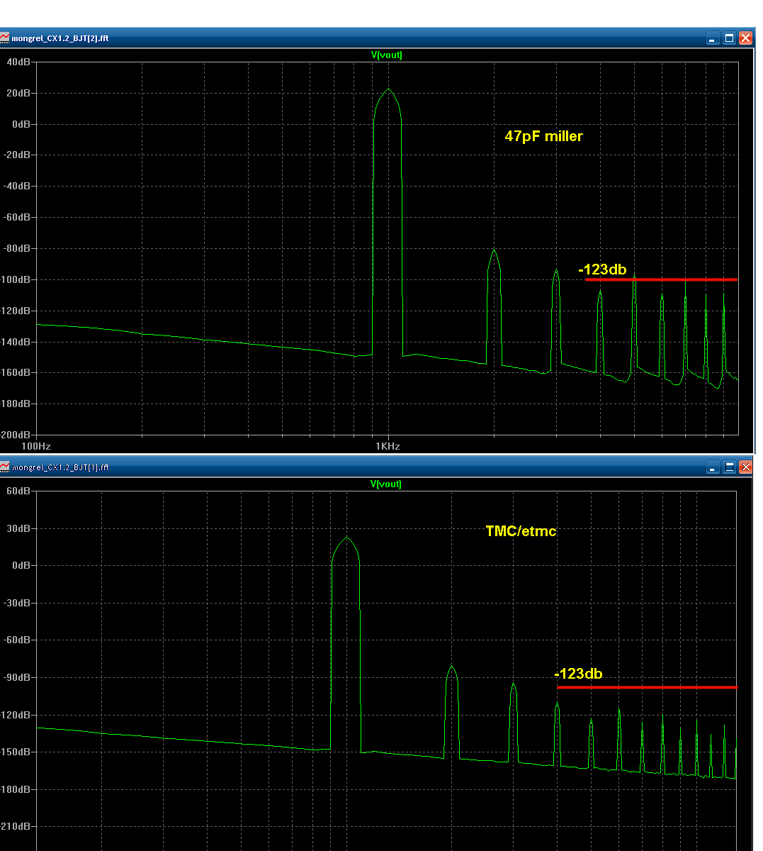

Absolutely!! 😎 I tried TMC/ETMC variants on both my symasym based design and my "blameless". On the blameless I observed a 10X reduction of total THD (300 to 30ppm) , most of which appeared to be higher order harmonics. Ported to my *sym ,the differences were more subtle .. but I did LOVE the substantial reduction of H5/7/9/11 (almost gone -142/-145/-150db!!). It is almost as through the BJT OP stage's Xover distortion influence was fully negated. The only way I could get the second FFT (below) before TMC/ETMC was to run the circuit in isolation (no OPS). I must be doing it right ,as my closed loop plot shows sufficient margin way after the UG point. I LIKE it... thanks Edmond..
BTW , I am not using as many "ideal" sources , so my results may not be single digit PPM. I also am not seeking PPM , but low high order components. 🙂

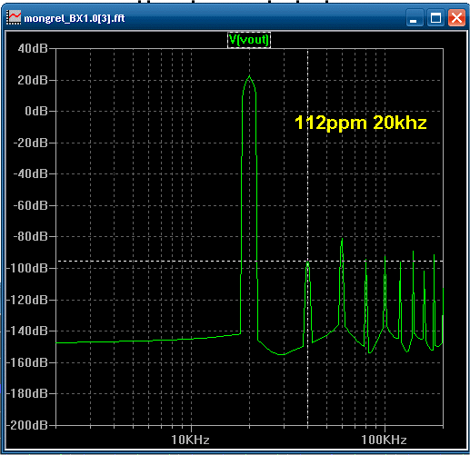

These numbers are really, really impressive, but how do the numbers look with a 20 kHz fundamental?
Bob
Hi Ostripper,
Bob

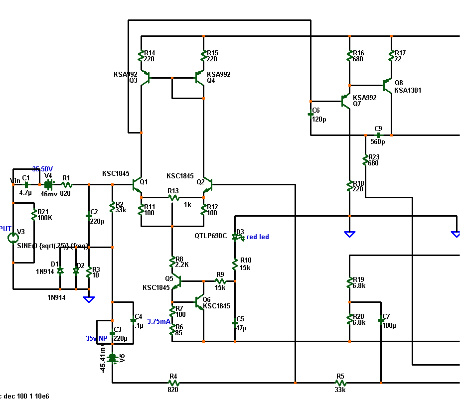

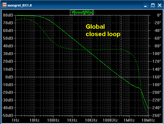

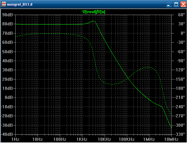

63ppm @ 40vpp /110ppm @90vpp - 20khz. I always thought of TMC in the terms of the "Self way" and was not impressed. With that little example of Edmonds ..Wahzooo! I then added the ETMC which had a much smaller effect on total THD. ETMC's beneficial attributes were noticable with "garbage" on the rails (PSRR) , improper OPS biasing.
I used Carlos's little amp since it is so "blameless" (below) and I actually have a pair running my 200W OPS's presently. Perfect test pig... The (2nd pix) shows JUST the TMC closed loop , when I first saw this I was a bit worried. It seems as if TMC extends the available loop gain to a higher frequency allowing better correction at those frequencies. The global closed loop bode(pix 3) is what convinced me to actually get out the soldering iron. Seems my phase margin was pushed to even higher frequencies ...

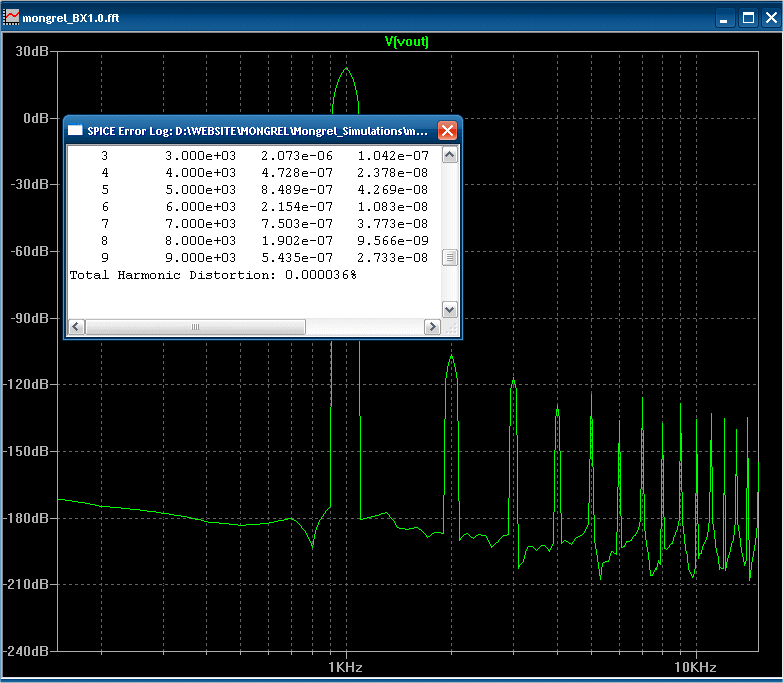

BTW ,is 120ppm THD20 really that bad ?? (pix4) .. this is just simulation, the real amp did not burn or oscillate , even with dubious used TV silver mica's. 😛
