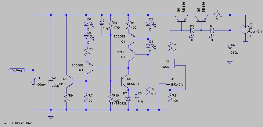

I created 3 LTSpice Model of the regulator with variations on the current source biasing D1 / D3. I did not have a model for LM334 and used a JFET that is pin-compatible, so one can actually use either. Maybe there are differences in performance to LM334, maybe not. First with a simple CCS:

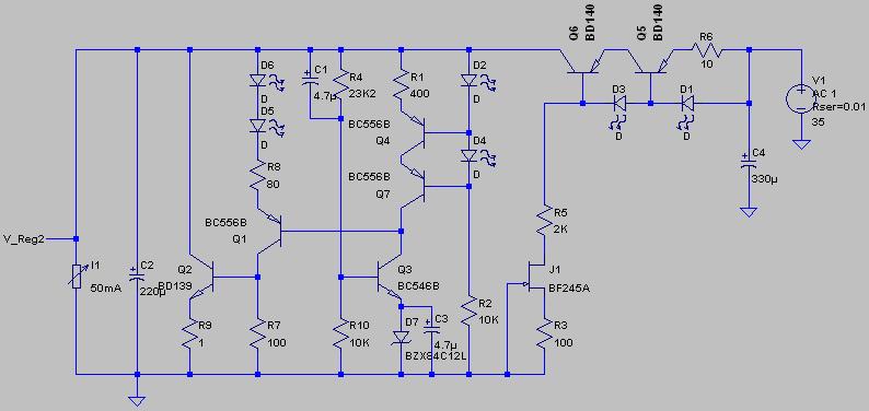

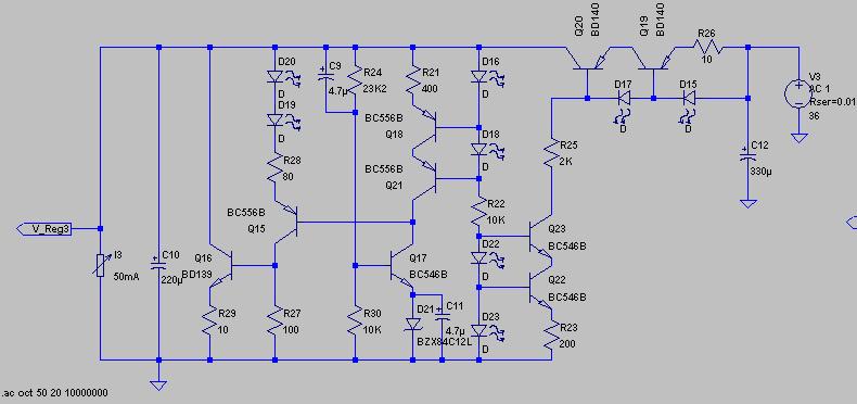

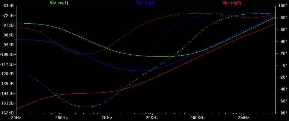

Here is the relative PSRR of the three circuits above: The series CCS is set to 100 mA, load current is 50 mA, Vin is 36V , with 1V AC, Vout is 30V. The results are interesting. Better results can be obtained with different transistors for Q5 instead (subject to quality of models):
Quickly: The setup is for a load current of 50 mA, and I chose the raw current through the current source as 100mA or twice the load current. I do not have models for the BC550/560 yet - I only installed LTSpice a few days ago and am still toying with it. However, I played with other resistors including some japanese models (2SC2240, 2SA970, and some others) at various positions but I only got moderate improvements if any, I will try the BC550/560 as a next step though.
The only position that made a substantial difference is Q5. I tried a BC327-40 and got extended bandwidth, probably from lower Cob ? (BC550/560 should have similar results) Then I tried a 2N4403, this lowered the PSRR by another 10-15 dB. Since Q5 has not too much voltage across it you can get away with using TO92 packages with currents of at least 150 mA.
Values of -160dB are somewhat suspicious, but then I saw Glen's grahs and they go down even further.

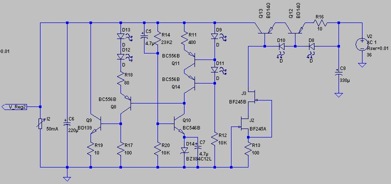

The next version has a cascoded CCS, this works both with the JFET and the LM334 (see datasheet).
Martin,
I would keep the two current sources for biasing apart. You don't want any ripple in the series CCS to end up in the shunt part.
A simple change that may improve regulation is to run R10 not to ground, but into the top of the zener. That way, you further stabilize zener (ref) voltage against Vout variations. R10 would then be smaller (would be anyway) but you could also replace R10 with a ccs. The FET type would be OK, I just had some LM334's laying around, that's why I used that one.
As far as the sims, they are OK to compare things, but don't get to excited with absolute numbers. For one thing, it doesn't take into account the layout and a lot of other real-world issues, for another, you don't really know how realistic the models are.

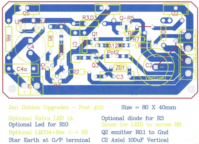

A different pcb layout approach to the current design, but illustrates the earthing focus on the O/P terminal - it does include some of the "J.D" upgrades, but not the last "rail-to zener" resistor that is currently under discussion.
Jan,
This resistor from the o/p rail to the top of the zener/Q3 emitter ....
If I follow your last post correctly, we can lift the gnd connection of the R10 (or R20 in the 2nd diagram) and attach this to the top of the zener, or even better, convert it to a BF246+R CS? This then is connected directly across the Q3 be junctions?
Martin,
On the first diagram, the Q2 emitter resistor is set as 1R0 but on the next 2, is a 10R - a misprint? (ie 0.1R)?
Martin, I would keep the two current sources for biasing apart. You don't want any ripple in the series CCS to end up in the shunt part.
I fundamentally agree, but this just looked too good - I may pursue this topology a little further outside this project. Btw., it is just combining the LED strings of both CCS. The second CCS is actually relying on the fact that the first CCS isolates it / and the whole regulator part from the rails. I also tried a CCS to bias the second string of LEDs but this brought no improvement whatsoever.
Jan,
Martin,
Sorry, my mistake: I meant R2, 10k, that biases the D2/D4 string for the shunt cascode. This bias current now goes to gnd. My proposal is to 'use' it to stabilize the Vref by returning it to the top of the ref zener. Next step would be to replace this R with a ccs.
Jan Didden

corrected version
Here is my corrected and final version, with the cascoded current source as I would implement it, but I am off course not the owner of this project. R5 is still left in to allow higher voltages than J3 can take. Do not get too hung up on the particular JFets, bjts, and resistor values, there is still some room to tweak, e.g. if a particular part cannot be obtained:
