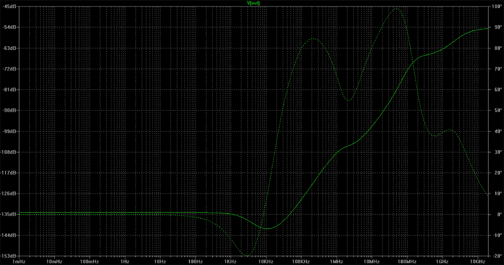

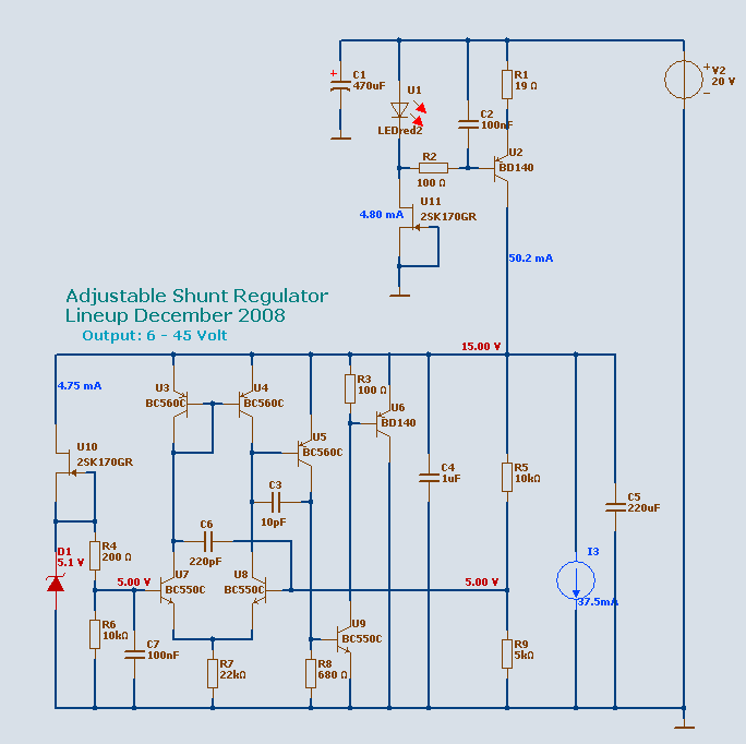

I received a number of questions regarding my version of this regulator: I am currently using 4 regulator boards running at 30 Volts (two positive and 2 negative regs). I made some slight amendments which you can easily see if you compare this circuit to the previous one in post 562:
Basically, I moved the compensation cap C6 and added a resistor R5 of ca. 10 Ohms in series. The phase margin looked better in simulation. And I removed a cap and resistor and have now a single resistor R2 to bias Q5. I am using 9.1 Volt Zeners as voltage references. Most component values are not critical and I used what I had, except compensation caps C6 (and R5) and C9, C3 should be at least 470µF, R6 can be from 1-10 Ohms and the higher value reduces gain (see also below). If you set the circuit to different voltages and/or currents you need to watch dissipation in the components.
As a warning: I had one regulator board which was oscillating, and the oscillation coupled into the other three regulators via the long umbilical cord to the raw supply, so they too started to oscillate. Increasing the emitter resistor R6 to 10 ohms (reducing gain) for this one regulator cured the oscillations. Why one reg. was oscillating while the others where not is not clear to me. At any rate, if you decide to use the circuit you should be able to check for oscillations, but this is probably a good idea with any regulator.
