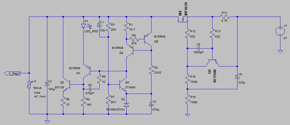

I built the positive one and have problems: the trafo is 18v which give me 28dc at the input of the reg.
I can measure 14.45v at the output of the reg but the leds don't light and i think i should have 18v at the output no ?
I'm using the LM334 and LT 1009, LT1029.
Voltage measured at the top of RF2 is 9.37V....should be 5V ?
Can you give me the correct voltage values for the different points of the circuit so i can debug this ?

What is the value of R1, R2, R7 and what is the load on the regulator (if any)? These values depend on the desired output voltage and current, so there isn't really a way I can give you the operating points of the circuit unless I know these target values.
values are as in schematic: R1 is 39R, R2 is 68R and R7 is 4k7...for 18V

but what puzzles me now most is the fact that i measure 9.37V at leg 2 of RF2
when i should be measuring 5 v i think.
There is 1.2 V at the terminals of led 1...not enough...and led 2 has a few milivolts...

hm. did you install the diodes on the back of the board? Can you verify that the PNP and NPN parts are not mixed up? Also, in case the silk is somewhat confusing, for the positive channel the flat face of U1 should be facing left for the LM334 🙂
Ok, i got stuck in the subject, studied the thing and ...it's working.🙂.............BD139 had given up the ghost !

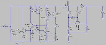

I received a number of questions regarding my version of this regulator: I am currently using 4 regulator boards running at 30 Volts (two positive and 2 negative regs). I made some slight amendments which you can easily see if you compare this circuit to the previous one in post 562:
Basically, I moved the compensation cap C6 and added a resistor R5 of ca. 10 Ohms in series. The phase margin looked better in simulation. And I removed a cap and resistor and have now a single resistor R2 to bias Q5. I am using 9.1 Volt Zeners as voltage references. Most component values are not critical and I used what I had, except compensation caps C6 (and R5) and C9, C3 should be at least 470µF, R6 can be from 1-10 Ohms and the higher value reduces gain (see also below). If you set the circuit to different voltages and/or currents you need to watch dissipation in the components.
As a warning: I had one regulator board which was oscillating, and the oscillation coupled into the other three regulators via the long umbilical cord to the raw supply, so they too started to oscillate. Increasing the emitter resistor R6 to 10 ohms (reducing gain) for this one regulator cured the oscillations. Why one reg. was oscillating while the others where not is not clear to me. At any rate, if you decide to use the circuit you should be able to check for oscillations, but this is probably a good idea with any regulator.
