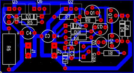

Dear Jan,
Here is my newbee's attempt on the layout. I hope it is not too bad. I am using PADS, so some of the outline patterns are odd (e.g, J1, J2 are input and output terminals, respectively.) I have add R10 to provide current from the regulated output to the reference zener Z1, but still using R5 instead of LM334.

janneman said:More measurements.
Changed R8 to 82 ohms + yellow LED (~2V). Works fine, and will allow use for 5V reg.
Changing R3 to LED only increases dropout, not usefull.
Then I replaced R5 with an LM334 CS (Rset=12 ohms, ~6mA). Some improvement, not much.
Then I measured the PSRR directly across the regulator sense points, between top of R4 and bottom of VR15. Bingo: a more than 20dB improvement! PSRR at 1kHz now -65dB. Residual close to noise (~ 60uV).
So the problem is the layout. If you want good performance at the output terminals, you must sense the errors at the output terminals. Top of R8 with its own trace to the output terminal, bottom of VR15 and bottom of ref zener Z with their own traces to the output gnd terminal. E & C Q2 with their own traces directly to the output terminals. Also C2.
I bet that Rout will also be much lower with those changes.

To all,
We are moving forward quite nicely with the refinements to this regulator thanks mainly to Jan’s efforts and also to so many others that have contributed before.
Our next task is the layout of the board to meet Jan’s outlines and this work will be done by Colin who was kind enough to accept this responsibility; so in a few days we can expect results.

Thanks, and I thought I was even more confused than I already am. My understanding is that the schematics you posted is not exactly the final result?
The most fundamental thing that is missing here is the current source and biasing resistor instead of R5 (or under R5 - this would remove the voltage limit for the LM334). It has a substantial influence on the current source performance and I thought Jan recommended to put this in. Btw., the LM334 has the same footprint as many JFets so one could use either on the finished board.
Another suggestion from Jan is to replace VR15 with a fixed resistor. It is less convinient but may be better. Or alternatively both in parallel (most current through the resistor and a small portion through VR15 for adjustement).
Another "request" for the layout: For D3 and D4, can you put in an extra solder joint so that one can optionally use an LED, would give some more flexibility.
P.S. I know this would be asking too much, but how about an emitter resistor under Q2?
Z2 should be a LED as well. I'm not sure we need an Re for Q2. Glen's rationale is OK (limit loop gain) but I think the same can be done with the R7/R8 ratio.
Jan, we could even cascade 2 red leds, this would fully compensate the voltage drop of the D2 + D4, and those who prefer a Zener would have the space to put in a zener - so just 2 more holes in the PCB. It could then be the cheap red LEDs and they are indeed cheap.
About Re, it is just a suggestion but would add the convenience of measuring the shunt current.

Yes, good points. The only reservation I have about that Re is that it would/might decrease performance. But as you say, what's 2 holes on a pcb between friends, eh? 😉

as someone whohas used current sourced shunt regs in everything he's built for 30 years, tube and solid state, I STRONGLY suggest the addition of a 1 or 10R reistor to enable being able to measure the actual shunt current.
I can tell you from this practical experience, it's a great help when setting it all up - other wise you have to either guess, make severalmeasurements and then some calcs, or hold the shunt transistor in your pinkies and see if it's cold, getting warm, or too hot.

With R5 instead of a CCS one might experience a surprise when checking, whether a shunt regulator is really inherently protected against a shorted output...
At least I had such a surprise with a similar circuit...

Allen, I just measured the total current with no load across R6 and that gives me the shunt current +/-5%, good enough for a quick check.
But, again, if people find it comfortable, why not.

With a short, the total Vin comes across the CCS. That *might* be a problem, but I can't see anything otherwise. Was it overvoltage?
