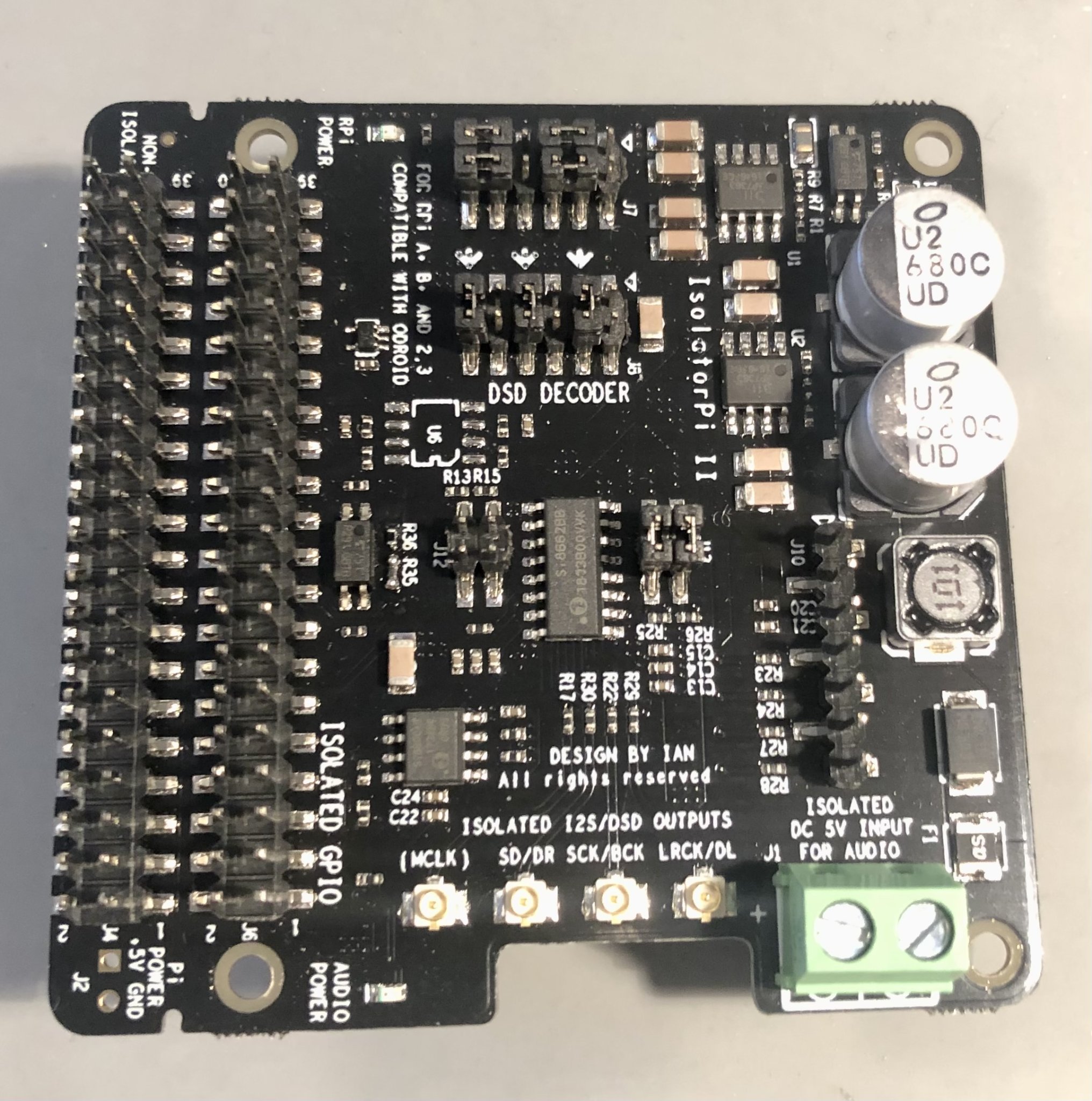

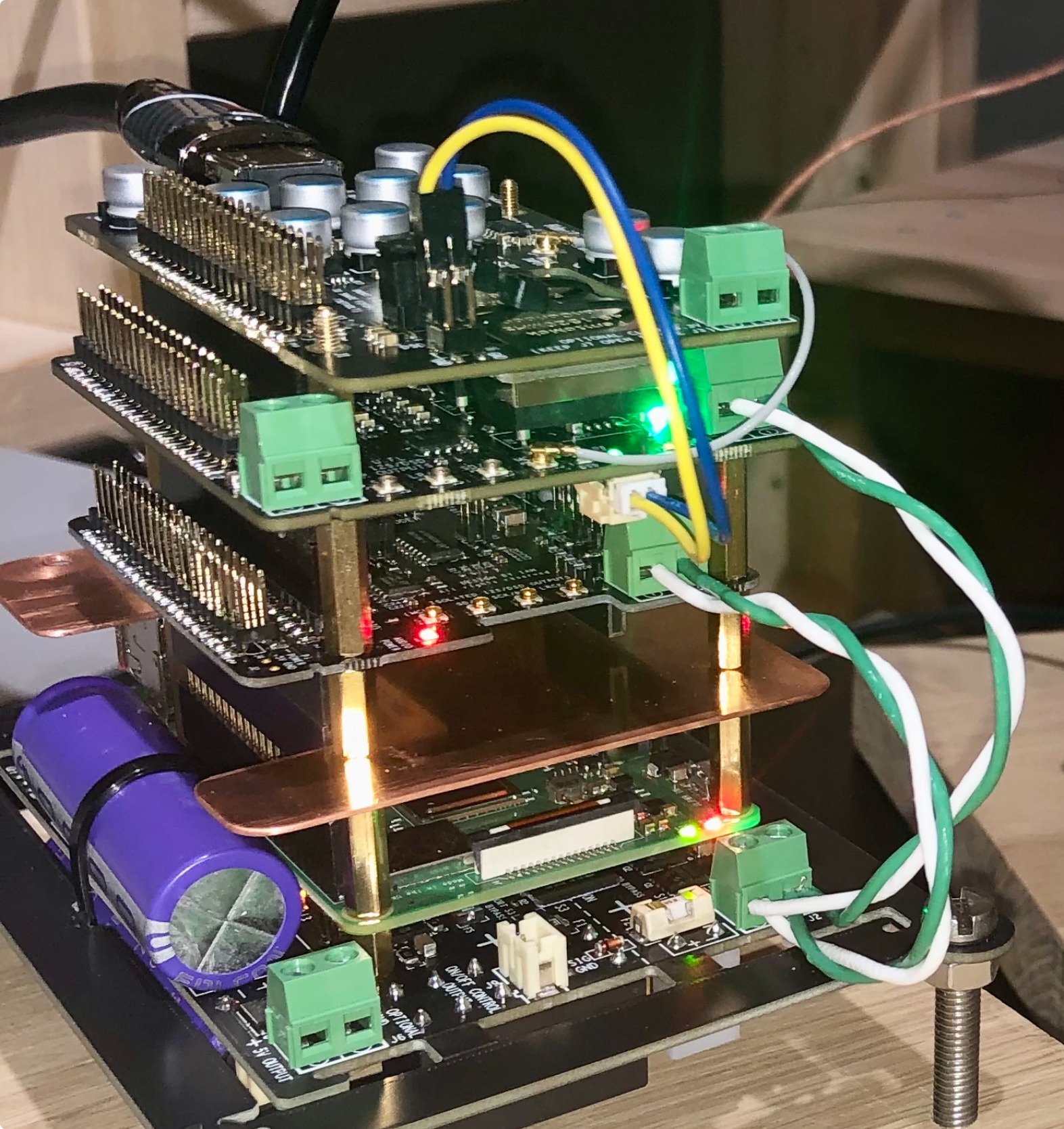

I am sorry, but what I can see right over the copper shield is the FiFioPi...
If there was an IsolatorPi we would see its power connector on the right-hand side, just below the 3,3V connector of FiFoPi.
Maybe you can make a better picture from a side such that we can understand how this is mounted?
Directly above the copper plate, it is this that is mounted, and it is written on it.

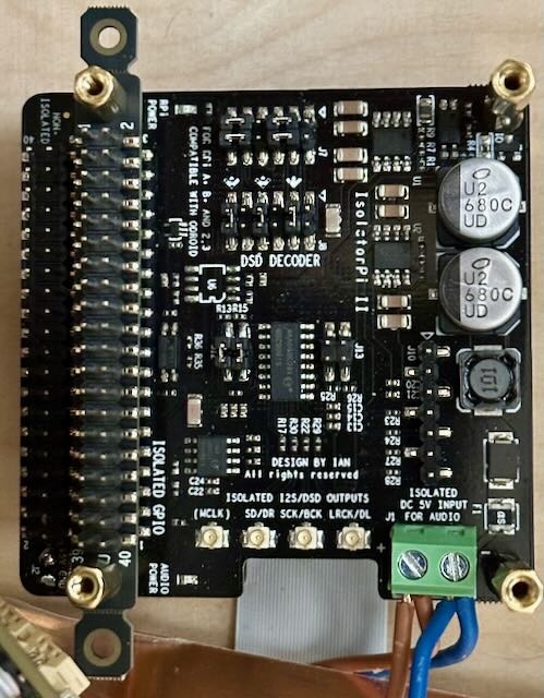

sorry about the picture. this is the picture with isolatorPi ll fitted.
Thanks. Now it seems about right. Can you connect MonitorPi Pro just for a moment from the secondary stack to the FifoPi Q7 on the first stack. Just to double-check the problem is with FiFoPi not getting the signal.
Can you also try disconnecting the DSD Mute cable (yellow and blue) for a moment, and test. I did not have this cable connected.

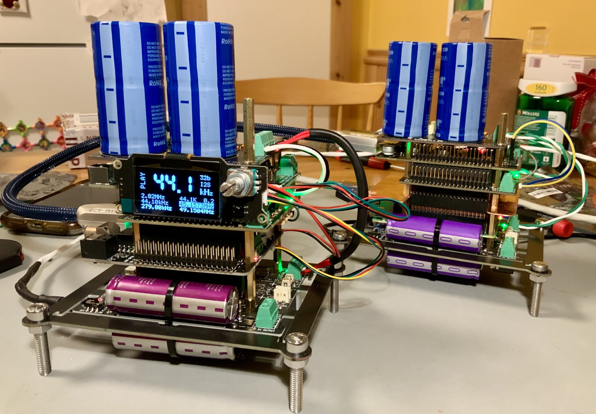

I get no signal from isolatorPi ll when I use HDMipi MKll transmitter to DDC stack, I want to try isolatorpi ll in Master mode. There is a very good sound with no isolator Pi ll.

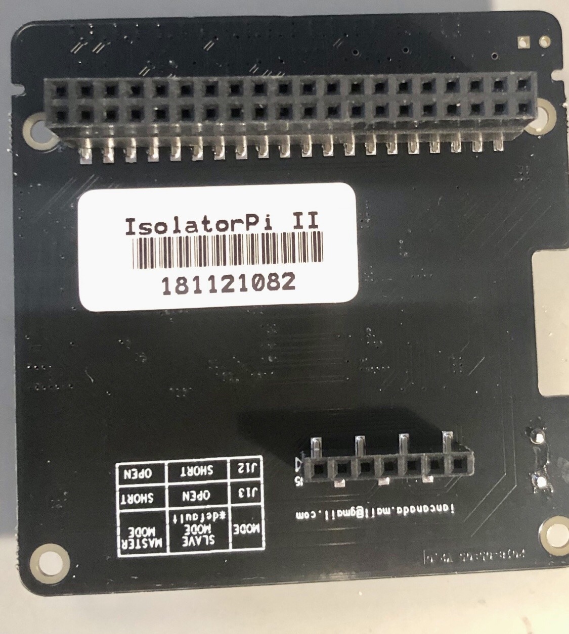

@geiren I checked my configuration of IsolatorPI MKIi and I run it with different settings than yours. My isolator is set to SLAVE clock mode and your was set to MASTER clock mode. That is probably why it was not working on your side. Check J12 and J13 on mine below:
You could also consider skipping HDMipi MKll transmitter and getting the I2S signal from the first stack to the second stack via GPIO. This is what I have done - removed the HDMI transmitter from the first stack and the DDC from the second stack. The stack are connected over GPIO.
I am waiting for #21B GPIO input adapter for FifoPi to connect it to the second stack. Then will connect FifoPi from stack one over the u.fl wires to the GPIO input adapter on the second stack. This will be better than double I2S/HDMI + HDMI/I2S conversions!
Eventually, I intend to install DDC on the first stack, so I keep additional input options.
