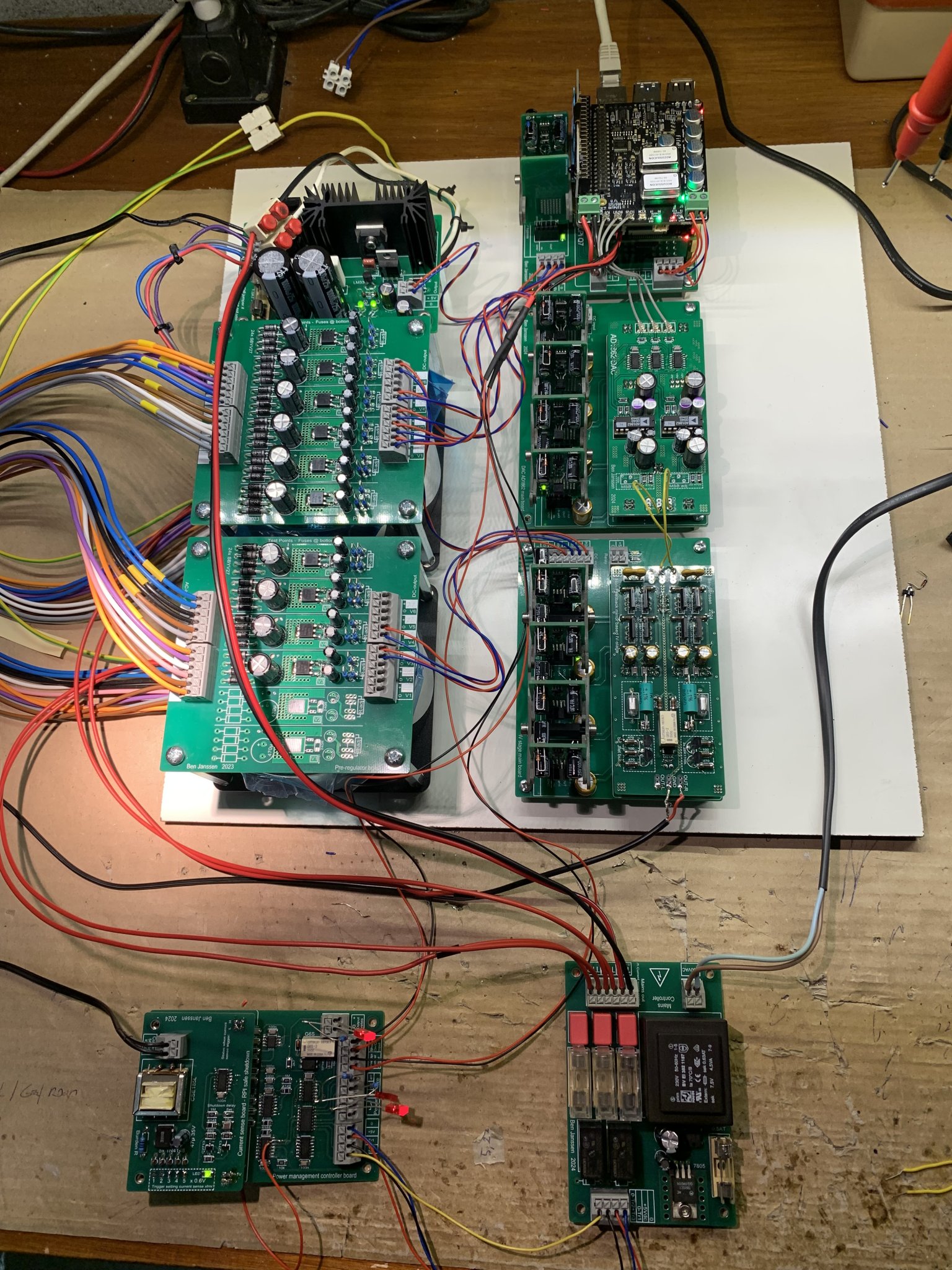

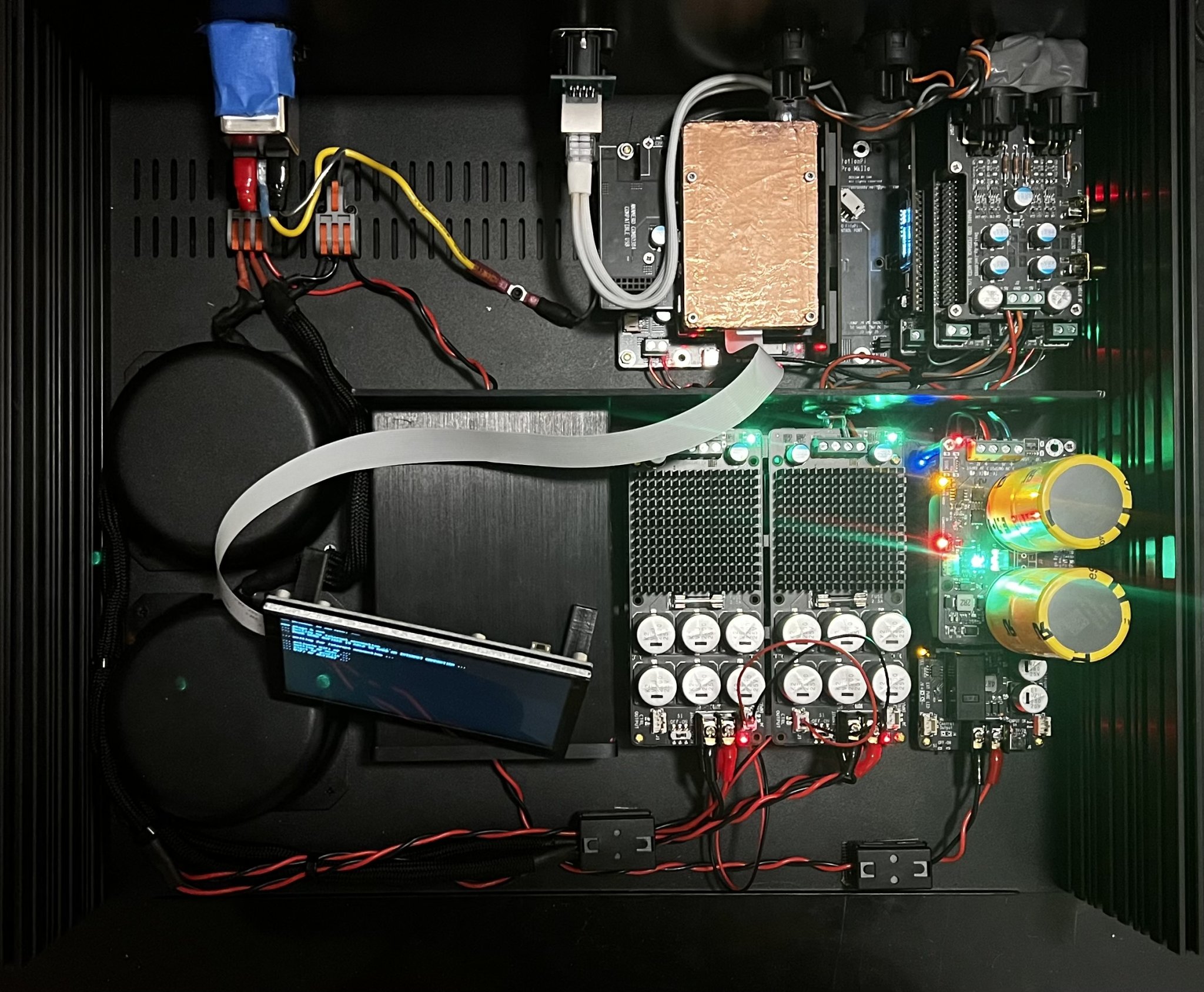

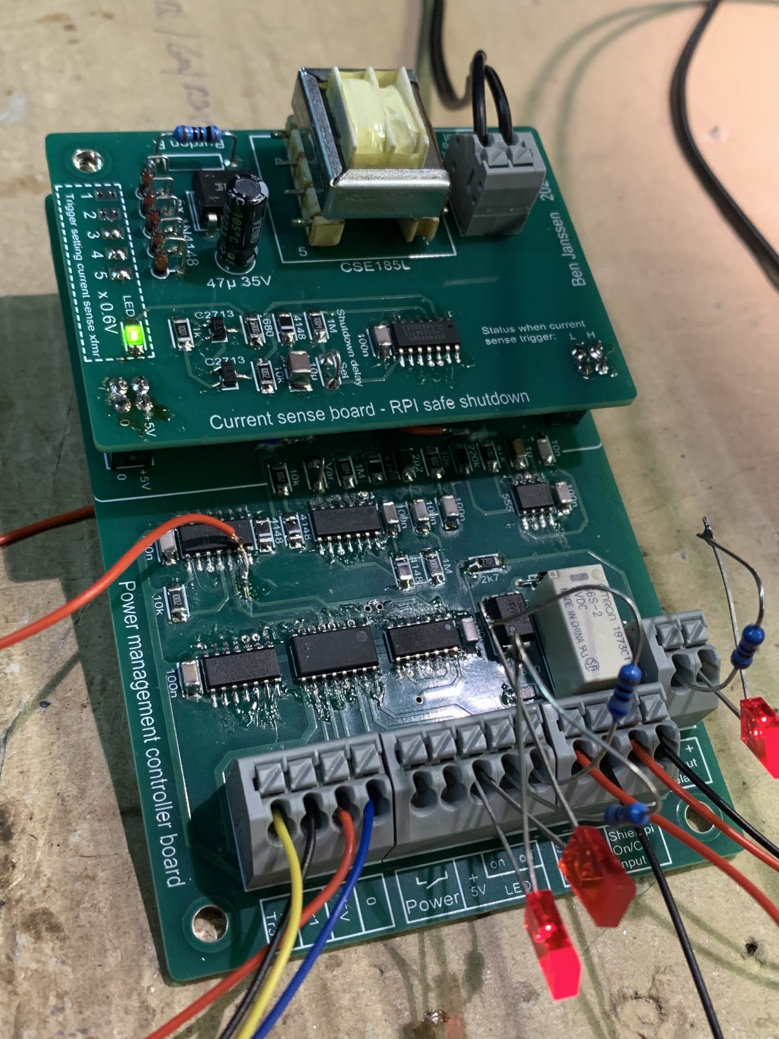

RPI power management.
I have a first iteration running of my circuit and PCB to make sure the RPI is safely shutted down, before mains are totally disconnected from streamer and DAC.
Yes, one of my personal requirements is that my DIY builds are fully switched of when not in use, excluding one small PCB transformer for the power management.
The circuit makes use of a current sense transformer (CSE185L), to measure the current towards the R-core xfmr, dedicated for the RPI.
The two signals from the Shieldpi are being used: external trigger and on/off input.
One happy DIY’er here.

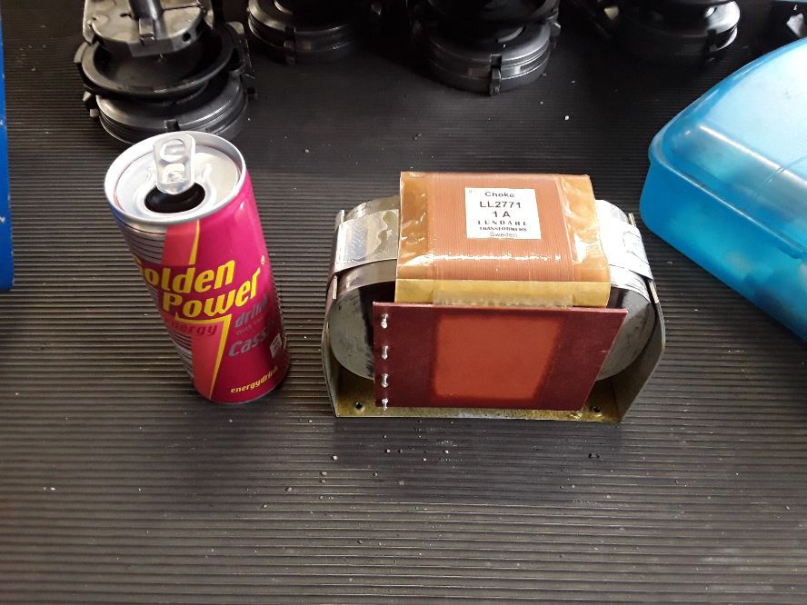

I have been using a 2.1 amp for more than a decade that had a big battery supply for a long time. When i had some big Lundahls in " stock" i bought a surplus Philips transformer and made a choke input and to my surprise it was quiet a lot better than the batteries which were no knock offs.

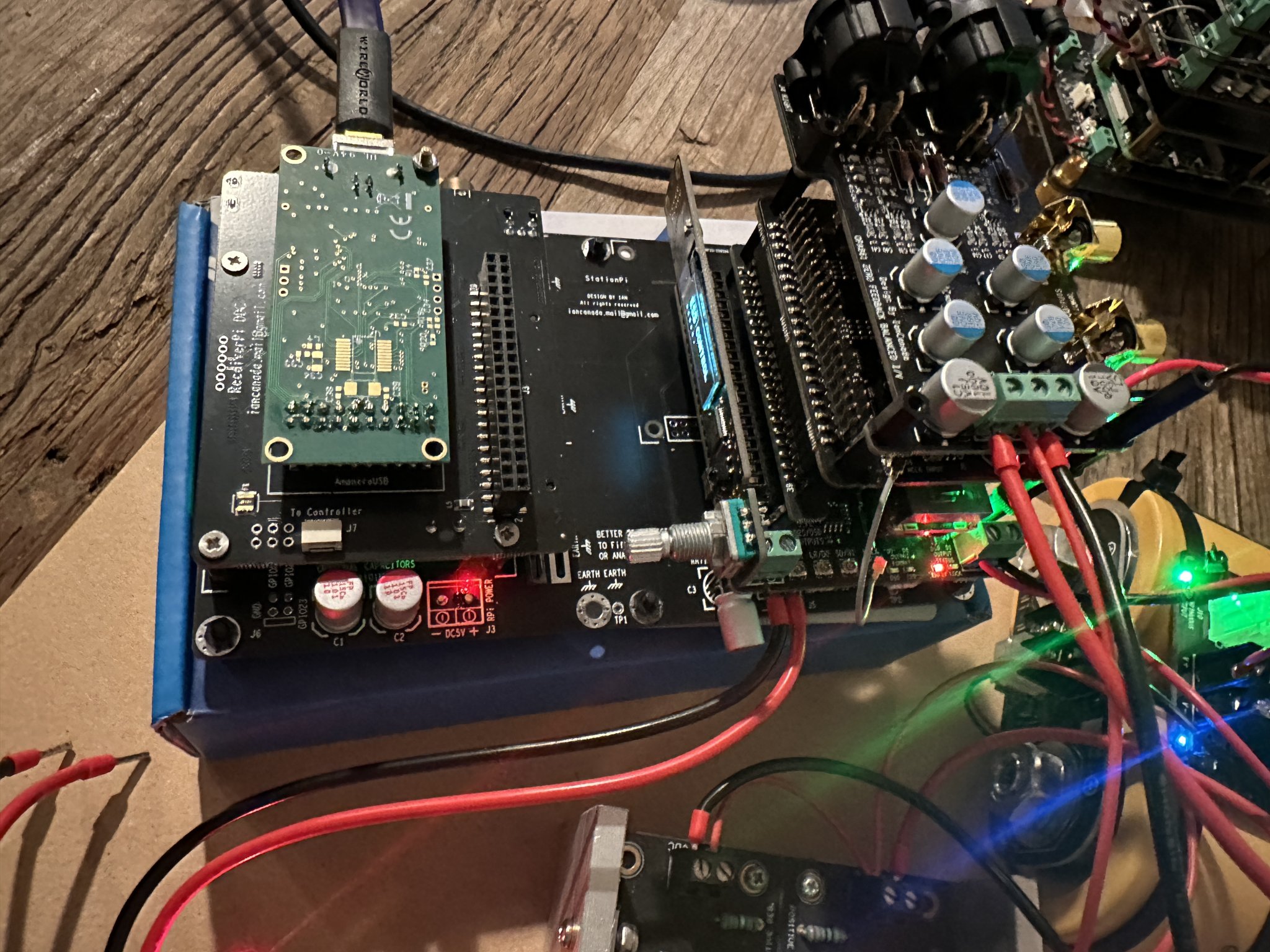

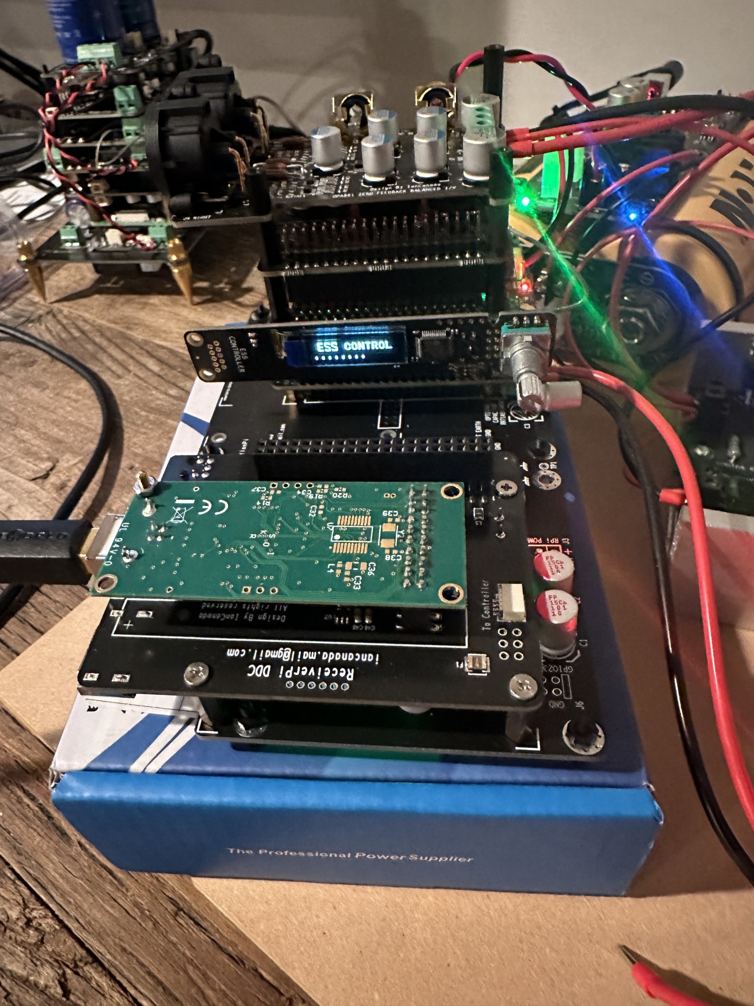

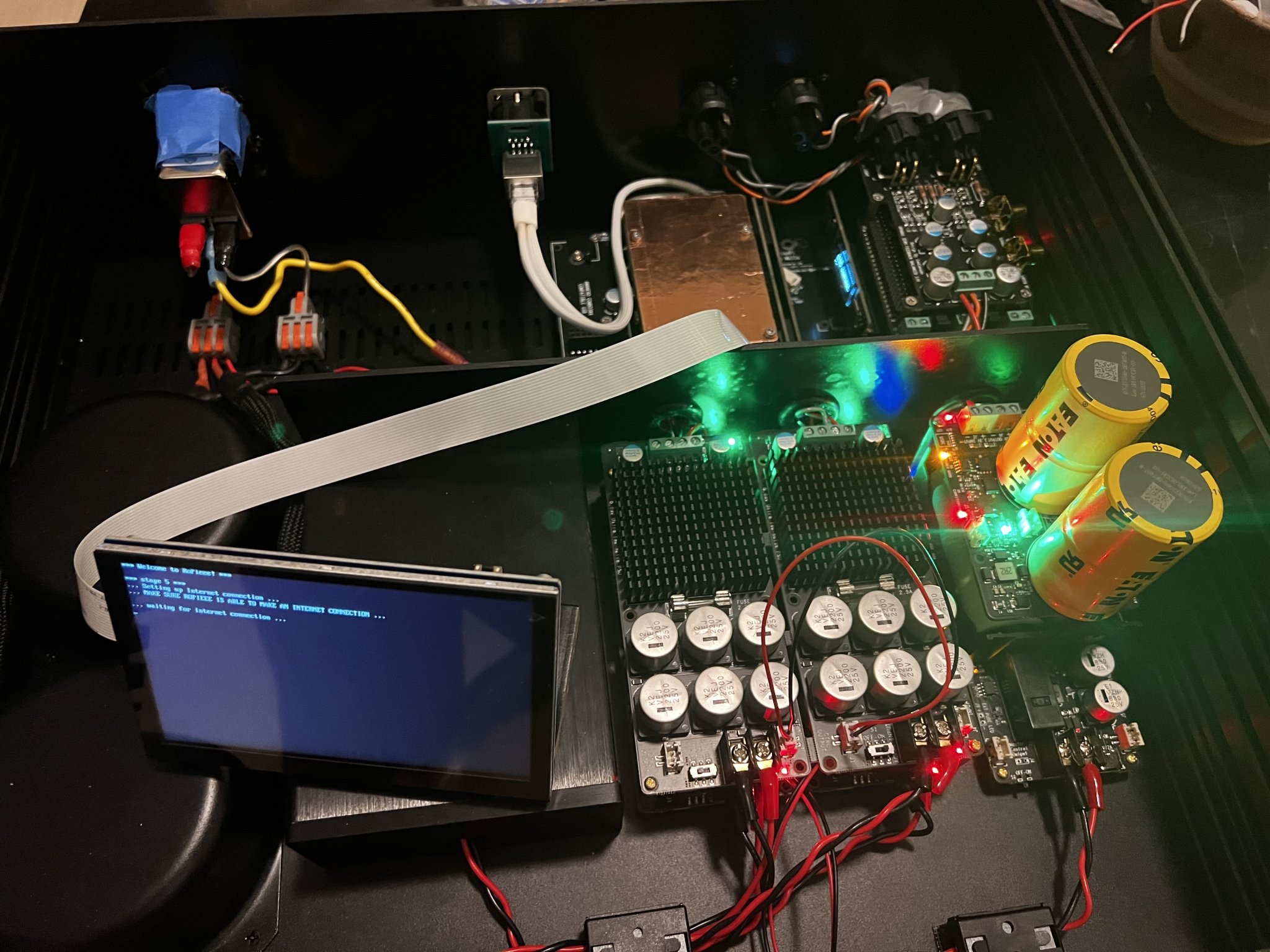

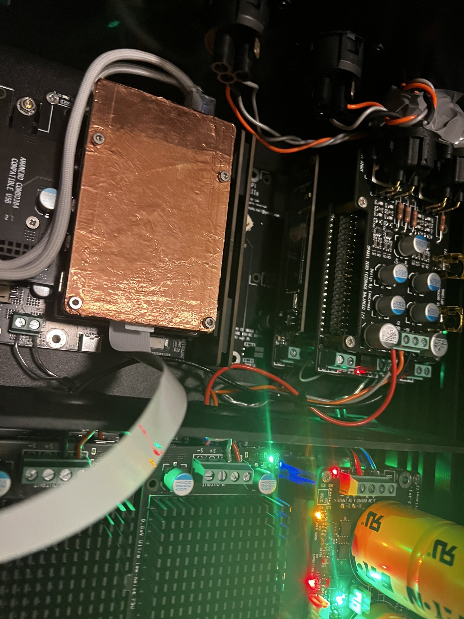

Looking for a little trouble shooting help.
When using the StationPi pro does the Q7 and Dac get powered?
I’m using a dual linear pi for the Station pro. (1side to the Ropieee, 1side to the audio side) Q7 and ess controller is the first layer, then Dac, the OPA864 on top.
Q7 clean side has power from a LIFOmini.
Everything has power except the dac.
When adding a jumper on the dual linearpis and toggling S1 I can either get the dac powered or the Q7 powered but not at the same time.
What am I missing?
Thanks!
First pic is all powered on
Second pic is toggling S1 that shuts off the RPi side and the Q7, but turns on the dac.
What am I missing?
Thanks!
If you are using two linearPi to power the StationPi pro (one for the Rpi and the second for the audio/dirty side of Q7), you should remove the jumpers J9 on station pro.
Do you use the LifePo mini+UcCond. combo to power both the DAC and Q7 clean Side? (This should be fine BTW).
Regards Mikkel

I could just come straight out of the UcConditioner to both Dac J1 and Q7 J5 right?
Also I remove the black jumpers? The wording makes me think that the black jumpers stay on. The board says “To share two Dc input J3 and J5”
@camrector
I would connected it with the shortest wires possible. That could easily be straight from the UcCond. with two sets of wires. Maybe the middel connector J2 at the DAC is even closer.
Yes must still remove the jumpers J9 on StationPi pro if you want to gain any improvements using two LinearPi at the StaionPi Pro. I agree with you regarding the “To share two Dc input J3 and J5”. It´s a little cryptic, but it means that if you only have one DC supply you share the two inputs J3 and J5 by having the jumpers in place. Sorry, but don't know how to explain it any better.
If you want to check it and that's what i did, first remove both you wire connection from J3 and J5 at stationPi Pro and then measure continuity with a multimeter:
  • With the jumpers in place at J9 you will have full continuity between "+" at J3 and J5. (You will only need one supply to power both)
  • With the Jumpers removed - no continuity (you must use two PSU).
The last setting is what you want since you are using the better option with two power supplies.
Reactions: camrector
