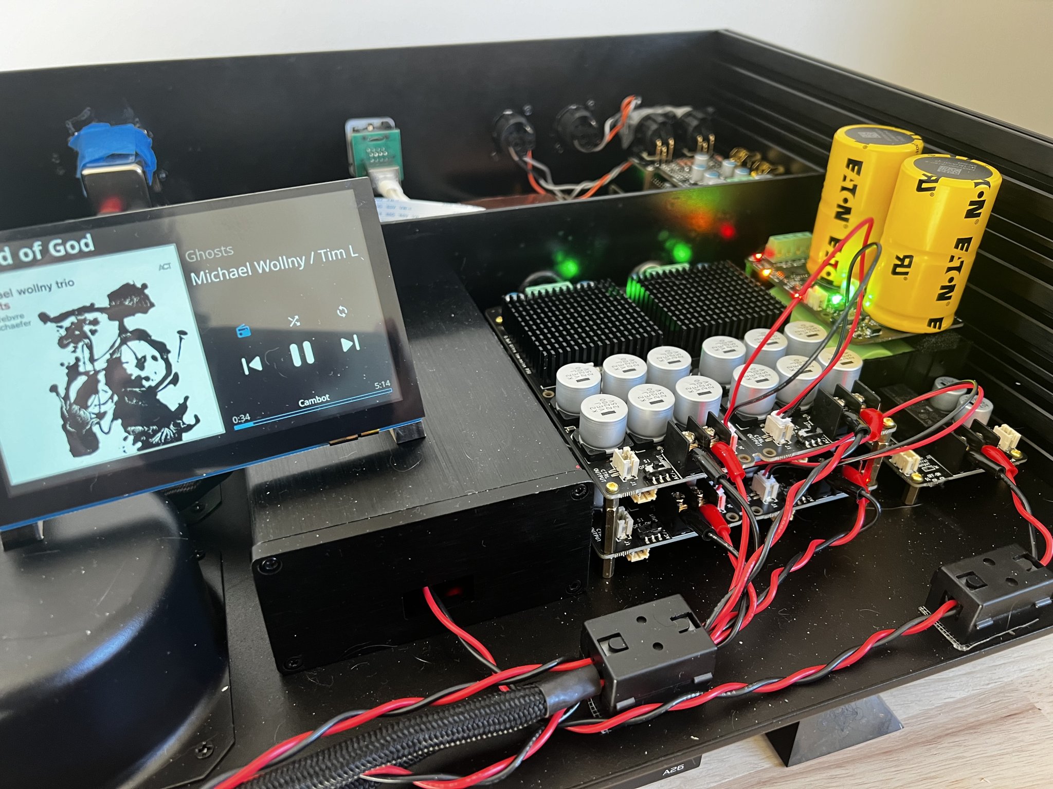

In what order are you turning on the power to each board? The Q7 must be power just before the DAC in order for the ESS controller to find DAC.
Have a look at Gabsters video here at around 55 min:
See if trouble shooting this helps in any way.
I too had this problem once.

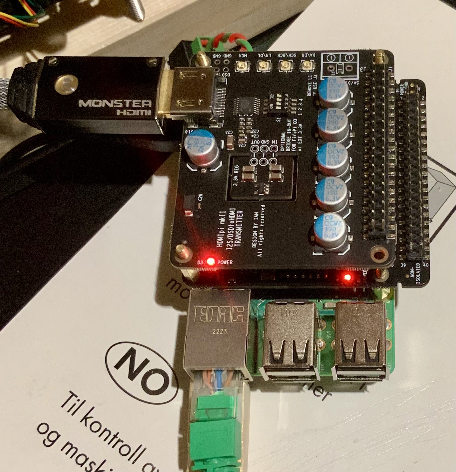

Thanks that worked and also now realize ESS controller will not change inputs on the DDC so need to jumper or get a monitorpipro.
Nevermind I got it!
@miklau the secret was connecting the dac to the Q7 clean power output.
Because the routing was easier I connected the dac initially directly to the LifePo4/UcConditioner.
Switching it gave the dac the delay it needed! 👍🏻
Listening now!
Thank you all for your help.
Now to make this thing pretty on the outside!

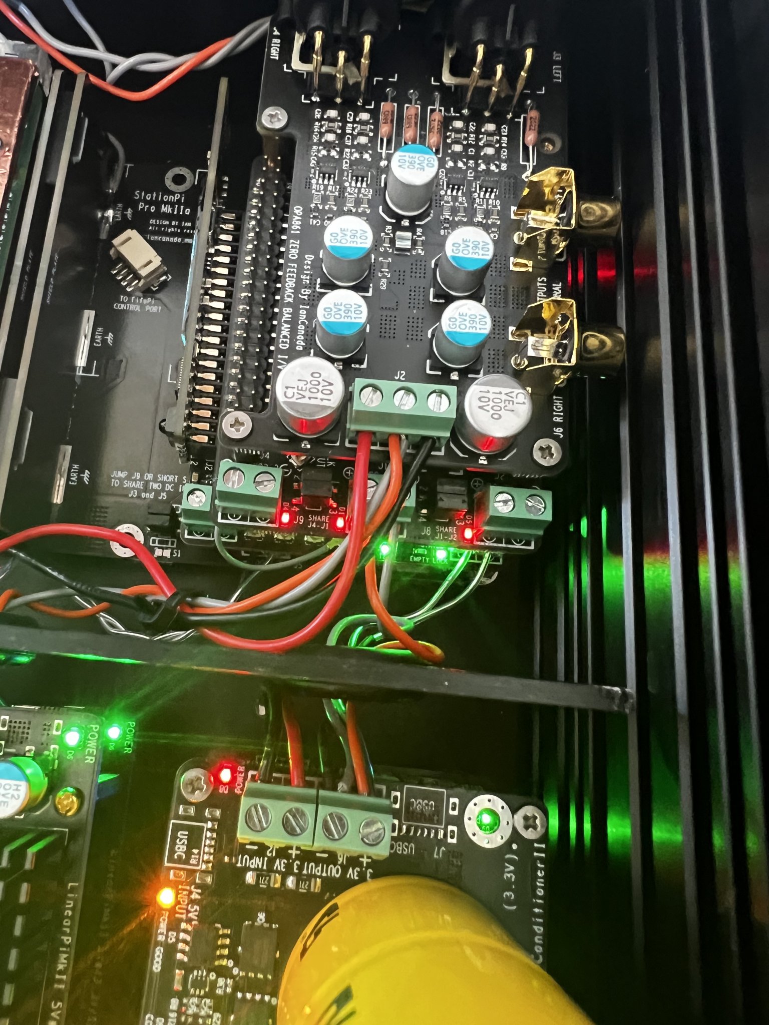

Did you solve the jumper issue?

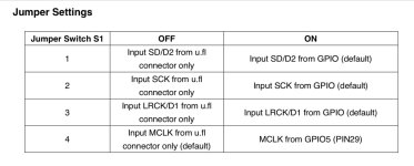

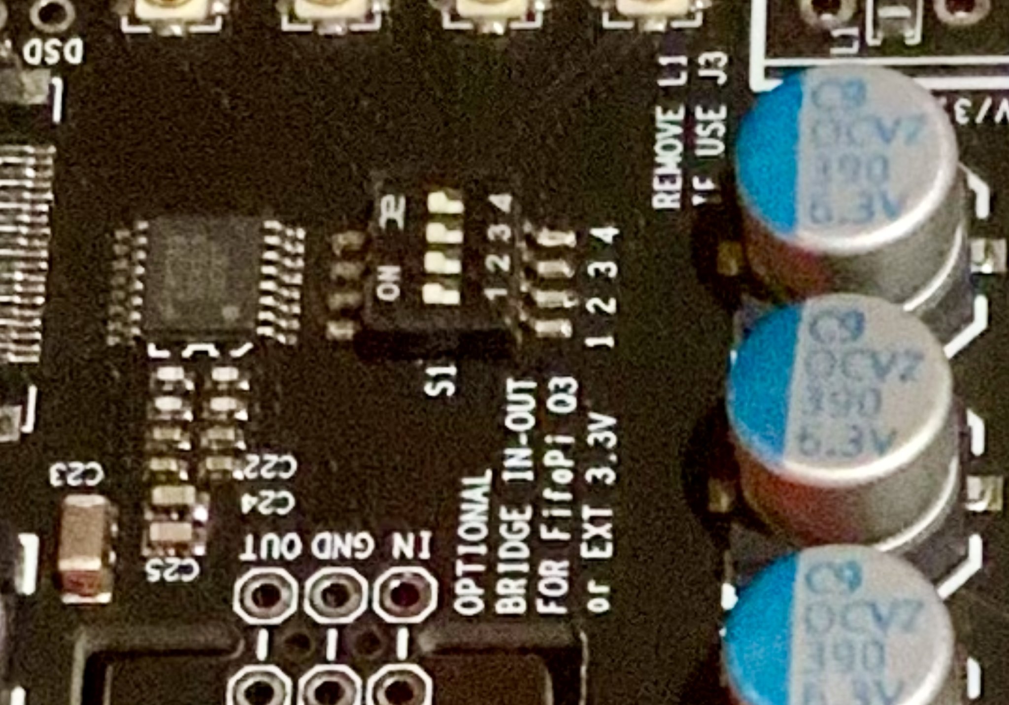

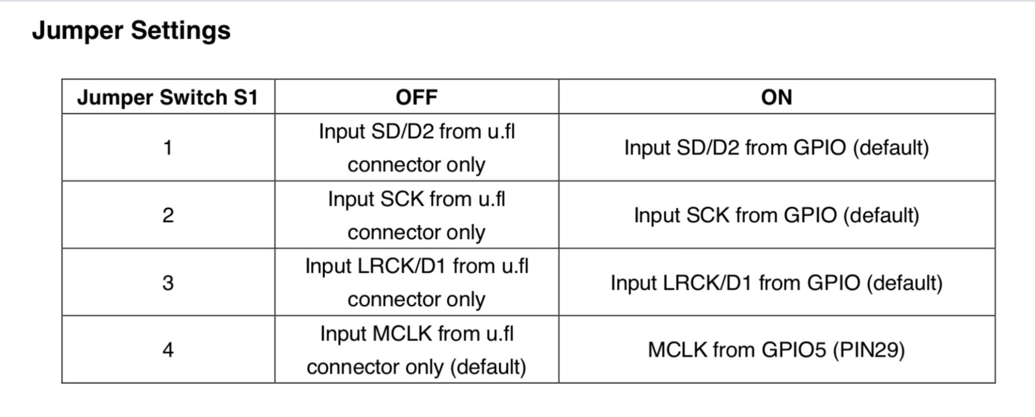

Have you tried measuring the voltage at j3 and j5 with the jumpers off?

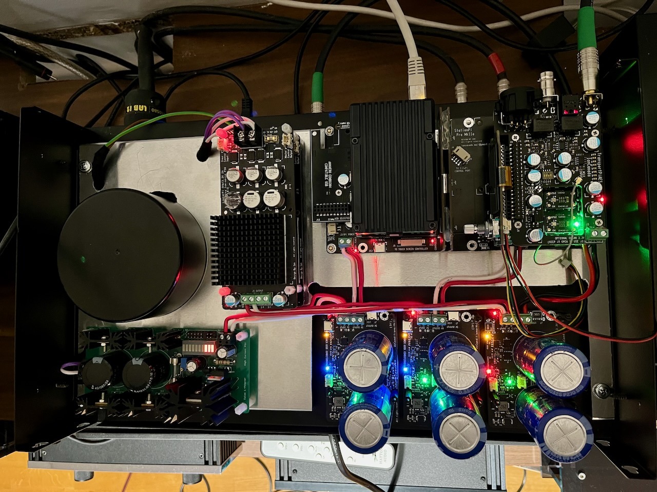

Looking at you last picture the cabling of you master/slave on off control looks a bit off. I can’t see any on/off control cable connected between the bottom and top stack off your LinearPi’s.
Maybe you were just testing?
Reactions: camrector
@miklau
That’s the last part I need to figure out.
I get no power with the jumpers removed
J5 is getting power
Yup I was testing the master/slave cable but everything is working now with the cables and jumpers on so I’ve left it be.

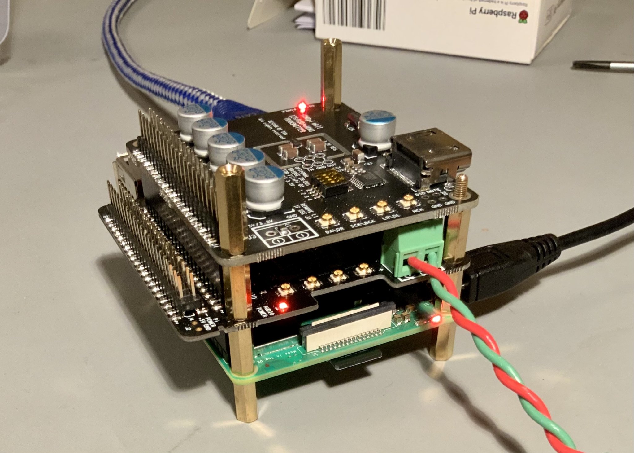

Maybe because I’m using the vertical gpio connection and not the horizontal one? 🤷🏻‍♂️
@miklau Ok got it
Jumpers and cables removed
I guess it just takes a bit longer for the Ess controller to load.
But it’s all good now!! 🙌🏻

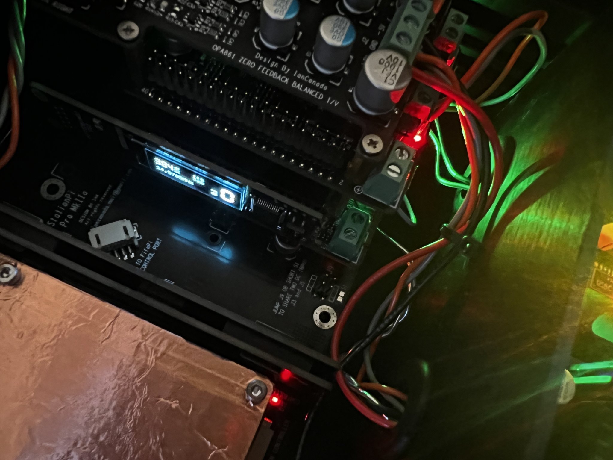

Edit Nevermind
It was playing without the jumpers for like an hour then just turned off
Put the jumpers back on and it’s fine
Pic is showing the jumpers off and everything working.
Edit again.
Ok just seems to be a connection issue
All is well now.
Thanks you all.
