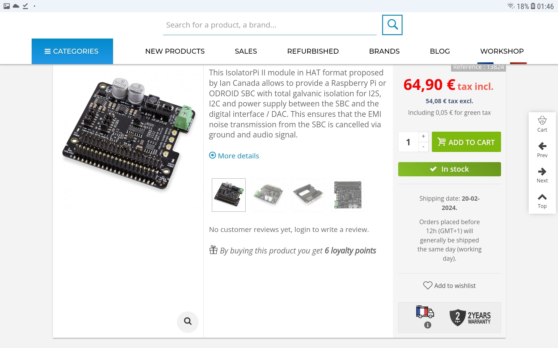

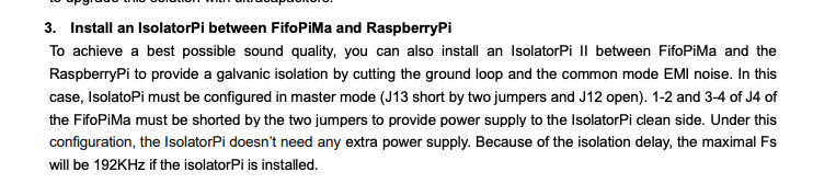

You seem not to consider that these boards can be used in various setups. In case FiFoPi is plugged into RPi then the dirty side is shared with RPi. But in my setup, it is connected to the clean side of the Isolator.Making them share the same supply you will make it onto one muddy area? I guess the division was created for a reason.
I guess there is a reason why Ian made MKII of FifoPi Q7 to also accept 3.3V.
@eduard I suggest you build something yourself, get more insight into how Ian's products are designed, and maybe cool down a little on commenting before you can contribute with your own experience.
That's right, I do it this way but with a FifoPi Ma- isolator II, works well.You seem not to consider that these boards can be used in various setups. In case FiFoPi is plugged into RPi then the dirty side is shared with RPi. But in my setup, it is connected to the clean side of the Isolator.

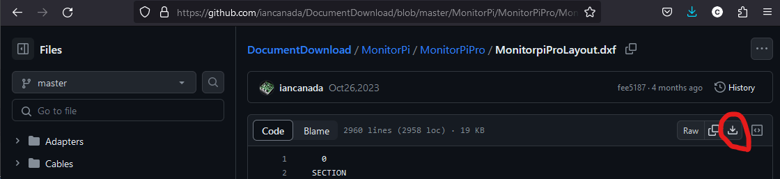

I have used a software called CADReader on my Mac. That works fine.I think that something is not right with https://github.com/iancanada/Docume...MonitorPi/MonitorPiPro/MonitorpiProLayout.dxf
Tried a couple of different CAD software, but can't open it...
I used the “Download raw file” at my desktop at Ian’s GitHub.

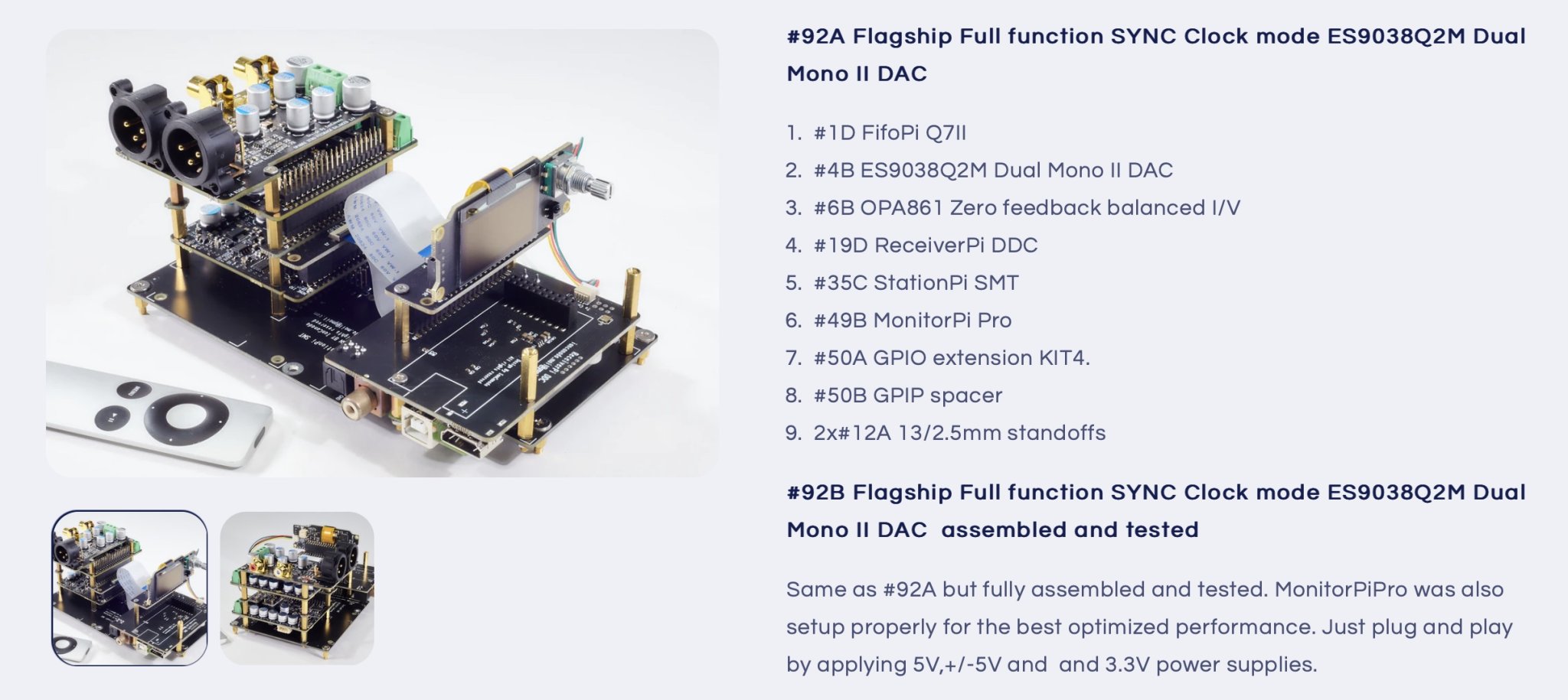

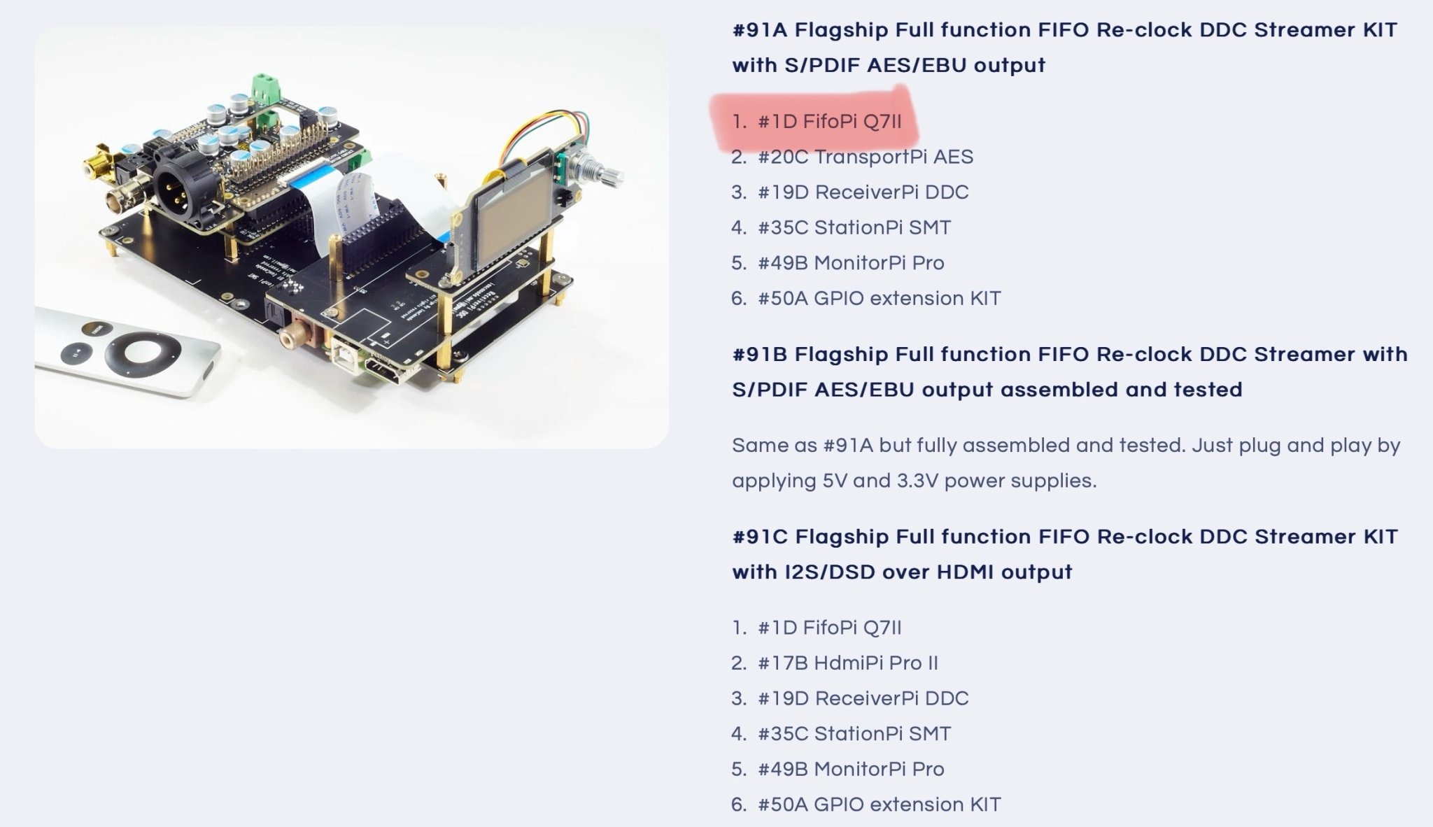

If you look @ the flagship projects, full & compact size, both Streamer and DAC use FifoPi Q7 MKII in their respective stack.@MtlJazz do you recall where you have seen FifoPi Q7 doubled in Ian's design?
https://iancanada.ca/collections/project
Cheers, Jon
@Ghostship correct, each stack comes with a single FifoPi. It seems to me @MtlJazz assumed the streamer gets connected to the DAC, each having its own Q7.

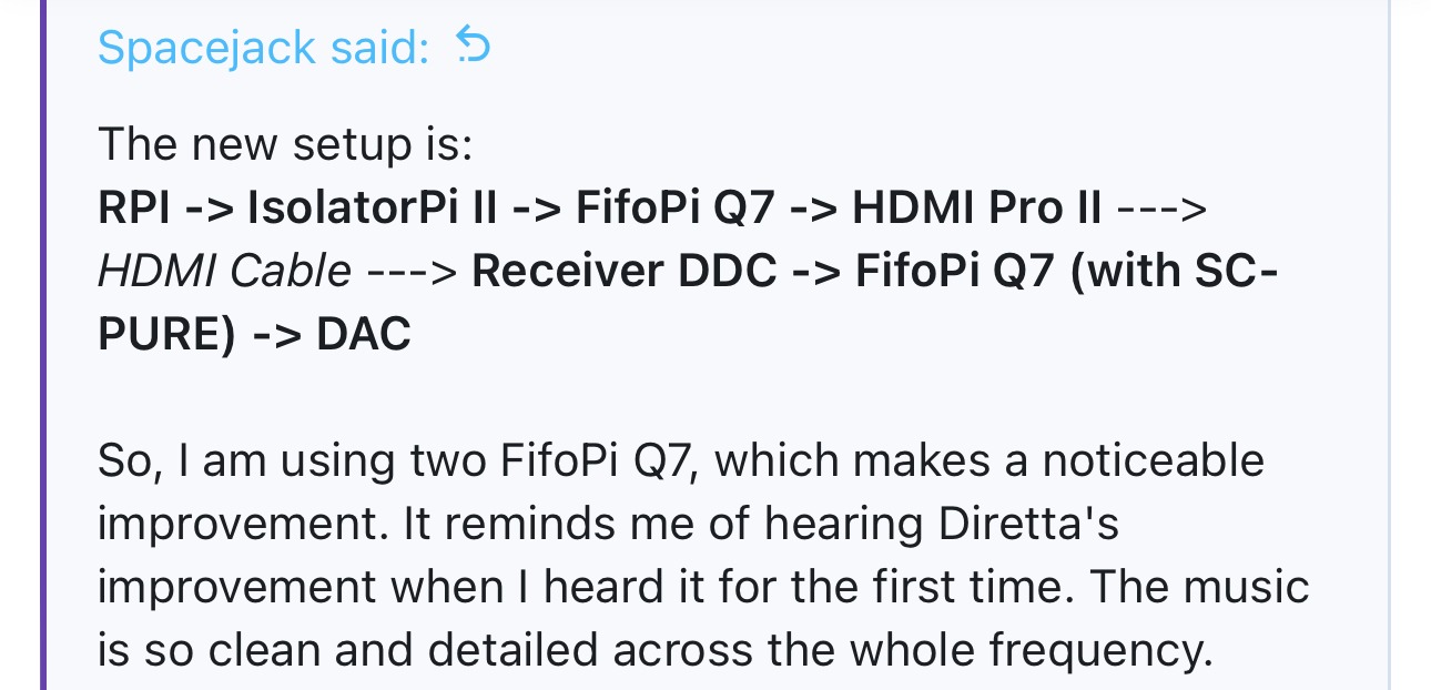

If I had to guess at the answer to why two FiFoPis sound better, it would be both the double filtering, and the clocks. I know a better clocked signal into my streamer by Ethernet achieves better sq than without (Paul Pang Quad Switch). Love to know the technical reason...
@Spacejack that's exactly what I assumed…I thought one for the streamer and one for the DAC…So both fifoPi on the streamer before the DAC? SC Pure on streamer instead of DAC?

@ qwertyl You need to download raw file using a download symbol on the top right. I just made a test, could open freshly downloaded file with latest Autodesk TrueView, Solid Edge, M4 Personal. Also opens with Inkscape.I think that something is not right with https://github.com/iancanada/Docume...MonitorPi/MonitorPiPro/MonitorpiProLayout.dxf

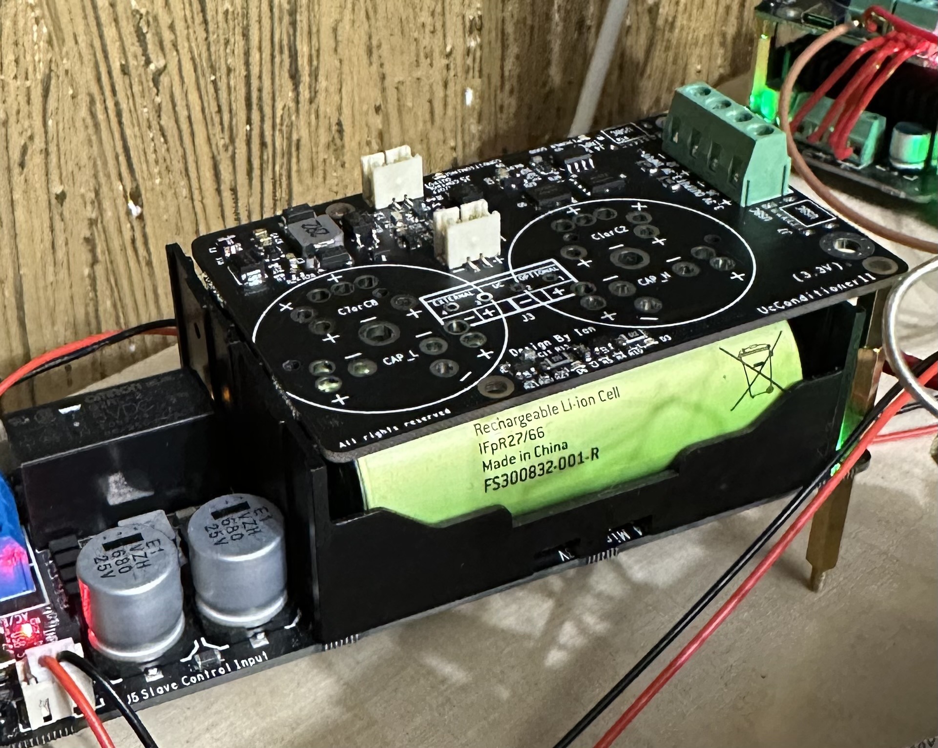

EDIT: To mount the UCCONDITIONER MKII to LifePO4 Mini, where can I find the info about the minimum spacer lenght?

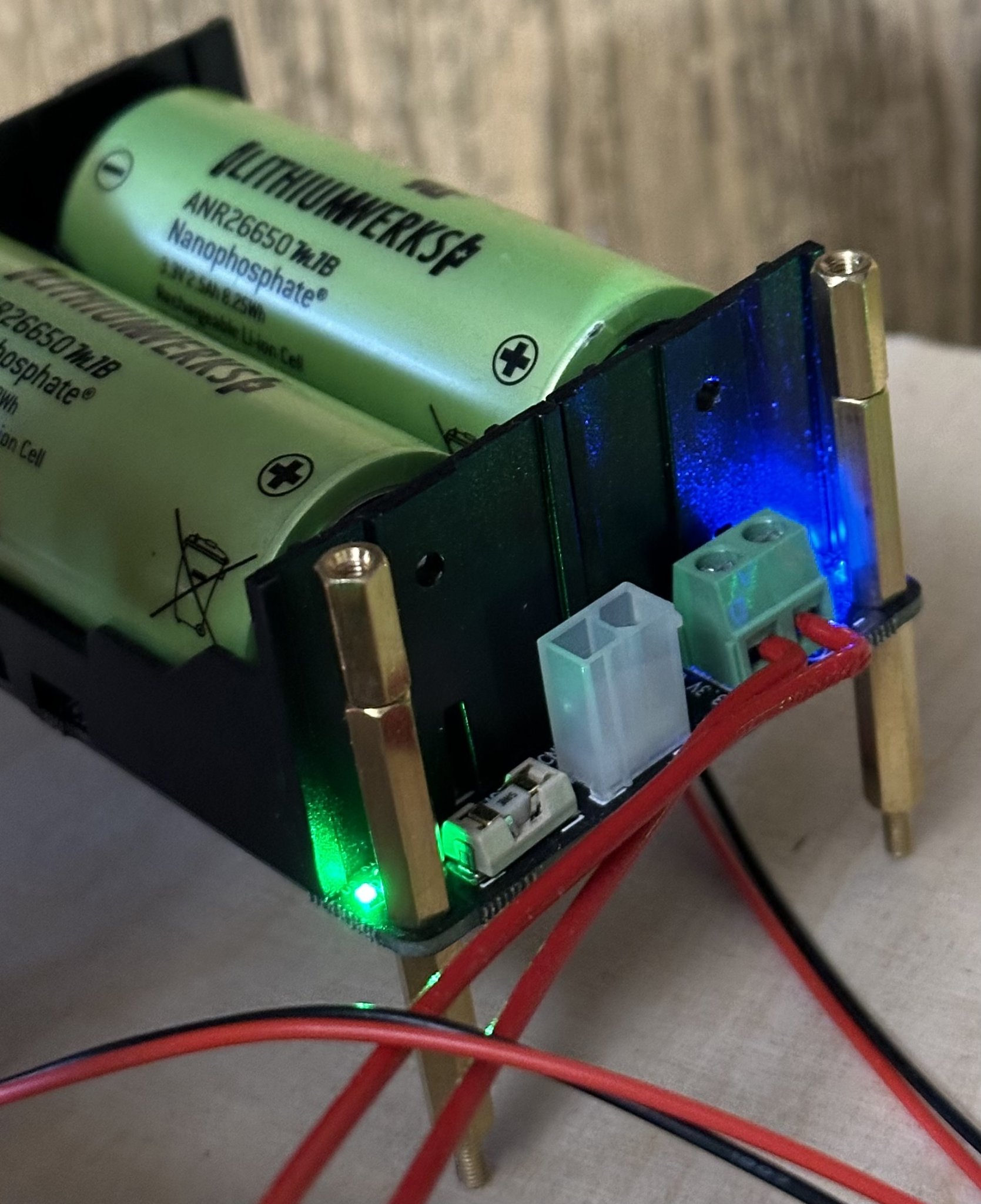

This is a bit tricky since there is no place on LifePo4 Mini to attach the rear spacers of UcConditioner. I just place there a small 5mm distance and lay the back of the UcConditioner board on the LifePo batteries.To mount the UCCONDITIONER MKII to LifePO4 Mini, where can I find the info about the minimum spacer lenght?
For the spacer at the front, I use the 3cm length.
