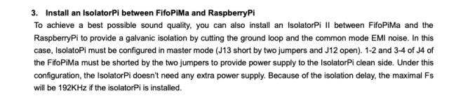

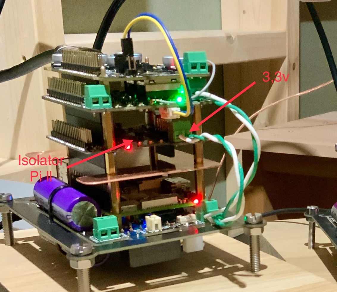

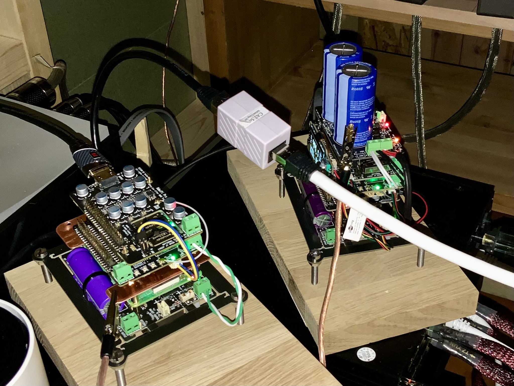

I can't get signal to DDC, When I use isolator pi ll between rpi3 and Q7. when I take it out of systems, I get signal to DDC and sound in my audio system. Is there something with the software I have to do or put it in master mode, now it is in slave mode.This used to be my setup, consisting of two stacks connected by a HDMI cable
https://www.diyaudio.com/community/attachments/_mg_2855_radiant_photo-jpeg.1246669/
Stack 1: RPI + IsolatorPi II + HDMIpi MKII
Stack 2: ReceiverPi DDC + FifoPi Q7 + DAC
I have modified Stack 1 to be RPI + IsolatorPi II + FifoPi Q7 + HDMI Pro II.
The new setup is:
RPI -> IsolatorPi II -> FifoPi Q7 -> HDMI Pro II ---> HDMI Cable ---> Receiver DDC -> FifoPi Q7 (with SC-PURE) -> DAC
So, I am using two FifoPi Q7, which makes a noticeable improvement. It reminds me of hearing Diretta's improvement when I heard it for the first time. The music is so clean and detailed across the whole frequency.
Surprising. How does doubling FifoPi Q7 in the signal path bring a noticeable improvement?
I use the same setup as you
@geiren I am a bit puzzled because I can not see IsolatorPi II on your (left side of photo) stack. Under FiFoPi Q7 there seems to be some sort of a copper shield. Do you have a better photo of this stack?
What software do you use on RaspberryPi and what signal do you try to send (bit rate, kHz), where does the music come from?
What do you mean? Which software do you relate to?Is there something with the software I have to do or put it in master mode, now it is in slave mode.

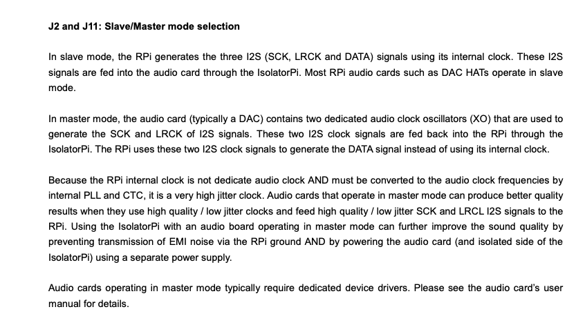

maybe this is what he meant.What do you mean? Which software do you relate to?
Makes sense. Then I run it in the Slave mode. I will double-check my Isolator Pi II configuration when I get back home.

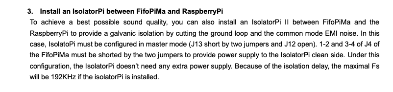

in my configuration (FifoPI MA 1.5) I get no sound isolator II in slave mode.I will double-check my Isolator Pi II configuration when I get back home.
make sure you power the isolator II correctly, in my case I power it from the raspberry pi gpio.
I don't know how this is arranged with the FifoPi Q7 because it already has a built-in isolator.
see screenshot, manual FifoPIMA 1.5.
software on rpi is ropieee xl
the music com from roon
IsolatorPll is right over the copper shield
I will try it in Master mod.
I don't see the isolator II either.What I don't see on @geiren photo is that there is any IsolatorPI but if there is one but somehow hidden, then I don't see power supply cable for it.
