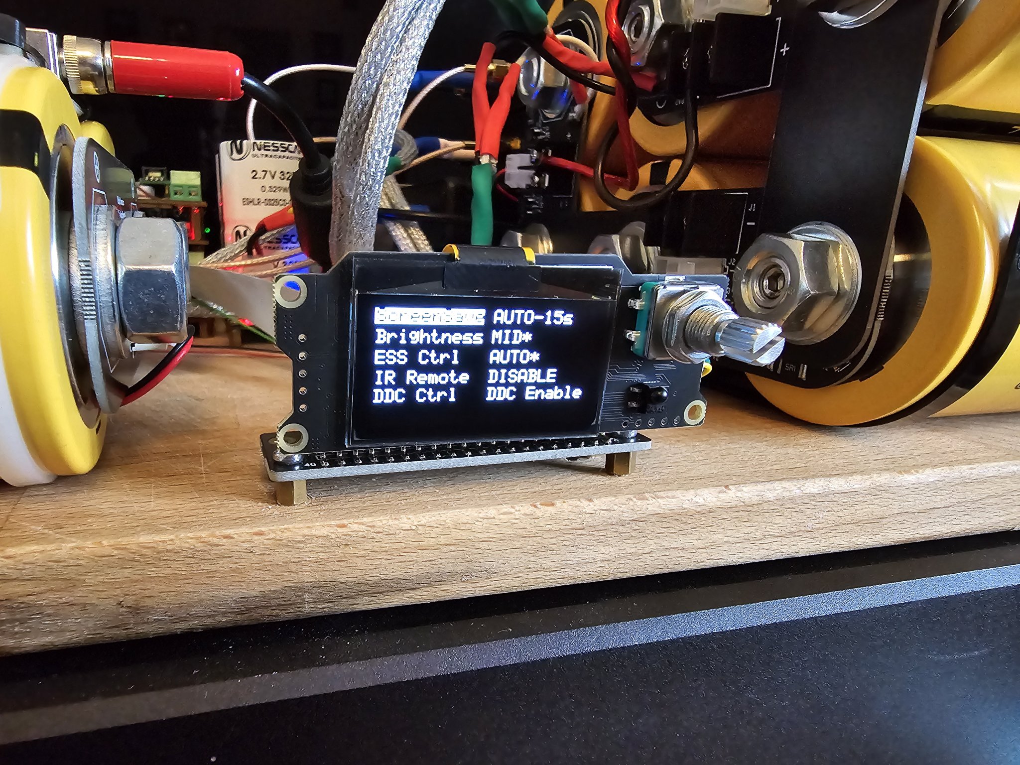

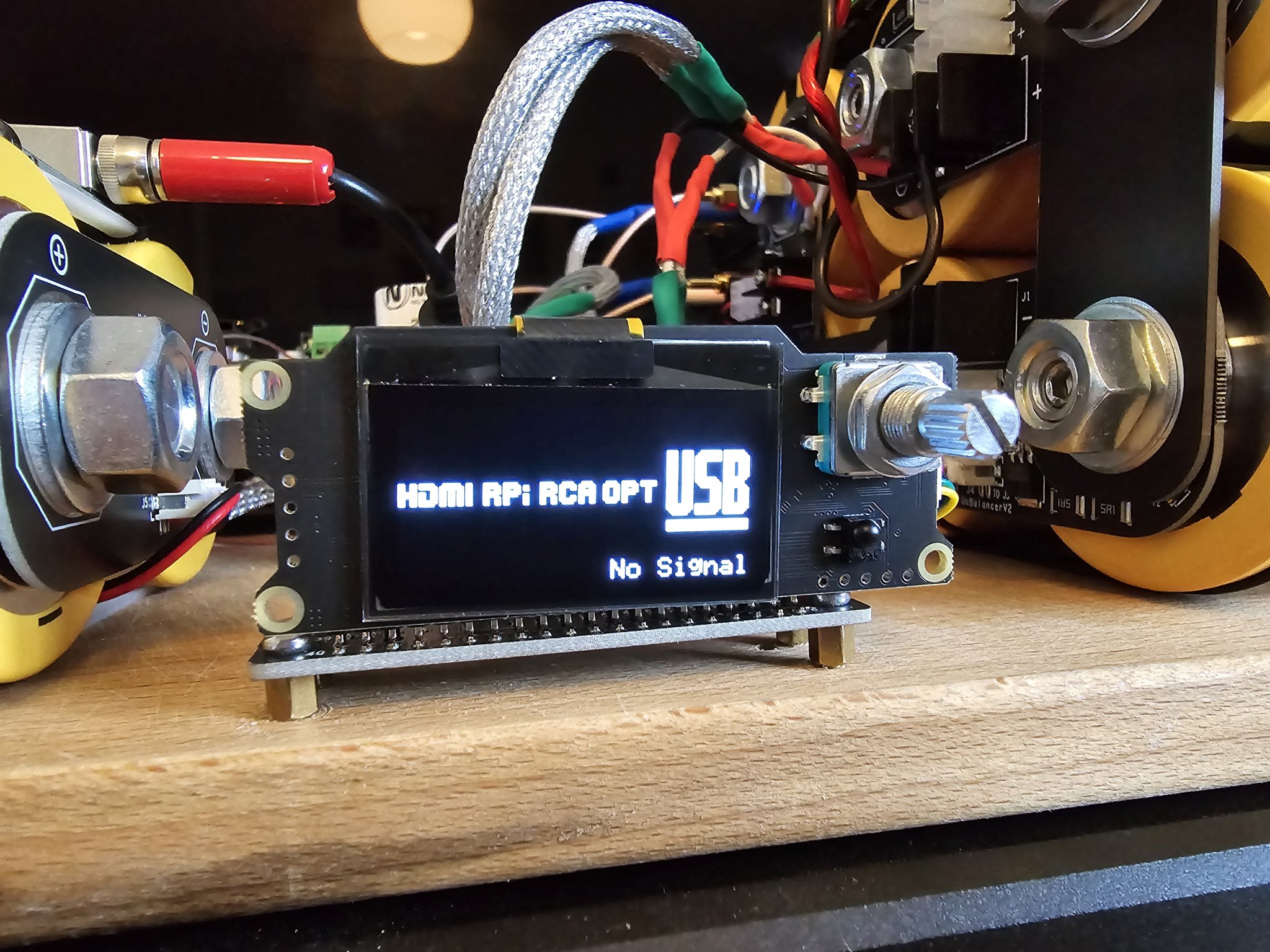

You're right. you can try my settings, all inputs are active. I don't have a Raspi at the moment, but I use WaveIO connected directly to the GPIO. works without any problem.@Cerole Thank you for your response and suggestion! Unfortunately, for me, switching to RPIFree mode only disables the selection of RPi, no USB input options appears

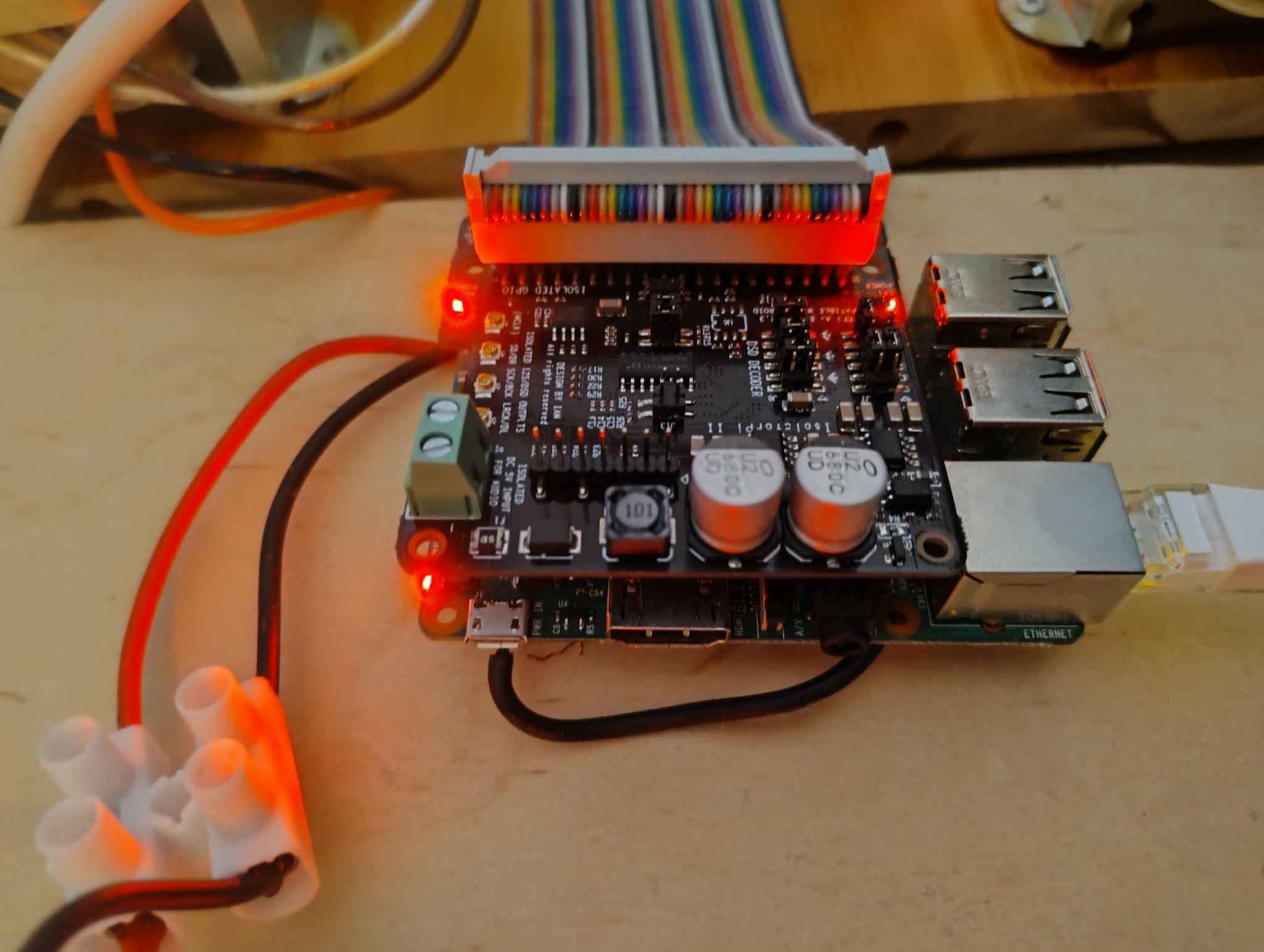

If I understand it
My Setup is RPI -> Isolator -> gpio Extensions cable -> fifopi. Advantage ist that only one Power supply is required for fifopi 5v and Isolator part. And i think in this case no additional Isolator required because the fifopi has also Isolator built in between 5v and 3.3 side. I use 5v linearpi with ucc connected at fifopi which is then shared with Isolator via gpio cable. Could you please compare your Setup with mine? So If you remove one Extension cable and one fifopi. I'm very interessted in the result.@michl2604 Thank you for the suggestion. I removed the HDMI transmitter and connected stacks through GPIO extension cables. Now it is:

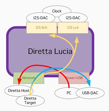

I'm still a bit of a novice in the RPi world, gradually learning the ropes. Regarding Diretta, are you implementing it with the Lucia board? I've come across the schematics on their site and wondered if it might be a suitable addition.

@MtlJazz do you recall where you have seen FifoPi Q7 doubled in Ian's design?I recall seeing Ian doubling the FifoPi Q7 in his flagship stacks. It's reassuring to know that others have observed positive results with this approach.
Regarding Diretta: I run RaspberryPi #1 with GentooPlayer and Diretta software set as Host. On RaspberryPi #2 I run Diretta software set as Target. RaspberryPi #1 can run Roon client, HQ Player NAA., UPnP. I run Roon and Audirvana on a separate PC which send music to RaspberryPi #1.
The downside of such setup is that you need GentooPlayer license for each RPi and one Diretta license for the Target RPi. Diretta Host is free. You could actually use a Windows PC to be a Host device. This would eliminate the need for the Host RPi.
I think the Isolator board shares 5V with Raspberry Pi. How do you power the RaspberryPi in your setup?My Setup is RPI -> Isolator -> gpio Extensions cable -> fifopi. Advantage ist that only one Power supply is required for fifopi 5v and Isolator part. And i think in this case no additional Isolator required because the fifopi has also Isolator built in between 5v and 3.3 side. I use 5v linearpi with ucc connected at fifopi which is then shared with Isolator via gpio cable. Could you please compare your Setup with mine? So If you remove one Extension cable and one fifopi. I'm very interessted in the result.
OK. The clean side of my Isolator is powered by 3.3V (check that with Ian if this is OK). I have the FifoPi Q7 MKII, which accepts 3.3V also on the Pi side. So basically both sides of FiFoPi and the clean side of the isolator are powered by the same power supply. Meaning my setup is a bit different. Anyway, two FiFoPi still make a difference. And I don't have an easy explanation for this.
