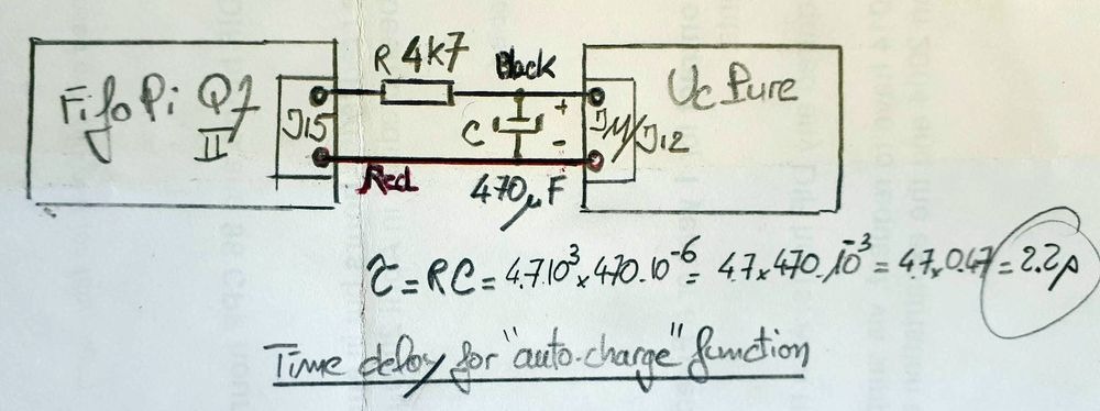

Hi everyone,
for my very first post here I'm sharing my experience with first class "Ian Canada" I2S Streamer using following main components I'm currently building :
  • RPi 3B+ mounted remotely to limit interferences with "clean cards"
  • FifoPi Q7 II
  • HdmiPi Pro II
  • UcConditioner 5V and 2x 450F for 5V supply (5V provided by external 12V acid battery regulated to 5V)
  • Uc Pure MKIII and 2x 3000F + UcBalancer for 3.3Vdc supply (supplied by a 9V 50VA toroidal transformer)
Here an overall view of my current prototype. The next step will be to mount it inside a nice aluminium case.
Everything works fine, the SQ is rich, incredibly detailed while remaining musical, with a deep and large soundstage. All in one it is a step above my already excellent Allo DigiOne Signature mounted in an USBridge module and also very cleanly supplied (even if for now I didn't try to associate it to UcConditioner and UcPure). My DAC is an Audiogd R-27 RE (with a compatible I2S input of course :)) which I am also particularly satisfied with.
Improving of the automatic super-capacitor charging feature while not playing :
FifoPi Q7 II can be easily connected to Uc Pure to release an automatic super-capacitor charging feature when stopping / pausing playback, allowing to reduce the charging need while playing (anyway only 3-4 minutes taking). In practice I observed this feature being too reactive, double triggering for less than a second (causing relay noise and increasing its wear) when jumping from one track to another or while file resolution changes within a continuous PL.
Anyway FYI by "test and try" I succeeded to solve this by introducing an "analogic" delay in inserting a "2 sec" RC temporization circuit between FifoPi Q7 and Uc Pure as detailed in the attached scheme + picture of its practical implementation. Using the delivered cable I had just to be careful that the + pole (3V3 level) is on the black wire, 0V on red as the 470 µF cap is polarized :)
Now no longer short-time double switching when jumping from one track to another or while file resolution changes within a continuous PL as observed before. When stopping playback the charge is started with approx. 1.5s delay but pure mode reactivated when playing again without significant additional delay.
I Hope this may be of help. Any questions, let me know.
Enjoy the music !
Stéphane

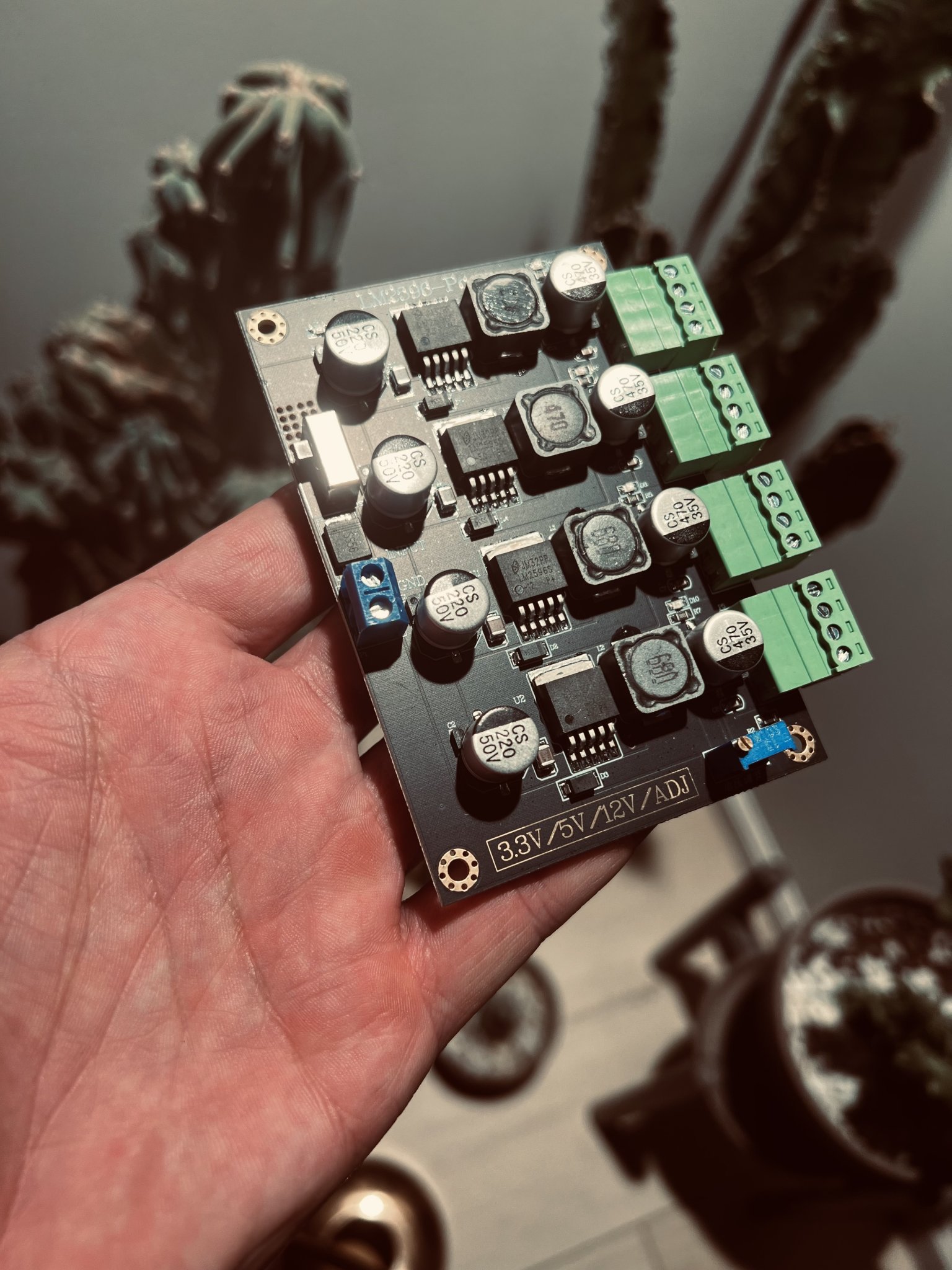

Just wanted to share this little guy that showed up today.
I shared a link on the last page.
Takes a 32v 5a DC and splits it into 2x3.3v, 2x5v, 2x12v, 2x adjustable
No measurable ripple current.
Very well made
Take a 32v 5a power brick and feed 6 UcConditioners or UcPures
