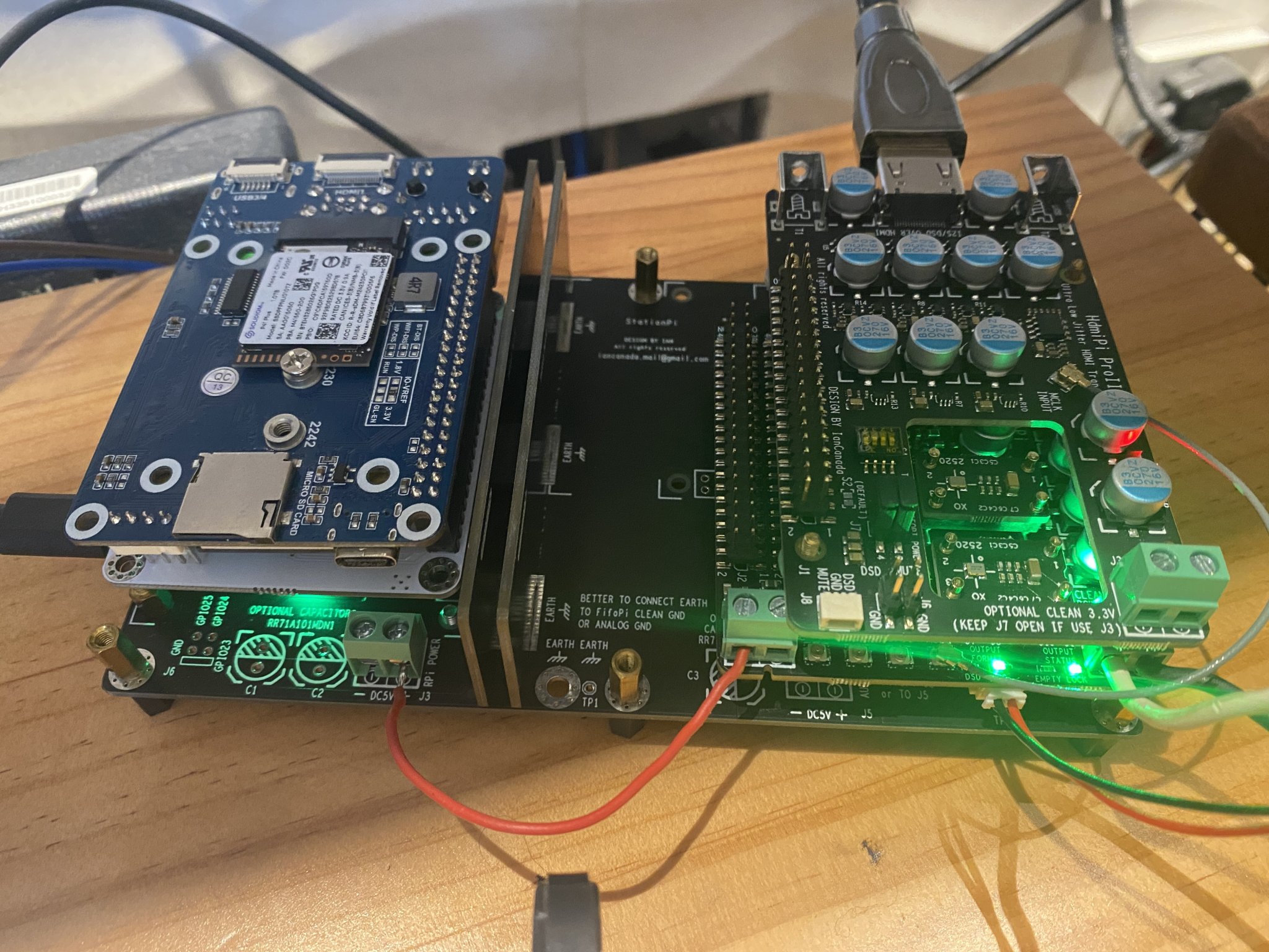

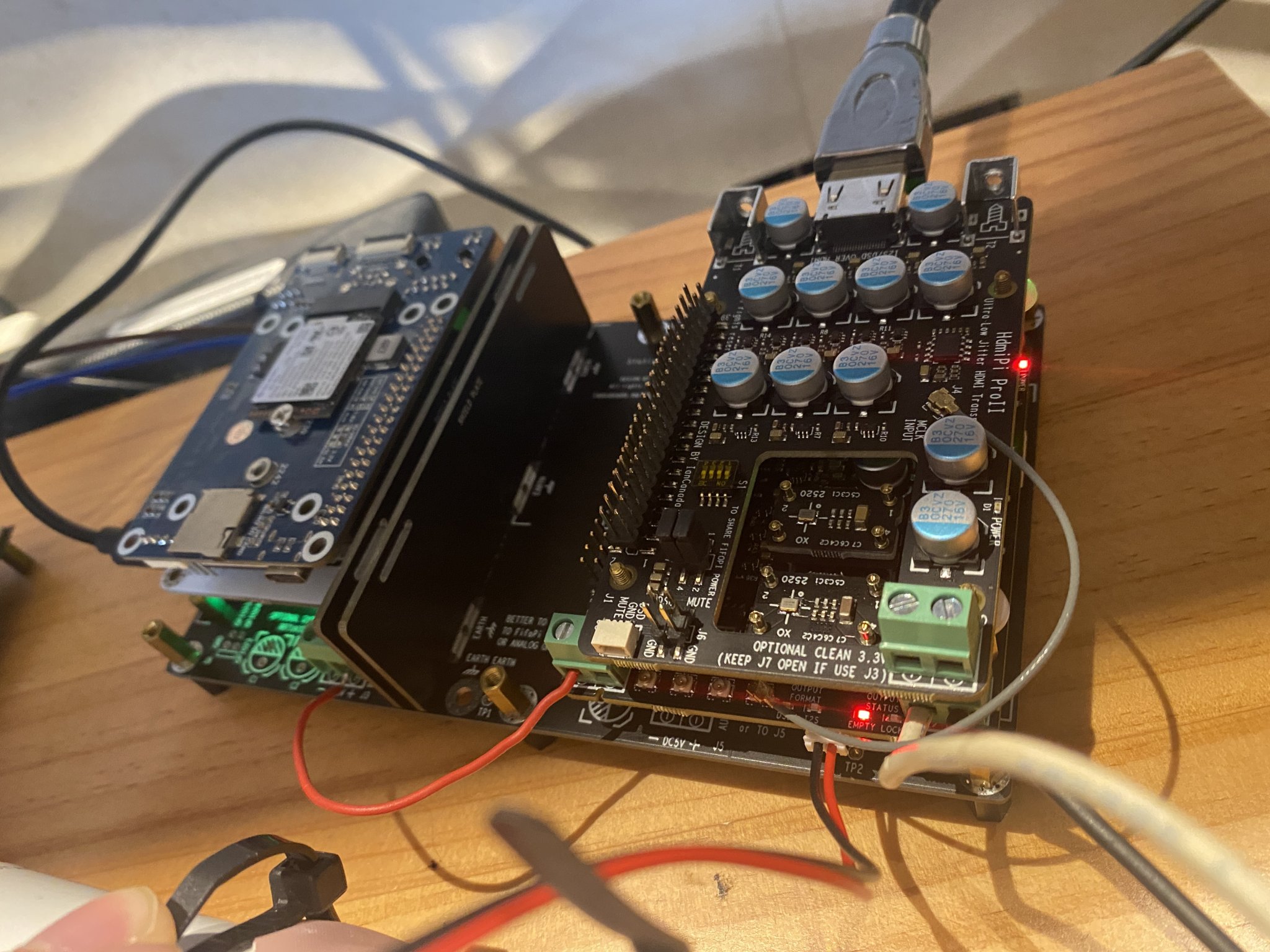

Please remove the FifoPi and install a MonitorPi or pro to the position of a FifoPi was installed.
Please music to see what's showing on the OLED screen.
Ian
Hi Ian
I don’t have monitorPi. But I resolved the problem.
I use super-cap supply hat to power raspberry cm4. Ucpure to power Fifopi 3.3v.
I found fifopi needs dirty side 5v to “wake up”. In this state, the led “empty” will lit first. Then power 3.3v as usually. If not doing this, the i2s signal does not work in this stationpi.
I know it is not proper ways but it works flawlessly now.
