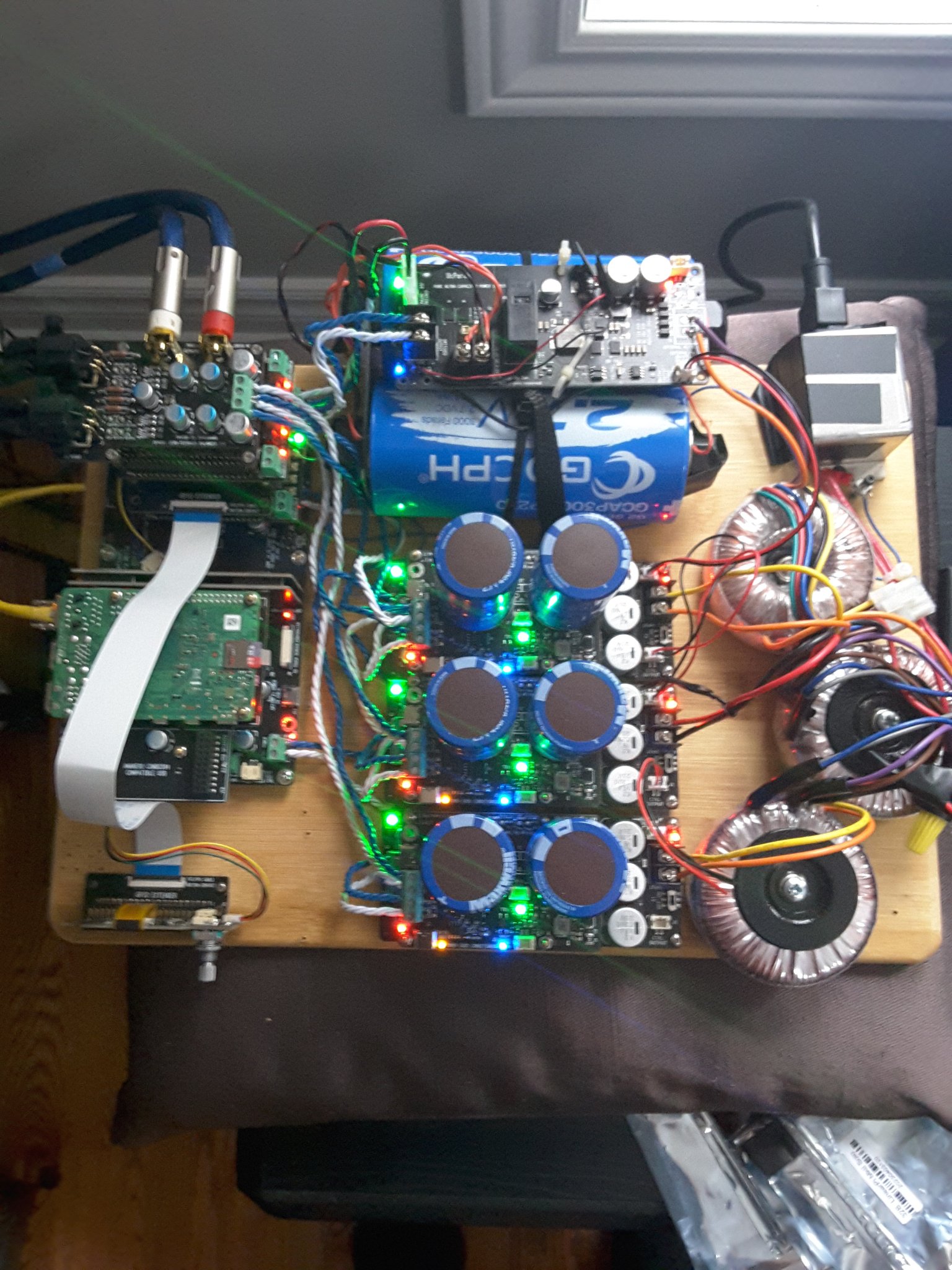

If all the measurement equipment that was used to develop your gear was inside a metal enclosure it would be strange not to use something similar for your build.
I see some of your wires from supllies to circuits are rather long . Twisting ac wires from your transformer could also help.
If ucpure is the most important supply, that should be the one closest to the " consumer"
It should be possible to create a kind of platform above the big caps that will allow you to create much shorter lengths for the power supply connections.

Like @eduard mentions .. tiwsted wires are good but looking at the picture again ..
You use twisted wires for individual + and - lines but you did not twist the + and - together .. that makes a difference too.

Hi Martin,
well at first glance your build looked quite reasonable, until I noticed that you're operating it on a PILLOW?? Of course it would sound uninteresting, no matter how many / how big capacitors you throw at it.
It's pitiful to see so many very handy and skilled DIYers putting this much effort (and money), just then to absolutely neglect (ruin) one of the primary domains of any component, which is its resonance control. Why do you all think there is big part of the whole hifi industry dedicated to component feet, pads and other resonance controlling parts? That it all must be just a snake oil, worthy of ignoring it altogether? None of you were even remotely interested, what could some $1-3-5k spikes/pads bring into the mix? Or how it is possible that they sell for these kind of prices? I'm not justifying some outrageous prices, which are clearly a rip-off, but if so many people hear their contributions worthy of such a price tag, then it must be something in it, or not?
And meanwhile, it could be such a >LOW< hanging fruit (financially speaking) to get things right, at least to 60-70% of the max possible benefit. Some decent spikes/pads are literally going for tens of $ and already make a huge difference. To get it on scale, in comparison the UcConditioner brought to the PurePi 3.3V out just negligible benefits, what could a proper resonance management bring for the PurePi-based streamer (or any other component for that matter).
Get a solid base on solid feet, put on it 4 half-decent cones and then put your build on top of it. Once you stabilize your board with these sensitive components and hear this revelatory transformation, then we can start discussing, how to improve it further. Because as I see it, no matter what anybody (or thousands of people in forums, reviews, articles...) tells to a person, he/she will start doing things differently only after they experience it themselves.

I saw in the test set up photo that the cinch output are being used. If i remember right the manual states they are only there for test purposes.
Of course using boards from different suppliers in the " wrong mix " will probably give you mediocre sound.
In the past i recommend Tent shunt boards to people who want to create a very good supply in a limited place. Using a few individual power supplies all having the seize of a mini shoebox would probably require local decoupling at the " consuming boards" too. Being told that power supply is crucial one should execute them properly as well. Like the small supercaps should be soldered close to perfect at least.

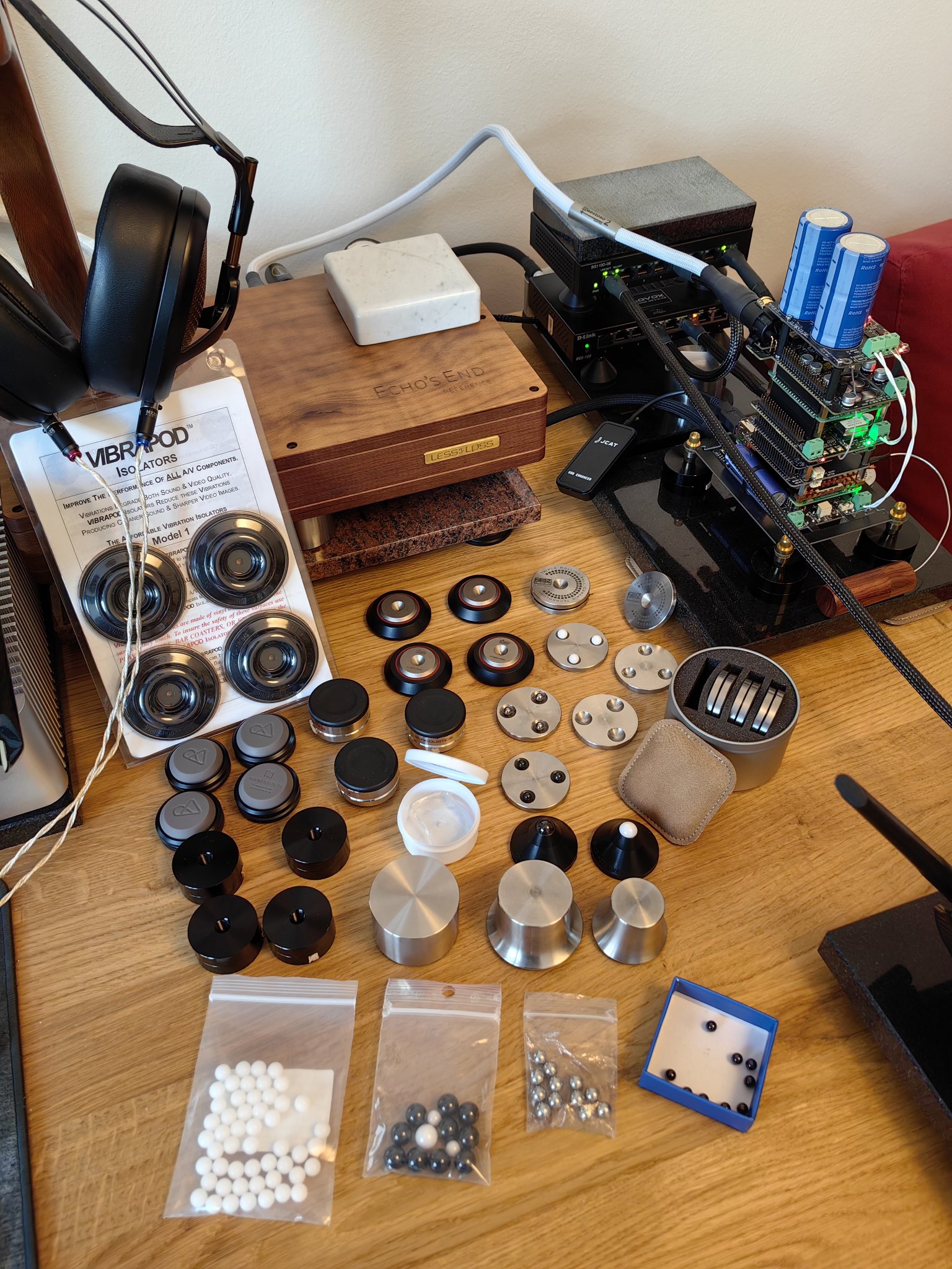

This is most of the materials I tried ONLY for the streamer. And there are other 18 devices & cables in my chain, where I implemented effective resonance control with different materials/components.

Please feel free to share your thoughts and discoveries regarding resonance control.
It's something that I'm just starting to turn my thoughts to so some pointers would be much appreciated.
Hi Wladimir
Those are some very interesting observations and must have involved a lot of listening test with that many different types of feet🙂
Where did you gain the best improvement in SQ for a DAC/Streamer? Coupled or de-coupled feet?
BTW: You system looks really good 🙂
Regards Mikkel
Reactions: 1 user

@Martin923 I also have experience with Ares II, and it was way inferior to Ian Canada stack. I run a similar setup to yours with UcPure, SC-Pure, Dual Mono Dac and OPA board. Something seems really wrong.
1. First thing do not use the single-ended outputs as they are not meant for high-quality audio, which is clearly stated in the manual.
2. Did you configure the Dac board according to the instructions in the manual in the section "How to produce the best sound quality from your ES9038Q2M Dual Mono II DAC"?
3. The power supply wires from UcConditioner power supplies to the OPA board are quite long which may reduce the benefit of using UcCondi. They also run very close to the RaspberryPi which is the source of a lot of noise, and these cables probably act as good antennas. Try to reposition the power supplies for OPA much closer to the OPA board, far away from RaspberryPi, and make these cables shorter.
4. Vibration isolation is something I suggest you take care of before you do any serious listening. One thing is the pillow but another one is damping the SC-Pure clocks. You will find my comments about it in one of my earlier posts. Others wrote about it too. Just try it and share your experience.
5. How did you arrange the grounding of StationPi and RaspberryPi?
Good luck!
