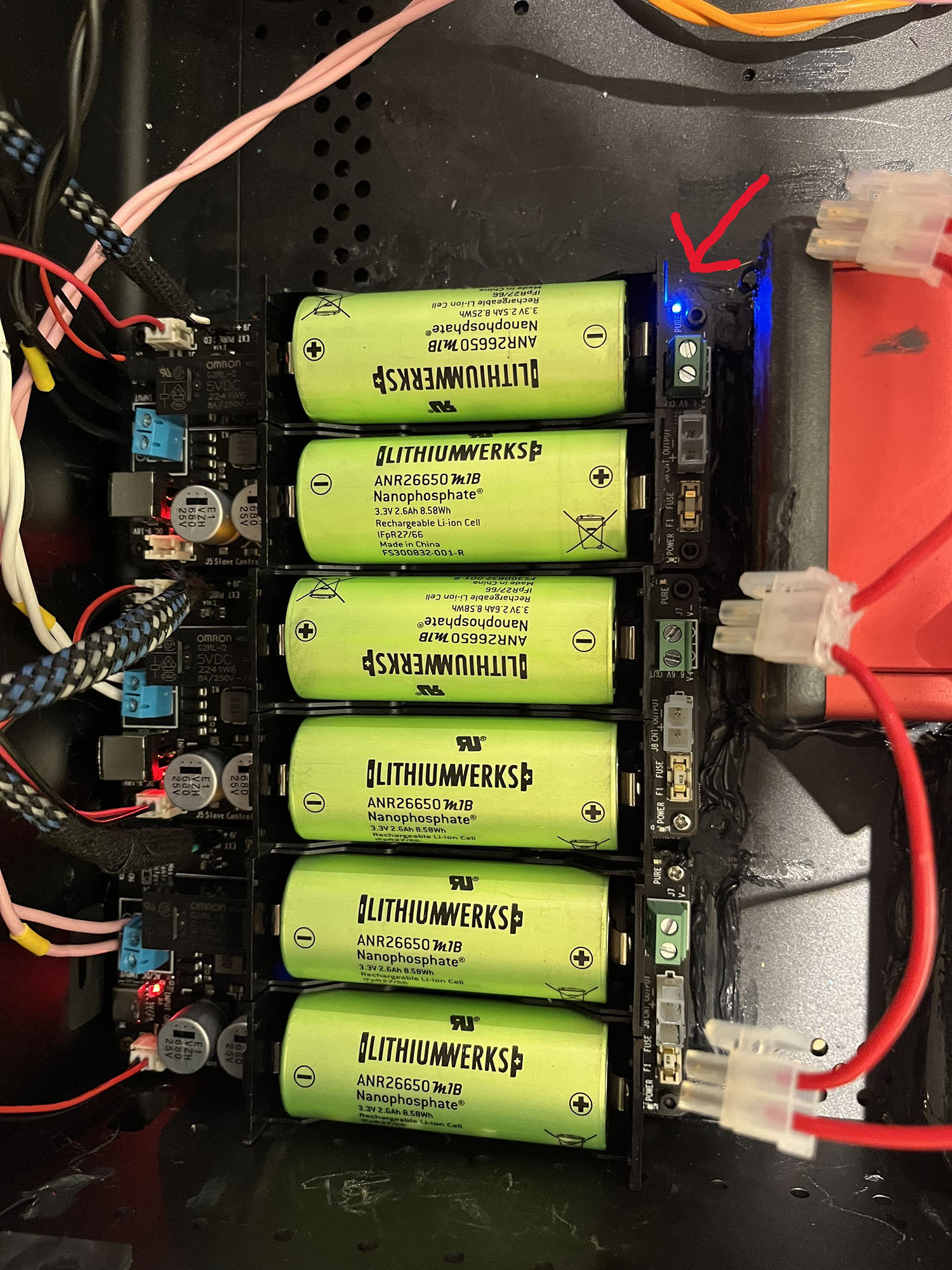

Hi Ian, Hi folks,
I have a new little problem with a lifePO4mini 6.6v.
One of my 3 lifePO4mini Pure LED D10 light stays on when master switch is off.
(When switch is on, LED D10 and LED D9 are light on and output power.)
Do you know what can be the cause?
Thank you for your help.
Terry

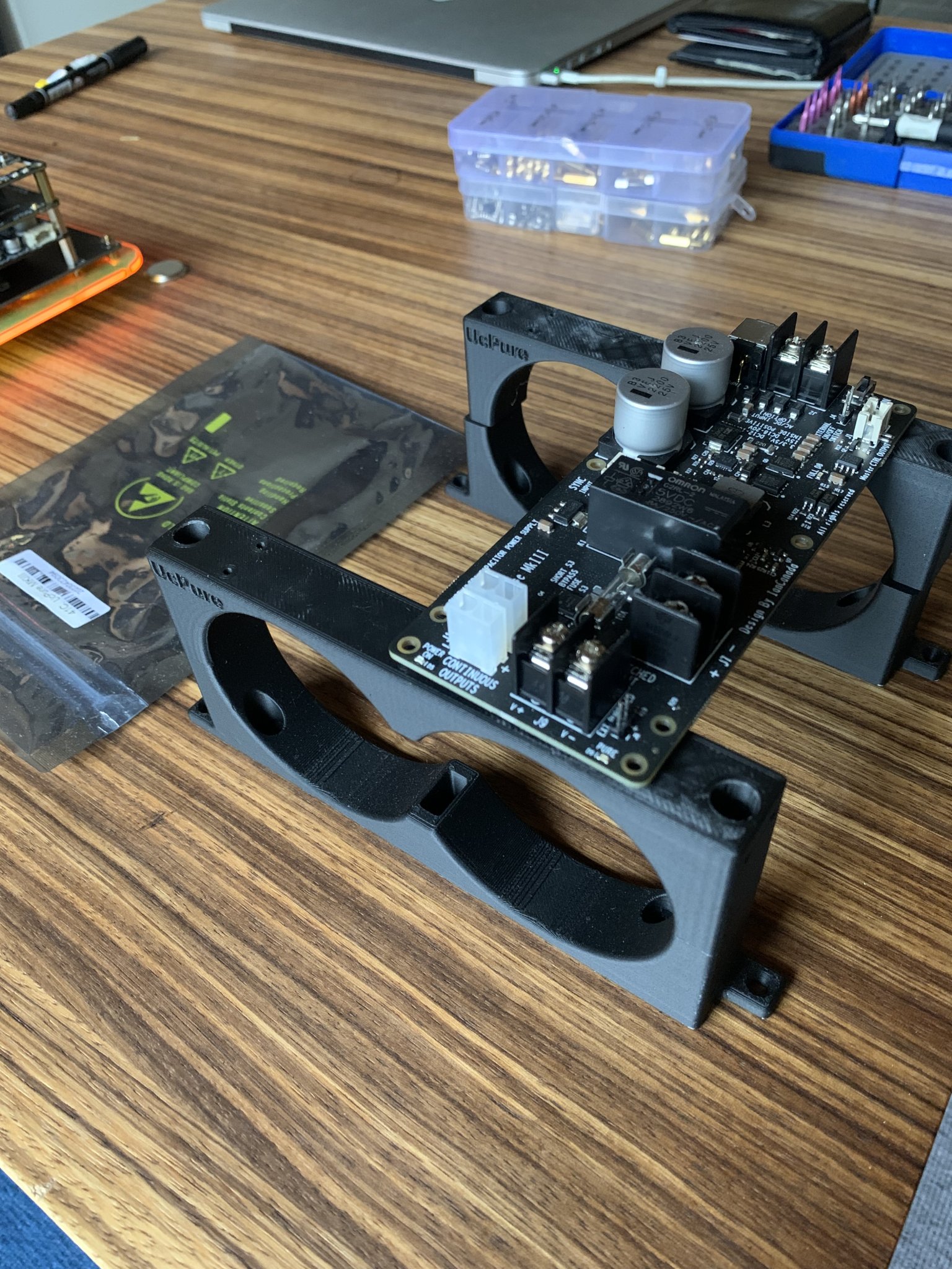

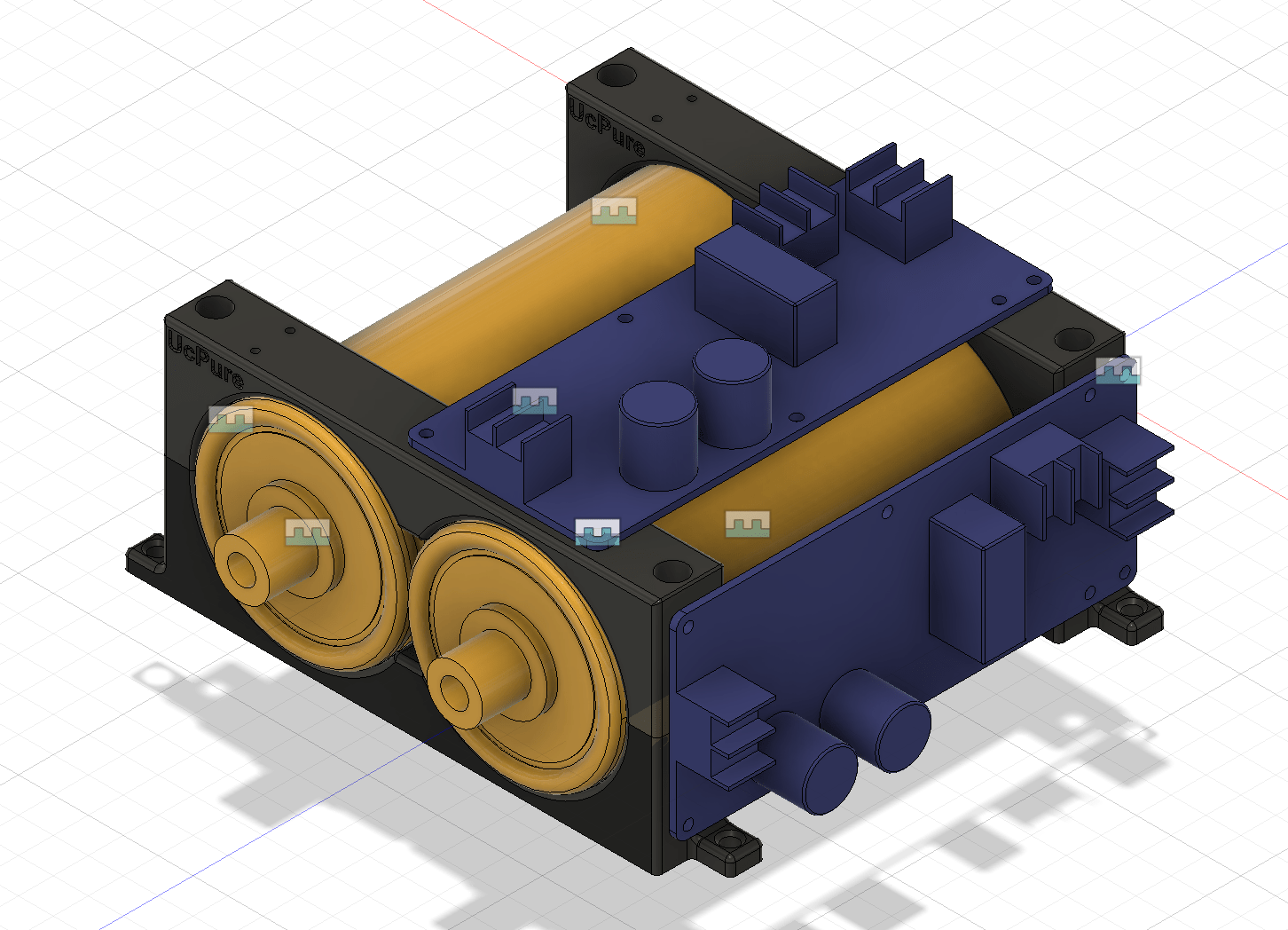

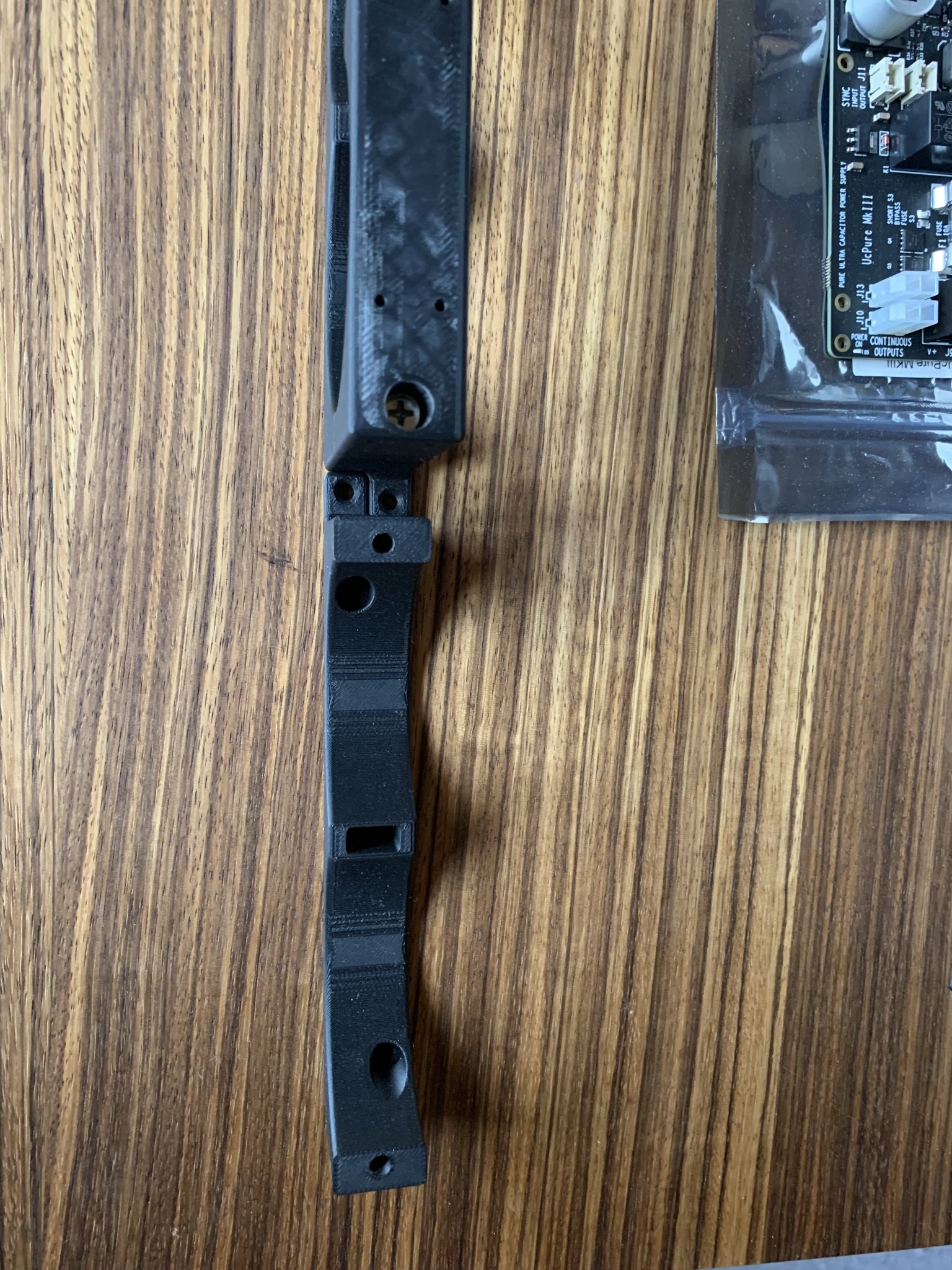

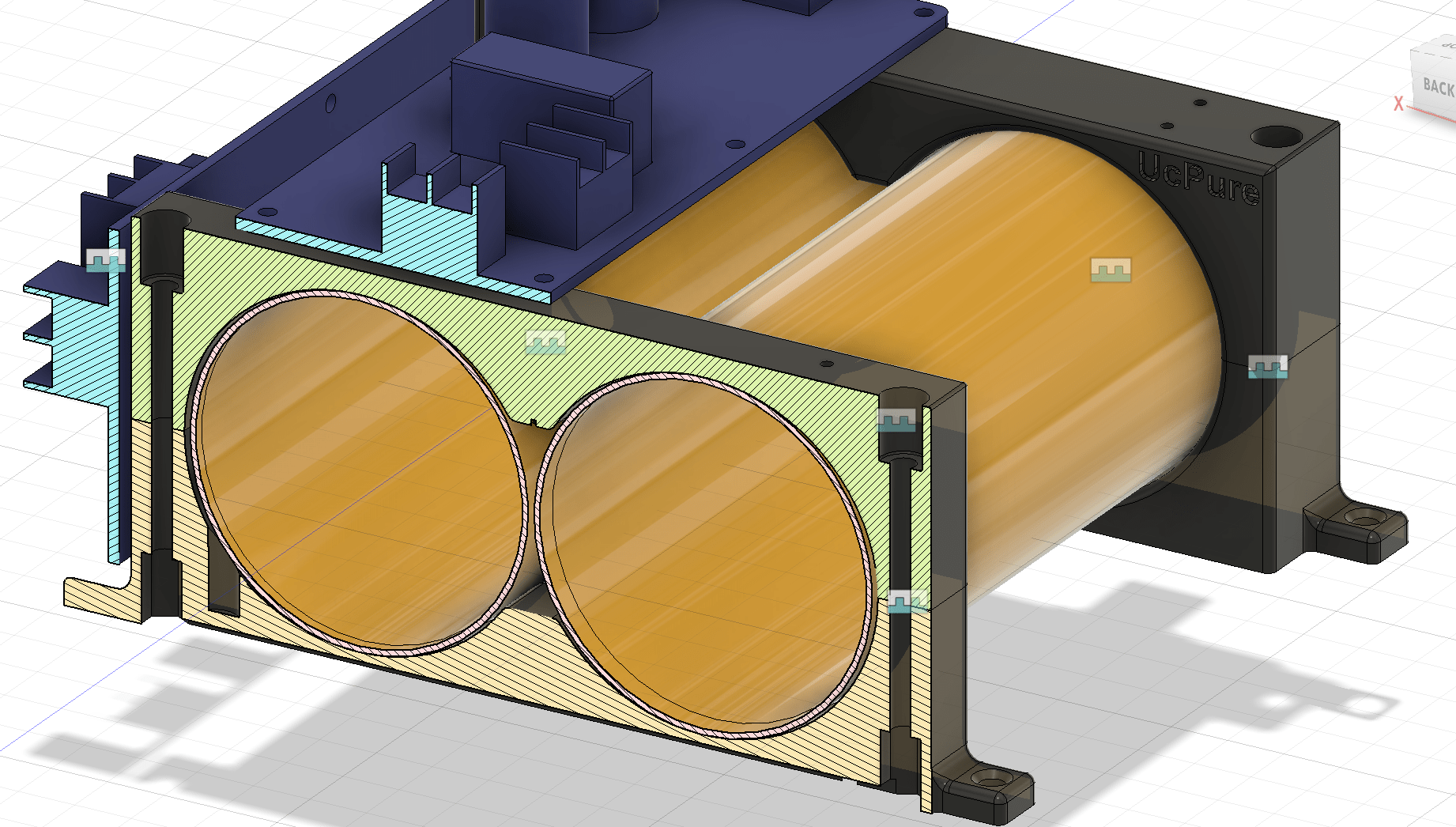

Here is the first prototype om my design for a 3D printable UcPure holder. Already made some small adjustment to this prototype. Still waiting for the super caps to see everything fits together.
The PCB can be fitted in two postions at the top or at one side. Bottom part can also be used alone using a zip tie, where a slot is located at the underside. The holders can be fitted at the two flanges or at the screw holes in the curvatures. The left and right holders are interchangeable. Designed to fit Ø60-61,5 mm caps using either Ian UcBalancer (pitch of 61mm) or the universal print from eBay/aliexpress (pitch of 61,5mm). The holders are clamped together with M4x50 bolts and hexagonal holes at the bottom to press fit nuts into. Spacers of ~2mm hight between the PCB and holder is recommended.
I could make some spacers printet to the holder that can be cut off using a sidecutter. Any thought?
I will upload some pictures when the product is fully finished and tested with some super caps.
I will share the design if someone is interested, but only if you agreed to use it for DIY purpose only 🙂
Hello,
Once you started to do it the right way you could as well get the piece bolted to the chassis so it will also make the bottom plate more rigid.
Of course can add some foam between your design and the bottom plate to reduce vibration into the caps. Don't know if the caps are that sensitive.
Usually these caps can be interchanged brand to brand so dimensions should be identical. But it would be strange if they just not fit. Maybe wrap them with a single layer of foam.
If the material is cheap you could change the two lower parts into one bigger part.
Greetings Eduard
Greetings Eduard

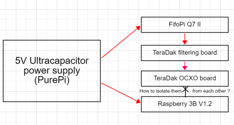

Hey guys, I'm looking for some creativity idea. I'm building an "evo" version of my PurePi streamer-stack with intention to incorporate an OCXO clock also for the RPi itself. For this purpose, I've ordered an OCXO on a separate board, needing just a 5V power supply, supplied either directly from a DC connector or via GPIO pins.
My primary idea is to power the OCXO board through the GPIO pin from the the top side, so not to be fed from the RPi directly, because according to the manufacturer, it would not even work (OCXO needs a warm-up time, before it's able to send a clock output to the RPi, so I guess the non-functionality comes from the fact that RPi won't even start and pass the 5V without it).
For the 5V input, I would use the optional 5V out from the PurePi. But here's a catch - if I feed the OCXO with it and put the OCXO above the RPi, it would also pass the power down to the RPi, so there would be a collision of 5V from the two sides, therefore I need to isolate them from each other. The question is - how to do it elegantly? Here's a diagram of my planned disposition, but I'm open to alternatives:
So far my only ideas are cutting the 5V GPIO pins of the RPI (or optionally of ShieldPi) or putting an Isolator between them. But would like to avoid the Isolator. Any better/smarter ideas are most welcomed 🙂

Thanks for your suggestion, unfortu that would bring new issues, for example excessively long connecting cable to the OCXO and possibly resulting impedance mismatch. And perhaps even more importantly, it took me around 1 year to perfect the resonance characteristic of this PurePi build, incorporating Zirconium dioxide, smoky quartz crystal, weight-calculated pads and others. Using a new platform would of course mean doing the whole exhausting process again, so I'm planning to release my first ultra-tweaked streamer as Pure-Pi based.@WladimirMXP
Wouldn’t a StationPi pro do what you need?
The next-gen streamer will be a completely different architecture, but that will be for release in '25 or perhaps even '26 till I perfect every nuance of it.

You could use longer bolts and the discard the press fitted nuts at the bottom part.Hello,
Greetings Eduard

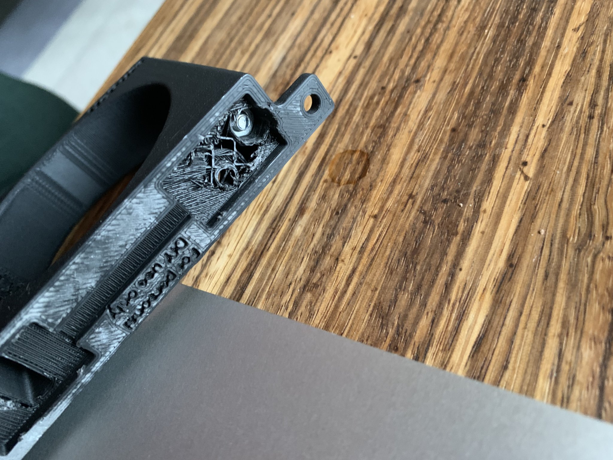

I would't do this way because this will require some post assembly of the whole UcPure pack inside an enclosure. By using the flanges you can safely assemble the entire UcPure pack at a work table and then bolt it to your chassis. The whole pack is less than 1,5kg everthing put together. Using 4 x M4 bolt at the flanges would be more than enough for a rigid fix of the UcPure pack.
Looking for more rigidity? You could just use 3 pairs of holders 🙂
Good idea regarding the foam, but as you I don't know of the sensitivity to these caps. I thought of Sorbothane foam or similar.
My first design had 3 cavaties at the bottom part to hold some damping material, but I was not happy with the supporting material used once 3D printed. Instead the holders a slightly wider for a bigger base.
Regards Mikkel

Hello,
I know the French have done some test regarding vibrations and capacitors. But supercaps is a new technology that could be less or more sensible to vibrations.
Just adding some kind of foam would not hurt.
It will always be a mix. If you will use 3 supports mounted on a piece of foam it will add some dampening and rigidity as well. You dont want to put any physical pressure on the ucpure boards and introduce a crack on a solder joint or track.
Usually people tighten the bolds way to much on electronics. They use the same screwdriver like the one they use to attach a big mirror in their hallway. Ikea will usually provide you with tiny tools because with " real tools" you would end up with splitting panels.
Greetings Eduard
