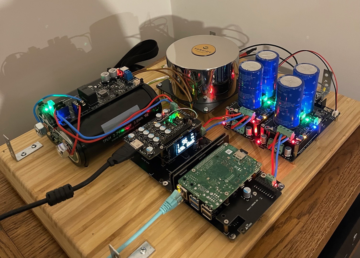

I need some help for debugging the issue appears after I made some changes.
Until couple weeks this was my transport build based on Ian modules:
Recently I made this changes:
On my initial build, the pure time was about 3 hours, but after I made the changes there's only 1 hour of pure time and sometimes when
changing from "pure output mode" to "protection mode" I have short audible interrupts on music played.
I am thinking this is not a normal behavior and I would need some advice what could I try or measure to figure out what's wrong. I wouldn't buy boards just to verify what's wrong.
My first thought is maybe something wrong with UcBalancer or with UcPure...
I just added a photo of my initial build.
Thanks!
- StationPiPro
- Dual LinearPi (mk1) + 2 x UcConditioner 5V - feeding RPi and dirty side of FifoQ7
- 1 x UcPure (mk1) + 2 x 2.7V/3000F capacitors (TPLH-2R7/3000SL60X138) + Aliexpress balancer feeding clean side of:
- FifoPiQ7 (mk1) - stock clocks
- HDMIPiPro (mk1)
- TransportPiAES
- MonitorPi
- Toroidy transformer
- secondary1 6V / 3A
- secondary2 6V / 3A
- secondary3 6V / 5A (not used)
- secondary4 12V / 4A
- stock clocks --> SC-PURE clocks
- Aliexpress balancer --> UcBalancer (I discharged the big caps before installing UcBalancer)
- MonitorPi --> MonitorPiPro with GPIO extender
- added ReceiverPiPro mk2
Thanks!

Hello CRM,
I dont have manuals on my phone but one hour seems rather short. I think those expensive clocks need more current but still.
By the way running the output wires of the ucpure so close to the power transformer does not look good.
Greetings, Eduard
Greetings, Eduard
When reading about your updates my first thought was the same as you regarding the UcBalncer.I need some help for debugging the issue appears after I made some changes.

Are the voltage across each of the super capacitor the same?

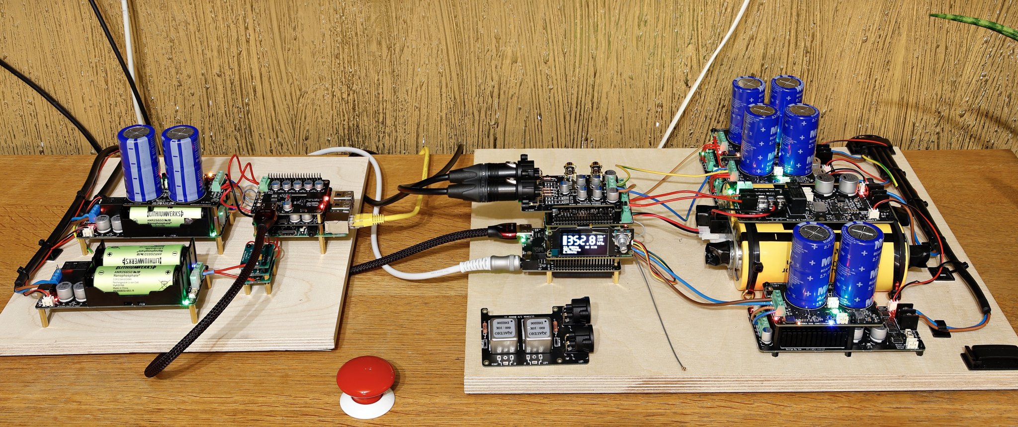

This used to be my setup, consisting of two stacks connected by a HDMI cable
https://www.diyaudio.com/community/attachments/_mg_2855_radiant_photo-jpeg.1246669/
Stack 1: RPI + IsolatorPi II + HDMIpi MKII
Stack 2: ReceiverPi DDC + FifoPi Q7 + DAC
I have modified Stack 1 to be RPI + IsolatorPi II + FifoPi Q7 + HDMI Pro II.
The new setup is:
RPI -> IsolatorPi II -> FifoPi Q7 -> HDMI Pro II ---> HDMI Cable ---> Receiver DDC -> FifoPi Q7 (with SC-PURE) -> DAC
So, I am using two FifoPi Q7, which makes a noticeable improvement. It reminds me of hearing Diretta's improvement when I heard it for the first time. The music is so clean and detailed across the whole frequency.
Surprising. How does doubling FifoPi Q7 in the signal path bring a noticeable improvement?

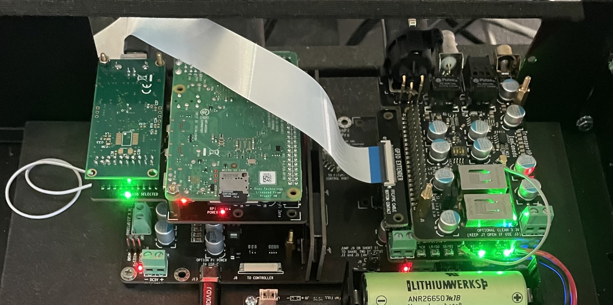

I found a similar positive effect but by removing things. Started with RPI -> Isolator -> HDMI Transmitter -> Receiver dcc -> fifopi ...
Then removed HDMI Transmitter and Receiver DCC. I just use a gpio extender instead to get some room between RPI and fifopi because of EMI. Sound is cleaner in this Setup. Like I know it from jitter improvements. But i don't get it. Input should not have no Impact when fifopi follows. And also in your case, why two fifopi are better than one?

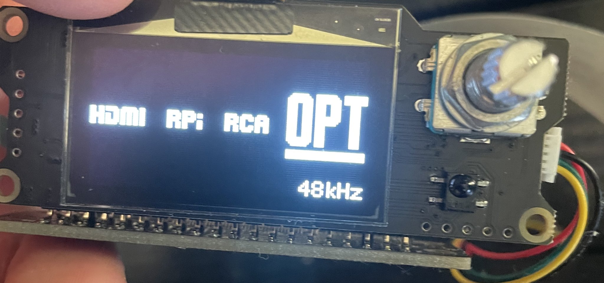

Anyone here with a suggestion how to debug / fix the following?
I have the StationPi Pro Universal Multi-inputs Digital Audio FIFO Re-Clock Platform Bought/build as separate components, a stationpi pro, a receiverpi pro II, a monitorpi pro and Amanero usb (bought from audiophonics). With Fifopi Q7, sc pure clocks and TransportPiAES out. The setup works like a charm for rpi and optical input. However, I do not see USB as an input option on the Monitorpi pro (see attachment)
I have DDC control setting of the monitorpi set to RCP enable. Pin 3 and 7 of J14 of the stationpi pro shorted, in line with application note 2.
The usb input led is on (see attachment) when the selected input is optical, so it might be I misplaced a jumper or missed a step in the documentation. But I am unable to figure out what I did wrong. The software version of the monitorpi pro is 2.5.
