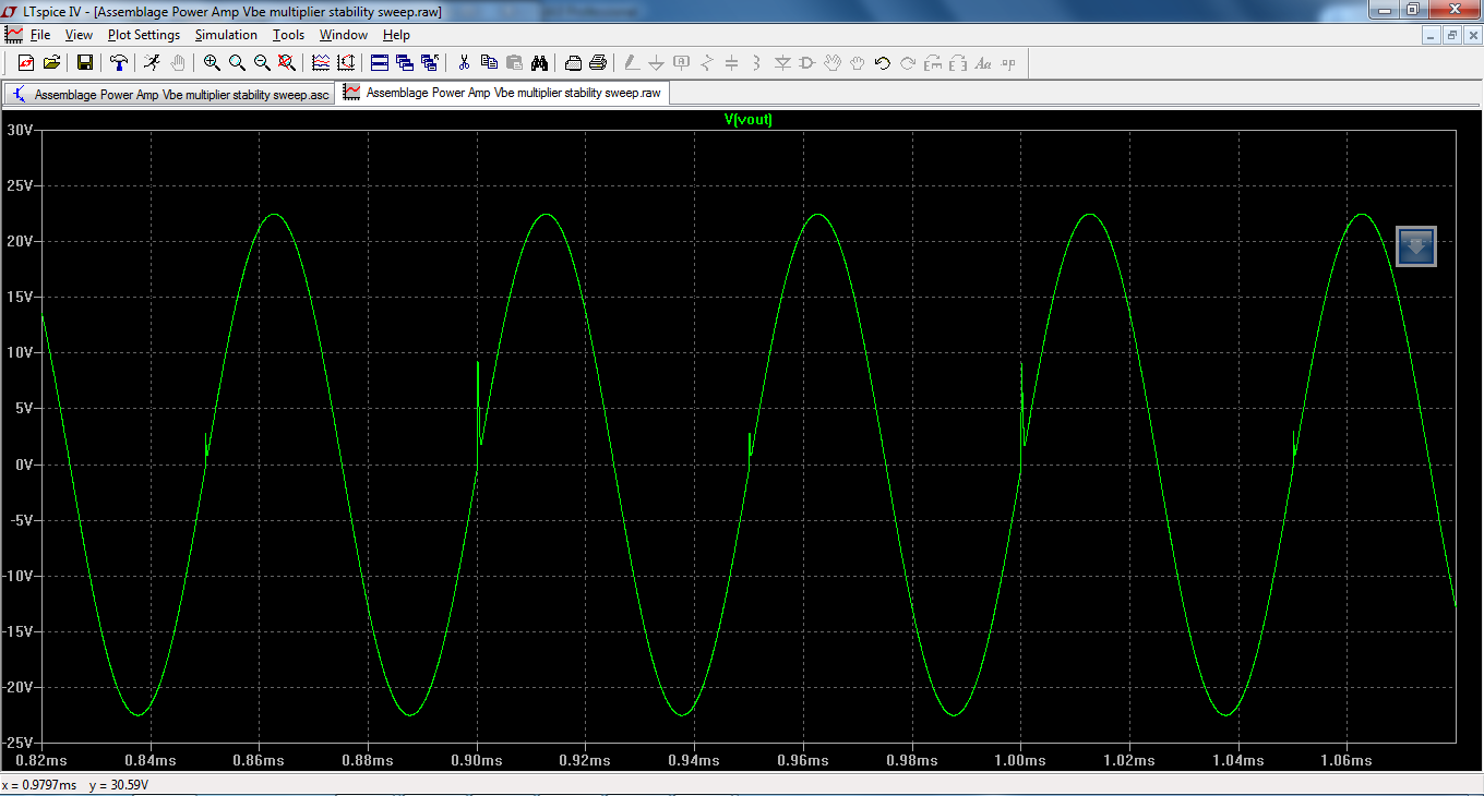

I set CM = 47pF and I get 70 degre phase margin.
But I still don't understand, why THD 20 is high. See attachment.
Just checked the schema from post #84 and it does not show this THD.
Check the bias current in your configuration (or redo your testing with #84).
Bias current around 53mA. Please see my simulation.

Would you care to do the same sim using the stock components in my schematic (post 84)?
Bias current should be around 180mA in each output transistor.

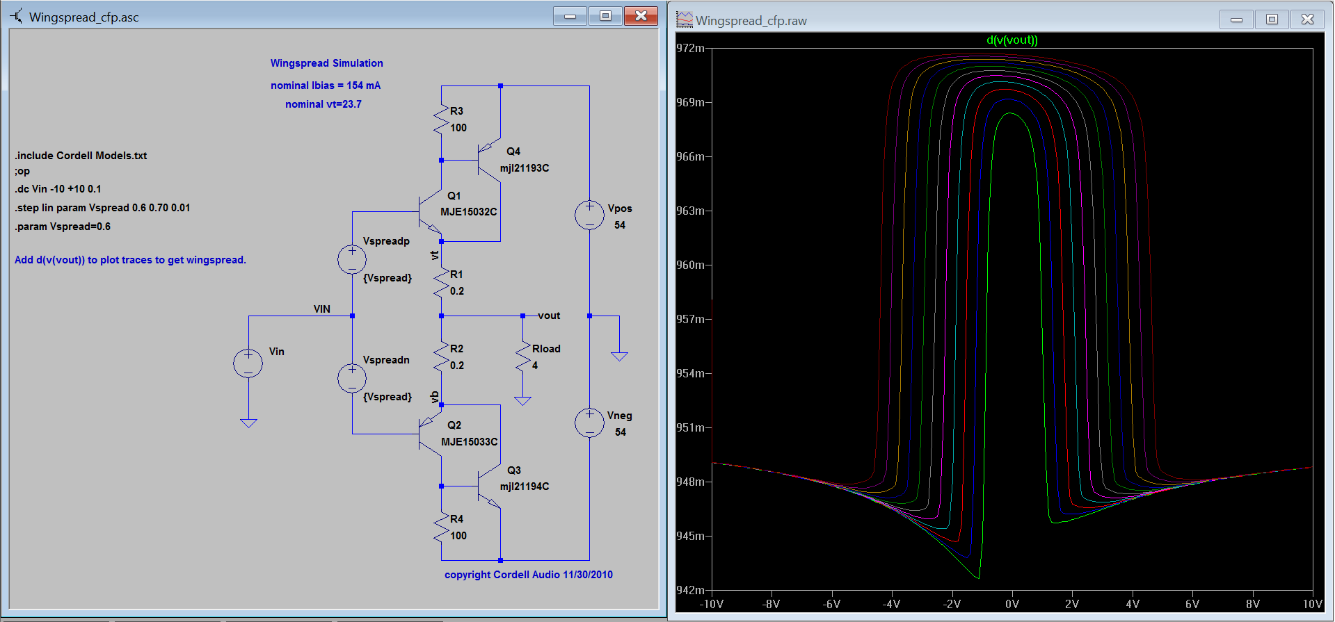

Other thing that I would like to show is this images that represent the gain of the CFP pair and the gain of an emitter follower with a 4R load at various quiescent current values, as one can see the CFP pair have an abrupt change in gain at the crossover region.

As far as i understand a simple EF stage has lower gain change in the crossover region then a CFB stage.
The CFB stage has that gain change in a more narrow region though.
Sergio, in your simulation two resistors are missing that are in Ricardos amp.
I do not know if that makes any difference.
It could be beneficial to put emitter resistors to PSU in the output transistors.
