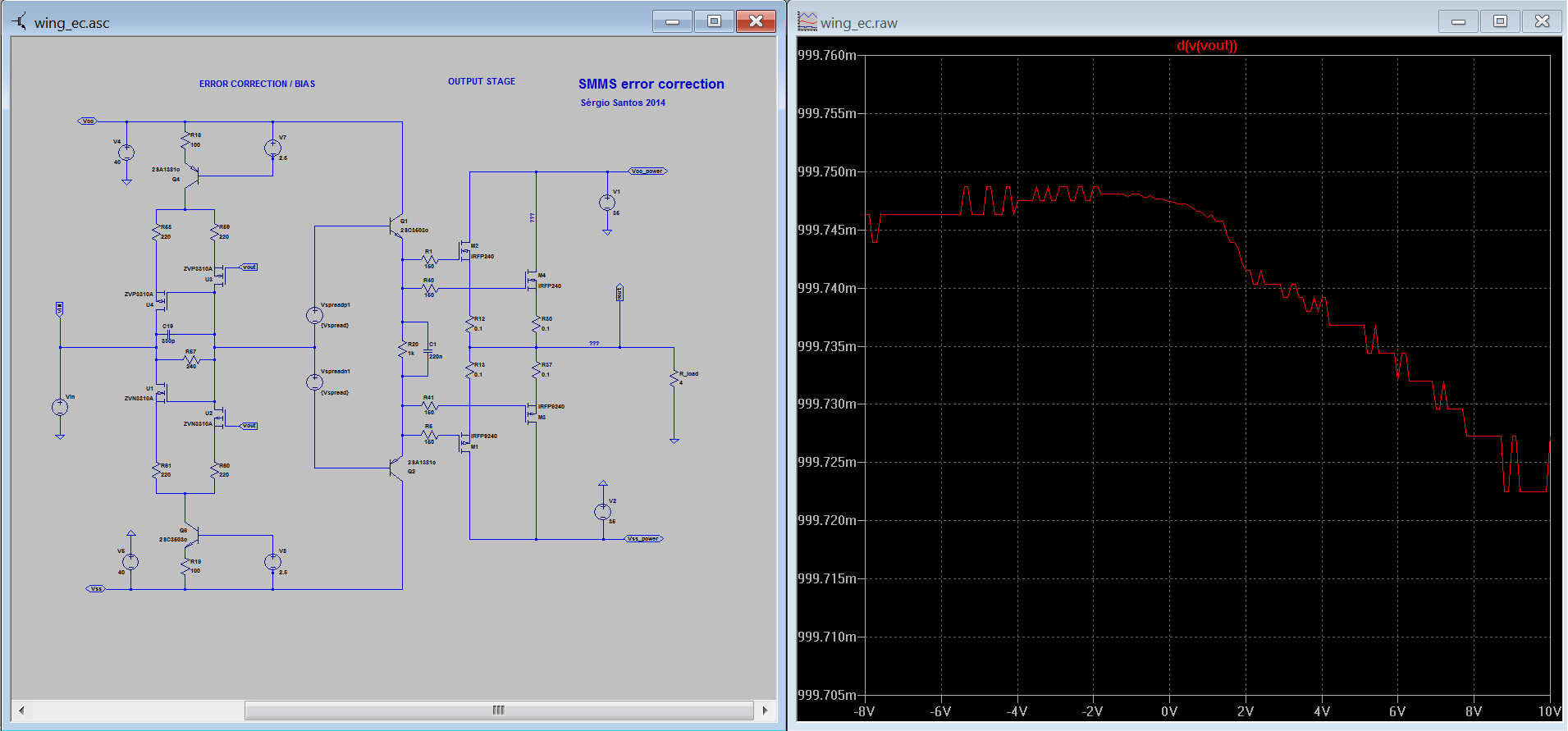

Must learn how to sim this wingspread....
I belive it is better now, could you sim again using different emitter resistor values ?
0.22 0.33 0.47 0.8 1ohm ?
You can download the example circuit from Bob cordell site in figure 19.4
CordellAudio.com - Tutorial Simulations

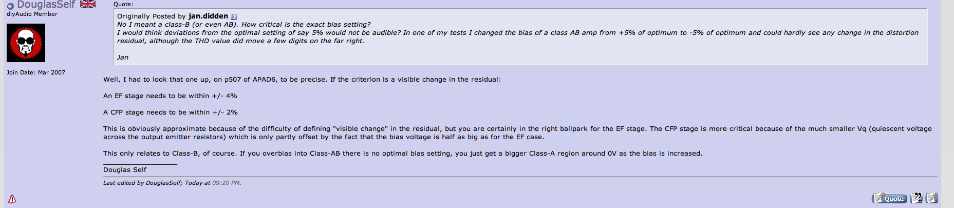

In my personal opinion the great feature of CFP output stage is the good thermal stability, but to have that, you have to use a circuit like Bigun uses.
Adding emitter resistors makes the crossover distortion worse.

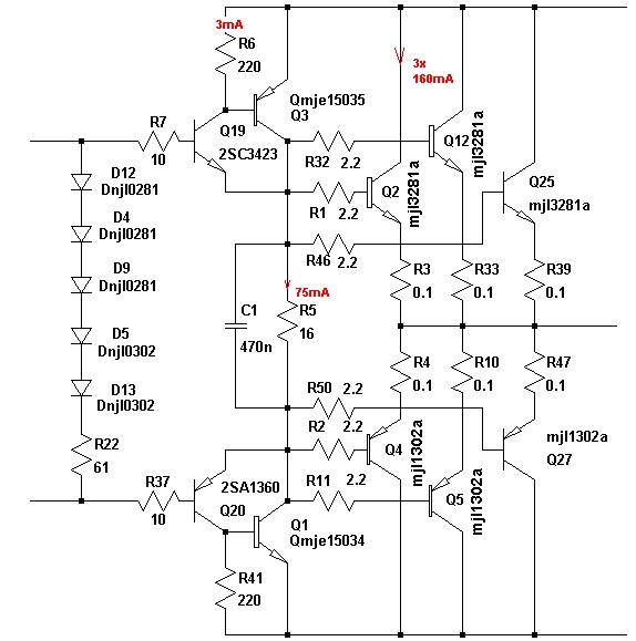

Here is the Bryston.
Q5, Q6 can also be MosFets.
I used this kind of topology in a number of designs with Sanken transistors (2SC2922/A1216) - like it a lot!
Low distortion, solid-sounding...

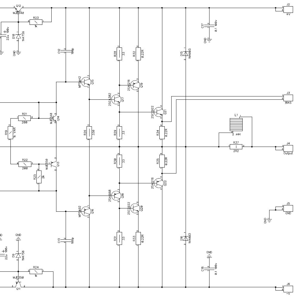

Attached is a fragment of my design with the values. I used it with +/- 52V rails.
Valery

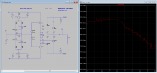

just for curiosity this is the wing from the output error correction amplifier that I will publish in diyaudio this week. It will use error correction and TMC.
That looks great, be sure that I will read your article with great attention.
Damir have start a new thread with a amplifier that uses my error correction circuit.
http://www.diyaudio.com/forums/solid-state/260308-gainwire-ngnfb-classb-poweramp.html

Valery, is that really a*2mH coil ?
I asume it is a 2uH.
You're right, it'a typo of course 🙂
So you mean I should use only collector resistors (to output) instead of emitter resistors ?
