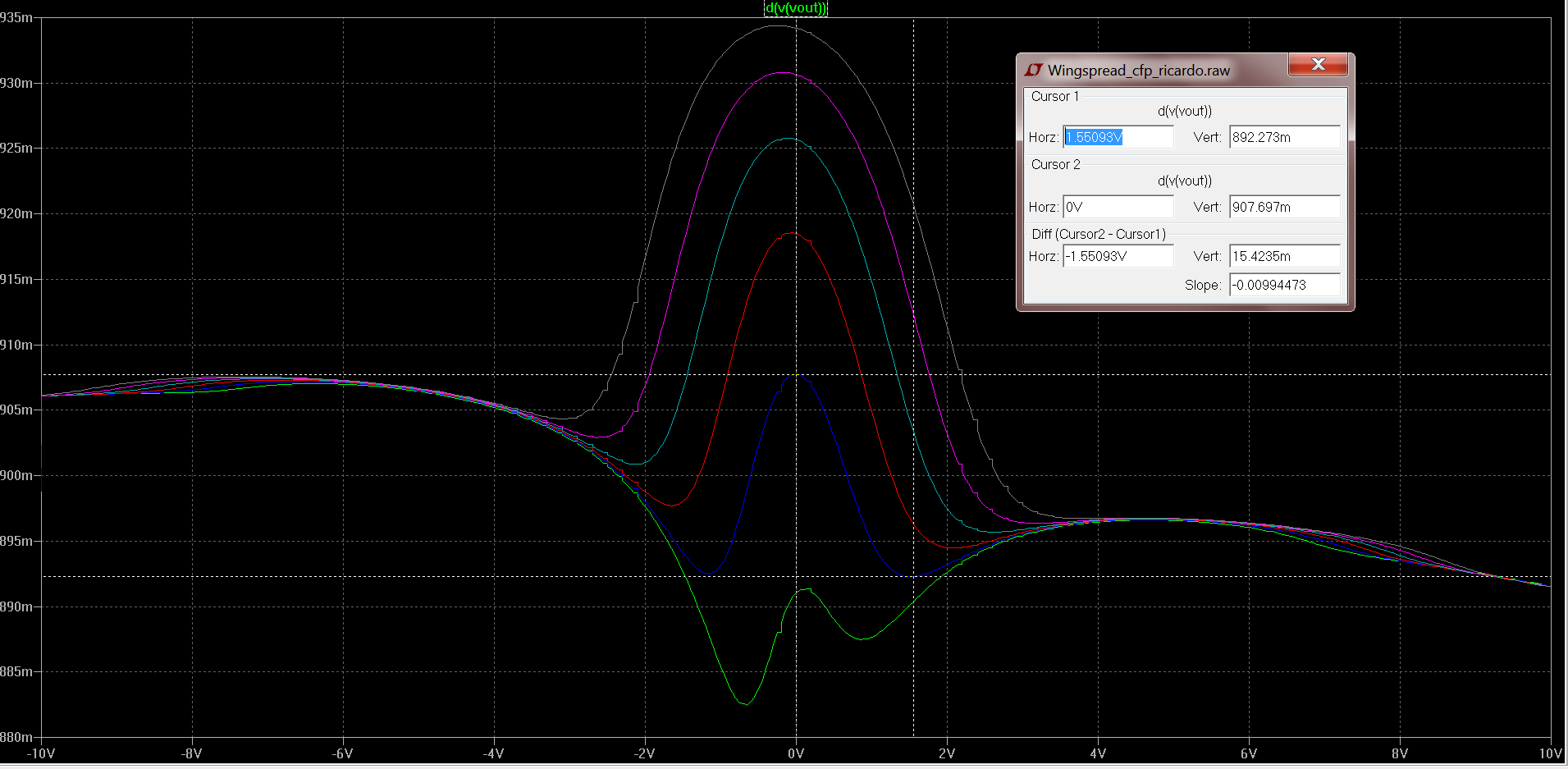

adding those 2 resistors makes the gain lower.
Remember, the Simple P3a that inspired my TGM8 (which has only a single output pair) sounds very good despite the wingspread diagram. It does not use emitter degen resistors on the driver devices (your R1 and R2).

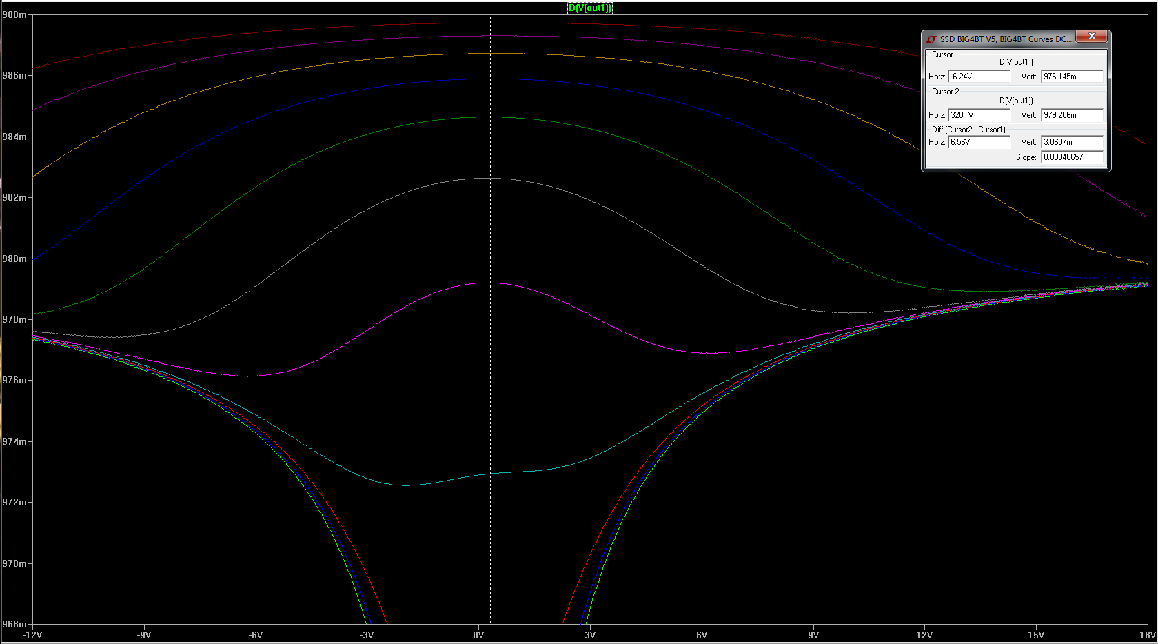

As an example, the 'wing-spread-plot' of my amplifier. Important are, the average gain (as near to 1 as possible, here 0.976 to 0.979) and the delta-gain (as near to zero as possible, here 0.003).

🙂 very good results Frans , can I see the output stage?
No 🙂 I'm sorry but no, this thing is going to be my future (I hope) and will (not at this moment) be published. The first version that will be marketed is almost ready. There has been 2.5 years of prototyping and auditions to reach this state, many more prototype's and enhancements will follow in years to come. Currently the amplifier has a 'natural' THD (that is all feedback, except local on devices, removed) of less than -50dB, I want to improve this to -80dB (in years to come). But hey... I will stay here and comment and contribute in this (and other) threads. First half of the solution is to know that it can be done 🙂

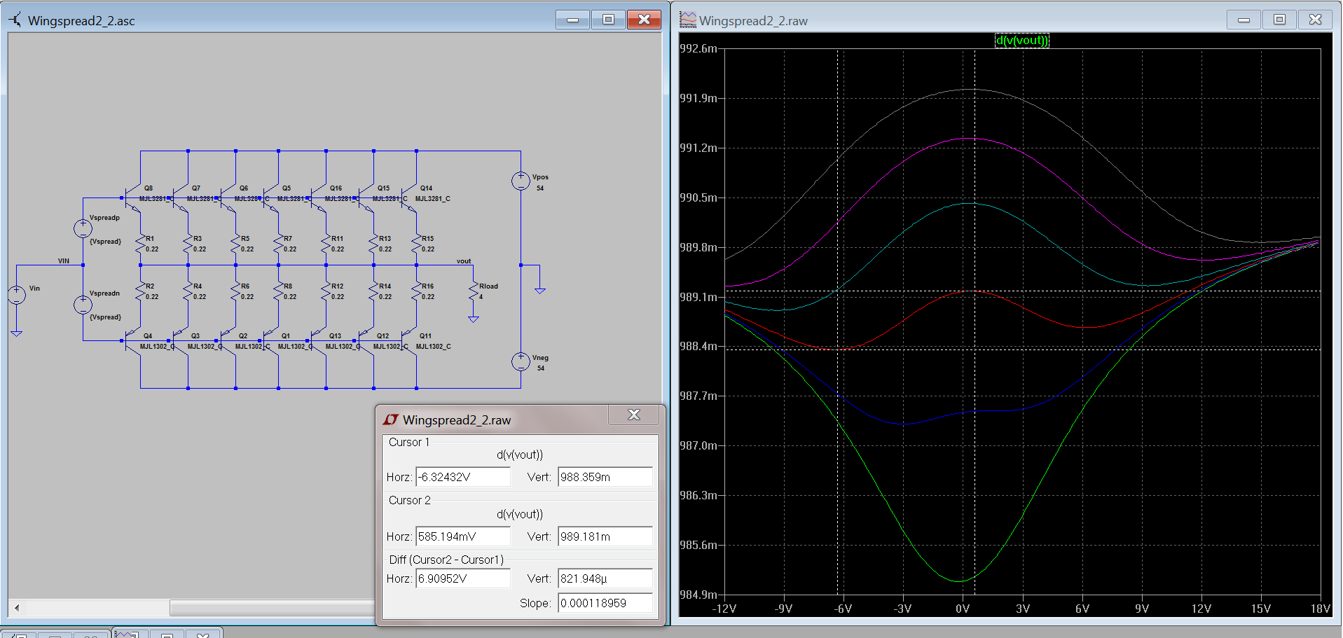

The more linear output stage without error correction or feedback that I know is the parallel of a large number of power transistors in a emitter follower configuration like this image, the best bias is at 56mA per device or 0.39A total.
