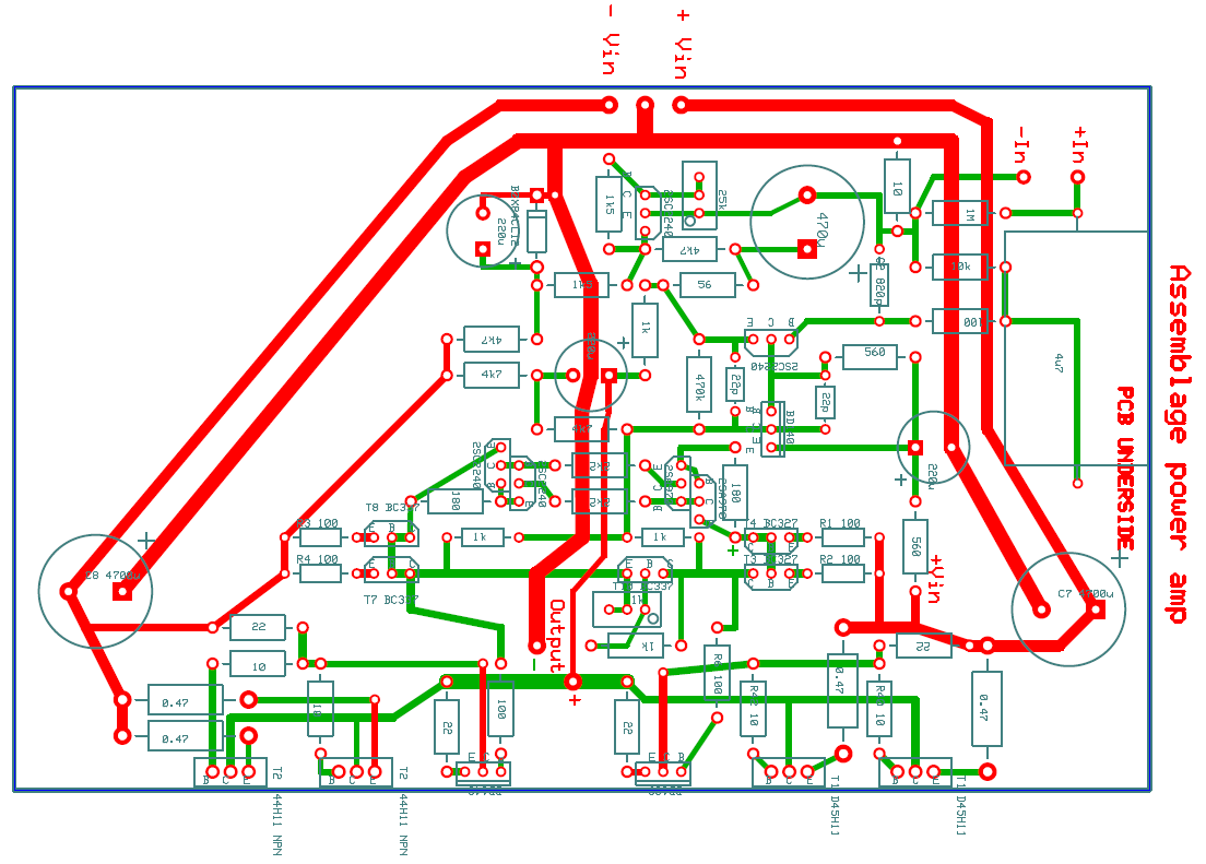

I am building this amp p2p so I need it to work at first start. In order to avoid possible stability issues I decided to postpone the 2 pole idea.
Here you can see 1st draft of the layout.
Comments are more than welcome as usual 🙂
Please note that for ease of layout I left the drivers and the output devices all related to the same heatsink..... would this be a major mistake ?
  • Assemblage layout.pdf
Just can not imagine how to add an extra heatsink to this rig.
Maybe it will work with a common heatsink
I guess if you have the Vbe multiplier monitoring the drivers temperature then it should work with a common heatsink. In my TGM8 I didn't need a heatsink on the drivers (due to design of the OPS) so I didn't face that problem and hence don't have direct experience to share.

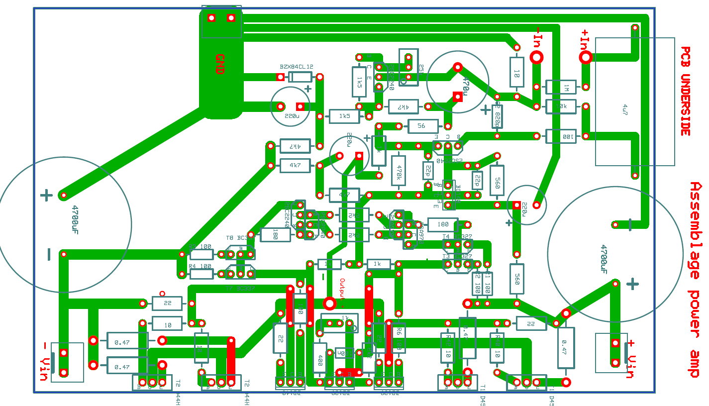

I'm not sure I have it all connected as intended, but it serves the purpose. This shows how each (and every) ground point is separately connected to the central star point. The layout can be improved a bit by rotating the reservoir capacitors.

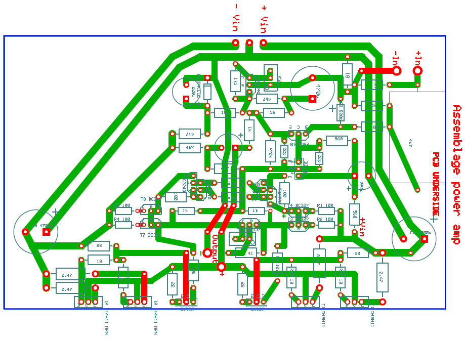

My 2 cents - make the traces, connected to the output transistors' collectors and emitters, emitter resistors, output of the amplifier, ground and rails (close to the output stage), as "fat" as possible (and as short as possible) - these are the traces, where the high currents will pass-through to the output load.
Valery
Valery
Yes, that to 🙂
