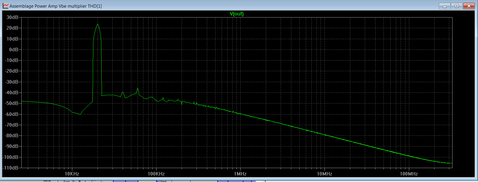

Why do you need the clipper again ? - the pcb layout and interpreting the sound/performance will be easier with the simplest circuit. Simulations make it too easy to add parts 🙂
I did play with it but am having difficulties understanding how it works and also it only sims ok if I use quite high miller caps..... In that case it eliminated 2nd harmonic and all others are lower than the single pole schematic so I am planning to leave space for this implementation latter.
My first build (The opamp input Nobrainer) has a very wide bandwidth and sounds quite pleasing but lacks power. Anyway, it promptly blew one channel when I unplugged the input rca when it was on.
That is why I want some kind of limiter.
THD is badly affected by the presence of the clipper circuit on the input.

I don't think you want a clipper, you may prefer to leave this out of the design for now. Perhaps it's better to think about how unplugging an rca broke a channel on your other amp (was it really just a spike - which would only produce clipping, or was it unstable oscillations?) and whether that is really likely to happen with this new design ? I believe you can make your new design robust without a clipper on the input.

In that case a clamp to the op-amp rail would do the job, with no measurable side effects (a 1n4148 is 7pF, adding 2 (to clamp to the positive and negative rail) ads 14pF parallel to the input). Get one of the (or both) D. Self or B. Cordell power amp books.
In my opinion, the right approach to clipping is something like this - Apex BX-500 - a bit more complicated, but gives much more linearity, precision and control. Plus a cool led clipping indicator 😉
Anyway, normally you need it for powerful stage amplifiers - you most likely use them at high powers and can reach the limits easily. In my home setup, having 7 channels, roughly 100W each, I never reach the clipping point. Just no way. Something in the room may be damaged when it clips 🙂
Will do for the Nobrainer.
As for the Assemblage, I will leave it out for the moment.

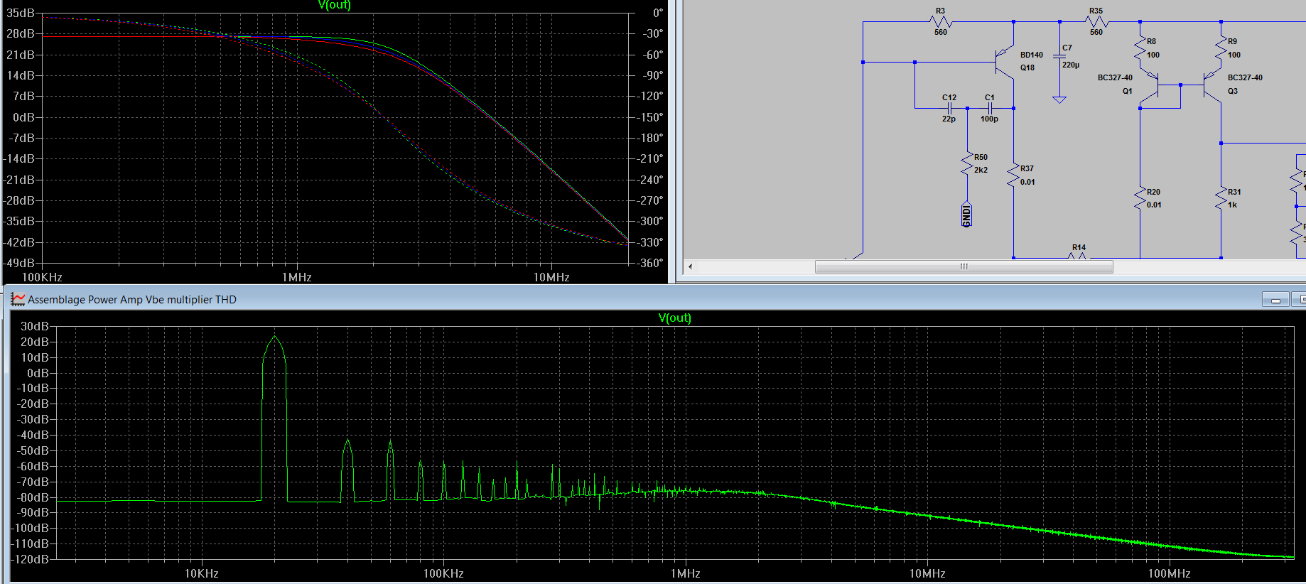

In the TGM8 you chose C6 (100p) to be only slightly larger than C4 (22p). In my simulations I was able to totally eliminate 2nd just by pushing C6 to 150p. How did you choose these values ?

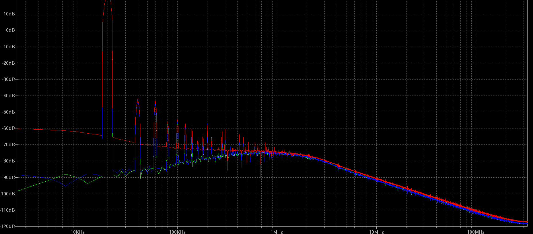

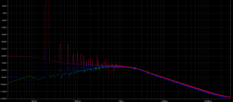

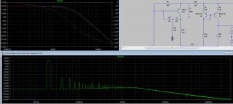

Still simulating the 2 pole miller compensation and now I am getting some strange results.... need some input.... THD seems quite similar but the base line is quite different.
I am comparing two very near resistors (5k and 5k1) with a 100k resistor that should act as an open circuit as if I am using only a single pole miller compensation.
Why does the graph begin at -100dB for the lower resistor and starts at -60dB with the open circuit ?

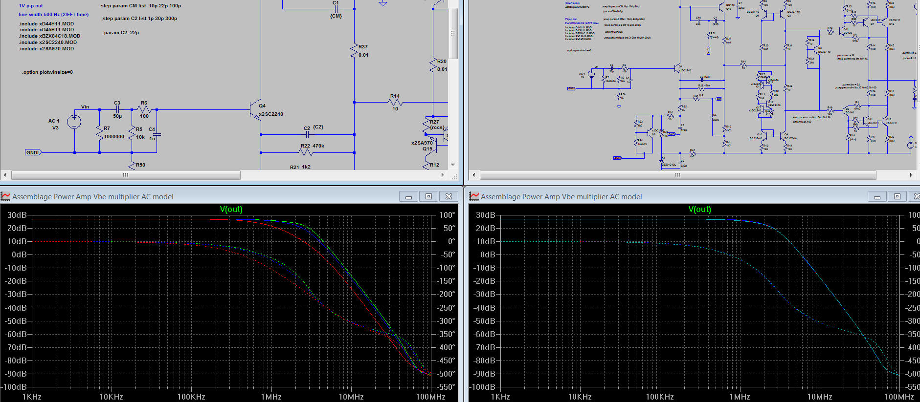

Show us an AC-analysis curve for both.
Hope this is what you need.... can not see any difference between using 5k or 100kr in this case.

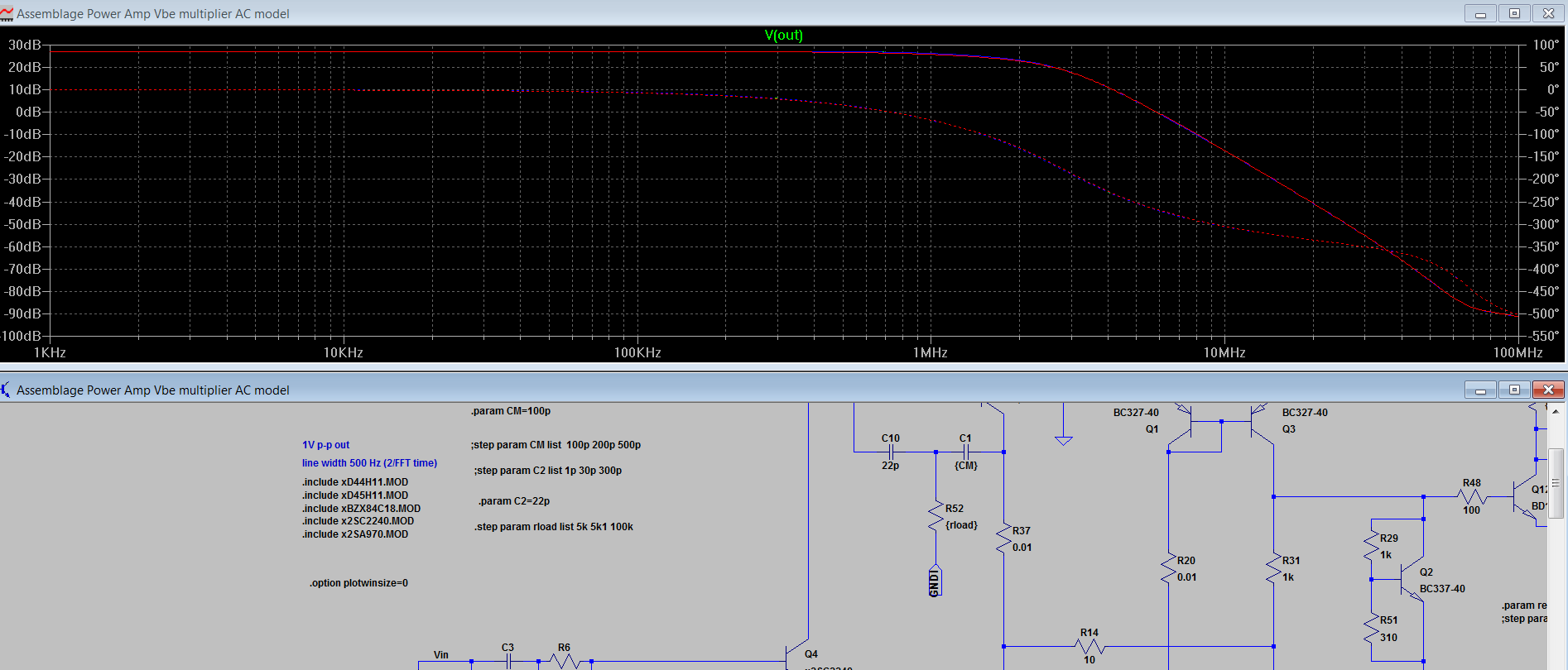

I do not see any significative difference between single and 2 pole miller compensation.
After rereading Self paper about it, I get the idea that this very small effect might be due to using CFP output stage.
As determining the second cap and resistor values is critical both to minimal distortion and also to stability (If not done correctly we might end up loading the vas collector directly to GND increasing nonlinearity), I finally decided to let the idea for future experiments and stick to the initial plan.
