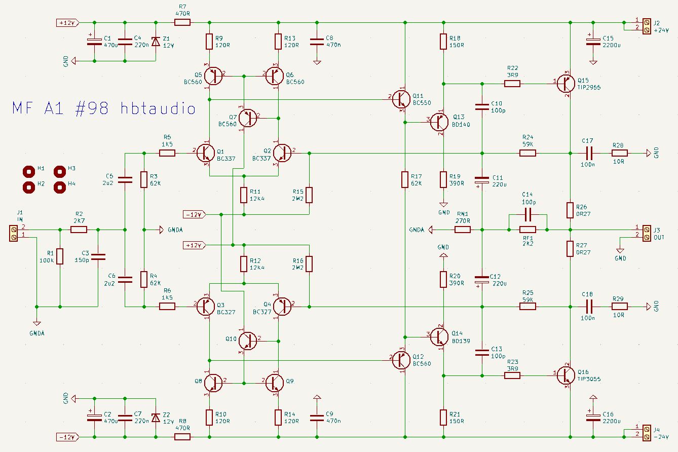

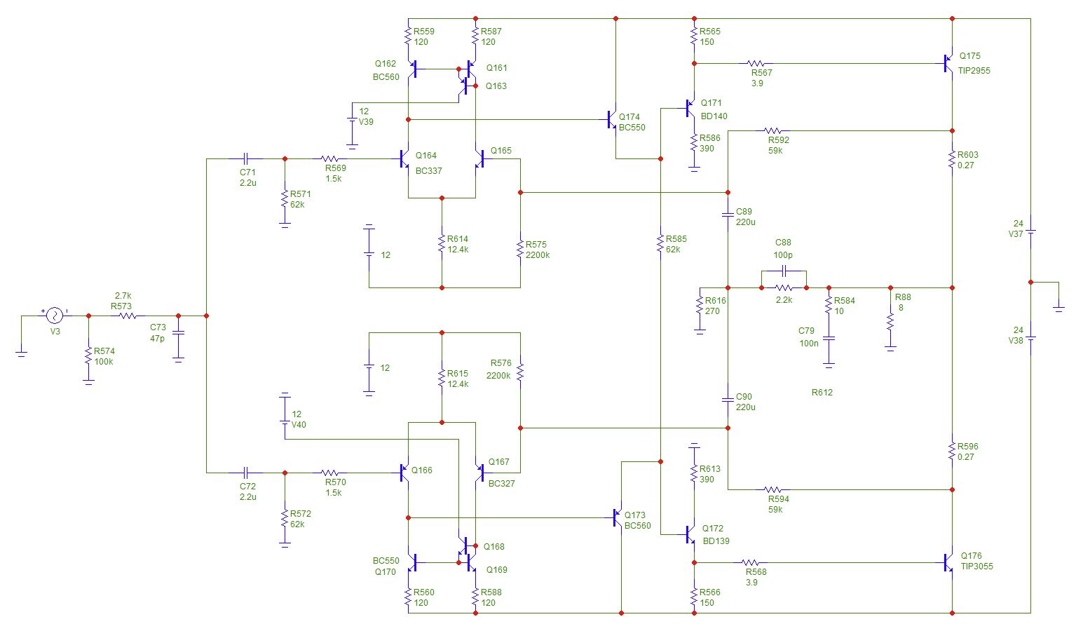

I guess this is the final #98 schematic plus a few additional changes by hbt. Changed GND, so that one may have separate GND lines from input and the rest.

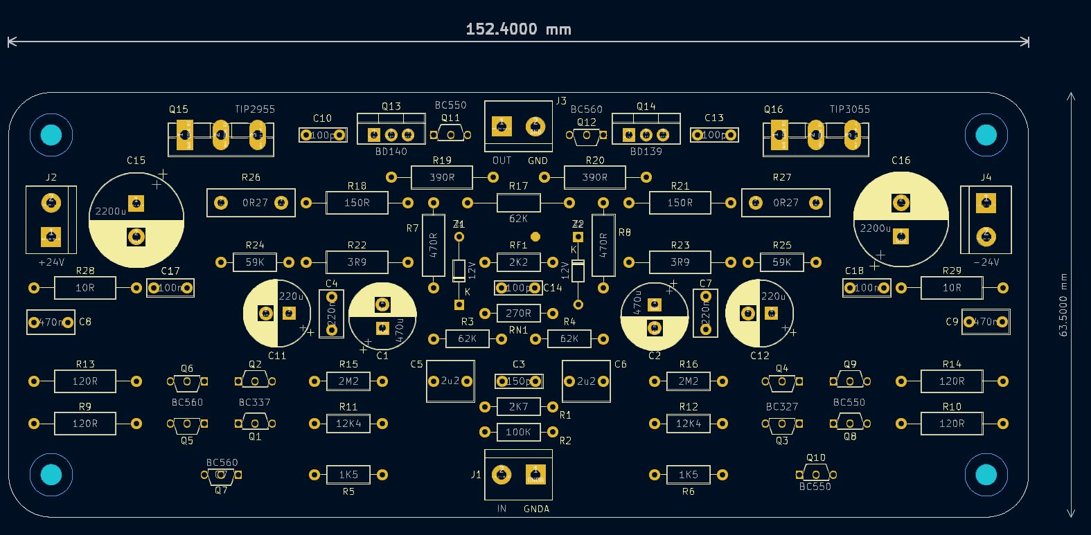

Routing, second attempt. First was a disaster. I am still not proud of this - maybe I give it a new try tomorrow.

Hello M0rton,
the PCB already looks very good, but:
  • Q13 & Q14 must be removed from the main heat sink, as well as Q11 & Q12
  • Q13 and Q14 can be given a small but separate heat sink, which looks professional and of high quality - they won't need one, but the typical tiny one won't do any harm
  • Q11 & Q12 belong to the front end, near Q1 & Q3
(maybe) turn Q13,14 by 90 degrees ..!
That's perfectly normal, three iterations are standard. So don't get angry. It's great that you're taking on the challenge - a beautiful and further KiCad project.

It is redrawn by me, is it the same as yours functionally and correct?
Your schematic from this post, I redraw it, only want to know if I made any errors.
You can find my model library in the Stellema thread, as I already wrote.

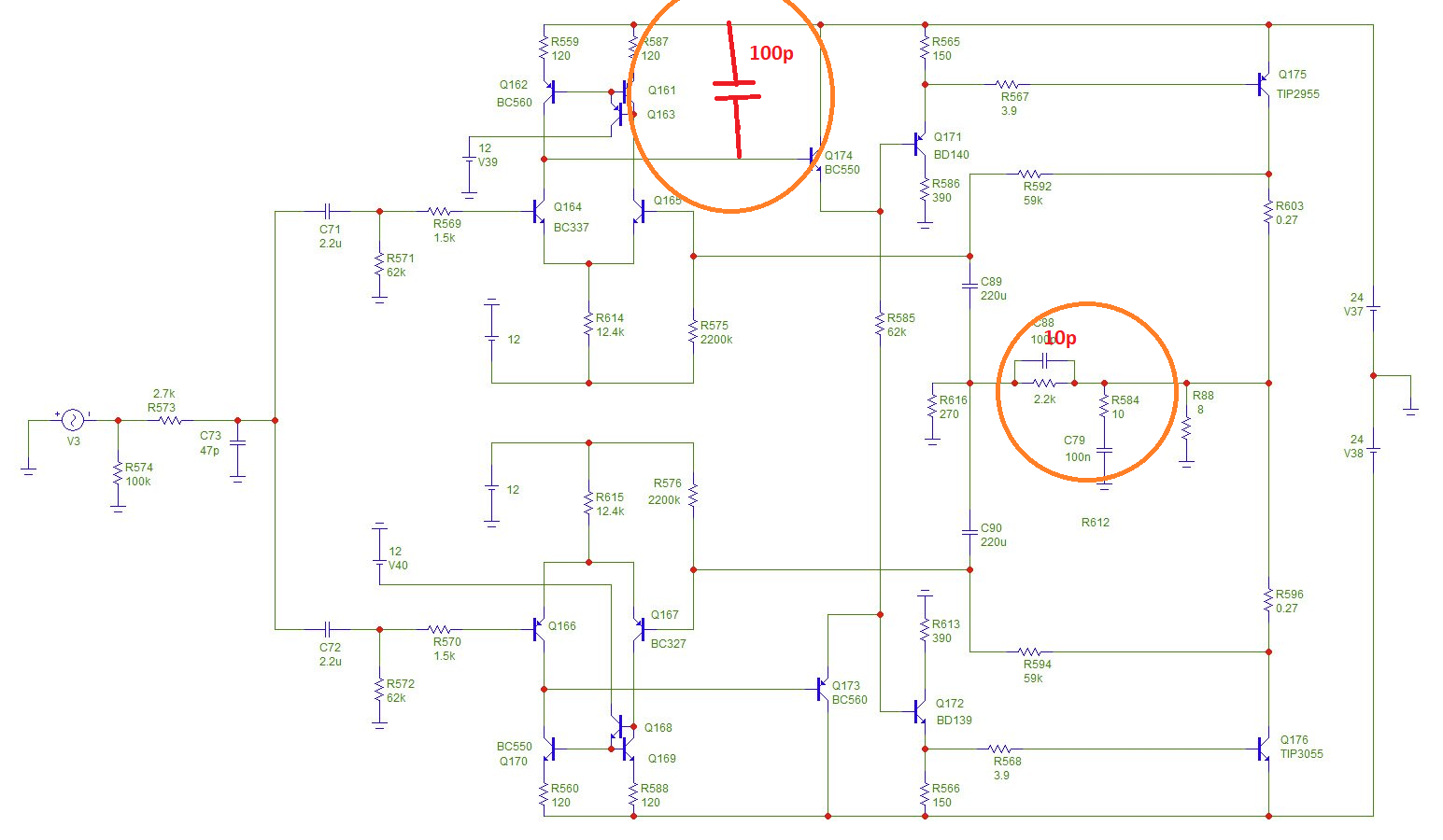

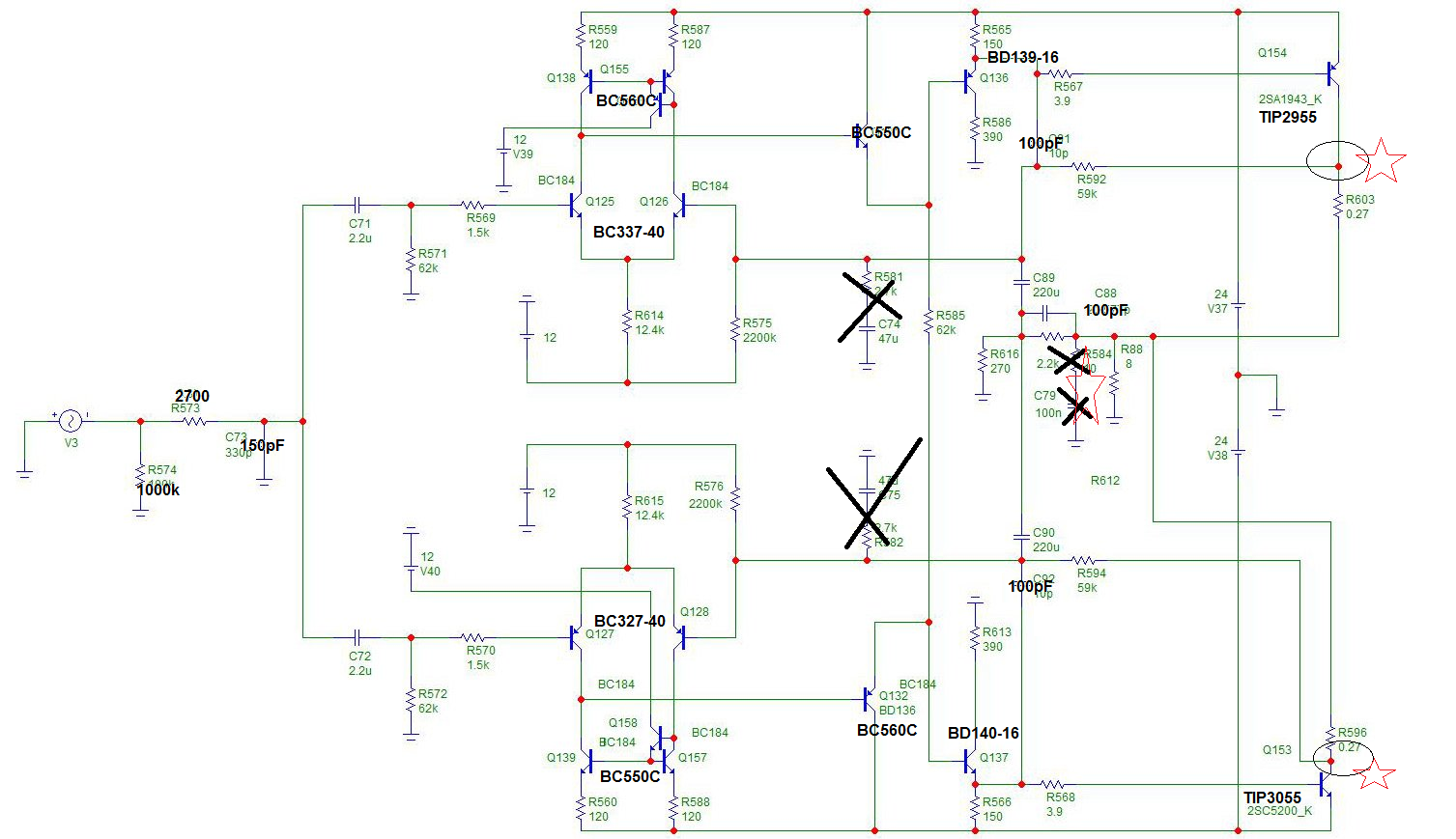

What are C10 / C13 for ?
Remove both.
If you want, reduce C3 to 47p for higher bandwith and less margins.
Compensation may be further optimized.
Somebody should cross check stability and perhaps built a quick prototype before launching a pcb.

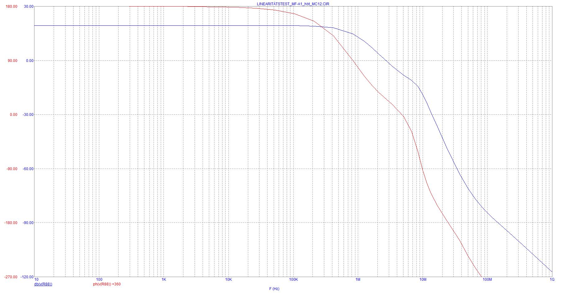

Plot with C3 = 47pf:

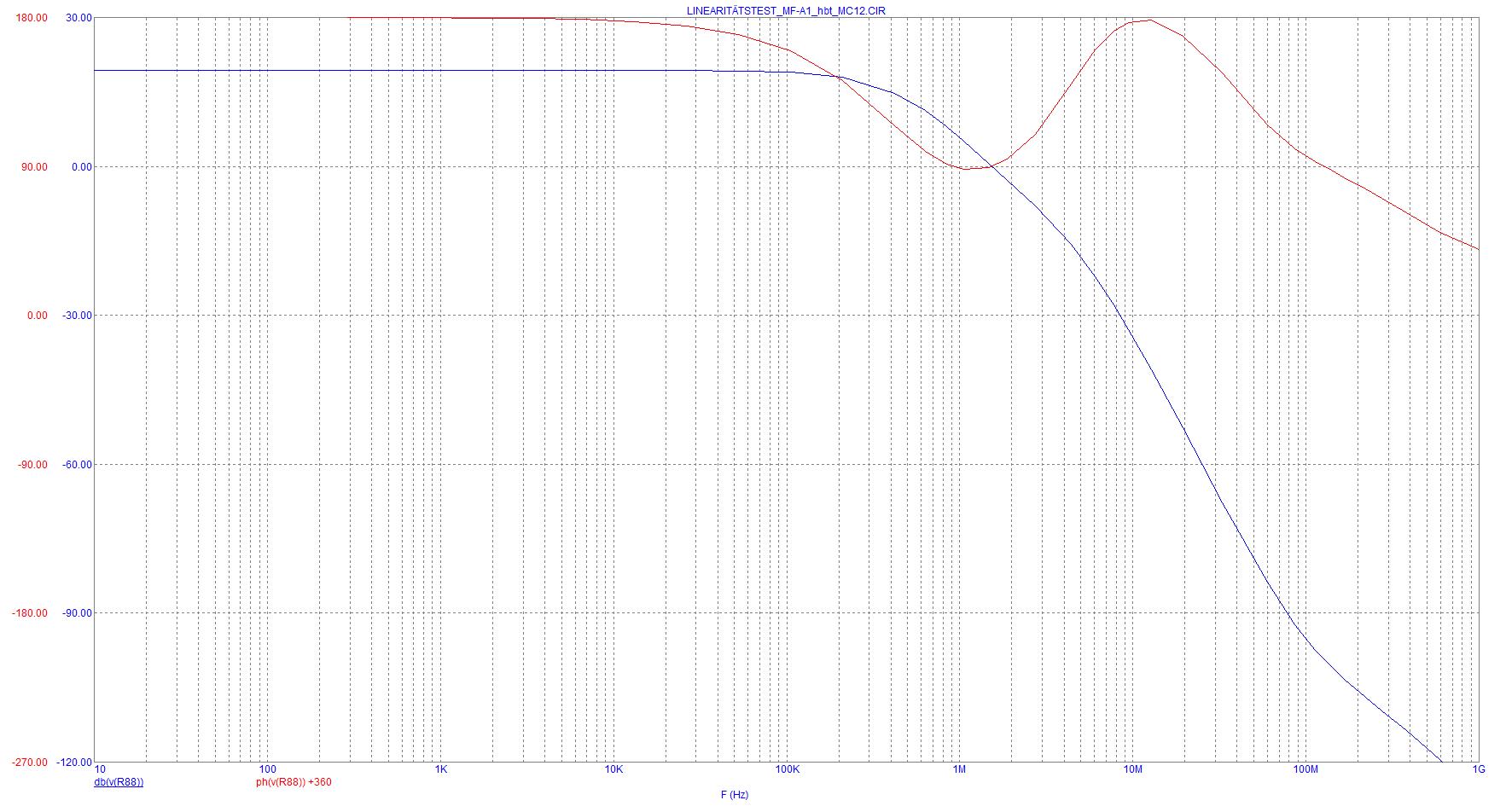

Quick Reminder of the original MF-A1

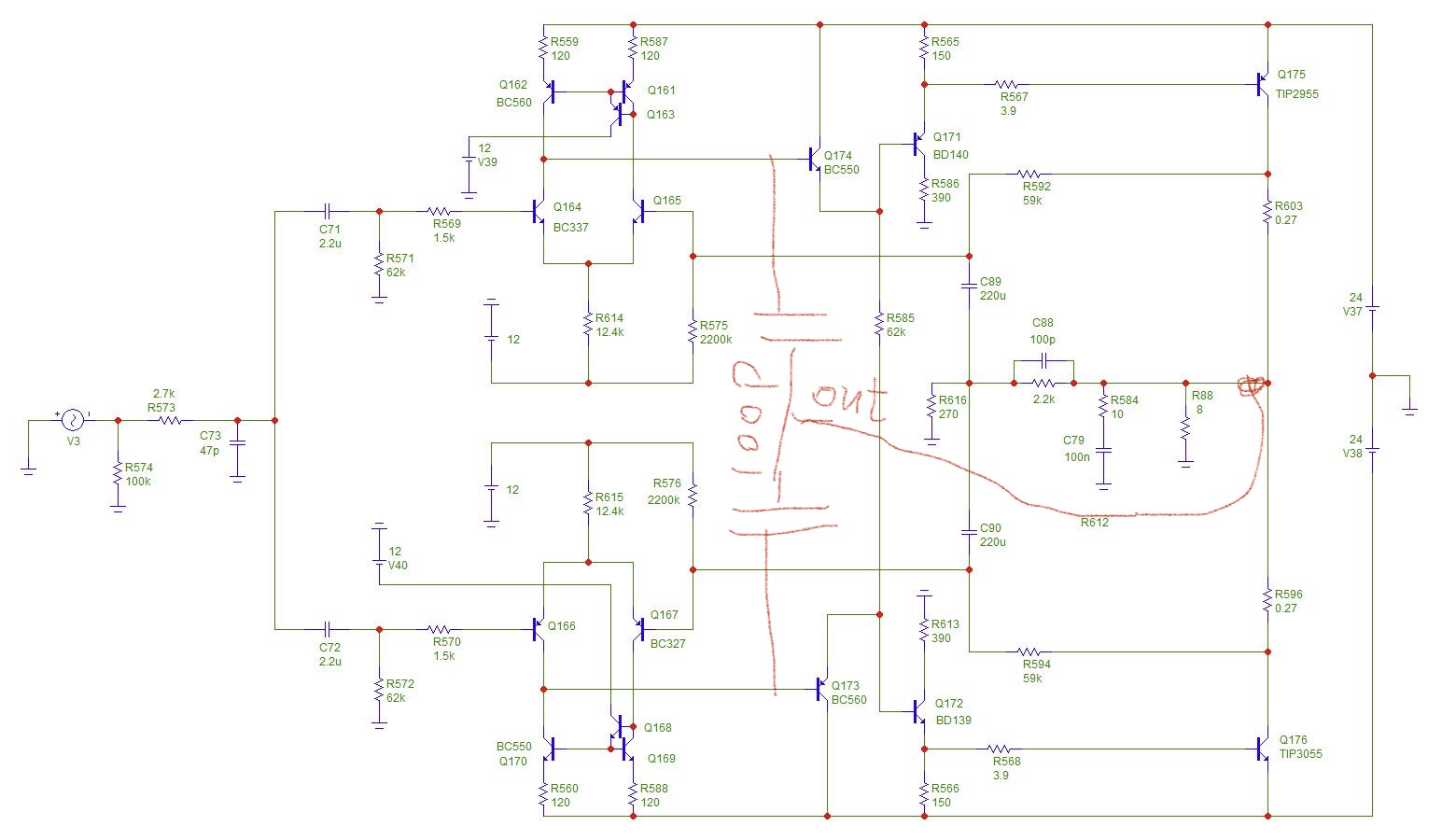

No, simulation
OK.
You are shooting in the dark. C88 in #214 could work if the Zero it creates cancels out a Pole in your circuit. A1 is a relatively simple 2 stage amplifier. It only has 2 major Poles. In this case, make one of Pole more prominently so that you know where it is.
Try this.
PS: I strongly suggest to swap out 3055, and replace it with something like 2sc5200. Low ft 3055 is your largest obstacle to compensate.
