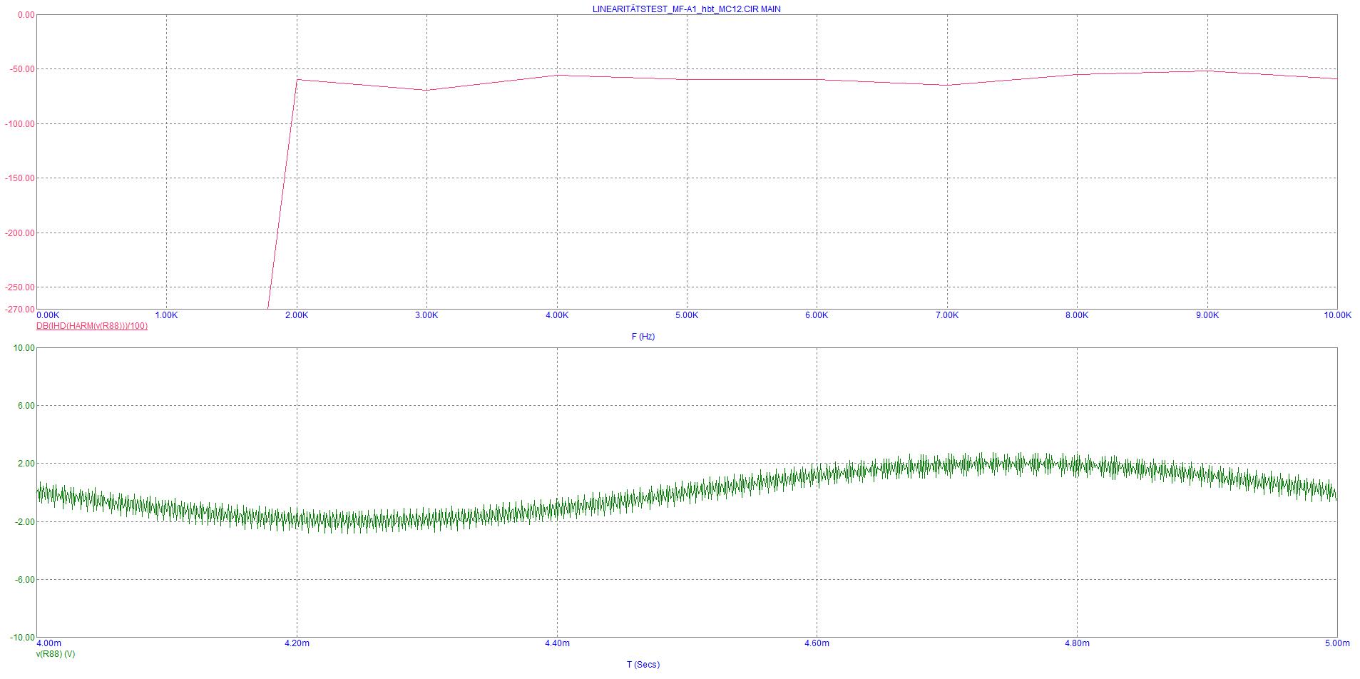

Simulation says unstable. Mentioning flaws is not constructive ? I don't want others to make layouts for oscillators.
Still waiting for your original gain phase plot for cross check.
MC12 transient analysis with 2 x 100 pF
Time to build a prototype! To the soldering irons, diy-warriors!
But that is very strange now, because you are constantly proclaiming that this proposal will oscillate!
I have just checked “my simulation” again and nothing oscillates.
However, I am happy to admit that the present circuit is susceptible and therefore I welcome the unrestrained commitment of every attentive neighbor.

You really keep me on my toes.
I would like to refer to your
posting #214 and posting #232; the snot doesn't oscillate with the models I use!
C88 in your schematic must always be a tiny bit bigger than the other two bangers, you have to keep that in mind as well as the unconditional symmetry of the circuit halves.
I hope you'll take another look at Tim's original from time to time -> 2k2 || 680pF -> and the result on the phase rotations.
