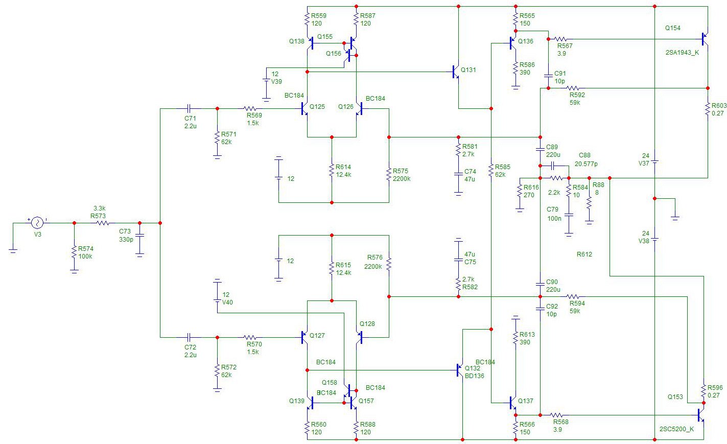

Not forget that I still used the 2N3055.

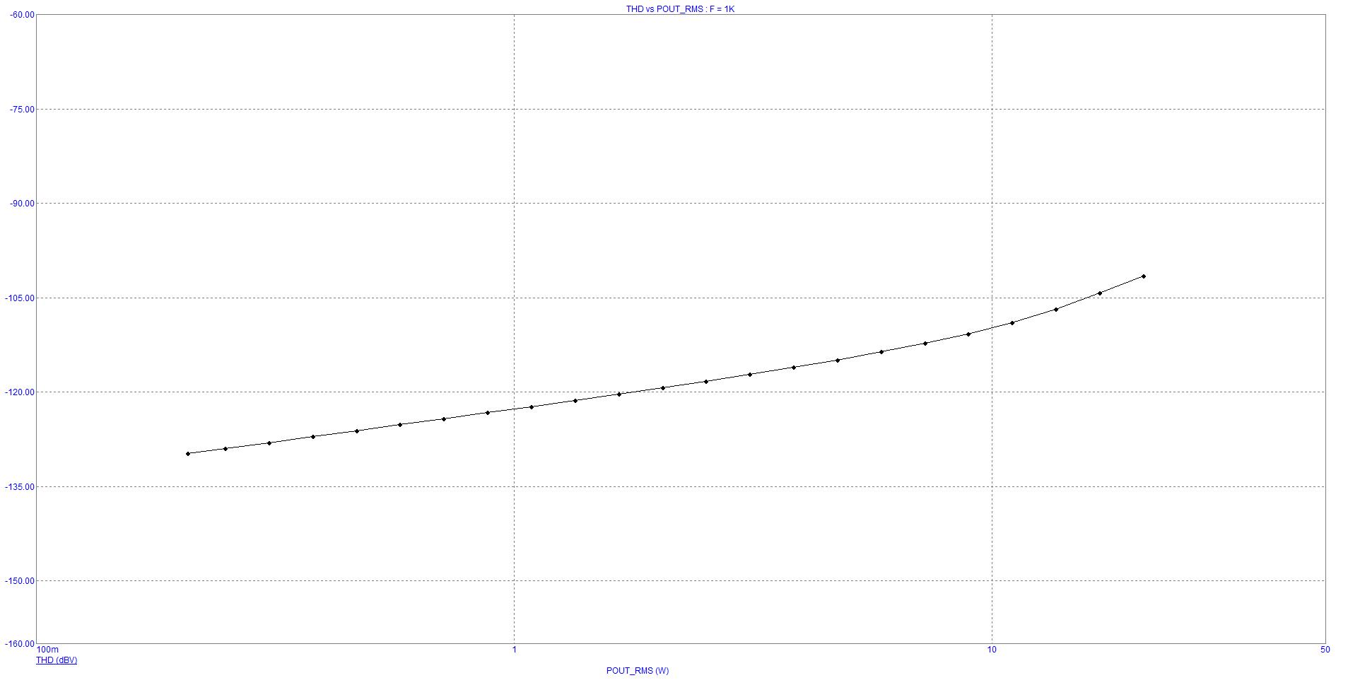

Rows of 7 x BD139 /140 give -140 dB @ 1W

My bias towards class B. It is just my preference. I could put 1A bias and run 1W, but the software I use only has 0.001% resolutions.

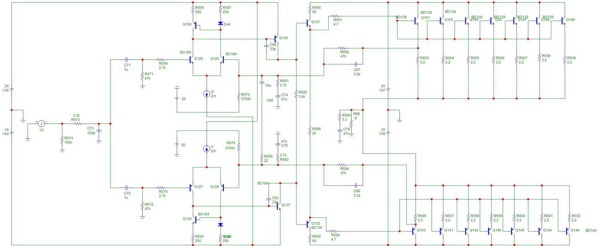

The fun version with BDs, before used single 2N3055 / 2N2955.

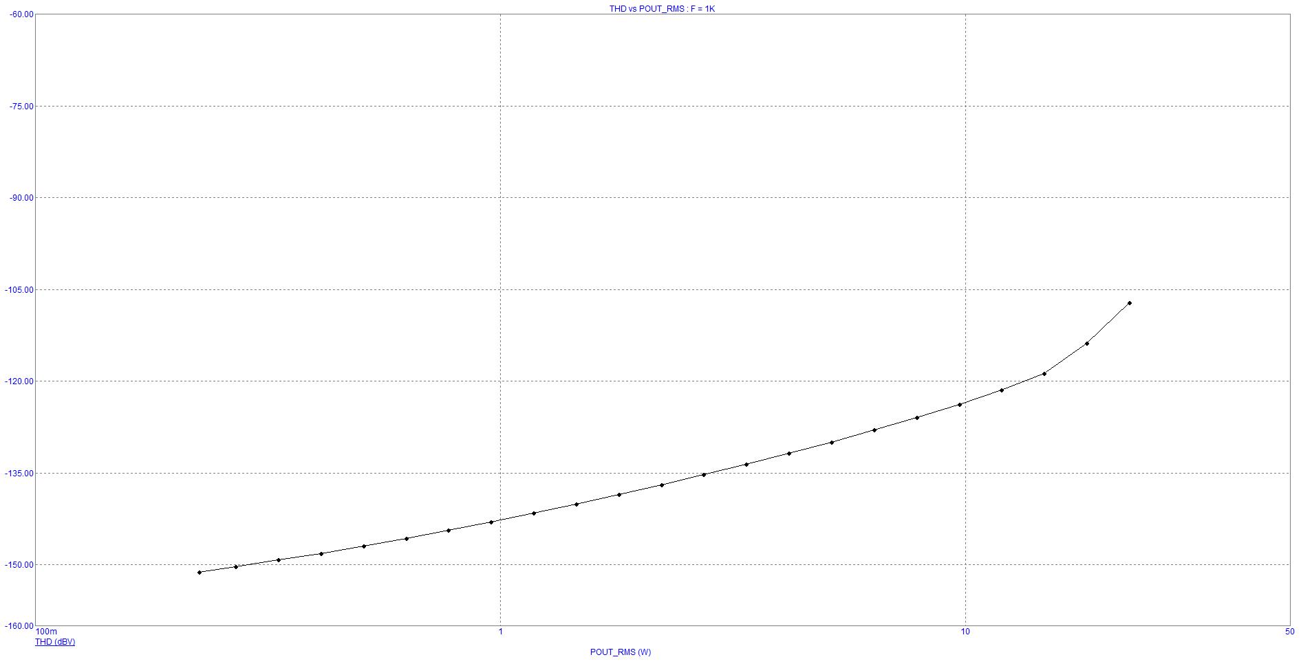

EF + mirror and ccs on the ips : THD @ 1W -131 dB
0.0000275 %
this

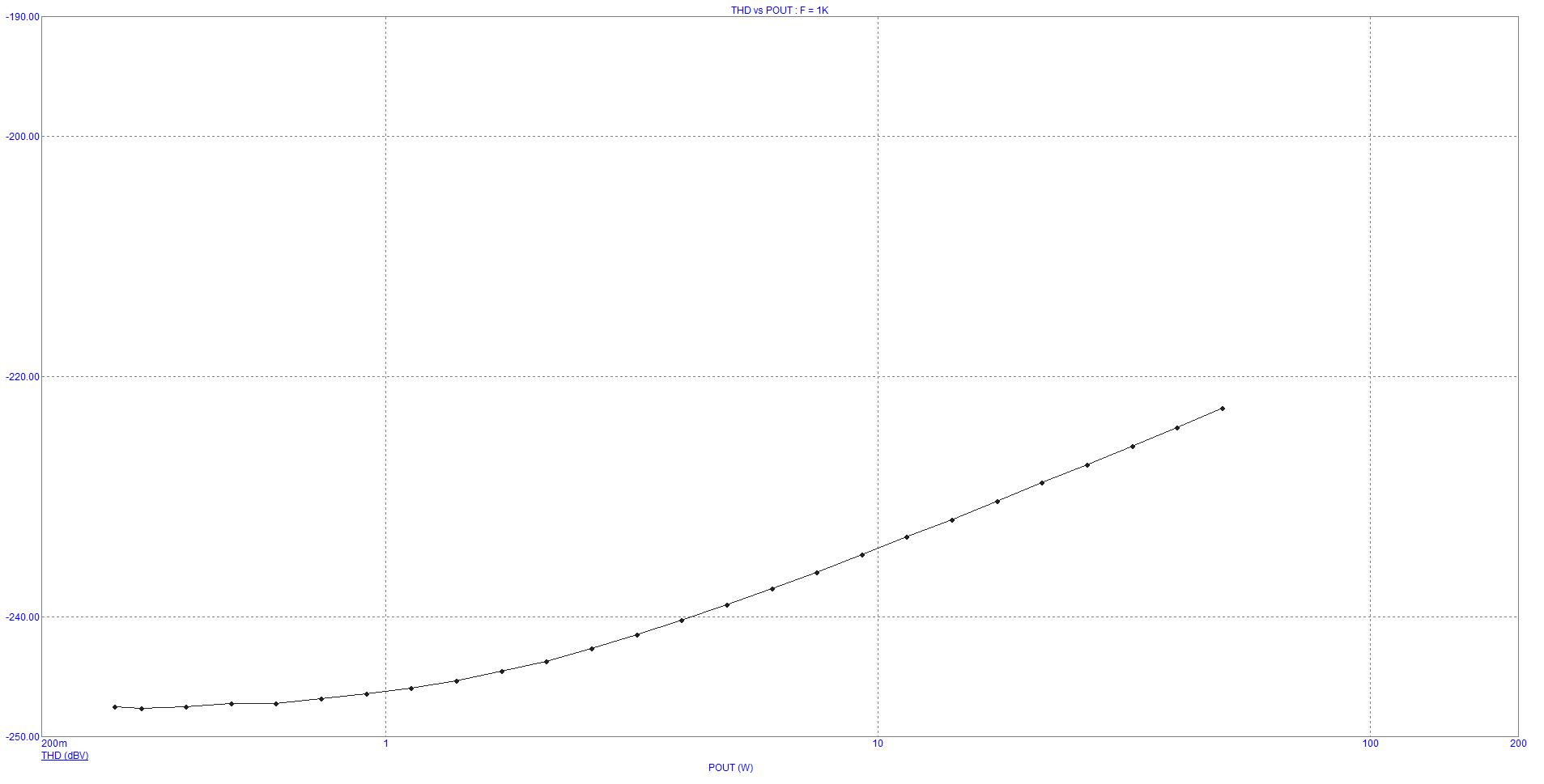

  • is the THD_1k(1W_8Ohm), which I read for my recommended iteration of the A1, i.e. MC12
  • also corresponds to your statement after playing Bernhard's last trump card!
As you can see, I haven't played my last trump card yet - the absolute high-end version with the CCS overkill is still missing.
In the interesting range, above 1W to 10W, my THD plots are much flatter than yours. Unfortunately, you lost this match by a very narrow margin, and you should accept that.
It might be interesting for the reader to clarify why our two 1W-THD-Things don't differ, and can't differ much at all - where MC12 gets this insane resolution from is also interesting.
Can MC12 (for example) predict the crazy value of -240dB?

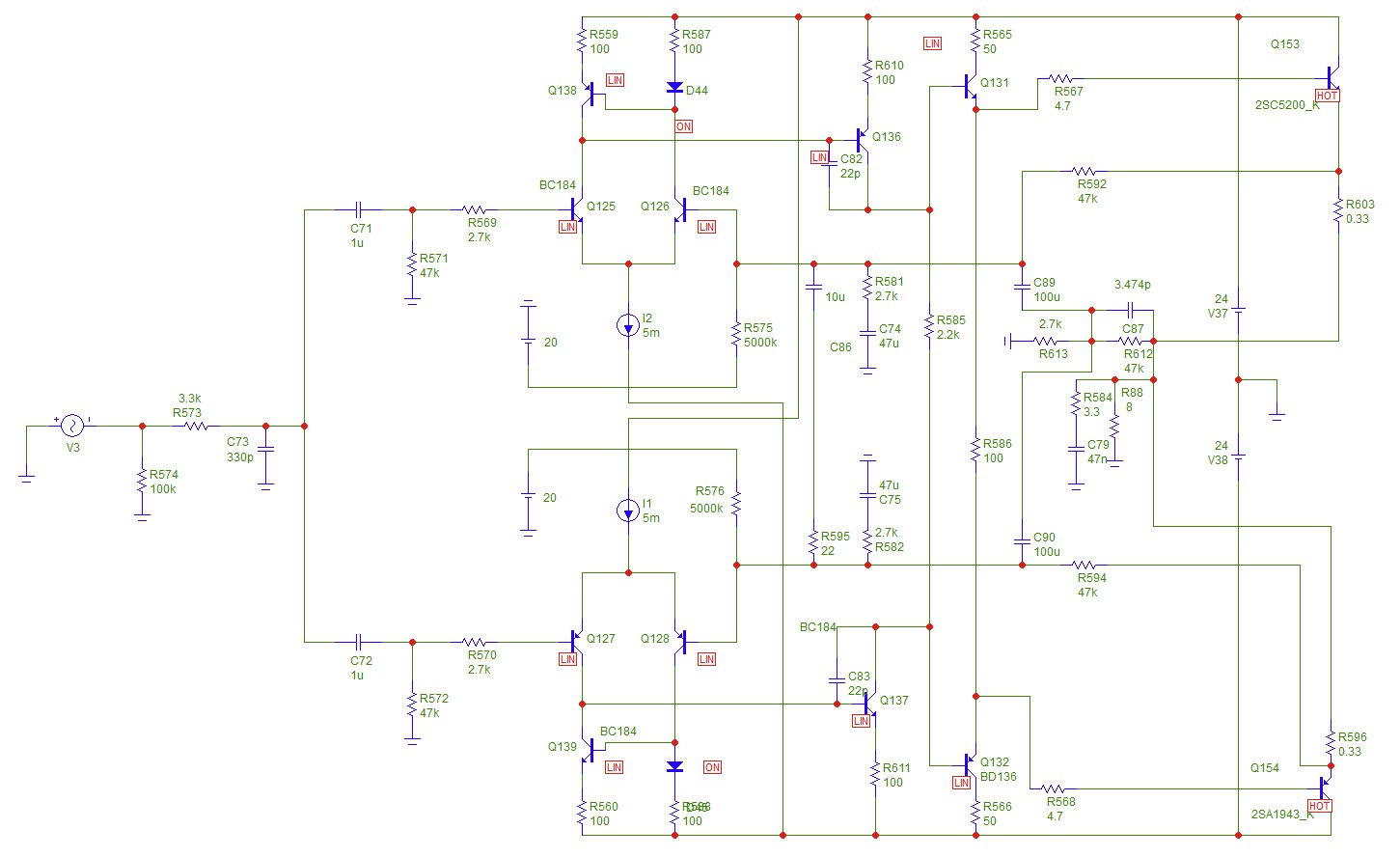

Perhaps the picture in the appendix will help the newcomer to understand - and differentiate.
Let's end the THD war now, because we will never be able to confirm these dream values in reality, in an actual power amplifier. That should be quite clear to any (professional) designer.
An A1 is no longer an A1 if we give him a completely different skeleton. That is the crux of the matter.

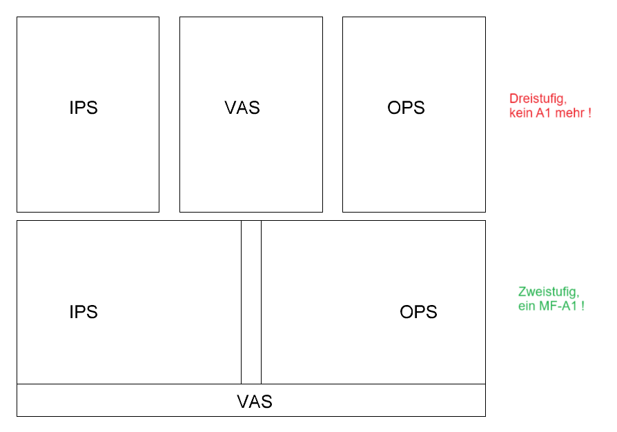

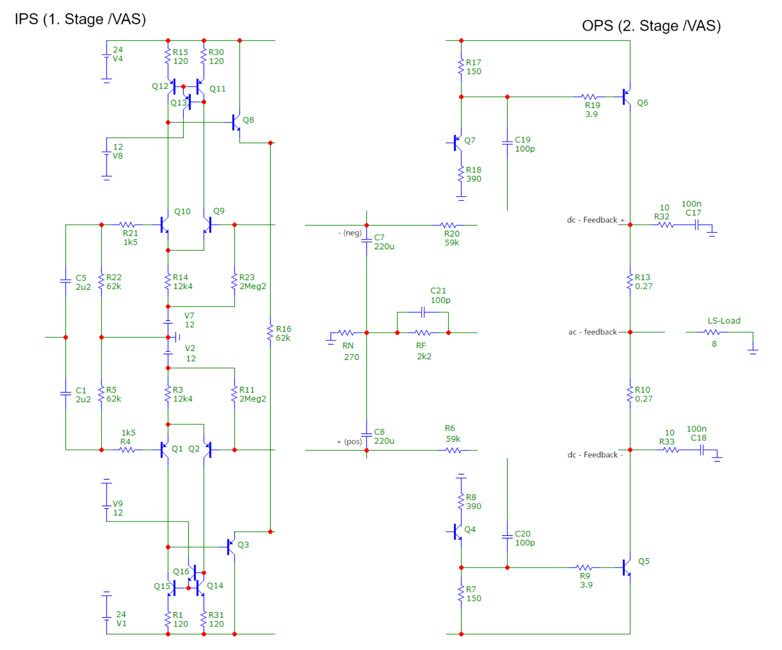

Both have 4 junctions in the signal path from input to output.
A1: ips - ef - ef - vas
My modification: ips - vas - ef - ef
Just a different arrangement.
A very decisive difference,
it is by no means as marginal as you would like to portray it here.
Either you can't distinguish the fundamental connections or you simply don't want to. Perhaps it's a question of education, a misunderstanding or simply a lack of specialist knowledge and the competence to make a fundamental analysis?

Unfortunately, your line-by-line description of the two fundamentally different concepts is misleading and simply not really 100% correct.

Voltage controlled current sources with feedback, to be precise.
Dear Bernhard,
As much as I would like to "like" this statement - it is also incorrect. The MF-A1 voltage amplifier is not a voltage-controlled current source.

Let's not just play down the fact to "the small difference." That's the only thing I want, because the difference is enormous.

"Just a different arrangement" [Bernhard]
And that number is now also off the table. Blameless goes A1 - just equal, but different!
