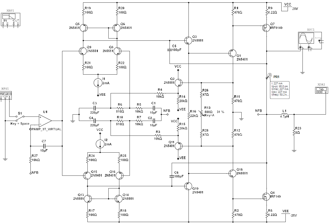

Keep original topology, add vertical feature (mirror) to increase olg, conceal the errors of the inferior ops to a certain extend.

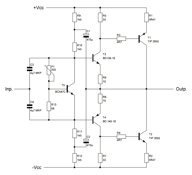

Dear Bernhard,It very looks like all attempts to improve the original schematic will lead to a standard design.
I can't agree with you. An improvement to an existing concept consistently forgoes a change in the concept and therefore also a fundamentally different topology.
You want to go for the three-level division with power. This perfectly encapsulates the voltage amplifier (the second stage), it is completely shielded from the input (the differential point) and the output (the emitter-follower). Not 100%, of course.
Of course, you can now play your very last trump card, the current-mirror in the collector circle of the differential amplifier. However, this is anything but an A1 that has been improved in detail, i.e. modified; it is a familiar power amplifier.
I assume that we are not talking at cross purposes, but that you know exactly why it is only a matter of comparing systems (concepts, topologies).
Perhaps you want to disguise it with the word “methods”?
Detailed improvements are not a gender change.
An MF-A1 (whose creator is said to be "Tim de Paravicini") must also remain an A1, the structure of the holding skeleton must remain unchanged.
Appodictically, one could also make other demands, according to which my extreme proposal (posting #98) would no longer be valid.

One chance to improve the original ops could be to substitute the power transistors with multiple parallel BD139 / 140.
8 x 8W = 64W

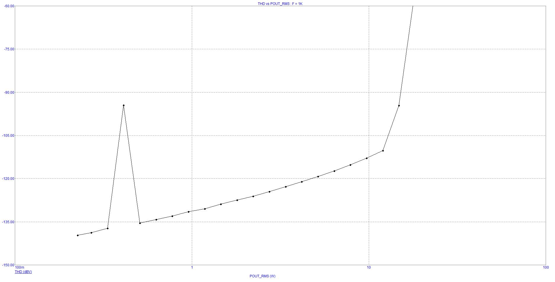

and now I regret to inform you that MC12 certifies that my suggestion has an even slightly better THD than your last throw.
I am very sorry, you have lost the competition by a very narrow margin.

I realize that,
so I'm attaching the circuit again - you can check it yourself. The models are known or can be found in the “Stellema thread”.
You might also like to try out the extension from posting #153.
Good luck with it.
I'll wait and put my money on “M0rton”.

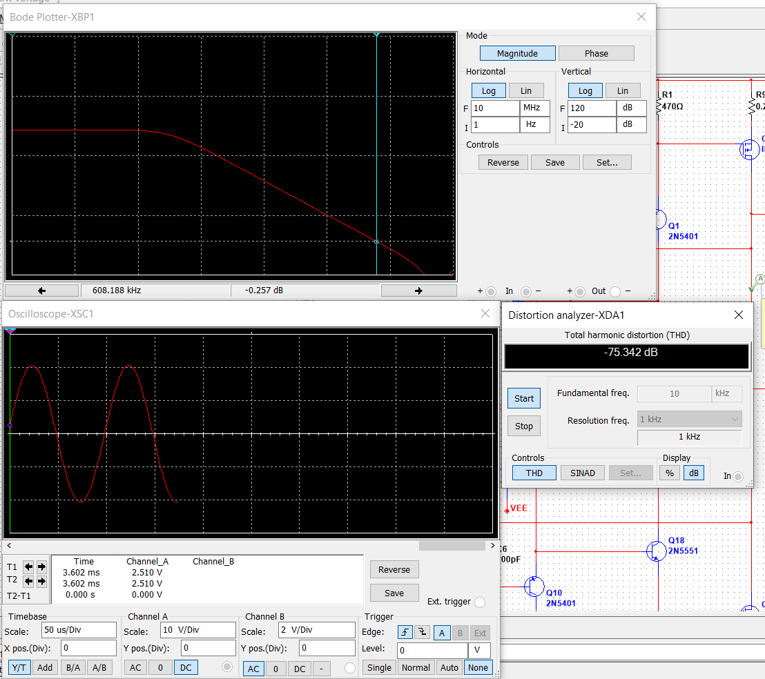

I believe this is the best one, A1 with current mirror, and MOSFET.
The opamp is required to get DC fixed. The amp itself has no idea where the output DC level is. Without the opamp, It would blow up your speakers easily.
With about 200ma bias, -75dB 10K THD into 8 Ohm at 25W.
