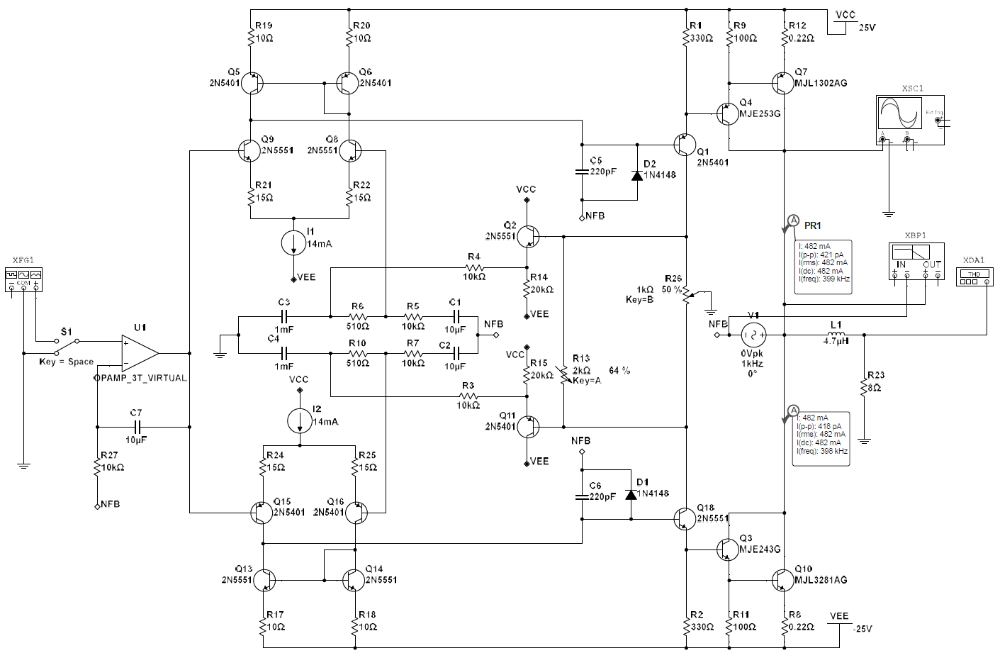

An A1 descendant - a relentless analysis

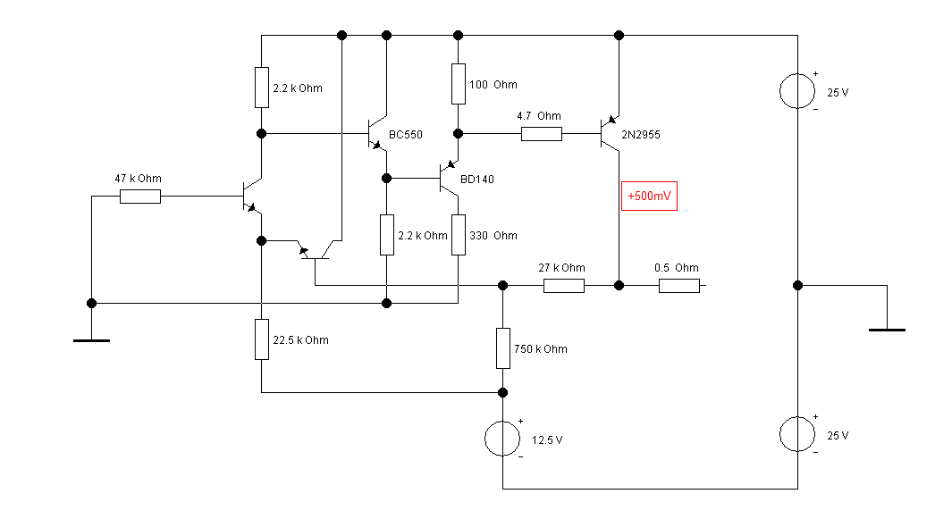

First, using current sensing feedback is just not working. The proper way is to clamp the sum of VBE, as below, the sum of voltage across R1 and R2 stays constant.
The output stage is using about 500ma in idle.

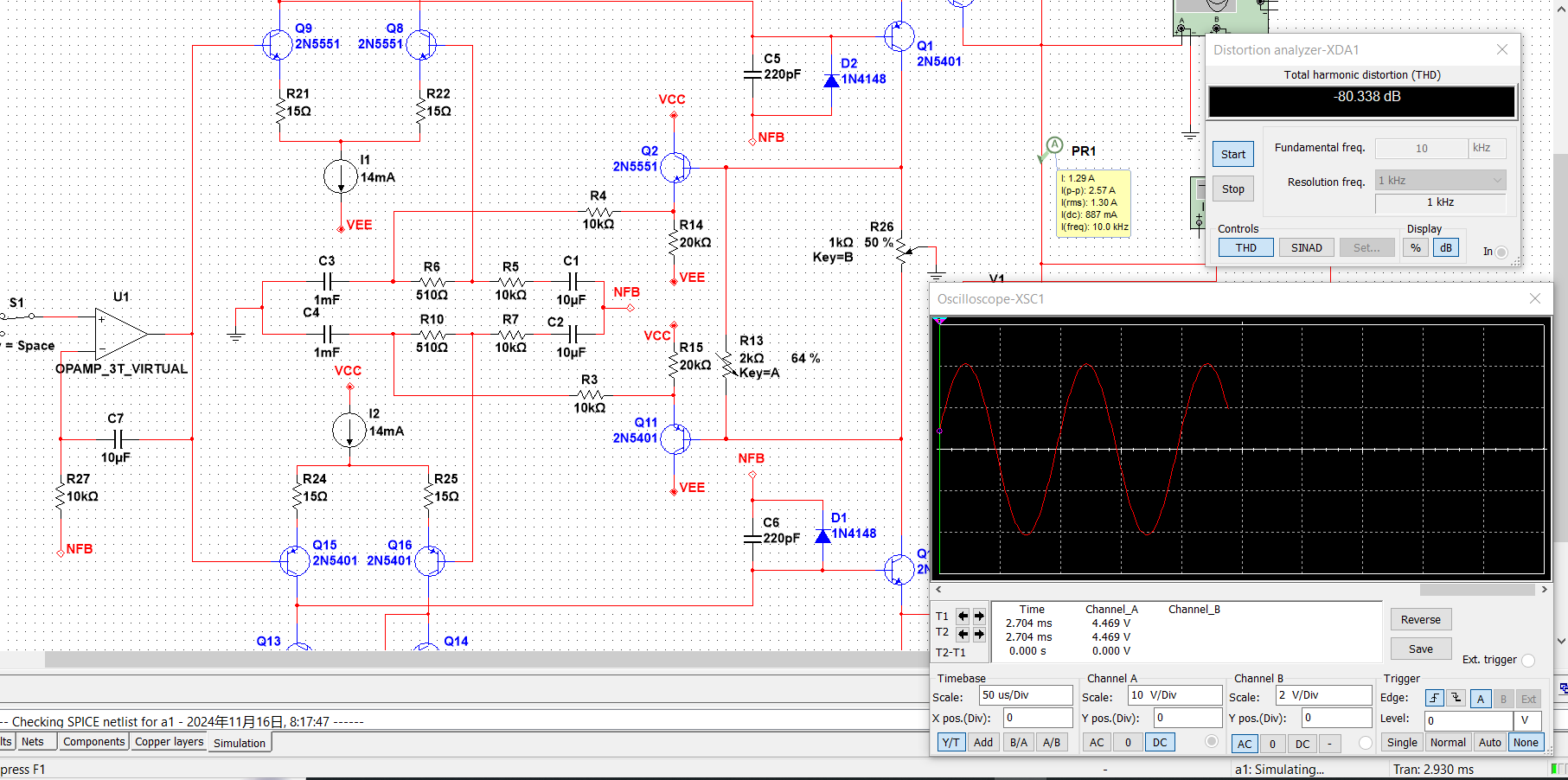

10KHz, 20Vpk into 8 Ohm, -80dB. (for your reference, the Blameless is about -82dB with my simulation suite)

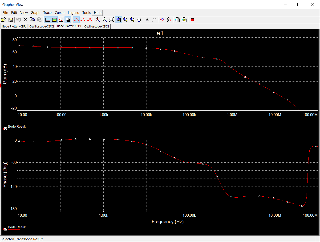

NFB around the output stage. As the output stage is nested in the Miller cap. The phase margin is lower, but it should not cause any issue.
Regarding stability. 1st. just use faster devices such as MJL3281A/MJL1302A.
To compensate, just use Miller compensation. It is the most effective way in my opinion.
If you nest Darlington topology in the Miller compensation loop, the 2 collectors of the transistors have to be tied together to eliminate a pole.
Like this.

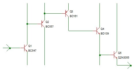

Look at the MFA1 topology, there s an IPS stage in common emitter driving two transistors in serial wich are both
connected as emitter followers, and the output transistor connected as common emitter provide the necessary voltage gain,
so yes, the OS is the actual VAS driven by a two transistors buffer wich itself is driven by the IPS.

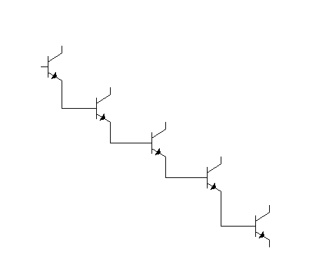

An yet you know that 4 bipolar transistors in serial between the input and output are not enough for very good perfs,
in a blameless there s 5, each providing a 100 Hfe on average for a grand total of 10^10 combined current gain.
(...) a grand total of 10^10 total current gain.
I_out / I_in = current gain (of the entire circuit)
2.24A / [(Vout/ voltage gain) / r_input]
In our case, this is around 24.000, regardless of which eye wash lotion is used.
---> Imax * dynamic input resistance ---> divided by the required input amplitude ===> current gain
Do you mean BETA, as a multiplication of ..?
End of communication,
HBt.
Generaly it is implemented this way, notice that the total gain is the same, and also, there s two common emitters
and three common collector, with 4 transistors you ll still have two as common emitters, like in the MFA1 or a blameless
without VAS enhancement, as two voltage gain stages are necessary given the low output amplitude of the IPS.

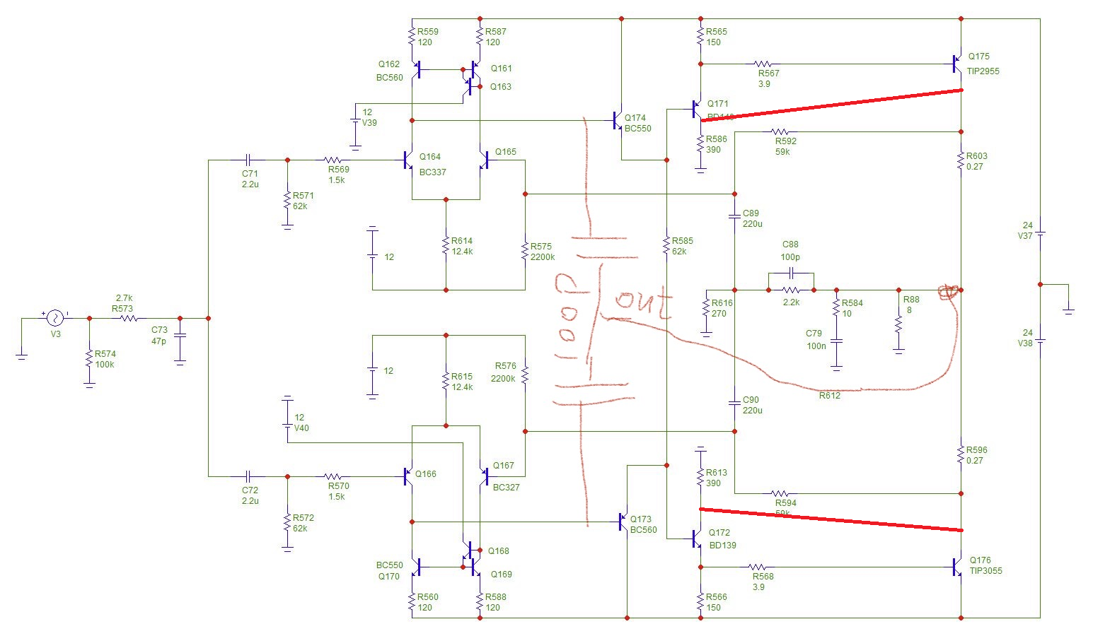

Two DC voltage regulators that compete with each other - and thus lead to the desired quiescent current, the praised class A operation.
The two halves of the circuit compete and each of the two tries to gain the upper hand, i.e. any extremely pimped A1 version can also tip over.
As soon as you couple both halves together, you no longer only have to solve the well-known safety issue of an HF oscillation tendency, but also have to precisely control (and adjust) the DC control behavior.
Any attempt at modification (i.e. the desire for improvement) can backfire. I would like to expressly warn against this at this point. Unfortunately, the mirror image must also correspond to the "other me" in all parameters. It just has to be a 100% complementary structure.
If we now slavishly pursue the demand for the utopian THD, then the problems chase each other; once one is eliminated, the other is happy (and gets up to mischief). For this reason alone, Bernhard will never bring the present design to maturity, let alone market his -240dB thd dream amplifier.

I want to say not to emphasise on THD too much. As long as it is be low a certain point, such as -70dB (@10K), or even -60dB, it should not be 1st priority.
A blameless 3055/2955 design. 30dB NFB over 10KHz. The THD is about -73dB @10KHz. You don't have to beat blameless to be successful.
For DIY, the circuit has to be attractive. A1 has it. The 2nd, it should be relative easy to build.

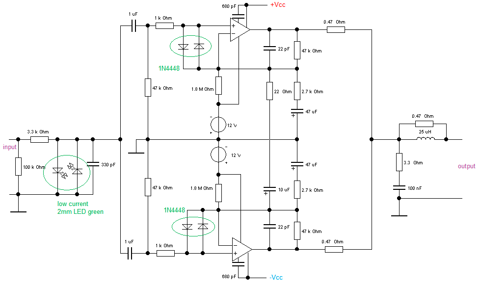

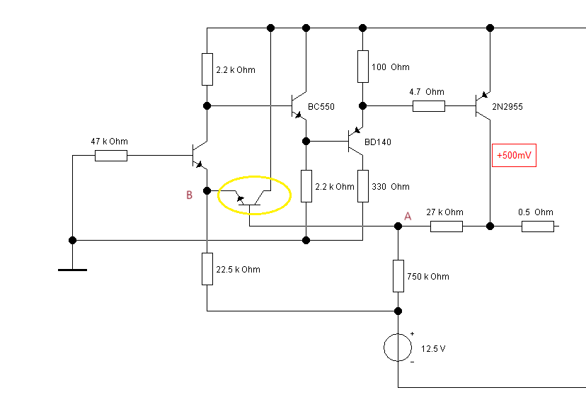

Thesis
In A1, the transistor marked in yellow is nothing more than an impedance converter. Between the negative feedback node B and the output node A.
An A1 must not be regarded as an IPS with differential amplifier on the input side, i.e. a balanced stage with a current mirror as collector load is counterproductive, in particular because of the DC voltage regulator actually present, whose reference point we modulate ac-like.
When viewed as an LPT, the optimization, especially the goal of the later powerful ac-global-voltage-feedback, is a mistake.

Open loop:
voltage gain for one half alone is greater than 100000. Current gain -> 618421053, do you think that might be enough? The correct answer to “this rhetorical question” is: Yes!
@Bernhard,
"bist Du ein Troll?" Are you a troll? I only want to deal with the A1 and not with you. If you can increase the OLG (voltage not current) of the original A1 in such a way that the entire system remains safe for negative feedback, then I would be happy to listen to you. If you just want to make a fuss, please do it somewhere else. Thank you.
