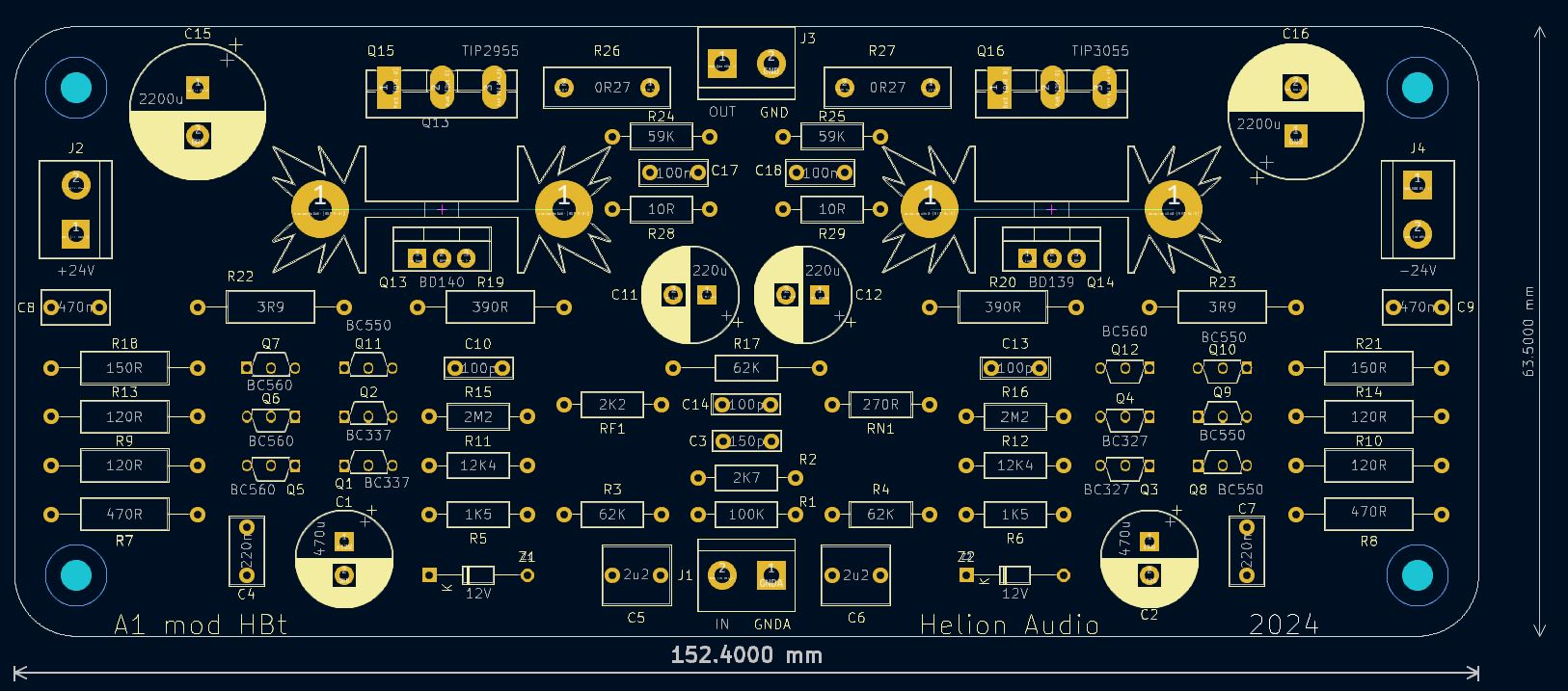

The layout already looks great, there are still at least six small components missing, namely the limiter - I'll come back to that later.
So wait a moment with further activities, I would like to have the absolute stability issue and other small details clarified here on this board and especially in this thread.

@wahab,Sort of, what is sure is that whatever mod you ll do to this half baked design you ll hardly make worse than the original schematic.
Why are you blowing the same hackneyed horn? Is it fun and does it promote your own satisfaction?
It would be constructive if you could explain to the readers (newcomers) why the two-stage (but symmetrical between the rails) **** has very specific limitations.
And perhaps where the fundamental differences to the EF lie.
Basically the whole program.
I'm so shocked now that I'm about to throw my original MF-A1 out the window - the topology is so bad compared to D. Self's “Blameless baptism”.

Didn't you ask me to do a simulation ? Now you don't like the results ?
Why don't you post your ac analysis screenshot, together with the schematic for reference ? Some problem with that ?
Where did you get the idea that I would built a prototype of your schematic ?
To the soldering irons, diy-warriors! - was meant as a motivational call directed to you and your team of course.
It seems hard for you to accept that the A1 output stage is inferior to EF. According to my simulation, EF is still 20 dB better.
Your choice is ideological.
Nonsense "Blödsinn"It seems hard for you to accept that the A1 output stage is inferior to EF
A1 is A1 not EF.
Nice "schön, na und ?"According to my simulation, EF is still 20 dB better.

of the MFA1 that s even worse as the 2N3055/MJ2955 has to provide both a current gain and a voltage gain
and doing both at the same time will yield very poor linearity, indeed using the VAS as final stage is a very
bad idea.
With a total of 4 transistors in the chain that make about 10^8 current gain, a blameless has 10^10 current gain,
whatever the way this gain will be used, either as voltage ampification or as current amplification.
No need to do so, even if it s more difficult phisicaly to upgrade than the 70s era Dual amps that were fully modular.I'm so shocked now that I'm about to throw my original MF-A1 out the window - the topology is so bad compared to D. Self's “Blameless baptism”.
Current mirrors would improve much this amp, but that s not enough, the 2N3055/MJ2955 should be replaced by a pair
of BDX66/67 or BDV64/65 to increase the whole chain s power gain, still, that would be inferior to a blameless using
the same component count but with the usual IPS + enhanced VAS + EF2 arrangement instead of the MFA1 s weird
IPS + enhanced VAS configuration.

The criticized working basis, i.e. circuit, from my posting #98 works perfectly (with my models) both in the modern MC12 and in my ancient PSPICE, completely without oscillation.
However, one point is really important with the A1 concept (including the offshoots): it must not be led into any form of saturation at any point. I.e. in our case P=20W: Vout=12.65V & Iout=1.58A (all RMS) marks the end of the line.
An input-side band limitation and a limiter should be used. How these are correctly dimensioned depends, among other things, on the selected overall amplification factor (and we are not talking about current gain here!), which should not actually be less than 24dB for the A1.
What is the situation? We have an idea with a THD_1k of significantly less than 0.001% under full load.
It's hard to call something like that scrap.

For me, the thread is dead and I ask that you refrain from spreading total nonsense. I'm logging off here, but will be happy to help via the PM function.
If M0rton still wants to finish the PCB project, I'd love it and would be delighted.
Warning
Possible instabilities cannot be ruled out in any project. There are exceptions, but A1 ideas are not one of them.
Warning
