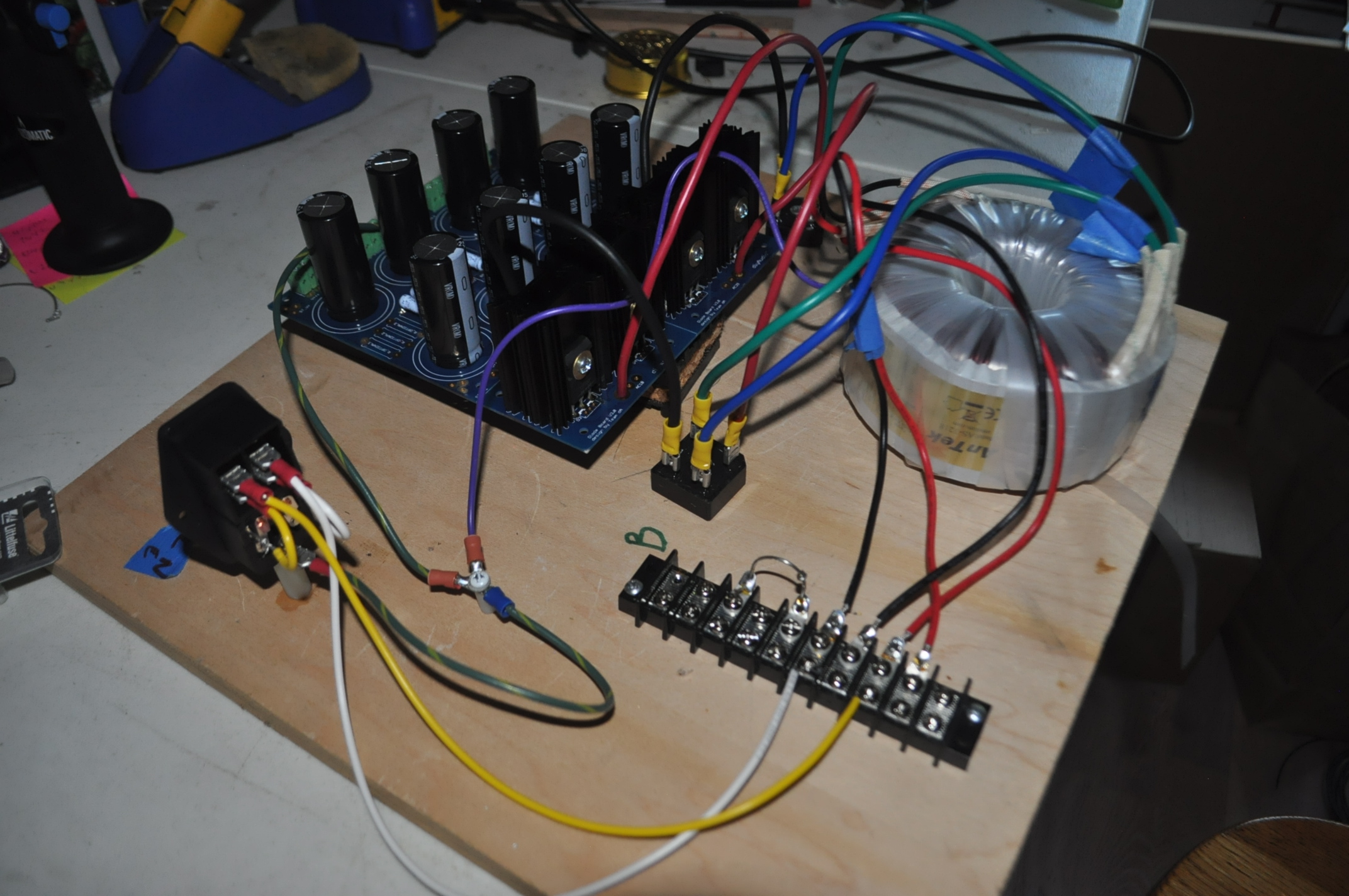

A wiring question if I may: I've tested for continuity and have pairs marked A & B.
A & B go to their respective bridge rectifier.
From the PS to the BR I have the neg. wires crossed. The part A side neg. goes to the B side +. Visa versa. I believe this is correct?

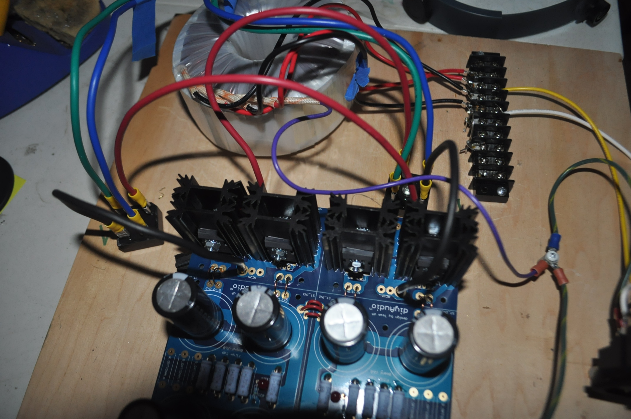

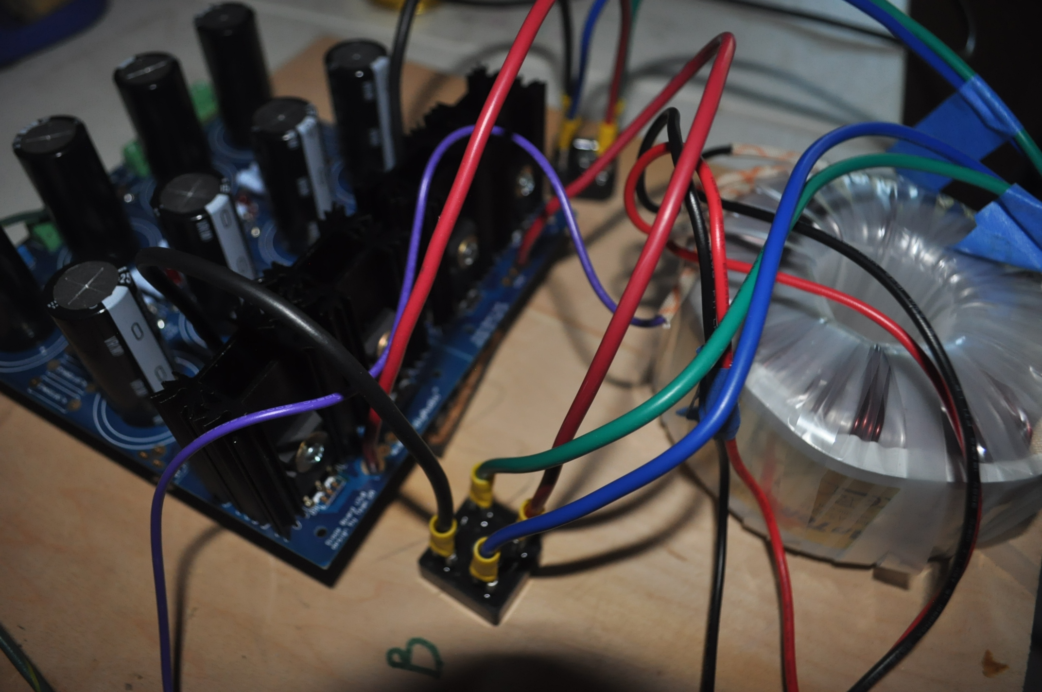

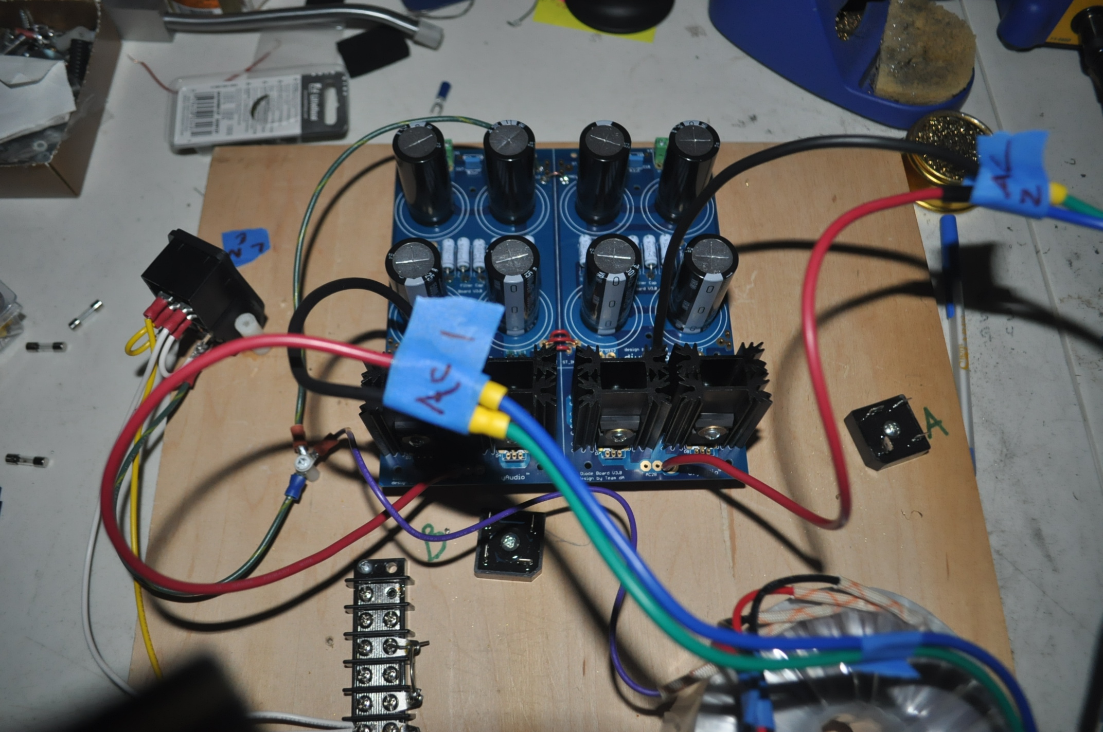

Sorry about the shadows. I have A & B side bridge rectifier marked.
A pair of primary wires to one, B primary's to the other'
The A red wire from the PS goes to the A rectifier, B red to B rectifier.
I have the B side neg. wire from the PS going to the A side rectifier & A side neg. to B side pos.
You're confused? I'm confused.
You have a bridge rectifier feeding another rectifier bridge (four discrete rectifiers) for both V+ and V- on the PS board. You only need one or the other, either the monolithic bridge rectifiers or the on-board discrete rectifiers.
Also the monolithic bridge rectifiers could possibly overheat if not bolted to a heat sink such as the bottom plate of a chassis. You have yours on a piece of wood.

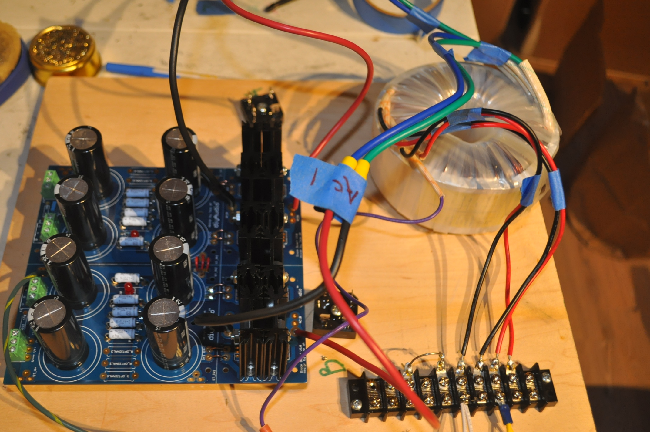

You have two sets of rectifiers. That's admirable, but it's not the way it's intended. If you're running the rectifiers on the PCB, then you don't need the monolithic rectifiers. I love that you were cool enough to post your pictures. This helps everyone learn.
What would you prefer to use, the monolithic or the ones you mounted to your boards?
If you're confident you've mounted the ones to the boards correctly, then... you may as well use those.

The monolithic are the units with the heat sink bolted to them on the PS board?
If I use those, the units I have screwed to the wood can be shelved and the transformer wired straight to the PS board? If so that will clean things up.
If I can put 120v to it using my DBT and it passes with the thermistors that would speed things up as I could put it in it chassis and then wait on delivery of the thermistors.
The discrete rectifiers with heat sinks are the ones soldered to the PS board. You can delete the monolithic bridges (the square units - they contain four rectifier diodes each).
