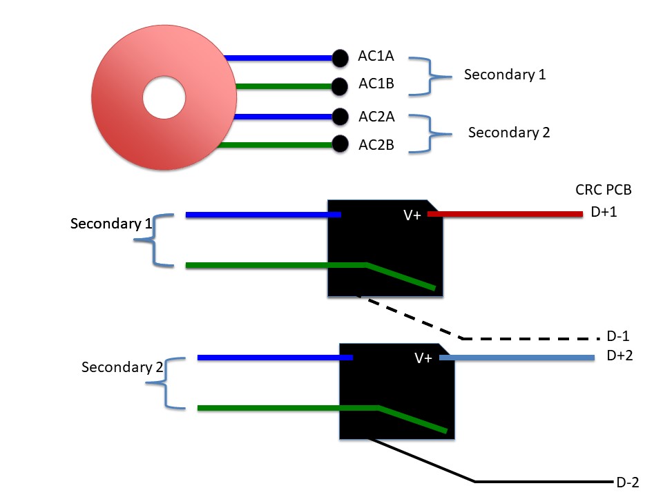

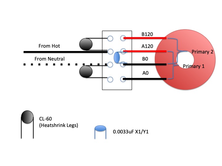

Here are the ones I created for my own use when I was trying to visualize it all. If you choose to use them and/or would like some mods/additions, let me know. Just (as you've always done) be sure to note that this is for 120VAC operation.
Edited to ask - Do you need from secondaries to rectifiers and rectifiers to CRC?

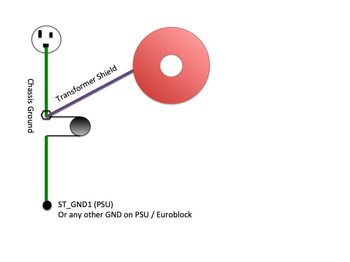

Just in case it may be helpful...
I used the wiring coloring from your guide and tweaked mine. Note: No one has reviewed any of these for exact electrical terms / correctness. They were good for my personal use, but If you're going to put it in a guide, I'd love for someone with 'real' knowledge to chime in. I love to help out where possible/practical, but I'm still a noob. I make LOTs of errors.

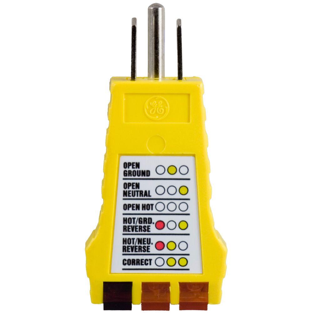

Wall socket tester, available at many stores:
Have one, my sockets are all good just jesting about my paranoia re guarding these fuses in neutral and hot.
I always double checked the FirstWatt PS drawing to line up from the plug/fuse IEC device all the way to the plug by continuity check.
This said, I have seen some preamp (not Pass related) that show fuse on the "big" blade style. I will look that up and comment later.

This is how I have always done it previously. Here, in post 17791, there is an example of the "RAW" PS, where fuse is in leg that goes to the larger blade. I have no doubt both the FirstWatt version here and Salas RAW are correct, just got me temporarily mixed up.

As far as RAW supply in the Salas unit, I will have to inquire there to know why fuse is in side going to the "big" blade, which is neutral. I am sure there is a reason.😕

Yes of course, but that's not what I'm talking about. With Antek's lead color scheme, (secondary A has 1 green and 1 blue lead, secondary B also has 1 green and 1 blue lead), it's possible to hook up one lead of secondary A and one lead of secondary B to rectifier bridge A; and another lead of secondary A and one lead of secondary B to rectifier bridge B.
Or you could wire it correctly, with both leads of secondary A connected to rectifier bridge A, and both leads of secondary B connected to rectifier bridge B.
Both of the above scenarios will look exactly the same to the human's eye, but of course are very different scenarios to the electrons.
Since the primaries are also 1 red, and 1 black lead each, it's very possible (likely?) that you can make a similar mistake wiring up the primaries, if you don't use a DMM to verify which red wire is connected to which black wire.
