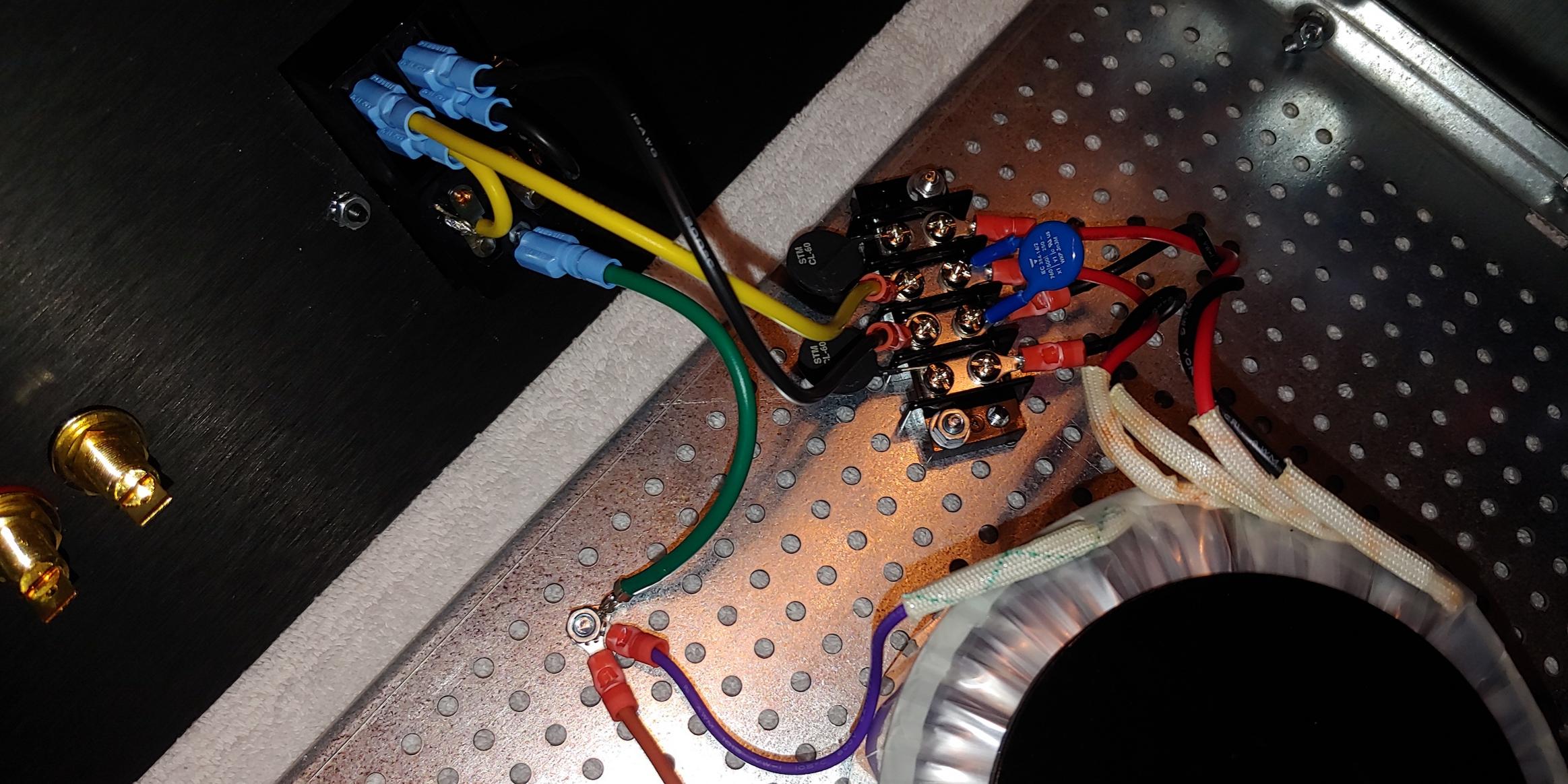

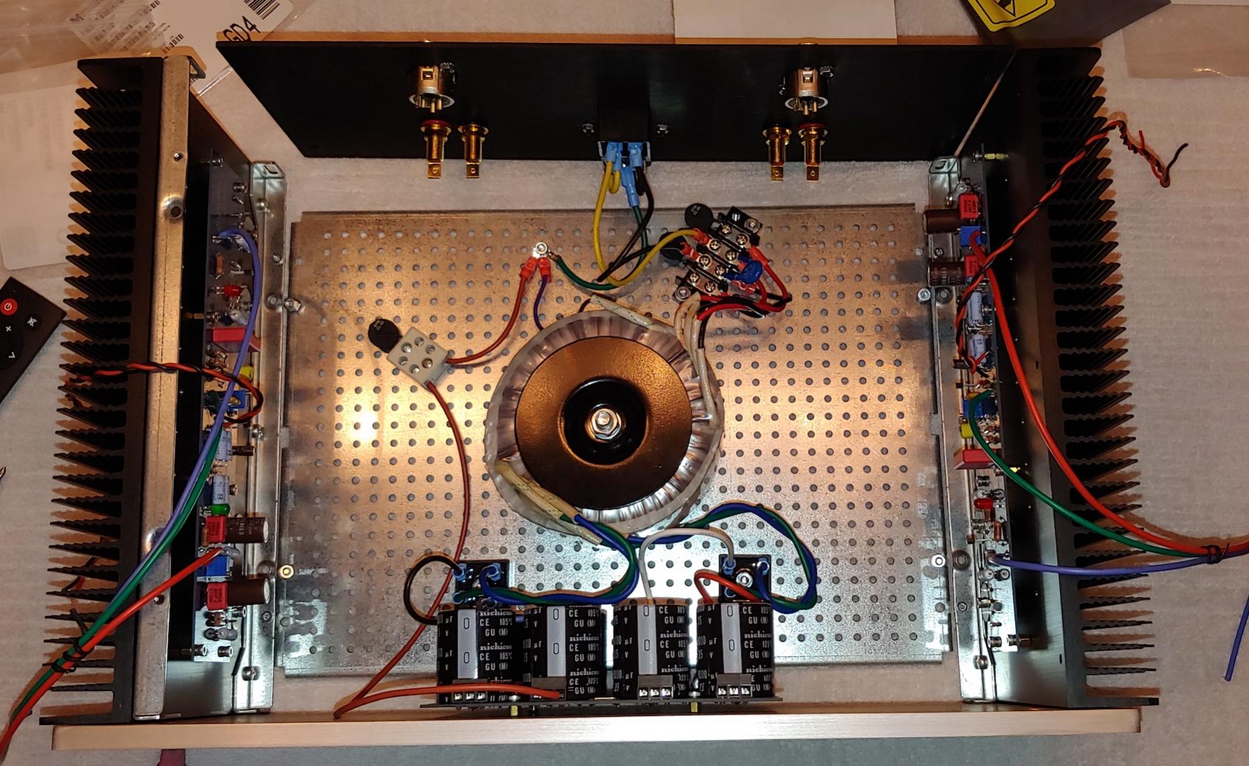

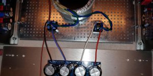

OK, while many of you are speeding ahead, I'm just now ready to test the power supply section. Two questions:
1. which fuse goes in which position in the power inlet module? I'm using the Schurter from the back panel kit, which has two fuses of different values.
2. anyone see anything drastically wrong in the photos? I've mounted the filter cap board to the front panel to keep things roomy. That meant an additional terminal block for the GND-to-CL60-to-chassis connection, and I assume connecting to the same chassis ground as the safety earth and transformer ground wire makes sense?

What? Uh oh....I guess I have been doing this all wrong these years. I assumed the fuses should both be the same, IIRC 3 amp slo-blo is what I used.
How should I have been doing this? I guess I totally missed the boat on this one!😱

What's that white square thing @ 10:00 next to the transformer?

If both the neutral and live lines are fused, the neutral line fuse should be of higher value such that the live line fuse will blow first.
The reason for that is if the neutral line blows instead, the live line is still active. Then if there is a short to the chassis, the chassis is live and if you touch the chassis and if you are grounded, electricity may pass through you to ground - a dangerous thing.
^^Exactly this.
In some places it's not allowed to fuse the neutral, so a 10A fuse on neutral should insure the properly-sized fuse on live to blow first.
So what's the point of having both live and neutral fused? Why even bother using a fuse on the neutral?
Oh ok. So if you were buying your own IEC power entry module, it'd be ok to get one with just 1 fuse, and fuse only the live then, correct?
Yes, and a single fuse IEC module will have the fuse in the live line. Then no problem unless your wall socket is wired incorrectly.
Also identify the live output of the IEC module so that the power switch is installed in the live line if switch is not built into the module. You do not want the neutral switched and the live unswitched. No problem if your switch switches both lines.
That's another terminal block, for connecting the CL60 thermistor between chassis and power supply board GND. If you mount the power supply board on the chassis floor, then you can just connect one CL60 leg to the board GND, and the other leg to the chassis floor. But since I'm mounting the board on the front panel, I needed a safe way to connect the CL60 to the chassis floor (and figured I'd just used the chassis ground that's already there for the IEC safety earth and the transformer purple ground wire.
I went with the white ceramic block (instead of the black plastic block) because someone on the forum suggested this connection could get hot in a fault case, so better to go with ceramic.
And another question. The large washers on the transistors. Do they serve a pourpose? Mine are a bit smaller.
Seems some people use them, some people don't. The DIYAudioStore backpanel kit for the 4U Deluxe chassis comes with a bunch of those large fender washers, so I figured might as well use them. I imagine the concept is that they spread the mounting force across the entire transistor, potentially making a better contact with the Keratherm and heat sink?
