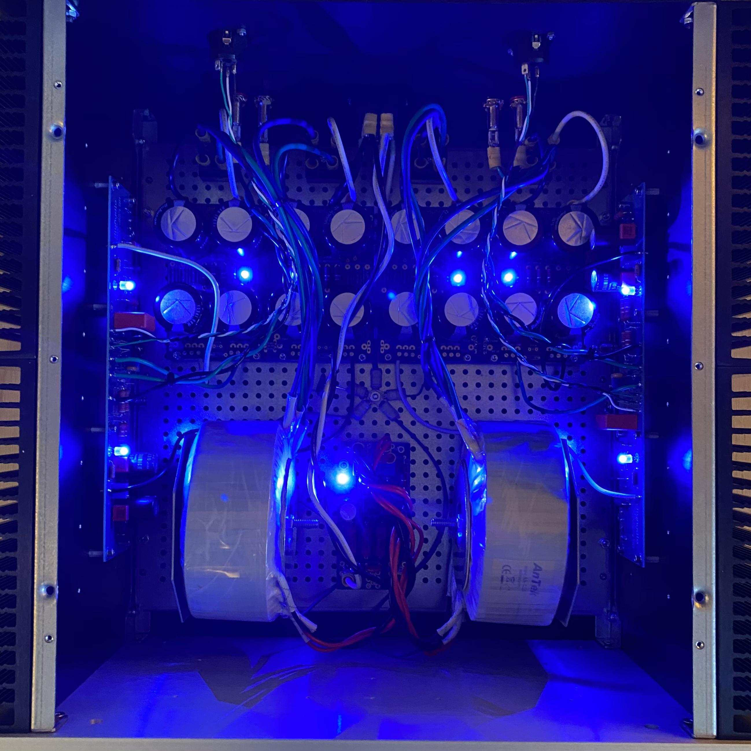

Well, last night I traced my dead channel to a bad jfet. Luckily I had another pair of matched LSJ74s on hand because I’d ordered them incorrectly from the store originally. Took out the original JFETs and put the new pair in and she fired right up. I was able to bias to .4V and damn near .000 on the offset. Got a test run in last night and sounds great. Dead quiet at idle through my Zu speakers which claim 101db. I mean dead quiet, no hiss or him or anything. No pops or noises at turn on/turn off. Letting it cook today and will check all the numbers then button it up.
I used XLR connections only, and built this with a full dual mono power supply and I used the store soft start board. I used Antek AS-4200 400VA transformers. I used the 5U chassis and it was pretty tight with two power supplies; I had to mount the toroids vertically with brackets. In retrospect...I might have splurged for two 4U mono blocks and had more room to work. Do the dual supplies sound better? Don’t know! I also used all blue LEDs, recommend this as it gives a nice blue glow; I don’t think I’d use red/green. Glad I went with one color. Also did not drill out the front panel for LEDs, which is ok but I might eventually want to do something on the front as it’s a big expanse of bare aluminum.
This was my second build, after an ACA. I made it a little harder on myself by going with the dual power supply but honestly that didn’t add too much complexity. No way I would have been able to even attempt this without this community and resource. Thanks to all of you for your time. And thanks again to 6L6 for his support.
