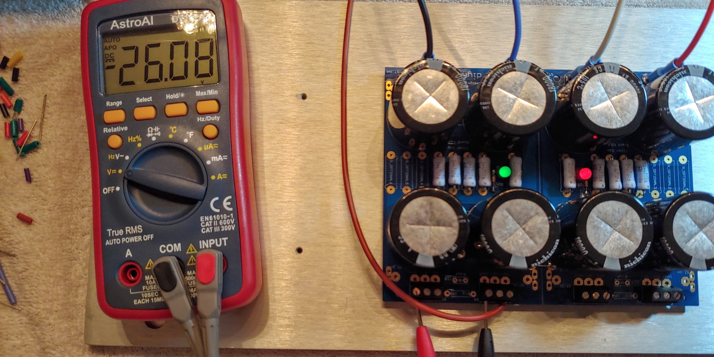

Is there a good way to test an amp board on its own if you don’t have a lab power supply?
Yes, you can build an amplifier successfully without a lab power supply. I would venture a guess that most of the builders here on diyAudio do not have a lab power supply.
The most important thing for a troublefree build is to build the power supply and amplifier boards correctly. That may seem obvious but there are many instances of diyers with build problems on diyAudio. That means taking your time, identifying parts before installing and soldering. Measure all resistors to confirm correct values before stuffing and soldering to boards. Compare with schematics and confirm. Confirm all component values and pin configurations and orientations of capacitors, diodes, transistors etc, before installing and soldering. Follow instructions where available. The same goes with wiring. Check and double check each wire location and placement. When in doubt, ask, don't assume or guess. The extra time taken will seem like nothing compared to the time of troubleshooting if you rush things and end up with a mistake.
The amplifier should be built and tested in stages. First build the power supply and test it. For the first powerup, connect it to a dim bulb tester. If it passes the dim bulb test, remove the dim bulb tester and power up and test for correct voltage and operation. If it passes the test then you have a functioning power supply.
The next step is to build one channel of the amplifier board. Connect it to the tested power supply and connect meters to measure the recommended voltages, and power up with the dim bulb tester in place. If it passes the test and the recommended measurements and adjustments are as expected, then remove the dim bulb tester and power up again, and adjust and measure as required.
Then build the other channel and repeat. It is best not to build both channel boards together to avoid identical mistakes being repeated on the second board.
After the first board is finished and tested successfully, it can also be used for reference when building the second board.
The key is to build and test in stages, and use a dim bulb tester with each initial power up.

Thanks for the posts above from @ItsAllInMyHead, @Dennis Hui, and @Ben Mah. Great advice there! I will try to incorporate it into my blog posts in the n00bs guide.
Speaking of which, I've posted the next installment, documenting my power supply assembly and test.
Building: Assembling and Testing the Power Supply
For the benefit of future n00bs, please let me know if I've goofed anything up.

re: testing with the dim bulb tester. It may be helpful to describe your experience re: timing with the 100W bulb. If you're feeling particularly generous and have the skills, a video would be incredible. If that's not practical, a more in-depth description may be appropriate. If it does not dim, stress could be placed on turning the power off ASAP. The dim bulb will not save you indefinitely.
Something like...
"Third, time to throw the switches and power it up. You should see the bulb briefly light and then dim (indicating that the filter capacitors have charged) and the two LEDs on the power supply board should light up."
Keep your hand on the power switch, if the bulb does not immediately begin to dim, then cut the power. If the bulb dims immediately, then you can grab your DMM to check the rail voltages.
Eventually, when you get to testing the boards and then testing / setting the final tweaks, it's inevitably asked why to remove the dim bulb tester or how it works / why etc.
