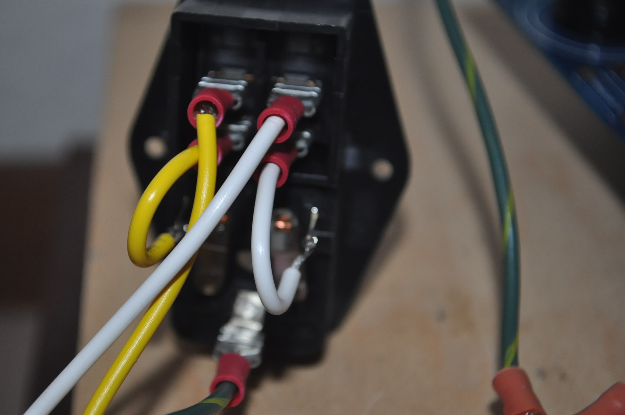

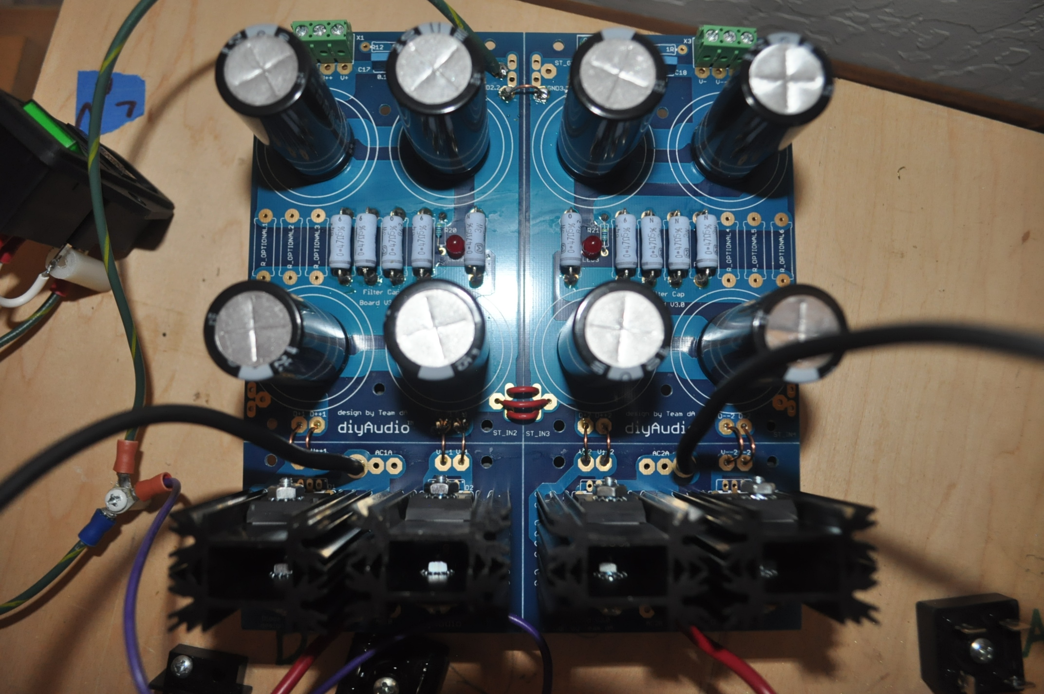

Your pics are pretty good, but if you already have or can jot down a basic sketch of your wiring diagram showing how you intended to hook everything up, it would also be helpful. If not, we may need more pics of specific areas.

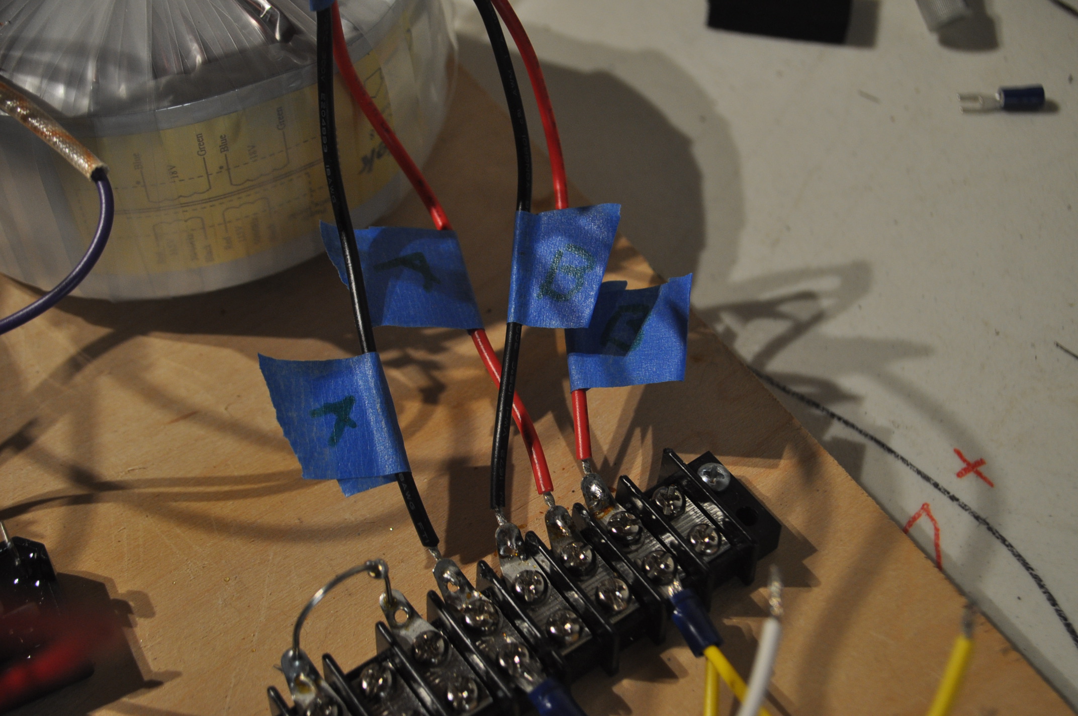

I have a quick question. The 4 wires going to the terminal strip are as shown in the drawings. I have the IEC wired with live going to red A and neutral to black B. No thermistors as of yet. Should I jumper A's & B's so everything has 120v?

At power On, with the Universal PSU board connected, LEDs should be On. Measure V+ out (from V+ or V++) to GND on the board, then do the same to the other channel. Record the values.

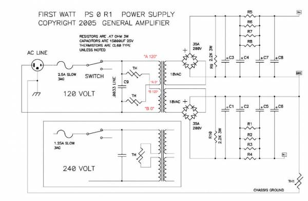

Within your context of your issue. See schematic below. Look where the two thermistors are in the circuit. Look at your terminal block. No connections between the primaries. That's why I had asked earlier if you were using a terminal block when you asked if you could test w/o the thermistors in place. Your latest pics were key.
So, you have a few options to proceed. Wait for thermistors or do a bit of rewiring.
Again, please allow at least one other person to confirm or say I'm nuts before proceeding. Also, if you have your fuses in place w/o the thermistors, they may (or may not) blow. I can't be sure. Proceed with that in mind.
