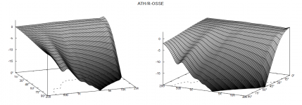

I mixed thinks up a bit. Ath seems to chose spherical/flat wavefront on its own. That does alter the peak >15kHz. It also seems to introduce the anomaly at lower frequency and higher angles.
So, does that mean that the bump is dependent on the wavefront type (spherical/flat)? I don't know what my driver has.
p.s. Changed k from 1.2984 to 1 also in this graph, but have seen it happen without also.
I can hear it already!- Let us know then at what SPL you hear a difference 🙂
That's hard to believe but maybe you have something in your script that mixes that up. The on-axis hole definitely emerges with a flat wavefront as the source.Ath seems to chose spherical/flat wavefront on its own.
Yea, I get the same DI bump around 500 Hz when I define the arc termination with arcterm=270. The overall shape looks quite the same to what you have but obviously something is different. The value of t at the junction (max curvature) in my case is ~0.922 and the arc radius is 30.3 mm with the center at [107.73; 194.56]. I used k=1.2984.
Yeah that low frequency DI hump is sound around the device, clearly visible now when diffraction backwave is eliminated with the midsized roundover on the lip. To get rid of this the roundover needs to be big like demonstrated earlier, it has to increase path length around the whole device. The whole thing needs to be shaped closer to a sphere than a mushroom to get rid of it.
The other option is to make smaller roundover on the lip to cure only the HF diffraction and leave LF main diffraction backwave be, which balances out this LF DI hump which is on passband because path length around the device at 500Hz is too short, the device is too small (depthwise) 😉
No, I don't think that's related.So, does that mean that the bump is dependent on the wavefront type (spherical/flat)?
Nobody knows what their driver has. Probably the best what you can hope for is a spherical wave corresponding to the exit angle (i.e. set Source.Shape = 1).I don't know what my driver has.
