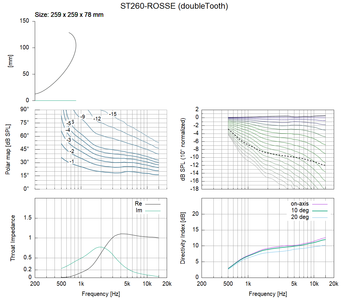

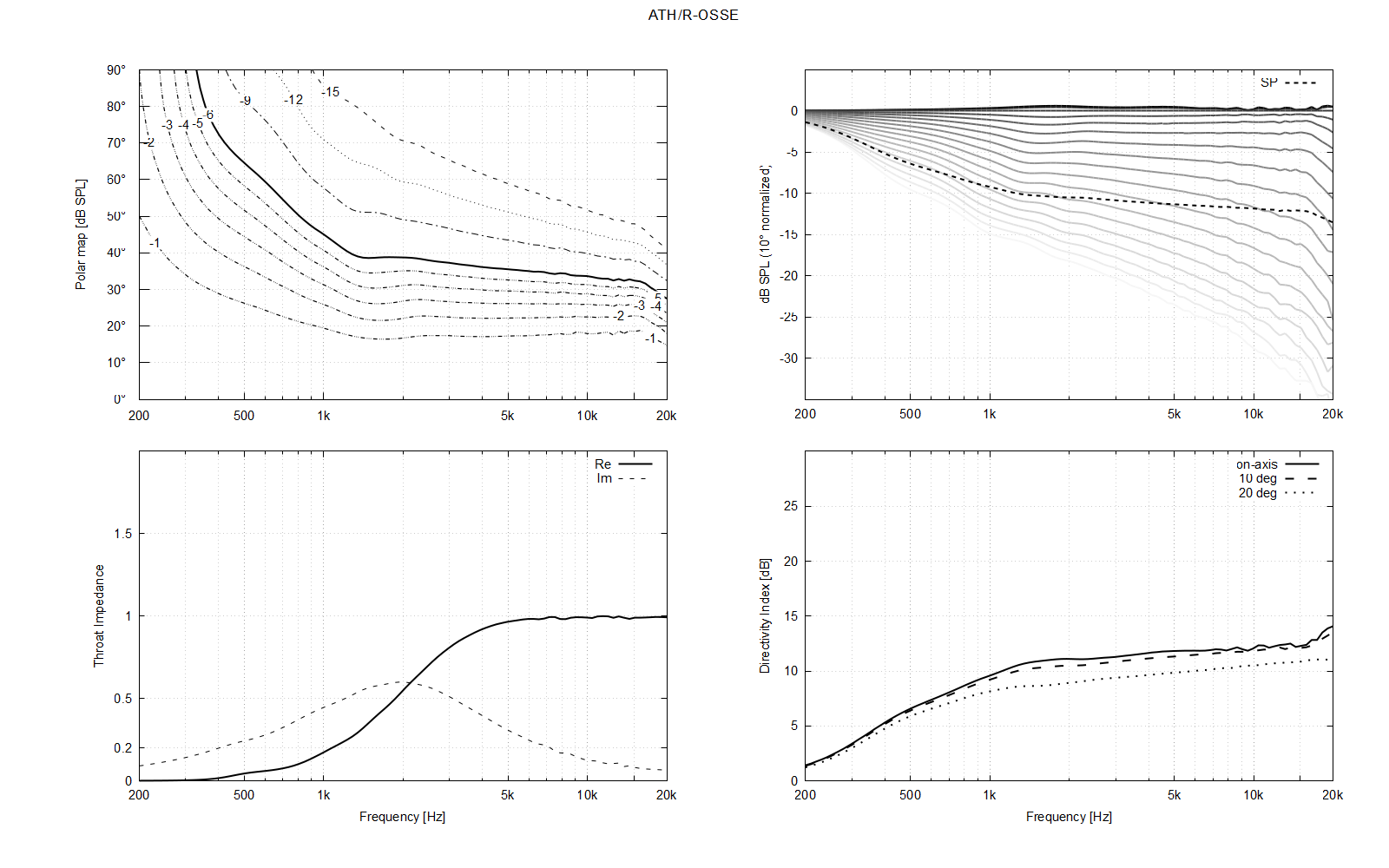

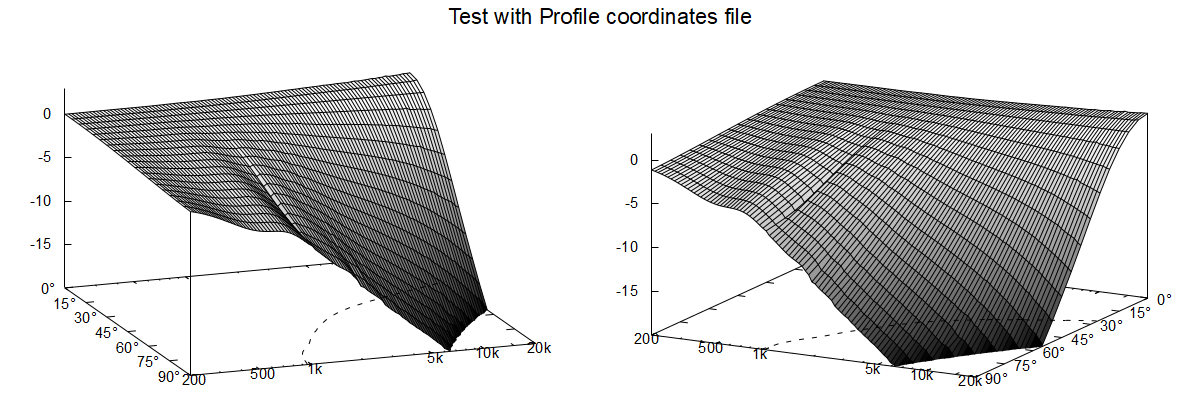

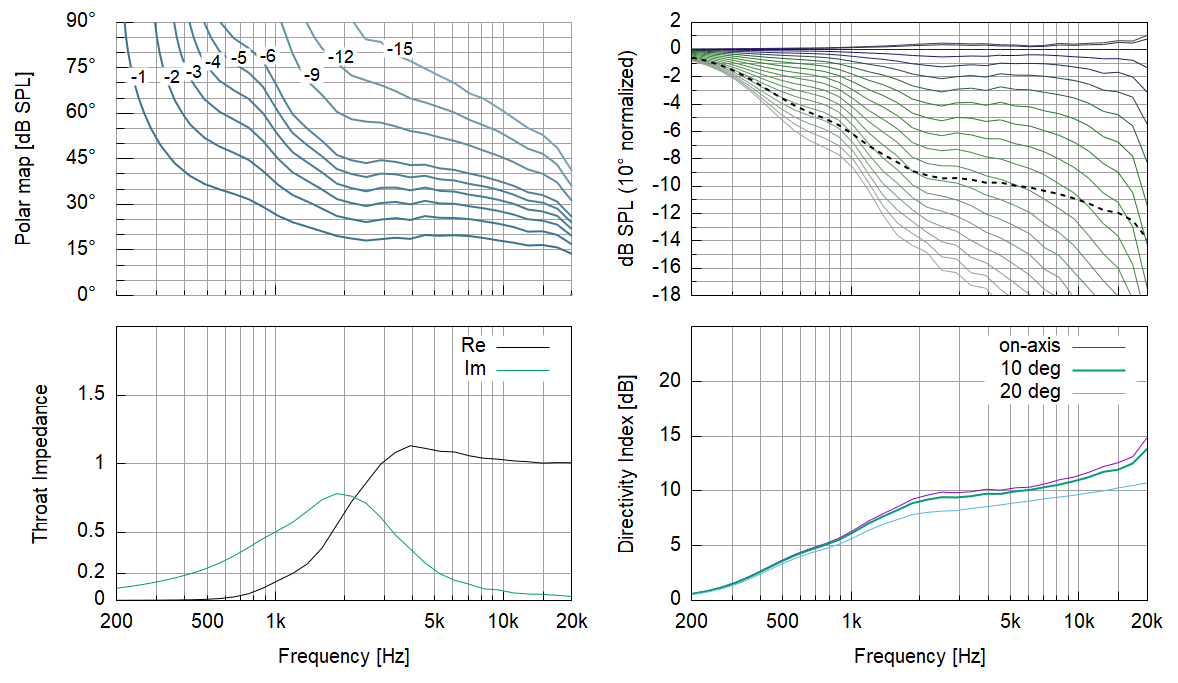

But Tom doesn't have that in his results. Can a slightly smaller arc radius, for example, make such a difference? Maybe it can.Yeah that low frequency DI hump is sound around the device, clearly visible now when diffraction backwave is eliminated with the extra roundover.
- There's a file with the final coordinates generated in the 'Results' directory, called 'coords.txt'. You can use this file to compare different profiles.
The last one has, while ealier one just before doesn't. I'm also curious why the earlier doesn't have such DI hump, hopefully it is not mixed up result attachments but true performance. I believe on the first one without the DI hump the low freq diffraction is balanced, in other words the rollback is sufficiently big to suppress ripple (diffraction backwave) on high frequencies but sufficiently small to leave diffraction backwave on the lows so that sound around device is balanced with the diffraction backwave resulting smooth graph, just like ST260 and others.
I need to get some evidence.That's hard to believe but maybe you have something in your script that mixes that up. The on-axis hole definitely emerges with a flat wavefront as the source.

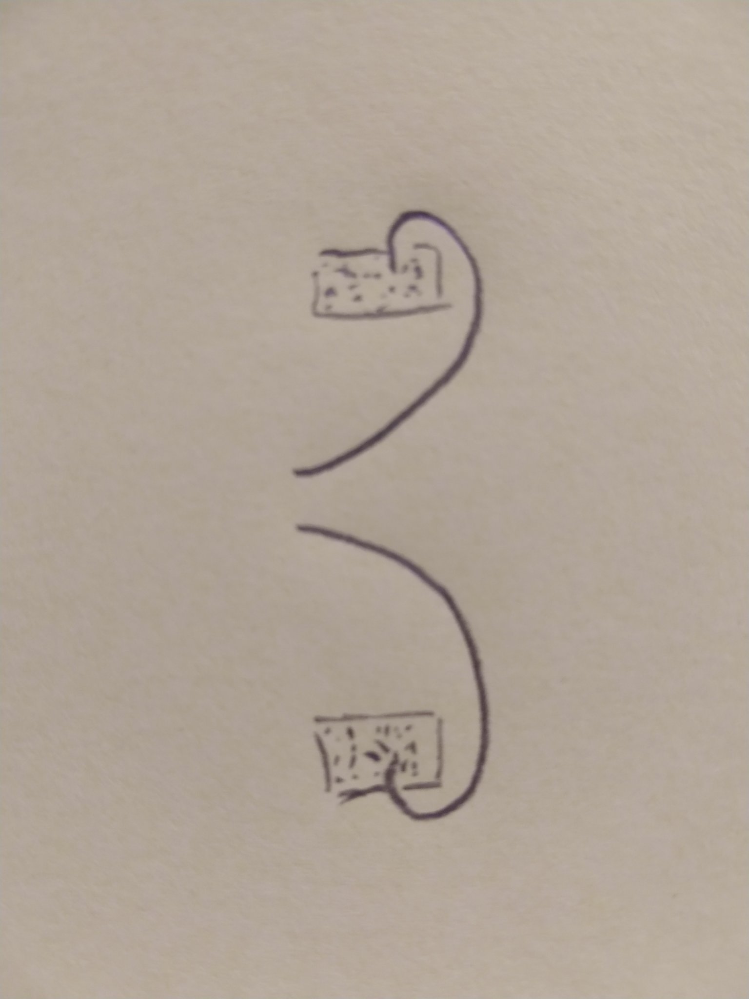

In the meantime, a small change in idea:
Rollover to 180 deg so on axis is free from ripple. Dump remaining sound in absorber so it doesn't get a chance to influence low frequency DI at high angles.
Unfortunately real-world damping is difficult to model (as I gathered from the previous discussions). Anyway, there's an option to add damping to any element in ABEC in the solving script I think. You would probably have try and measure this in real. Visually, this would be pretty non-obtrusive, should it work.
Wavelength of low frequency anomalies is about diameter of the waveguide, hense the foam block(s) would have to be quite big to be effective, at least 1/4wl in dimension so half R. Or just make the depth of the device similar to R with round shape.. broken record Well, all tricks are fine, I hope you get good device like that but I suspects only making backsie ~sphere will get really smooth results without side-effects.

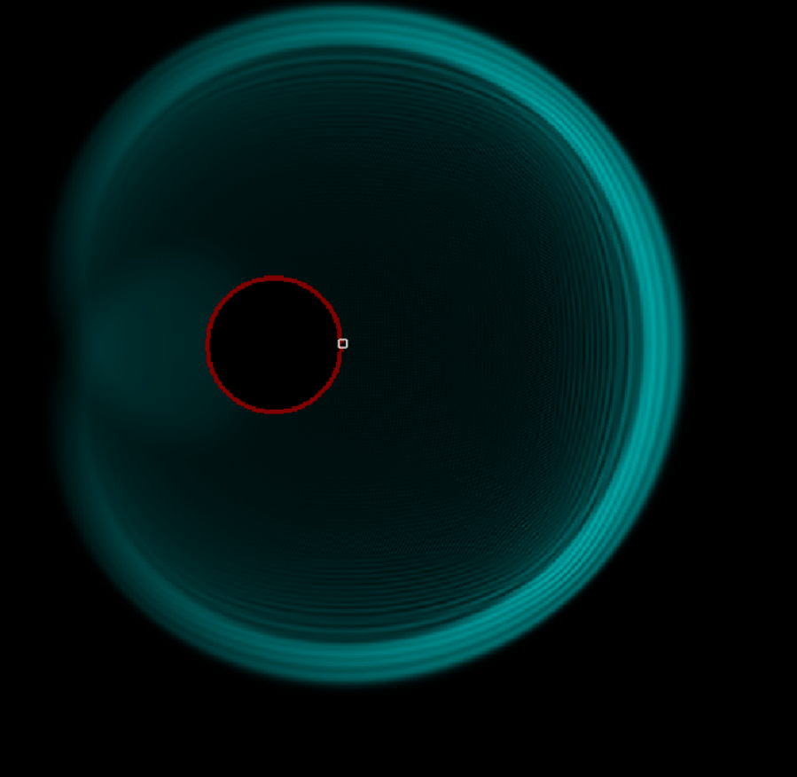

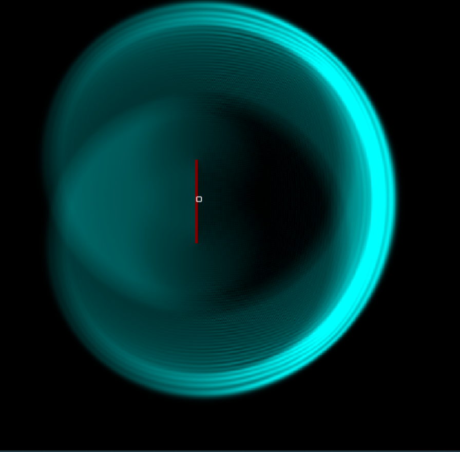

Basically, with small rollback on the lip the device outside dimension of depth is "flat" for device diameter sized wavelength. 5cm physical object dimension has almost no effect on 50cm wavelength, it doesn't stop it propagating but acts as relatively sharp corner. I'll simplify a waveguide to a stick in this ripple tank simulation example. Sound diffracts each end of the stick, expands towards opposite end of the stick on both sides and in opposite polarity. To 90 degrees (toward ends of sticks) the wave is propagating opposite polarity on each side and cancel out when they meet again at the other end but not toward listening window.
Listener would be on the right side of this image.
I'm in hurry so demonstrating round back shape with whole sphere, sound goes around "infinitely", no distinct diffraction backwave or secondary sounds making ripple. Basically sound "likes to" expand outwards like a bubble, only small portion of it goes (diffracts) around corners of an object. Some of the sound would go all around the object but only very little and much later as path length around the object here is about 2pi longer moving any interference at least octave down while mellowing them out.

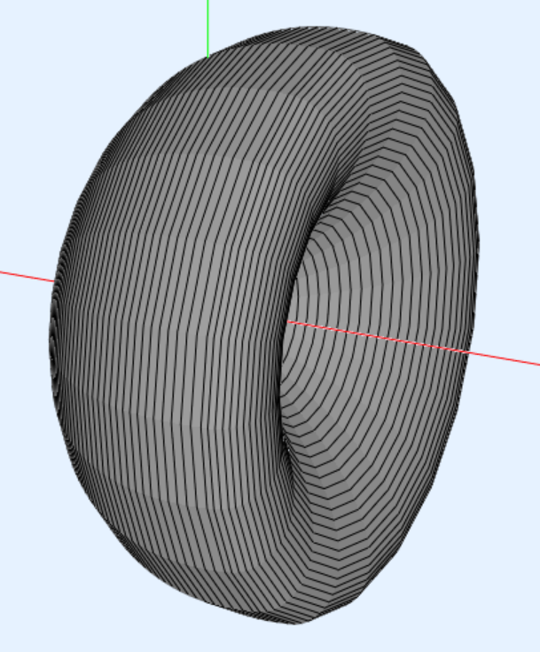

I sent the ST260 stl to JLPCB for printing in resin 8000 model. They ask me to double the thickness of the wall :
for enclosures with big size and unoccupied areas parts, have a potential risk of deformation and fracture during the printing and transportation, such as the models could be shrinking to the center and warping to the diagonal lines and edges.
We kindly suggest you to increase the wall thickness to 5.0mm to reduce the risk" "
this is the free standing model, any thougths, please, about that for the ones knowing that resin or company for their prints job ?

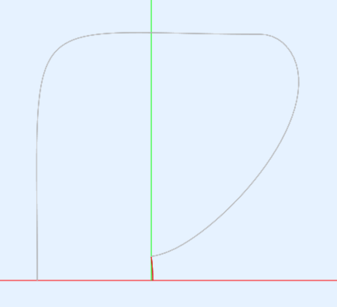

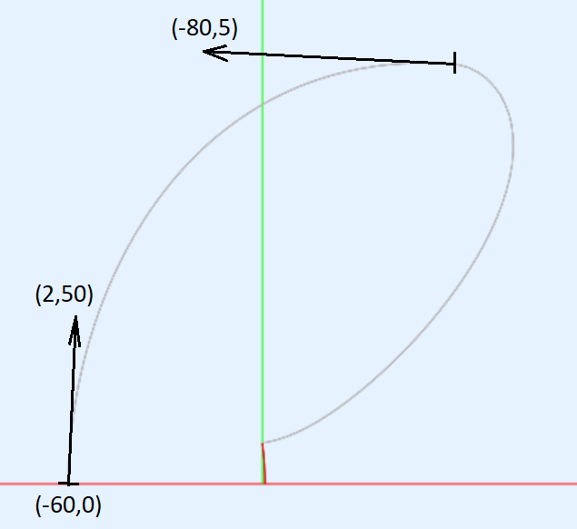

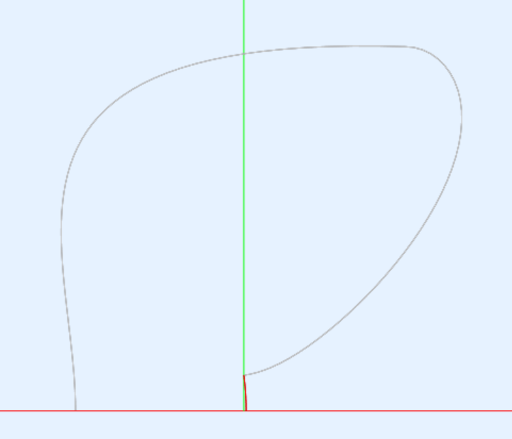

So the promised user-defined back side as a cubic Bezier curve:
Mesh.RearShape = 5 ; closed back
Mesh.RearCubic = -60,2,50,-80,5 ; [mm]
https://at-horns.eu/ext/ath-4.9.0-pre-230109-2.zip
You will lose LF directivity this way. To regain, you will probably need to increase the overall size. That's the drawback I see.

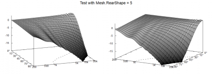

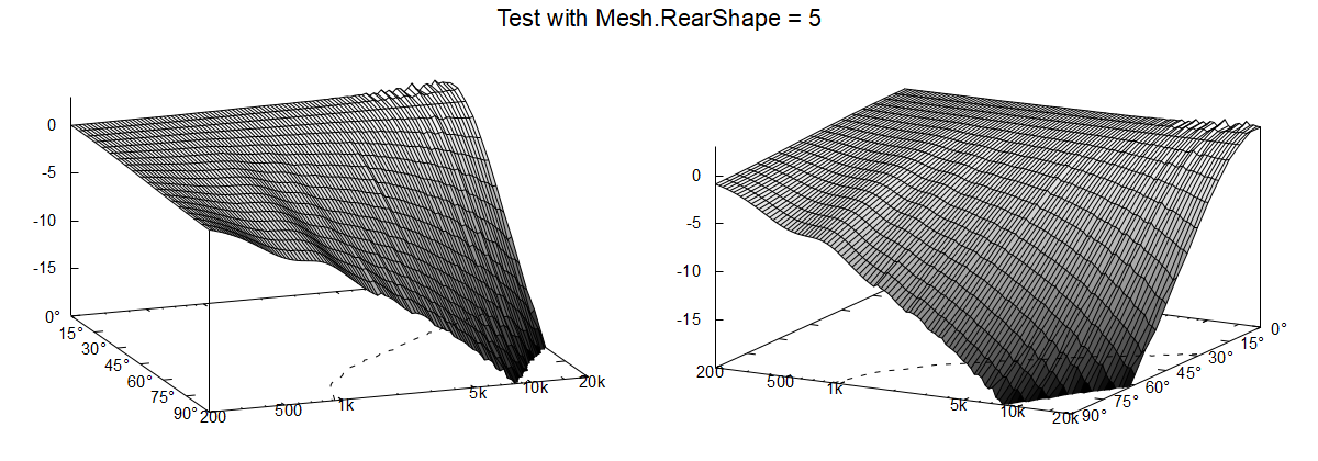

Thank you very much on this My results seem to have hair on HF, which is probably due to some other mesh settings, have you had this?So the promised user-defined back side as a cubic Bezier curve:
View attachment 1128260 View attachment 1128258

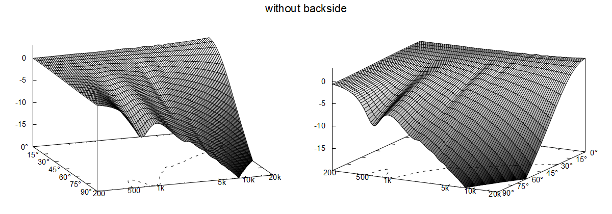

The same settings work fine without the backside
Without backside
Same script as above but with backside, looks some kind of noise. Any idea which setting could make it? I'll try some other profiles and report if its this one that somehow has it.
Should look closer to this
Main visual difference is that the first and last without the noise are open on the back like usual. The new one with noise is closed from the back, probably purposely?
