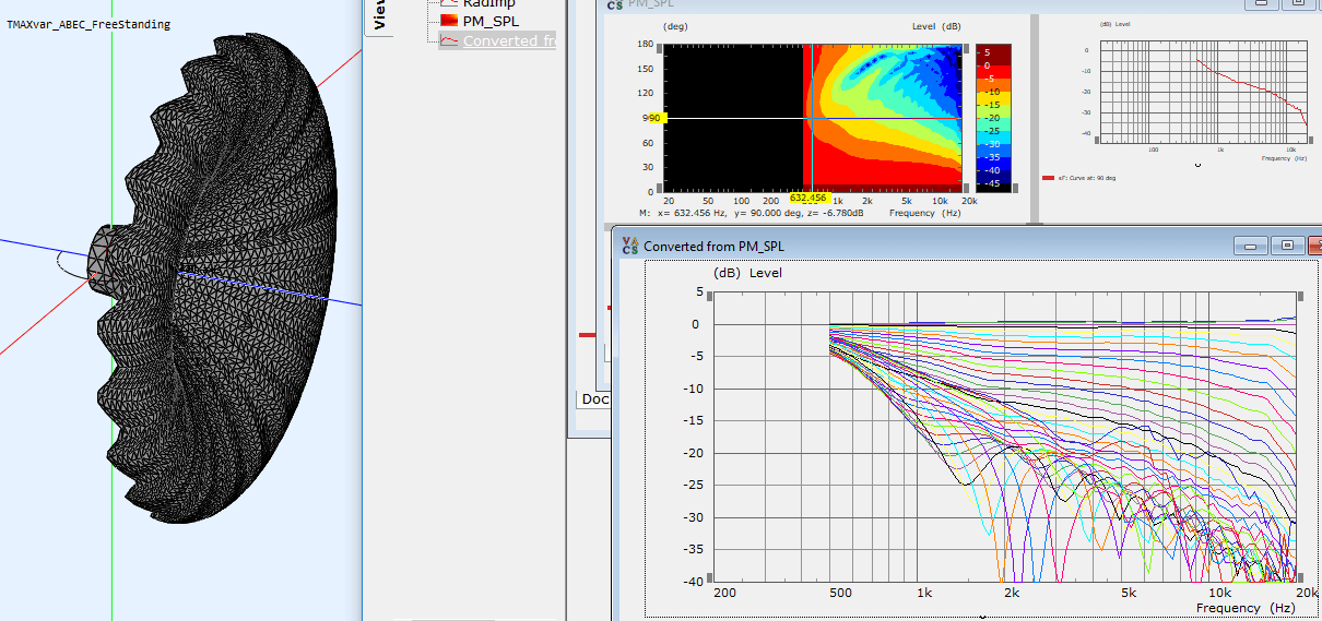

Both projects created by ath and the ABEC3 one you posted here result in very weird outcomes. No idea what is wrong...The rest is on you guys

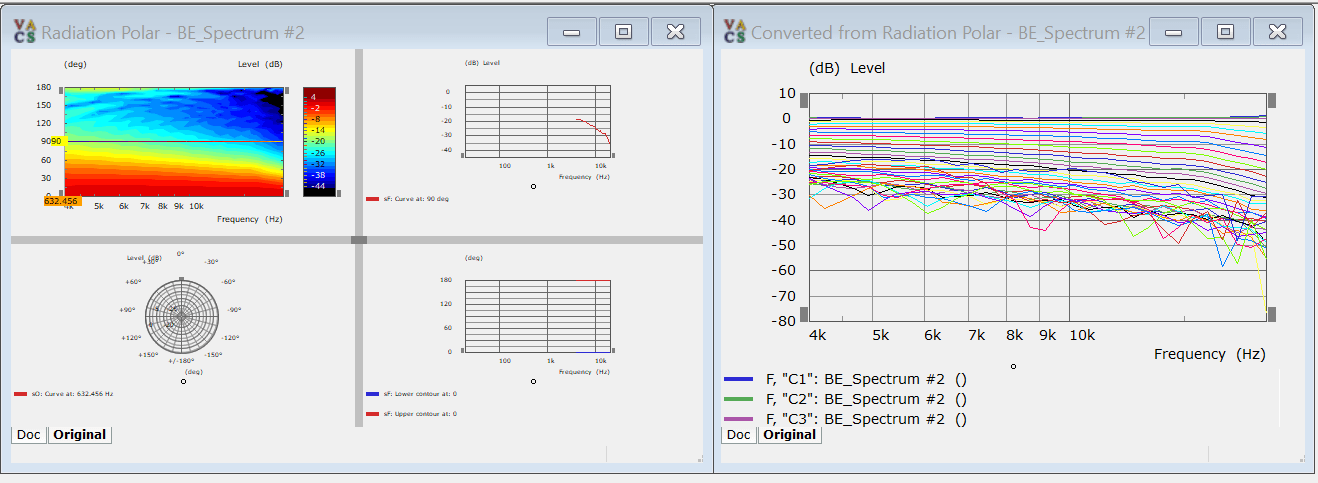

Does anyone here have the diaphragm & surround dimensions for: Scanspeak 6640 or SB/Satori Be or TX tweeters? Also, anyone try to model and AMT and horn?

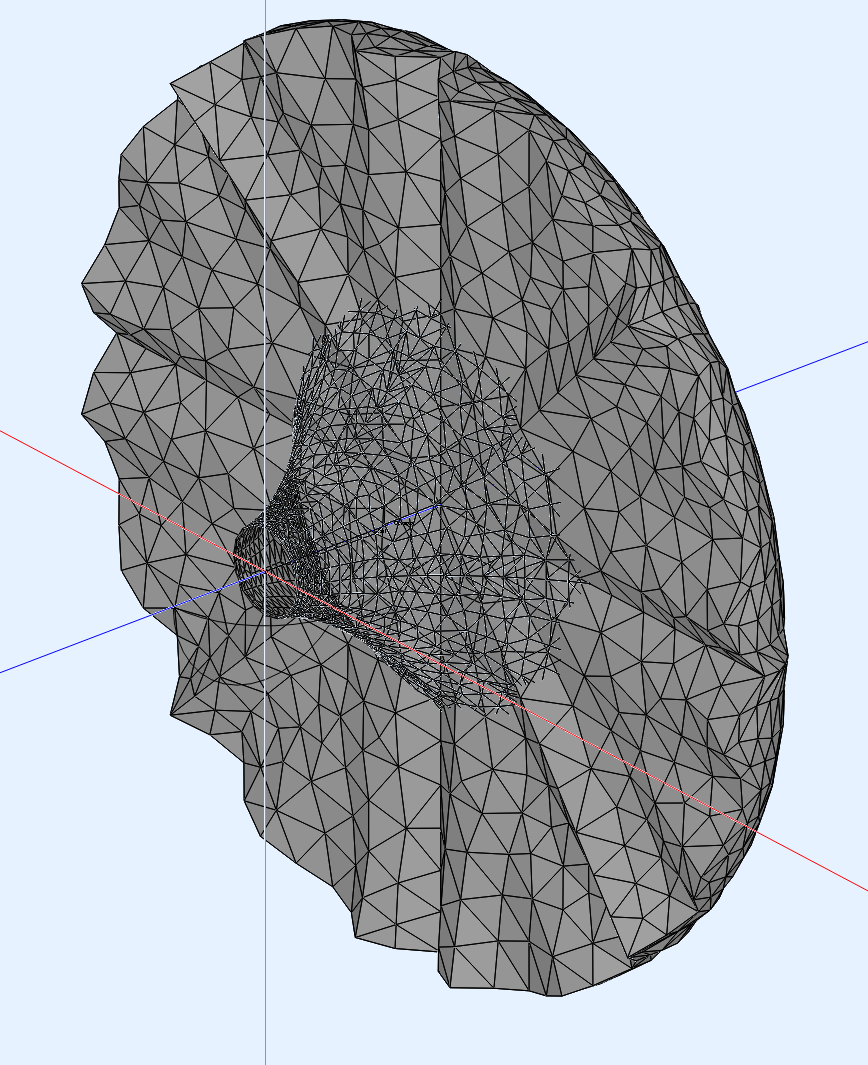

Strange, it works on my PC perfectly.Both projects created by ath and the ABEC3 one you posted here result in very weird outcomes. No idea what is wrong...
Probably pebcak...

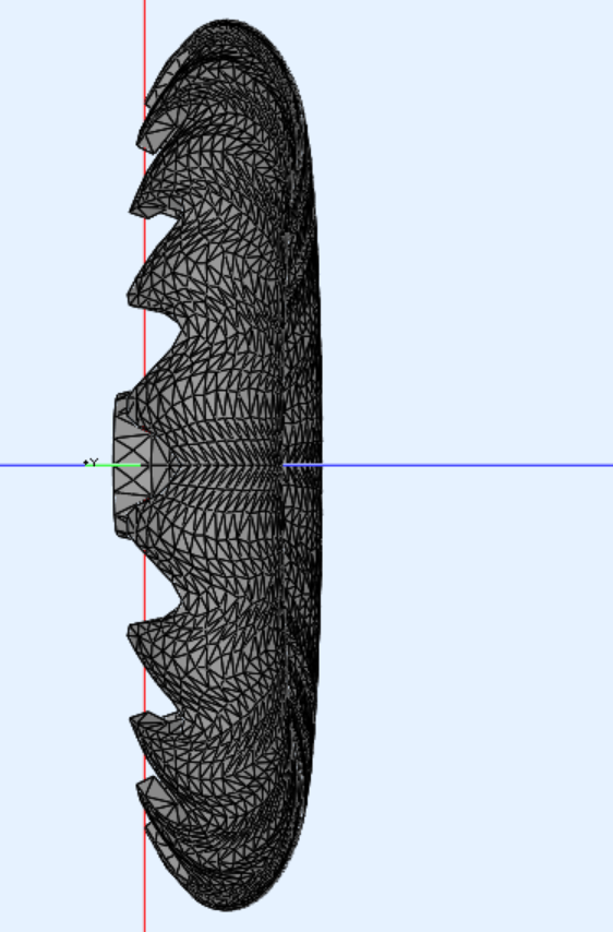

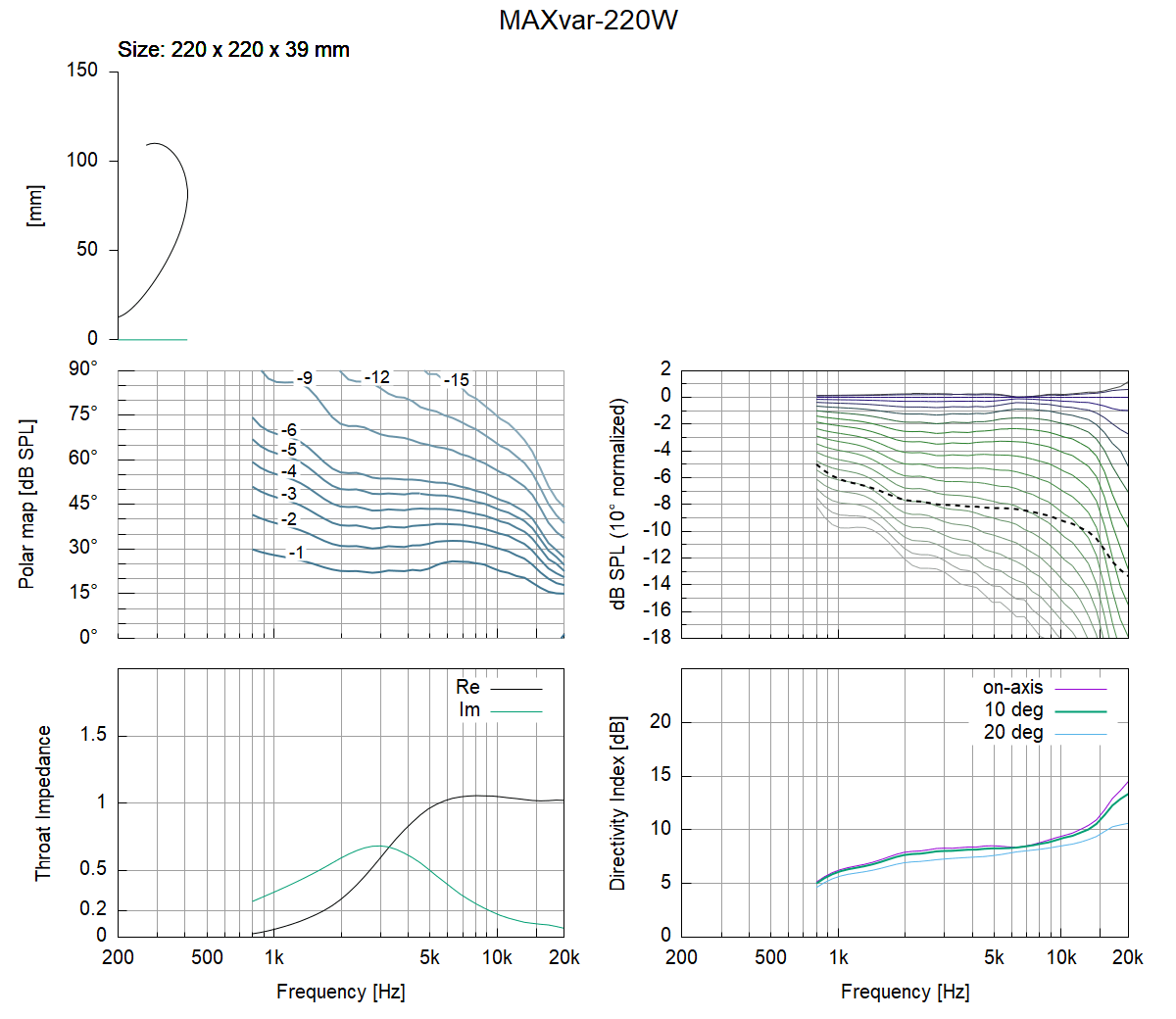

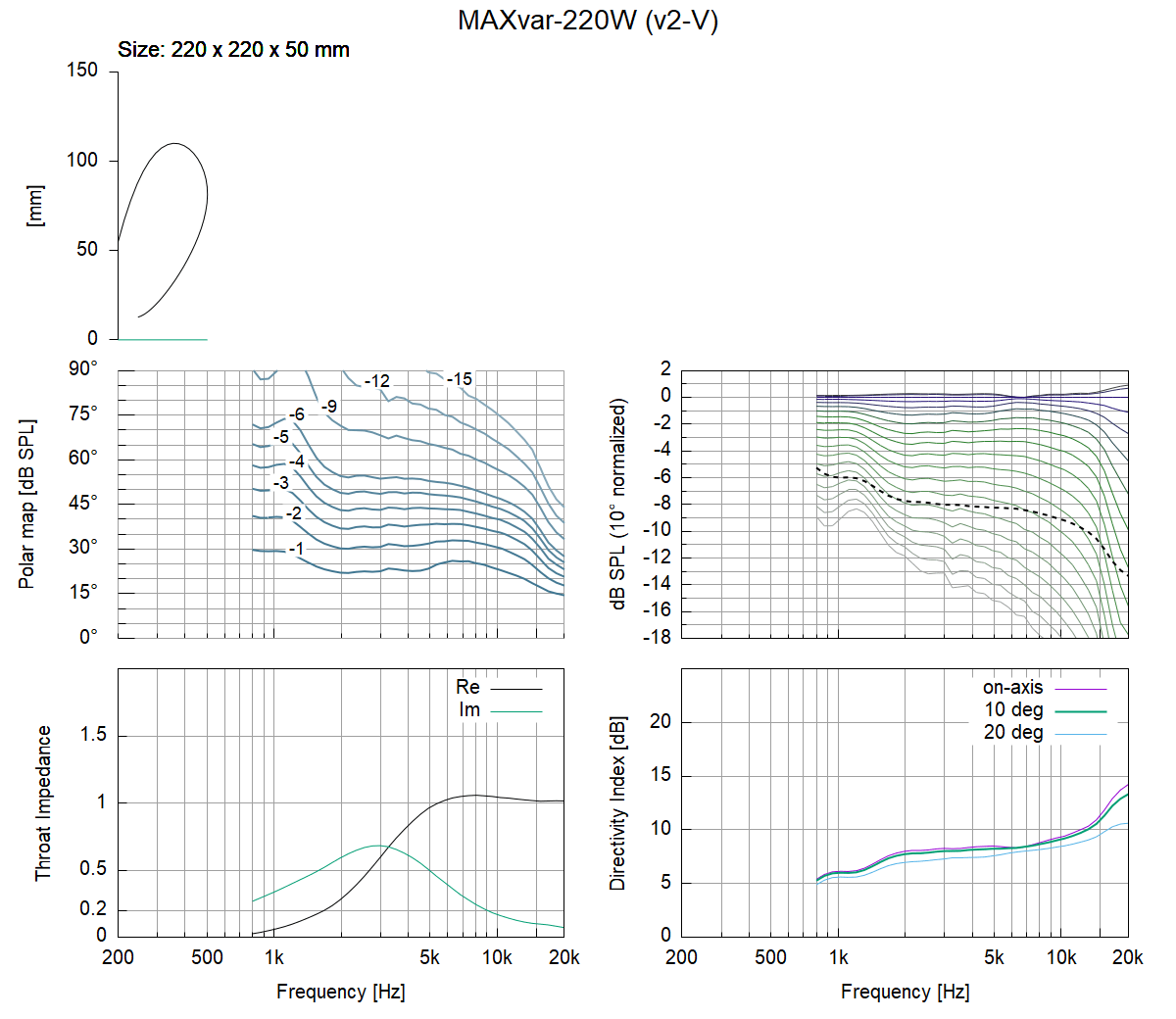

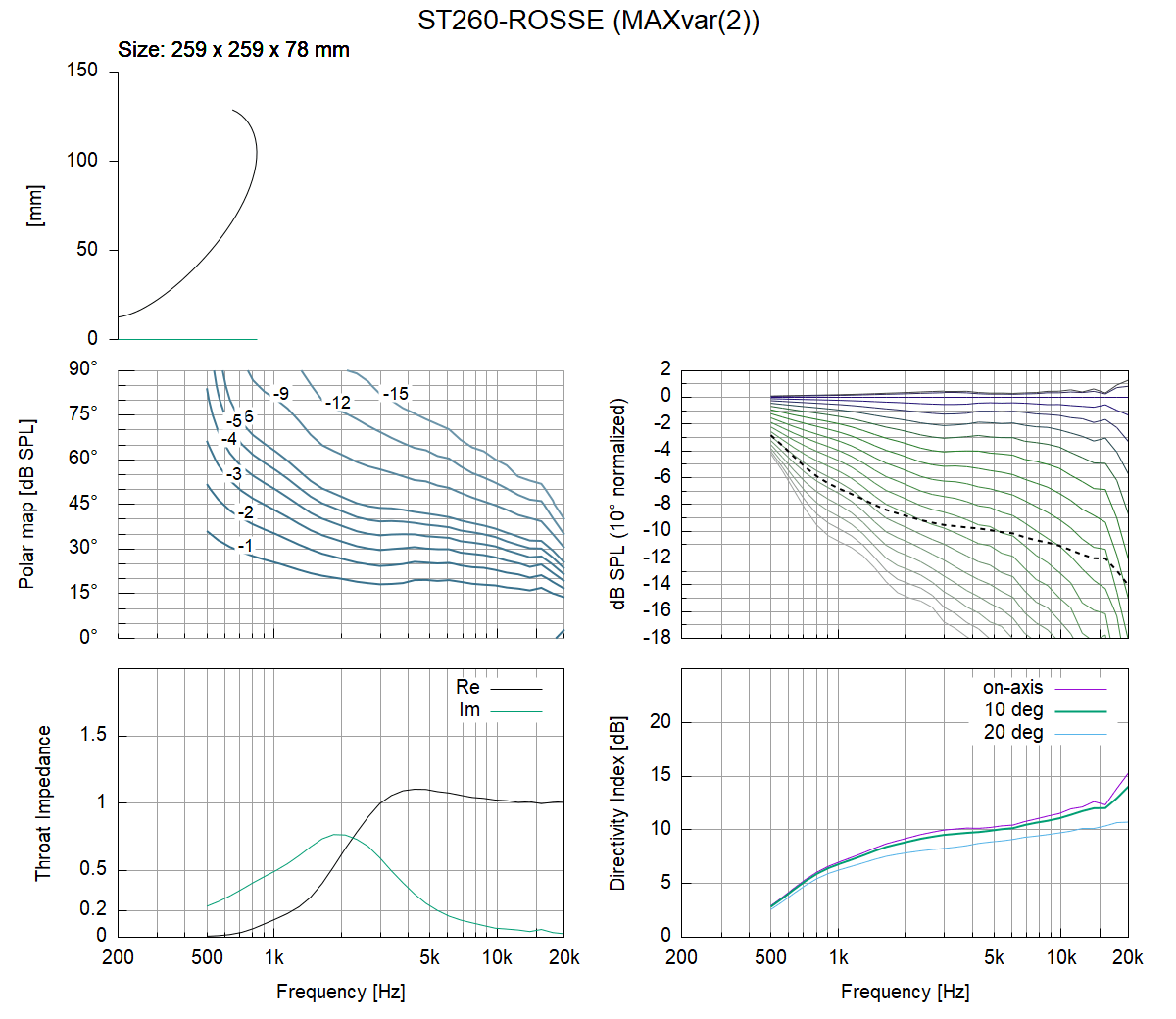

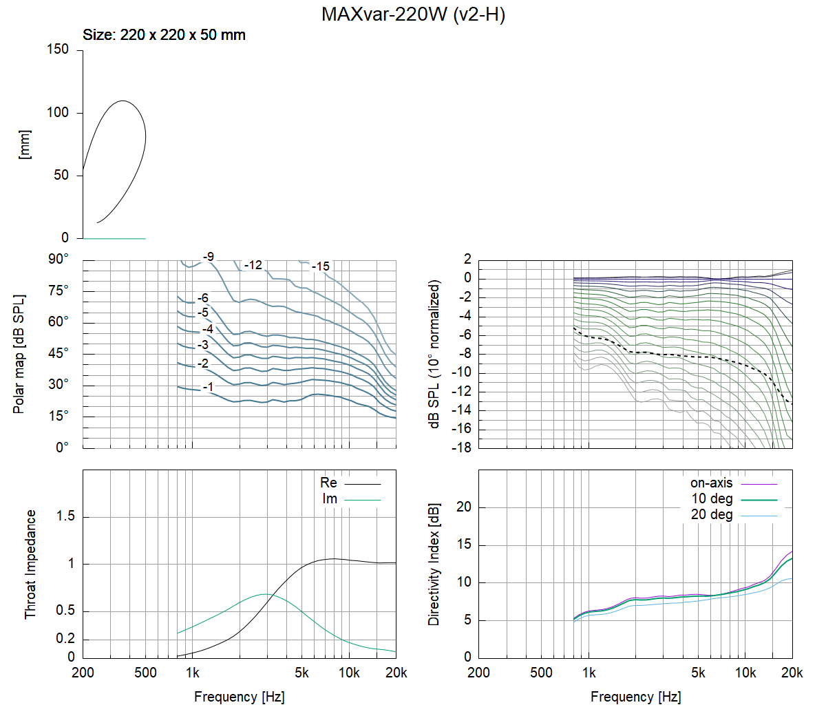

Because I'm unable to simulate it myself, I'll drop it here:
What about varying the curvature of the waveguide around t=1? Maybe it is more gradual than a varying hard edge.

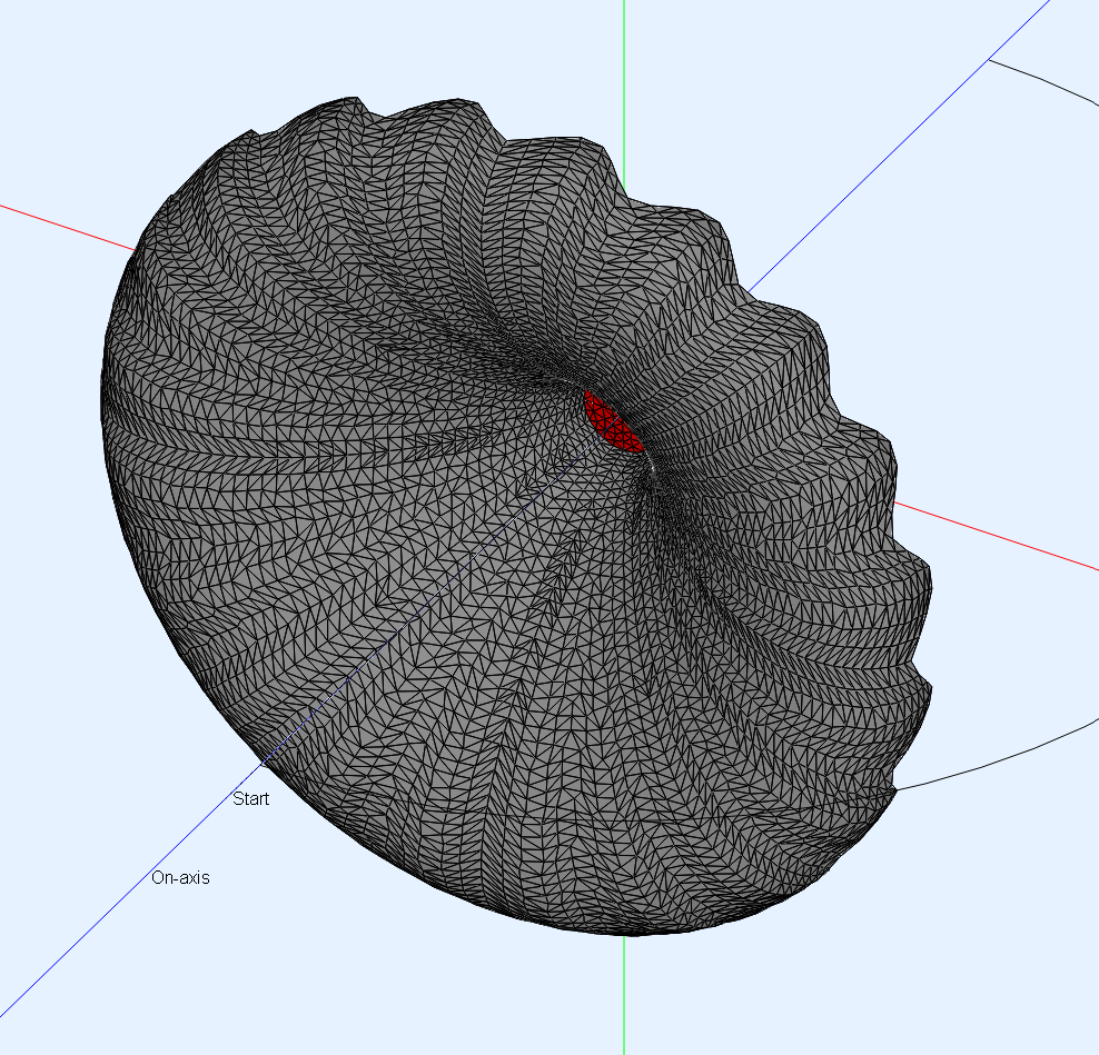

You can vary all the R-OSSE parameters using 'p' as in the tmax example above (p is the angle around the horn). That way you can create a device with varying anything.
The easiest is to take two profiles, between which you let the shape alternate smoothly - all parameters can be changing at the same time.
If the two profiles have the value of some parameter v0 and v1, simply set <parameter> = v0 + (v1-v0)*sin(f*p)^n. You can set frequency of the transition with 'f' (how many times it happens around the horn (=2f)). The value 'n' set the "shape" of the transition and should be an even integer, 2 being a simple sinusoid.

Had the same problem, same as the BLD script...Probably pebcak...
Code:
R-OSSE = {
R = 130.0
r0 = 12.7
a0 = 7.5
a = 39
k = 1.8
r = 0.3
b = 0.3
m = 0.8
q = 3.7
tmax = 0.95 + 0.1*sin(10*p)^2
Source.Shape = 1
; Mesh Settings
Mesh.LengthSegments = 36
Mesh.AngularSegments = 48
Mesh.ThroatResolution = 5 ; 10
Mesh.MouthResolution = 12 ; 16
Mesh.RearResolution = 15 ; 25
Mesh.WallThickness = 5
Mesh.SubdomainSlices = 35
Mesh.InterfaceOffset = 25
Mesh.InterfaceDraw = 0
Mesh.RearShape = 2
; ABEC Project Settings
ABEC.SimType = 2
ABEC.MeshFrequency = 1000 ; [Hz]
ABEC.f1 = 500 ; [Hz]
ABEC.f2 = 12000 ; [Hz]
ABEC.NumFrequencies = 54
ABEC.Abscissa = 1
ABEC.Polars:SPL_H = {
MapAngleRange = 0,180,37 ; 5deg resolution
ABEC.Polars:SPL_V = {
Inclination = 90 ; [deg]
; Output
Report = {
Title = "Athcfg2try"
NormAngle = 0 ; [deg]
MaxAngle = 180 ; [deg]
DrvImp_Range = 10
Width = 1024
Height = 768
GnuplotCode = 3x2n.gpl
Output.SubDir = "test"
Output.STL = 0
Output.ABECProject = 1
That should work

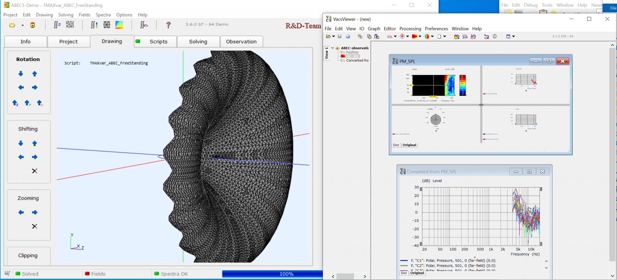

At least the frequency vector is wrong on mine for some reasons...
I've obviously changed that for the above picture.
I don't have a clue what the problem is. I tried to calculate it again with NUC on (it was off previously) and I still get the same clean results.

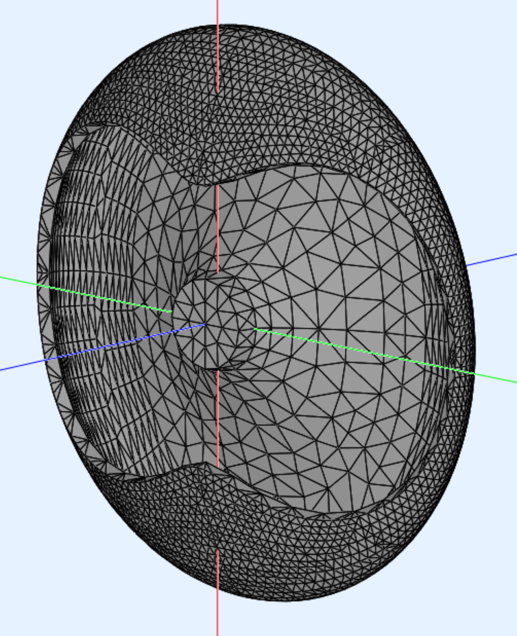

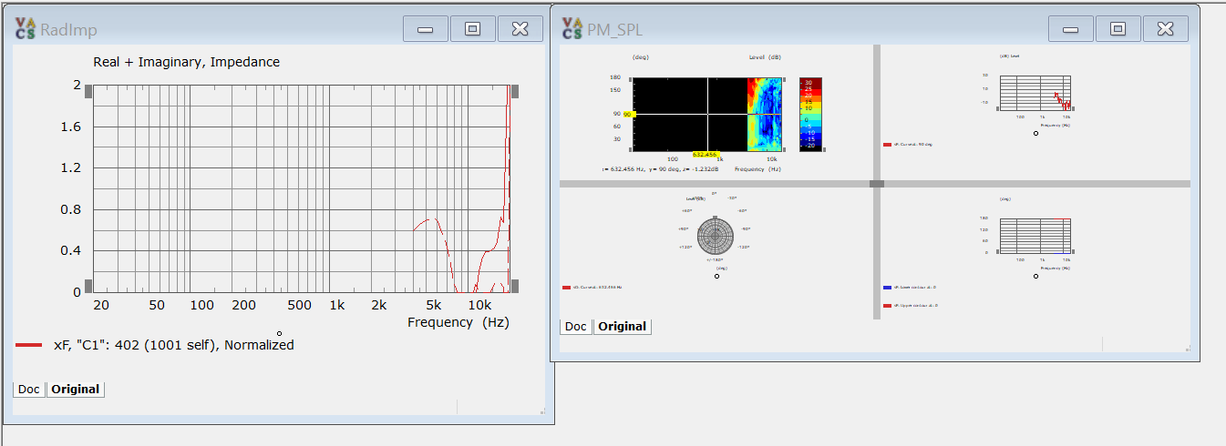

I get almost the exact same rubbish when I try and solve it, running maiky's code through Ath 4.9 gives me a very weird drawing which won't solve the issue for me either. The output from solving is based on mabat's project which does look correct in the drawing.
