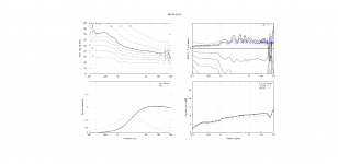

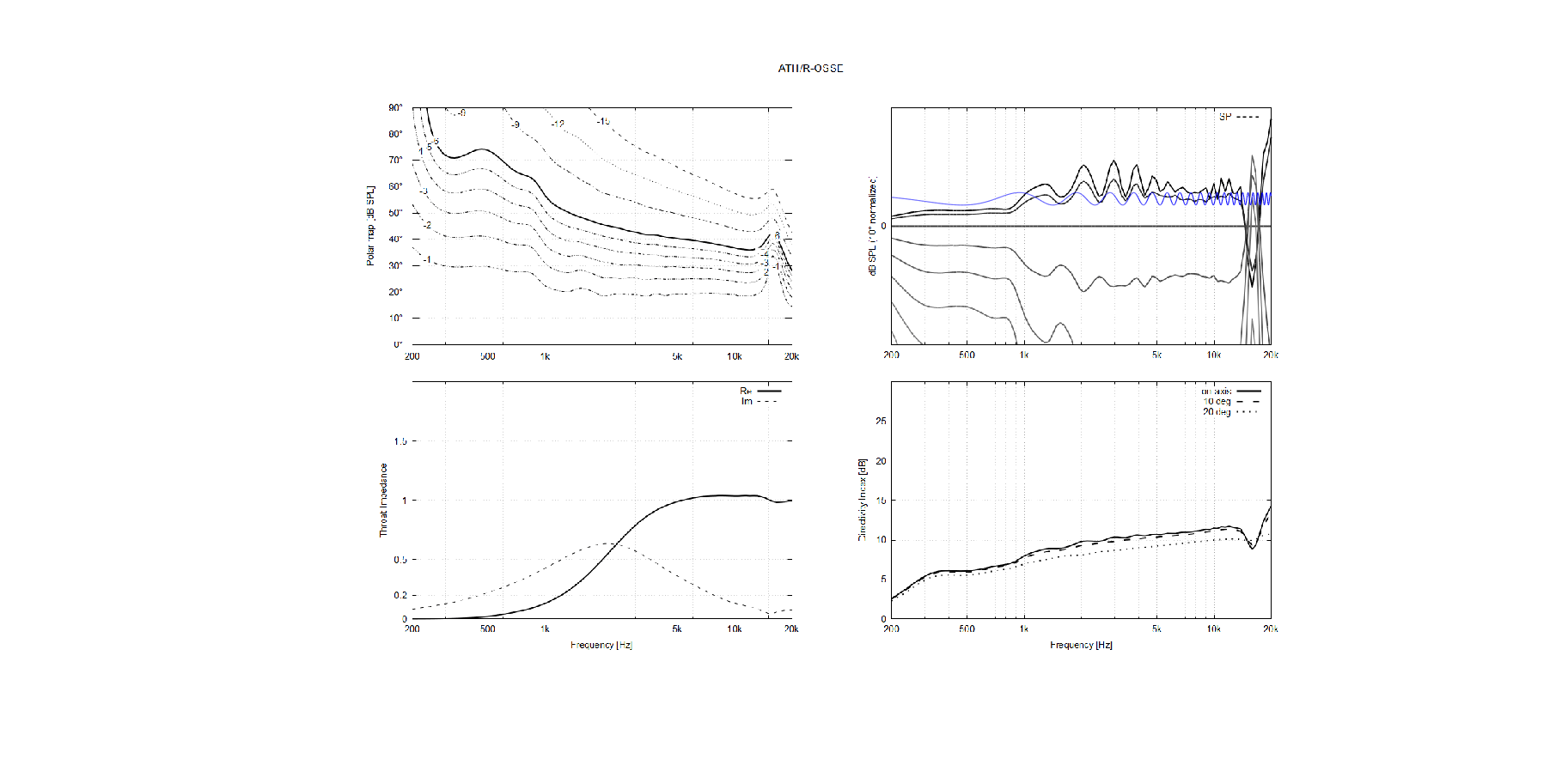

I continued to investigate the effect of 'Distance' variable (distance from source to microphone in ABEC3 sim). I found that even at very large distances (20m), I still had ripples on the on-axis response. That couldn't have been caused by simple Pythogoras as the difference from a point on-axis to 20m and R away from the axis to 20m is, well, the same.
Then another mental image popped up. What if the interference ripple is the effect of sound going straight from the source to the microphone and sound that has traveled along the waveguide and diffracted at the end of the waveguide and went on its way to the microphone.

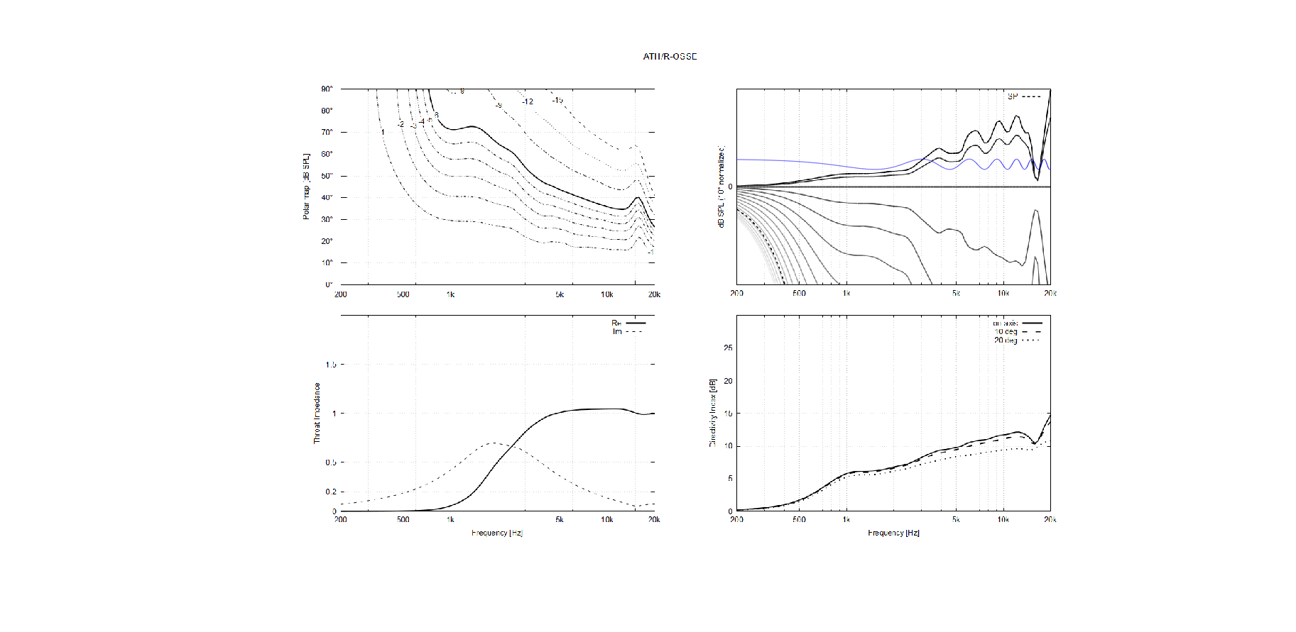

Here are two images of what ath (with ABEC3) has produced (with the dB axis of the SPL plot blown up to +-1dB) overlayed with the interference caused by the mental image introduced above:
It's not a perfect match, but I also don't think it's total bs either...
Edit: The amplitude is chosen such that it looks nice.

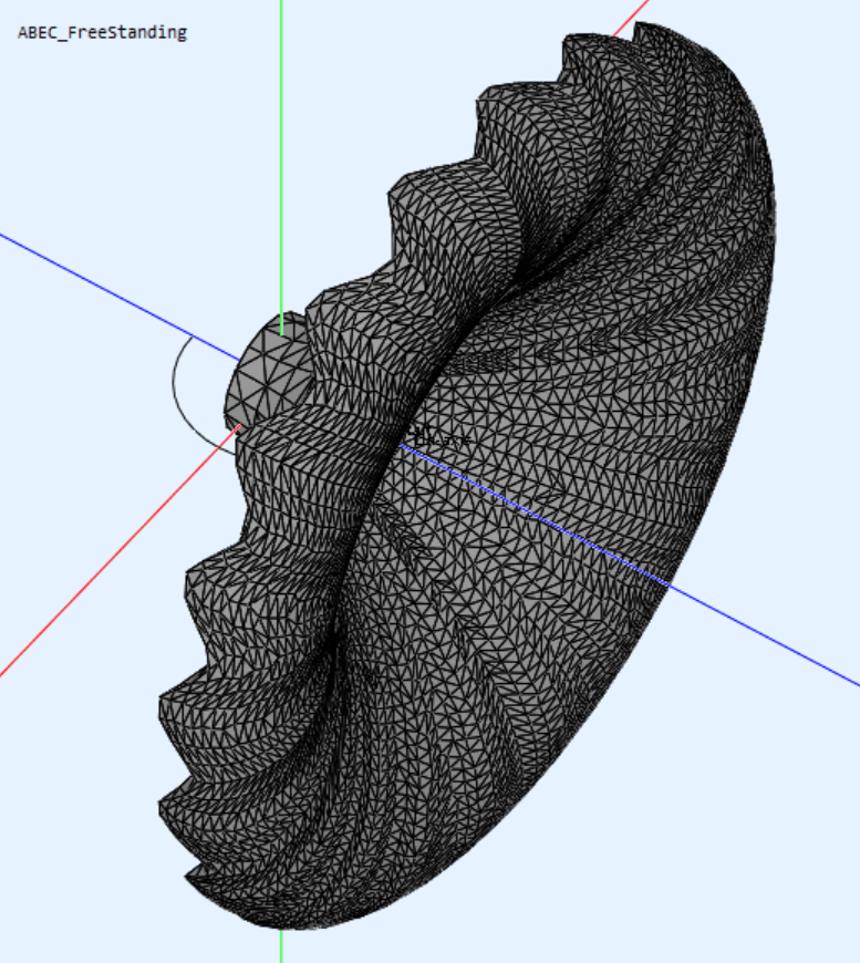

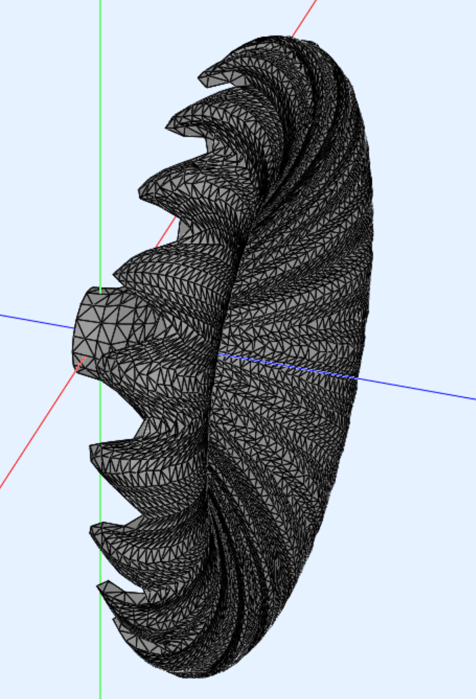

Yea but if you scatter the diffraction both in space and time you basically make it benign.It might smoothen the responses some by distributing the wavelength difference to the edge but it would still make secondary sound source 🙂
This is the code, I haven't tried yet. It might need some tweaking to work properly.

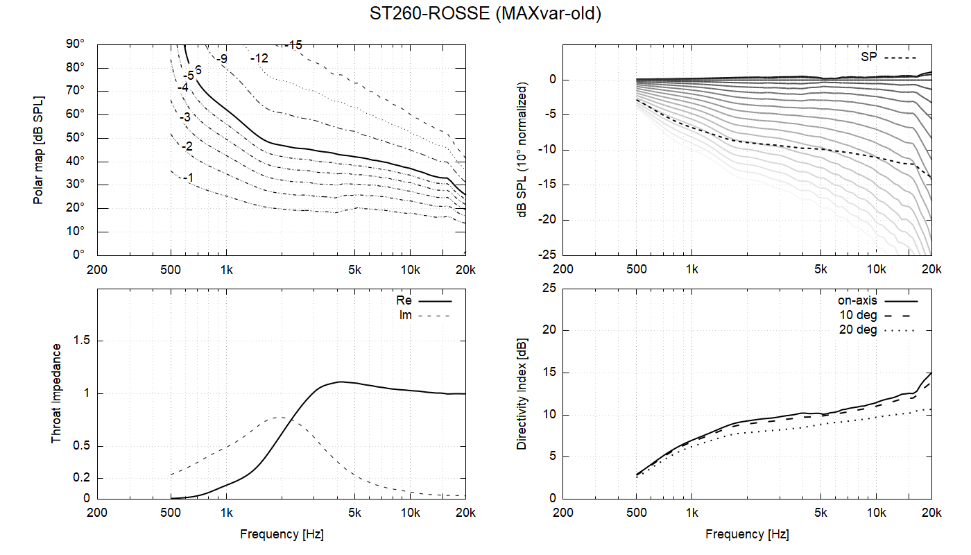

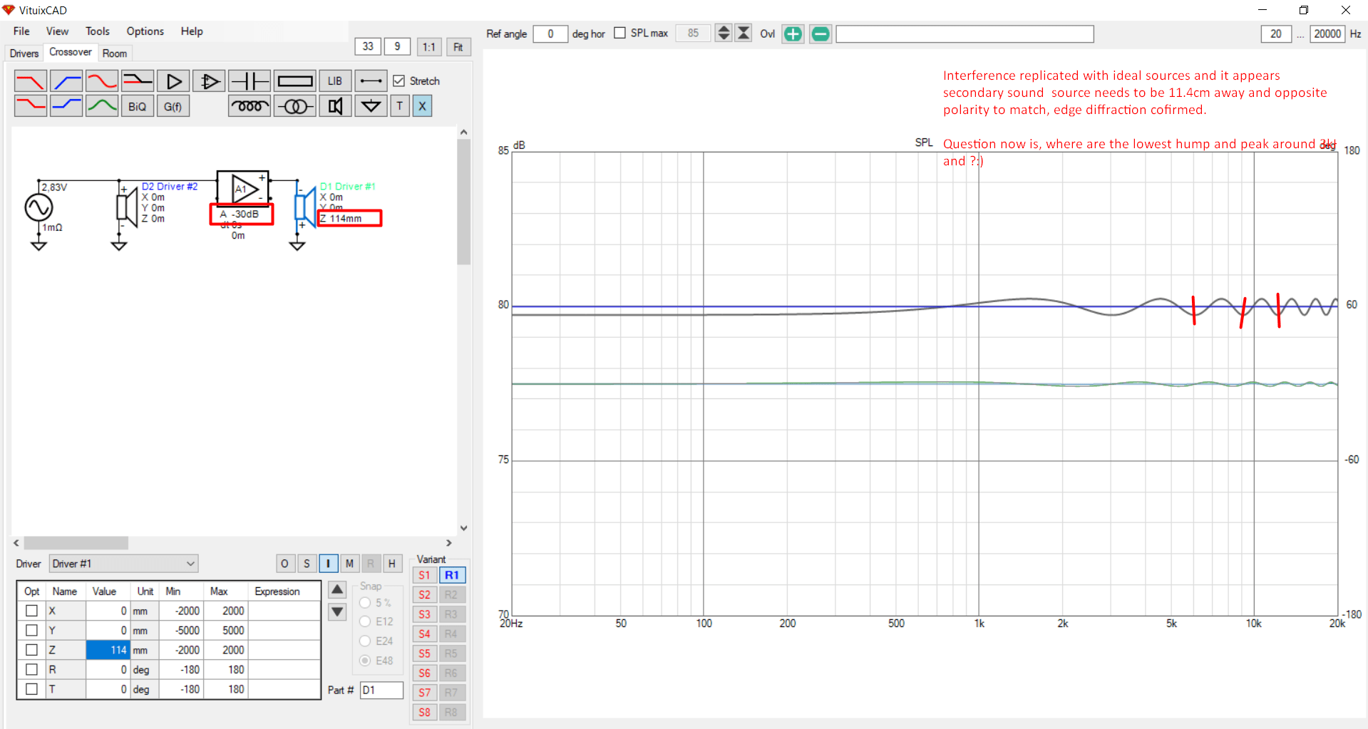

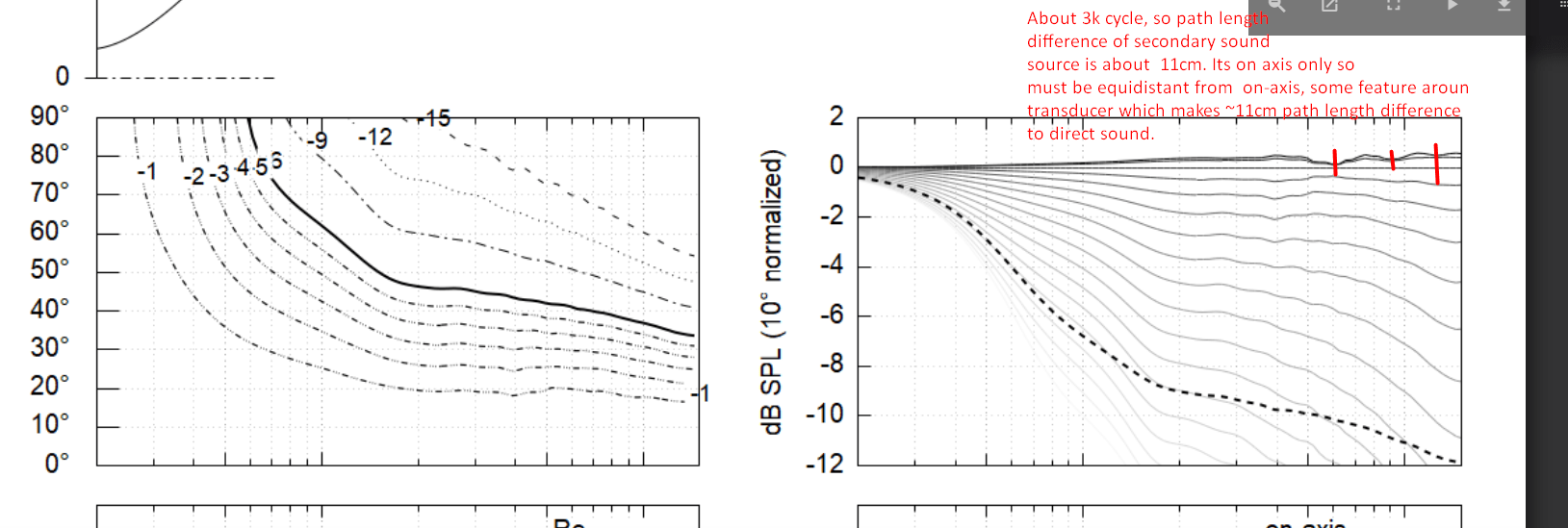

Quick example for this, some image from the thread, lets estimate secondary sound source:...
I use VituixCAD ideal sources to match ripple on graphs I want to investigate to find path length difference quickly without touching math. Also, using attenuation/EQ there gives estimation of amplitude of secondary source, again without maths 🙂 Basically it is tunable secondary sound source which I tune to match situation I'm inspecting and to find out parameters responsible for the ripple.
Then replicate the ripple in vituixcad
We learn that the secondary sound is attenuated about 30db or so and indeed about 11cm path length difference to direct sound. Also we learned secondary sound has opposite polarity so it must be diffraction backwave. Now its possible to esimate what might be the cause and if its something that needs to be addressed somehow.

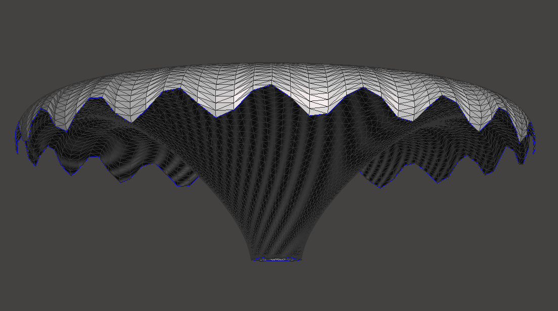

Cool trick with tmax!🙂Yea but if you scatter the diffraction both in space and time you basically make it benign.
Code:R-OSSE = { R = 130.0 r0 = 12.7 a0 = 7.5 a = 39 k = 1.8 r = 0.3 b = 0.3 m = 0.8 q = 3.7 tmax = 0.95 + 0.1*sin(10*p)^2 } Mesh.LengthSegments = 50 Mesh.AngularSegments = 100 Mesh.SubdomainSlices = Mesh.WallThickness = 5 ABEC.SimType = 2 ABEC.MeshFrequency = 100 ABEC.NumFrequencies = 40 ABEC.Abscissa = 1 ABEC.f1 = 2000 ABEC.f2 = 20000 ABEC.Polars:SPL = { MapAngleRange = 0,180,37 NormAngle = 10 } Output.ABECProject = 1 Output.STL = 0 Report = { Title = ST260-ROSSE Width = 1200 Height = 1040 GnuplotCode = 3x2nc.gpl MaxRadius = 150 }

Not a simple task to create such a model but I guess it could be perforated towards the back with larger and larger holes (or some similar structure).

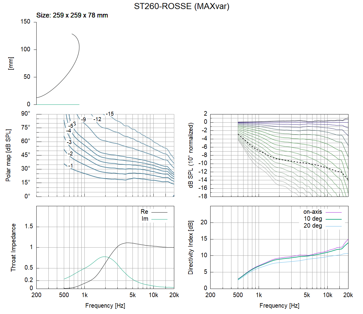

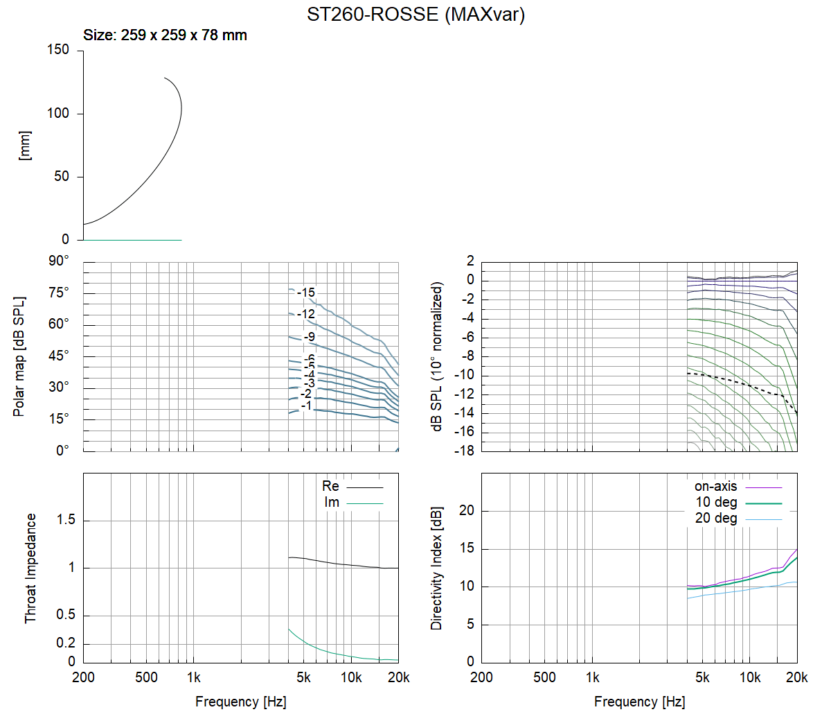

It's quite small model so I ran it again. Still not perfect but I'd more than happy.
(Together with the B&W version of the report.)
The sequence could be made more random. I'll try to figure out how.
