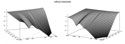

The same settings work fine without the backside
Without backside
Same script as above but with backside, looks some kind of noise. Any idea which setting could make it? I'll try some other profiles and report if its this one that somehow has it.
Should look closer to this
Main visual difference is that the first and last without the noise are open on the back like usual. The new one with noise is closed from the back, probably purposely?
