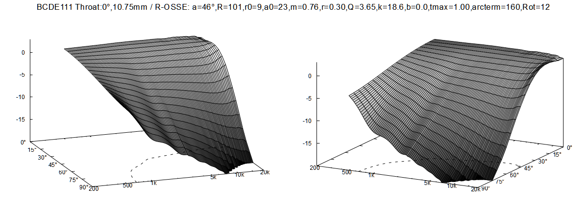

I'm trying to make something like the RCF HF950 for my beta3 1.4" compression drivers, just a little bigger and with a little wider horizontal dispersion
on your website "Ath 4.9 PRE-RELEASE now available for testing (2-profile geometry, example included)." is available for download. However the download does not include an example for 2-profile geometry but for cbt. I found one example here, but it isn't commented. If you still have a commented example somewhere on your PC I'd appreciate it if you'd put them in the .zip file.

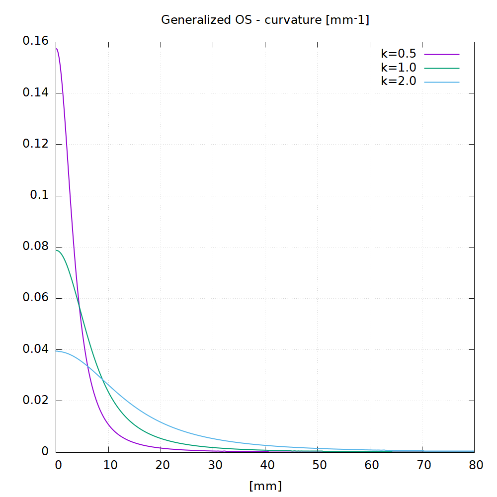

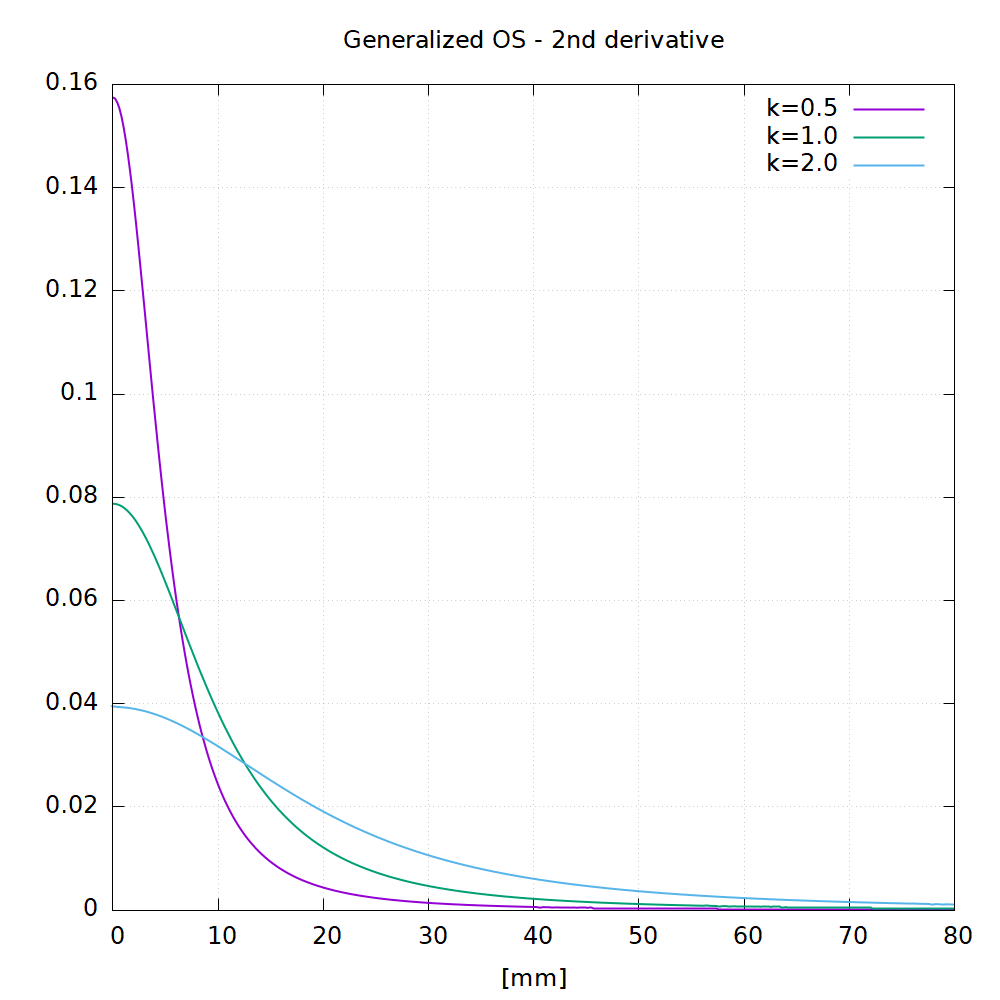

It is hard to say. What would the same data look like with curvature used instead of 2nd Dir?
Maybe curvature is the better use.

With OS the two are actually similar (seems only as a different scaling in x):It is hard to say. What would the same data look like with curvature used instead of 2nd Dir?

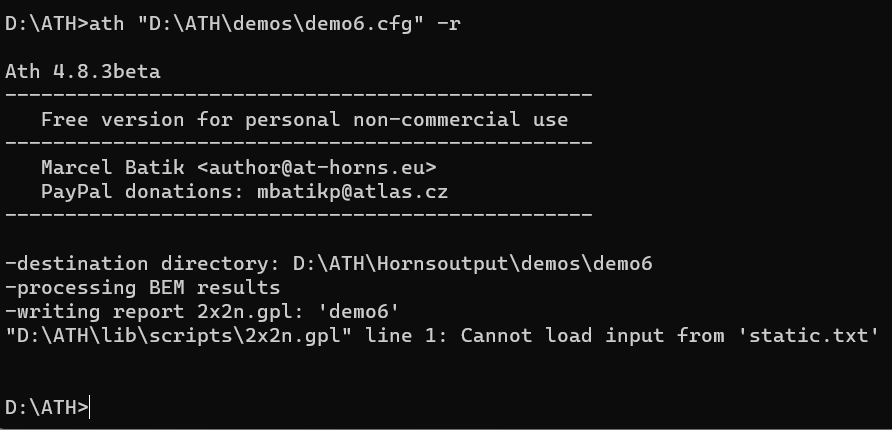

I'm running into an error when I try to generate an ATH report.
So far, I've done most of my ATH experimentation on a version of demo1.cfg I kept changing step by step. I've got the basics down and I'd like to move through the rest of the demo files. However, now for some reason, I can't figure out how to generate the ATH report. Everything seems to work fine, up to the point that I try to generate the report with ATH.
There appears an issue with the 2x2n.gpl script, line: 1: Cannot load input from 'static.txt'
I searched this thread and apparently I'm not the first to get this error message: https://www.diyaudio.com/community/...-design-the-easy-way-ath4.338806/post-6818209
Mabat figured it out:
I'm actually using the same bit of code that worked for me in the other config file.
What could be going on here?
- Ah, I see the issue now. In the script file there must be a 'Report' item defined, even if empty, otherwise the 'static.txt' file is not written:
Report = {
(Note that you can modify the report properties with this item.)

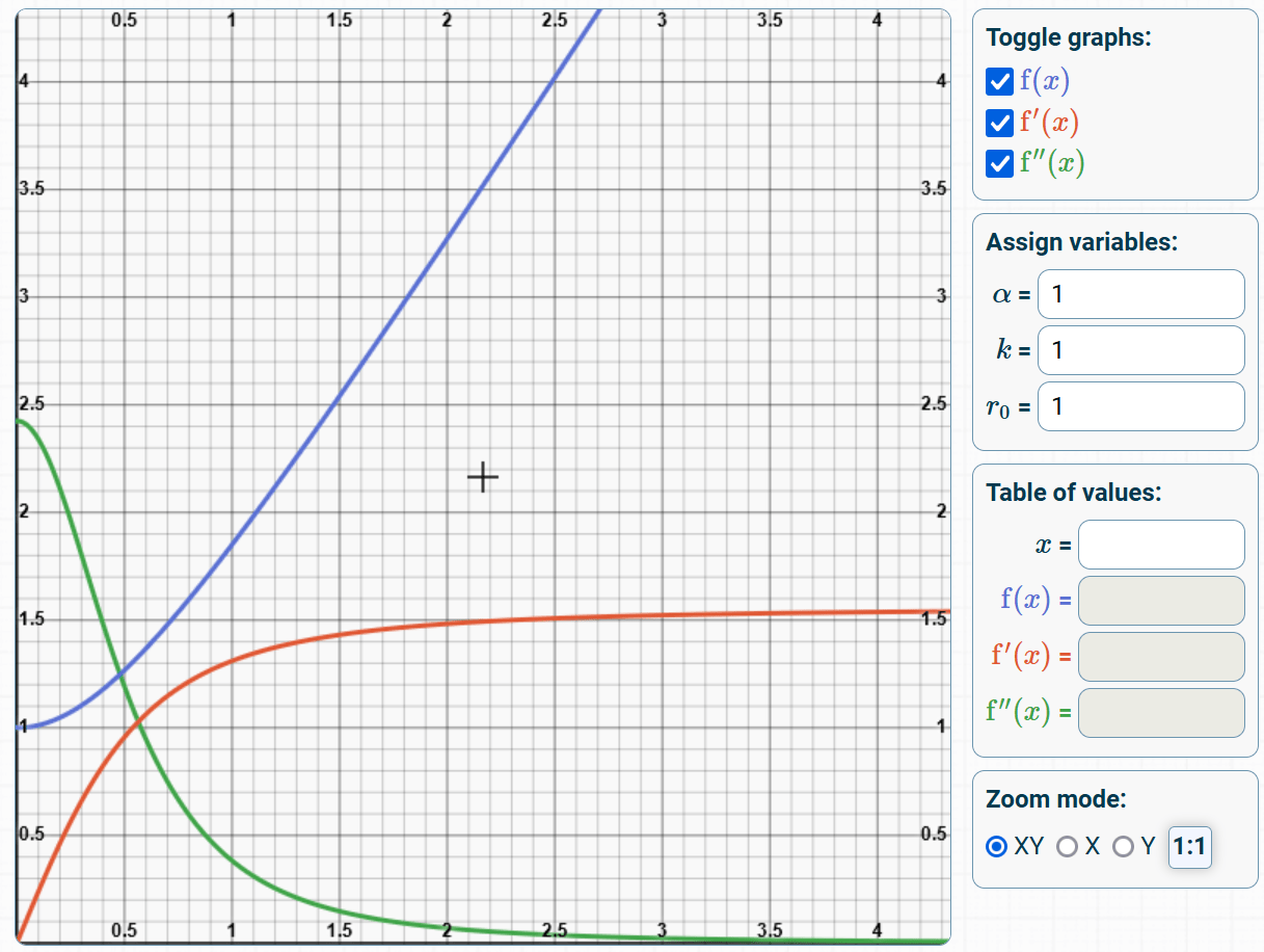

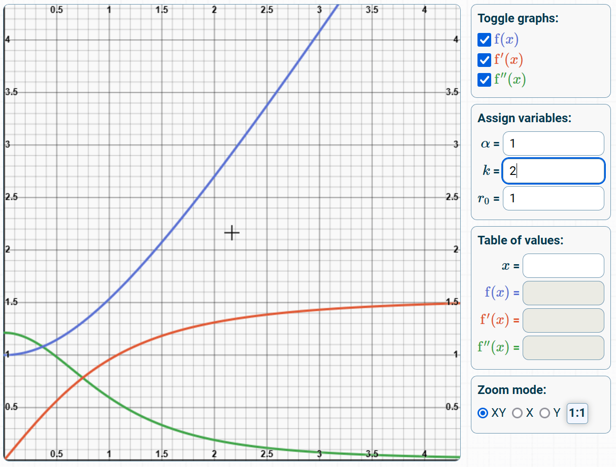

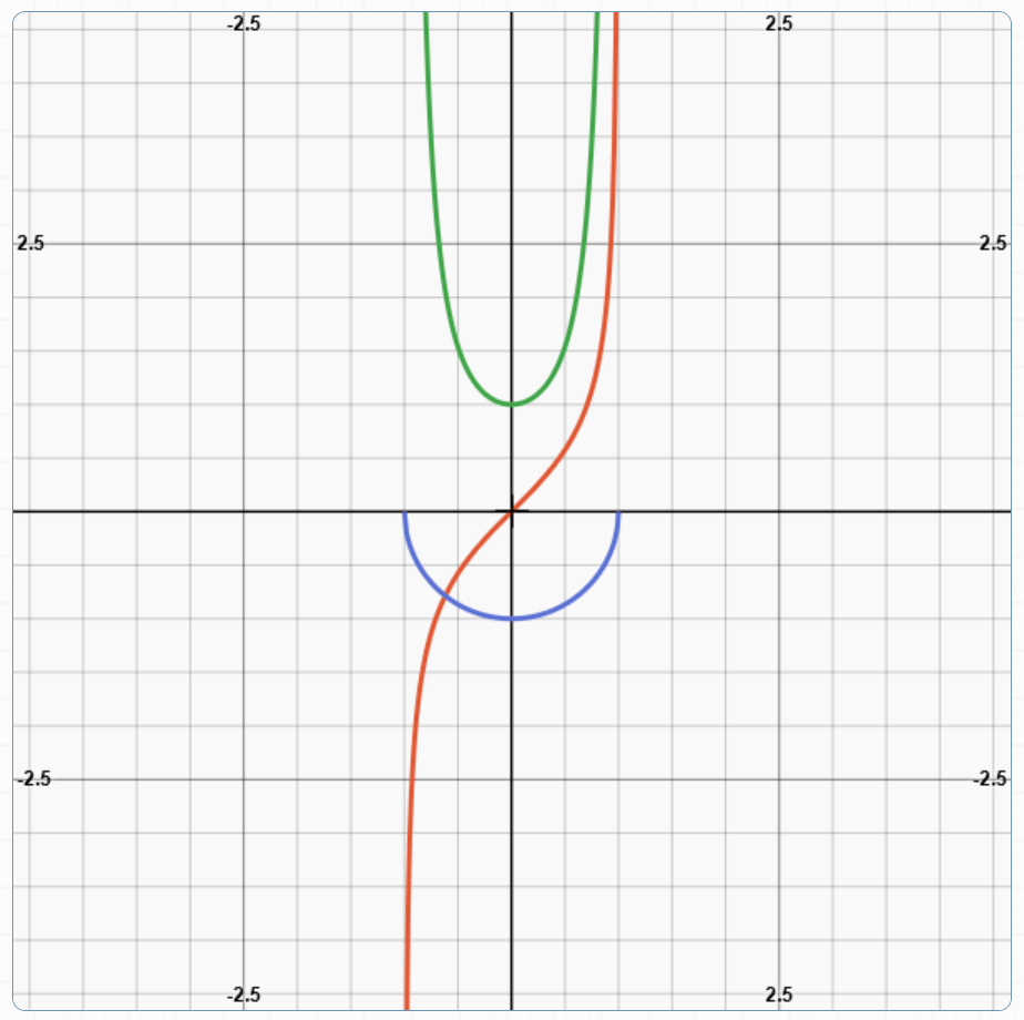

It is scaled, but not (directly) in x. It is scaled as a function of the slope and the green curve below gives the scaling:With OS the two are actually similar (seems only as a different scaling in x):
Here is a reasoning: https://www.diyaudio.com/community/...-design-the-easy-way-ath4.338806/post-7358766I'm still not sure it does, haven't seen a proof. (I'm not saying it doesn't, I just don't know what to make of it.)
If that reasoning holds, then the OS minimizes the integral of the second derivative along the curve. It also minimizes the area of the revolution. I don't think it minimizes the integral of the second derivative over the waveguide surface. The larger radius part will be more influential. Gedlee also mentioned a few post ago that larger delay is more audible. That would also give an additional influence of the larger radius part. On the one hand the R-OSSE has proven to be very helpfull in designing waveguides, on the other hand I feel we don't have to use it, but have more freedom in the shape (although I don't have anything else).
There is (at least...) one other thing that not clear to me. The OS was one of the shapes in Gedlee's book where the wave equation could be solved. Does that make the shape special in itself, or is it just one of the few we have a analytic solution for and as such has provided quite some insight courtesy of Gedlee? Are other shapes also just as 'ok' when we have ABEC to do the heavy lifting and provide a numerical solution?
Sorry, I just don't follow...
-That makes sense, of course. The more you need to bend the curve to connect the two given points, the higher the integral curvature / 2nd derivative... I just still don't see why should an OS minimize that.
Integral of the second derivative is a mere difference of the first derivatives, basically a difference of the inital and terminating wall slopes - I can't see how that could work. Or I'm just already tired today.[...] then the OS minimizes the integral of the second derivative along the curve.
Yeah, that's a good question. I have been wondering about this for long myself. No idea.There is (at least...) one other thing that not clear to me. The OS was one of the shapes in Gedlee's book where the wave equation could be solved. Does that make the shape special in itself, or is it just one of the few we have a analytic solution for [...]

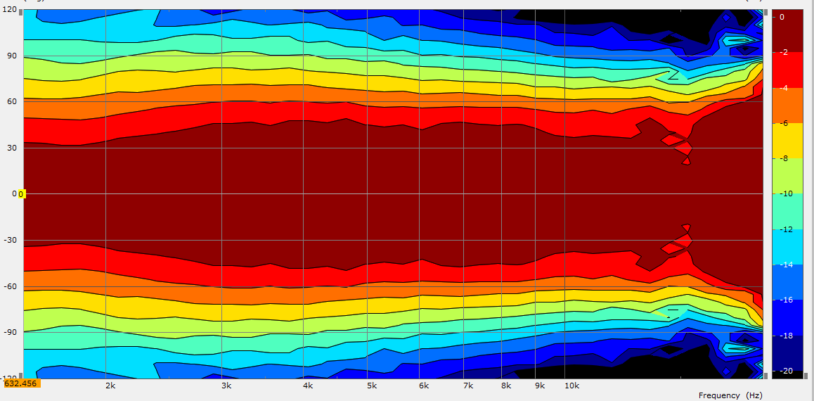

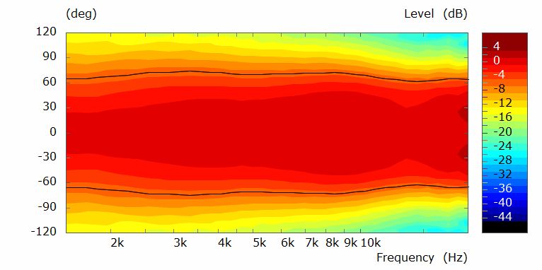

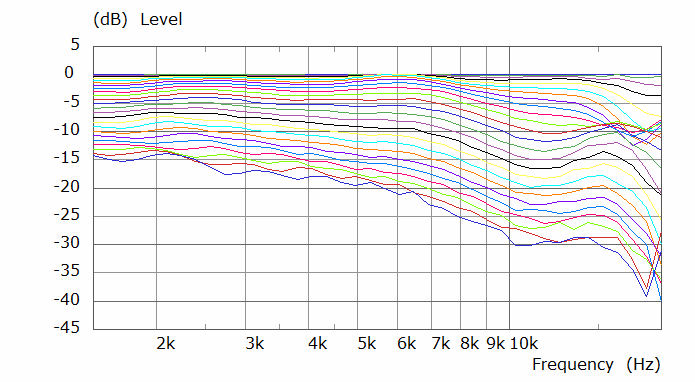

I tried the T34A in a 2-profile geometry, just to see if I'll be lucky on the first try.
It could be optimized further I guess to fix that narrowing around 13k, but I'm really not willing to do that now...

Hi @mabatI tried the T34A in a 2-profile geometry, just to see if I'll be lucky on the first try.
View attachment 1178003 View attachment 1178006
View attachment 1178004 View attachment 1178005

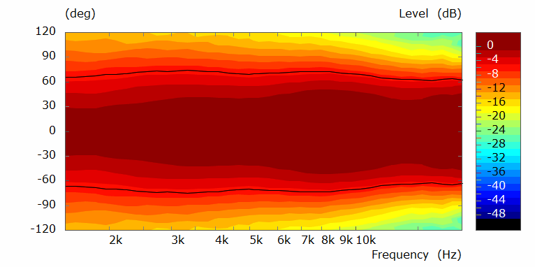

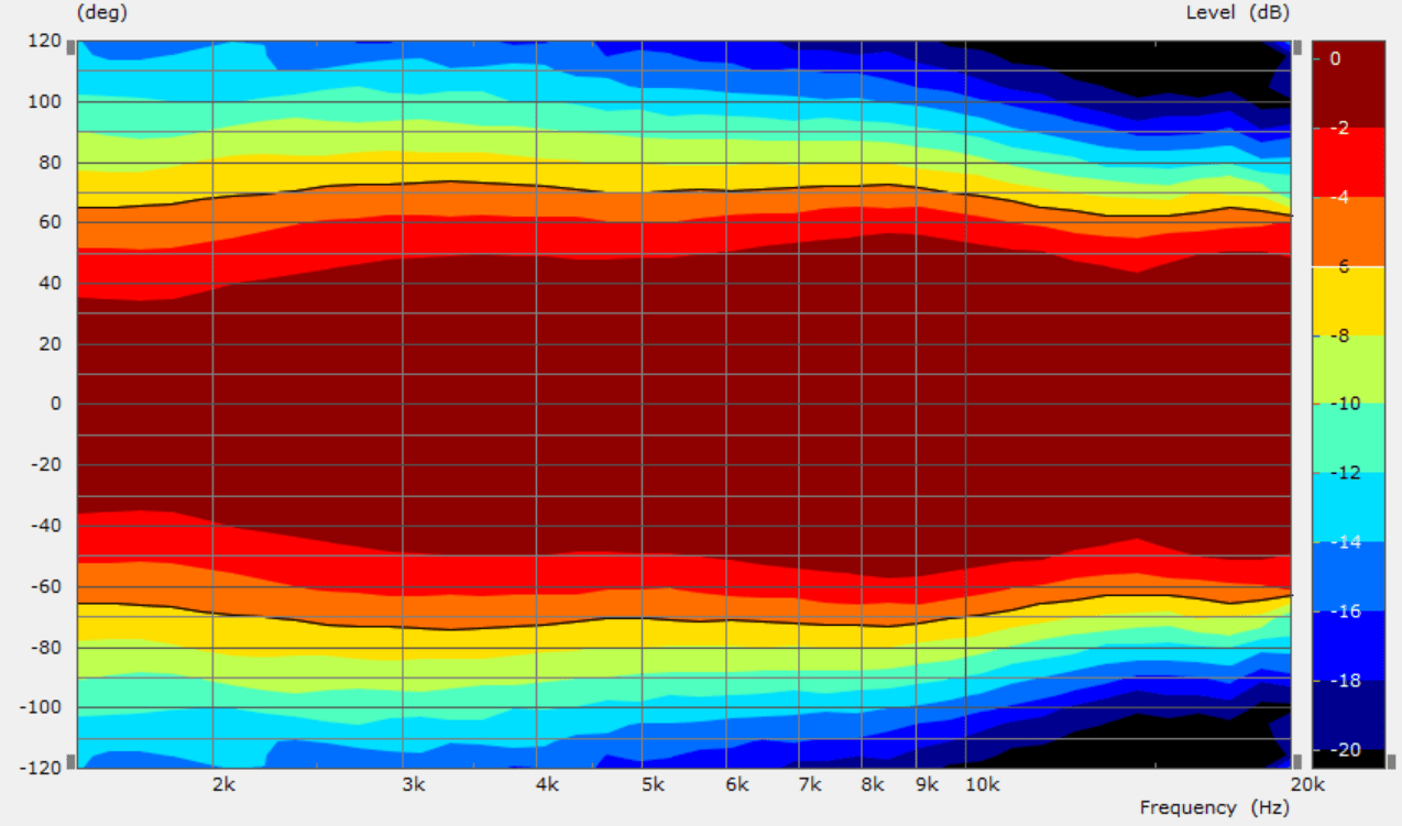

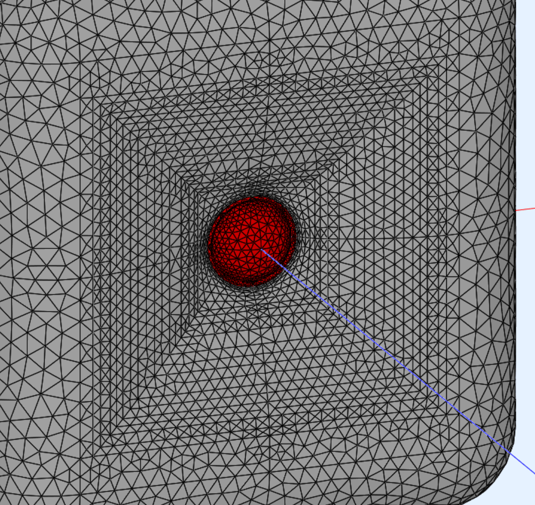

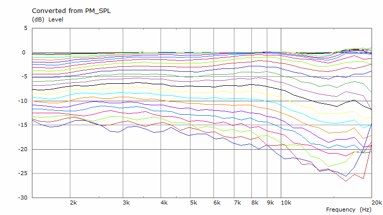

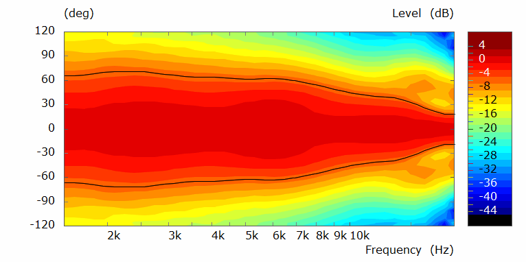

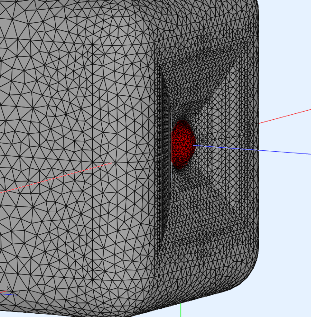

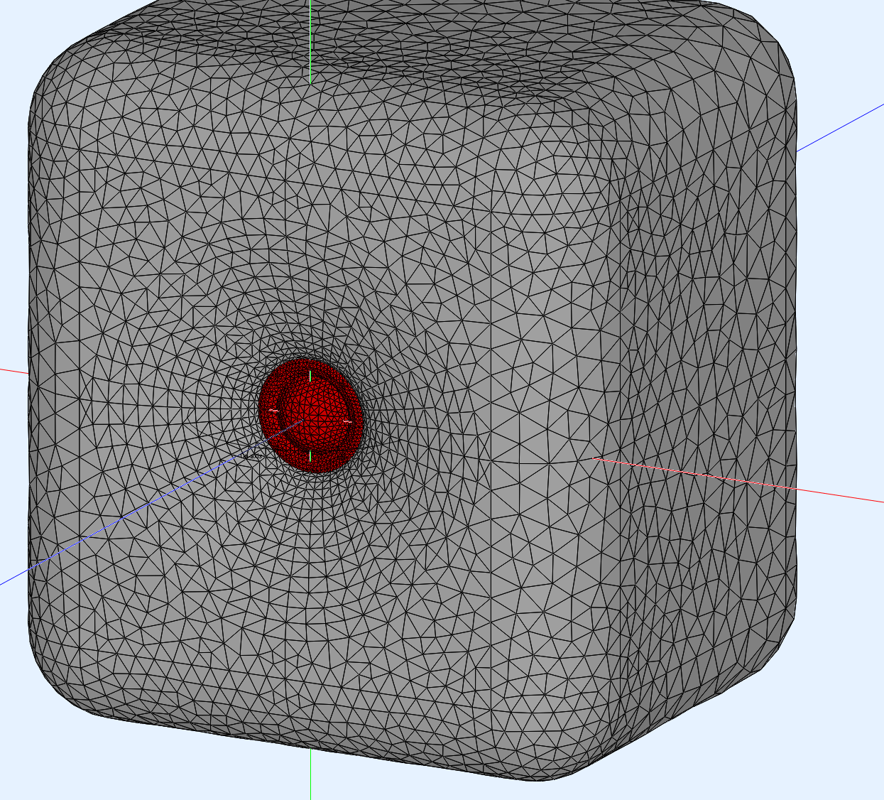

As I try to learn ATH + ABEC, I've been trying to run the same scripts others are posting and testing to see if I get similar results, and I couldn't in the case above:
Any idea why that may be the case?
Steps were:
1) Run ATH script above
2) Open Model in AKABAK
3) Start BE Solver
4) Open VACS
5) Back to AKABAK to Calculate All Spectrum Observations.
That is all I did.

I'm not completey sure of the reason but I ran into the same issue recently. My hack solution to it was to paste a random static.txt file into the results directory and then it would produce a reportWhat could be going on here?
Maybe the data in static.txt needs to be accurate but most of it seems to be information.
There are some differences in the way observations are handled between ABEC and Akabak, my advice would be to use ABEC with Ath as it is just easier. mabat has a link on his website to the ABEC download if you don't have it. You don't need a full version running in demo mode will still solve and if you have a full version of VACS you can save the spectrum file from there.Any idea why that may be the case?
Possibly you are seeing normalization changes too. Normalized to 10 degrees y value usually looks better and more even. Any changes to ranges or displayed value options can make a difference too.
What I get for the code above
Thank you, Fluid! This did the trick.
