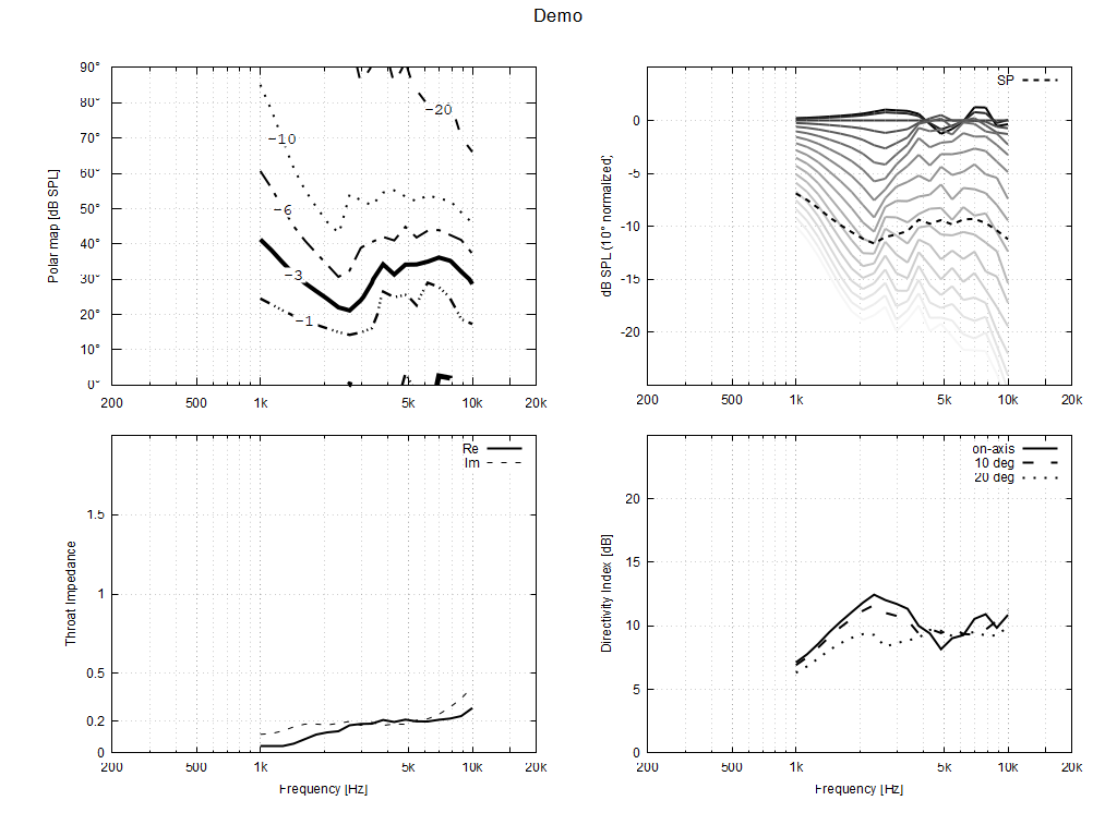

@fluid @keyser If you want to use old ath script with recent ATH tool binary, you need to extend the config with the Report section. For example:
If this one is missing, then "ath.exe CONFIG -r" will not generate a correct report.Report = {
Title = YOUR_IMAGE_TITLE
Width = 1024
Height = 768
MaxRadius = 180
MaxAnglePM = 180
I'm afraid I'm not following you, miero. I do in fact specify the use of the report function:
Regardless, are you saying adding this specification is no longer required in the latest version of ATH? Even without the spec, it will generate a default report? I'll give it a try.
Code:
Report = {
Title = "Demo"
NormAngle = 10
Width = 1024
Height = 768
SPL_Range = 50
MaxRadius = 90
PolarData = "SPL"

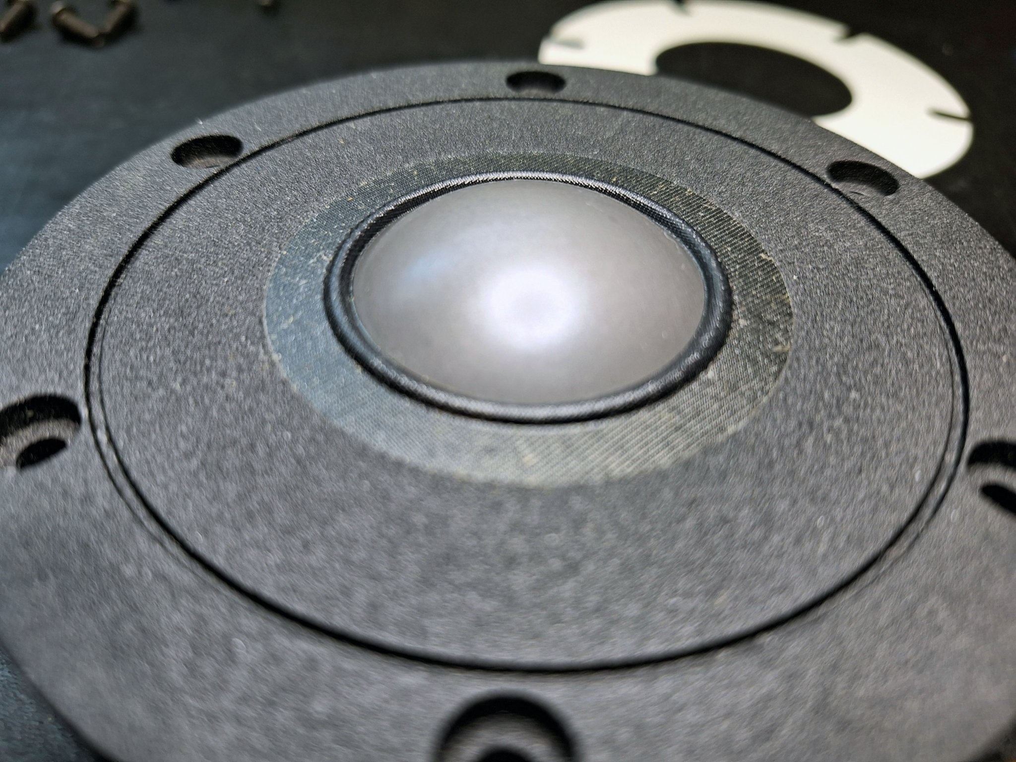

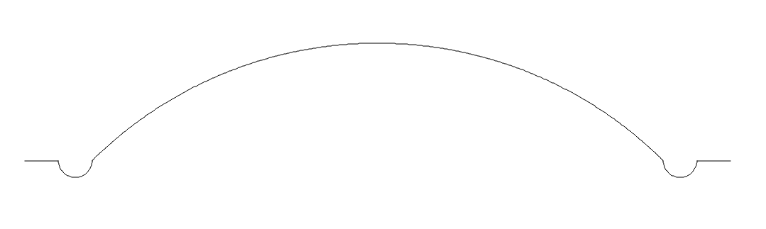

Hello,Just an affirmation - is the surround on the T34B really concave (as in the drawing)?
Or could it happen that they changed it to convex recently?
I've seen only photos and it's surprisingly hard to tell.
I have dismonted one of my T34B and I can confirm that the T34B has a convex surround, please see picture.
Hope this help

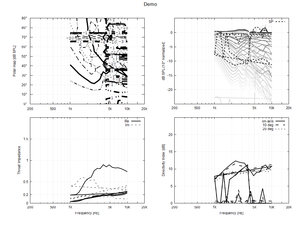

Unfortunately there are a few occasions where something else is at play and the report function does not generate all of the text files needed to complete. Without the report section in the config nothing happens at all and you get a different error.
I've moved on to demo7. I added the same report specification to the script. Then I tried to generate the ATH report, but again it gave me the error message referring to the static.txt. I then added the static.txt fluid made to the results folder and I ran it again. It worked, kind of. The results don't look plausible, quite different from VACS.
Your example dies not include one parameter that @miero had given in his solution, MaxAnglePM =I do in fact specify the use of the report function:
I often received that promt with definition scripts which included multiple sets of reports: for vertical, horizontal, tweeter, woofer etc. pp. In some cases it seemed to me as if ABEC was not properly parsing/selecting the title of a report, but if @miero is right, this would explain the illegible output too.
@miero I had misunderstood your previous post. I tried it today by adding in the MaxAnglePM and MaxRadius with the same problem config and it made no difference. I did notice that I had a static.txt file in some results directories where I had not actually run the report function so they seem to be created by Ath in the first instance. These were much more generic than the previous one and I was easily able to edit the dimensions and distance to correspond to the correct ones. Putting this in the directory manually and running with -r then worked with sensible output just like VACS. Attached in case it helps anyone.
@fluid @keyser It might be possible, that your .cfg file contains a formatting, that is incorrectly parsed by ATH on the first run.
You can verify that your .cfg has been "understood" correctly by checking if the config.txt, generated in the output directory of the project, contains Report section.
demo8Crep_v2/ABEC_FreeStanding/Results/static.txt
demo8Crep_v2/ABEC_FreeStanding/Results/coords.txt
demo8Crep_v2/config.txt
Yes that is the problem, something causes the coords and static files not to be created on first run, only the static causes the basic report not to generate though. I only came across it while solving someone else's old style config file, the same problem had been mentioned but without a clear resolution. Certainly for me it does not matter in normal use.
I can only suggest to use the latest build with some of the recent examples published here. Attached is the basic gnuplot script I have currently on my PC. This should all work fine.

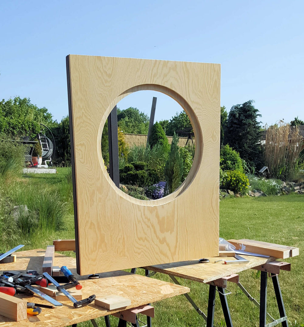

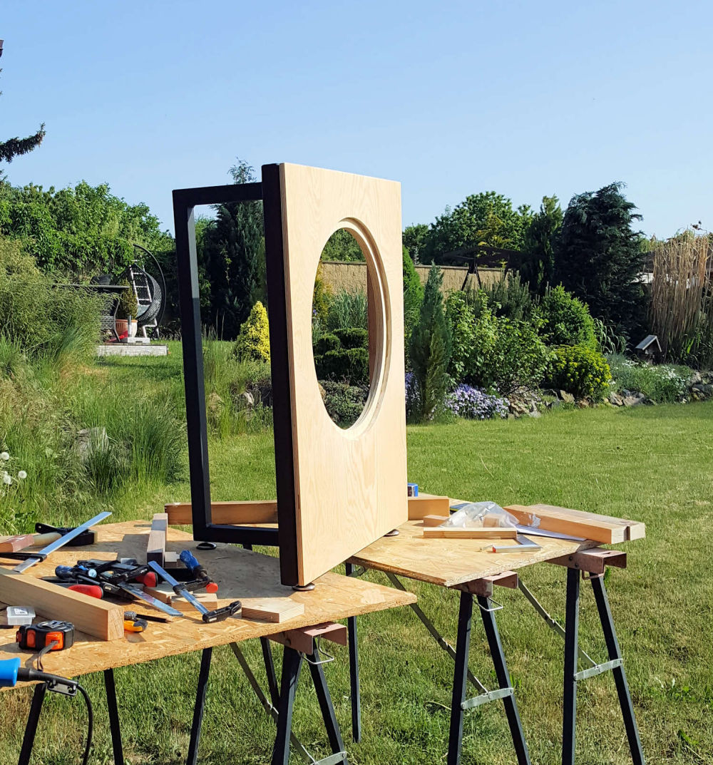

Yesterday I could spend all day working on speakers 🙂
This should make a pretty good base frame for testing different large-format horns...
The woofers are 18" (SB Audience 18SW500 at the moment.)

Look interesting. For open baffle design?The woofers are 18" (SB Audience 18SW500 at the moment.)
the SB18SW800 looked also great.

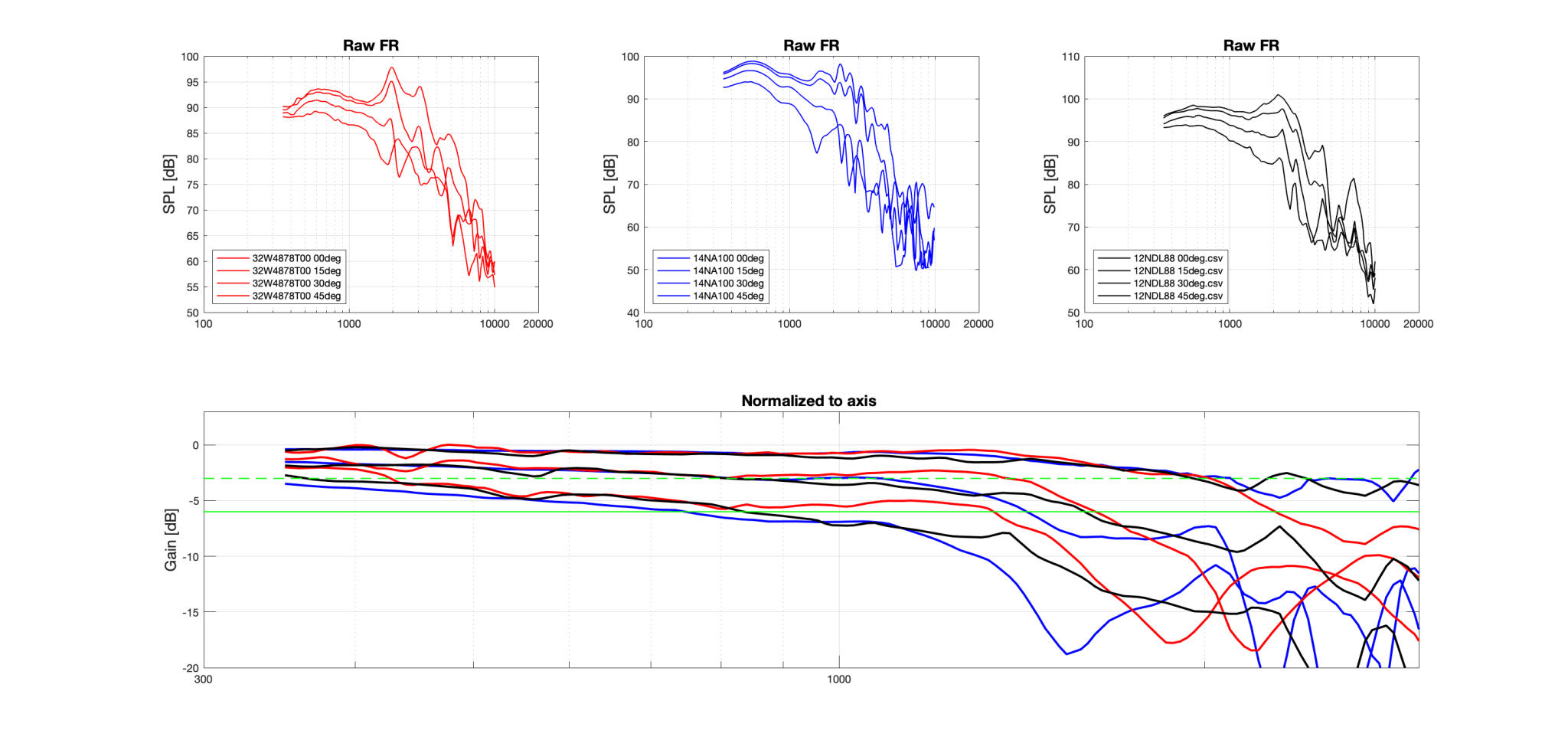

BTW here is an interesting article form the same guy that did compression driver comparison a while ago.
The interesting bit is the TAD 16003 data (as well as 18s 15LW2400 and BMS 15N850v3).
https://www.justdiyit.com/comparatif-15-pouces-pro/3/
It is a bit off-topic for the woofer
but finding good drivers is always a big part of any design...

I downloaded ATH 4.9 221115 and now generating the ATH report works again. Thanks!
Hmm... the impedance does look implausible though. This is demo7.
EDIT: Apparently I celebrated too soon. I moved on to demo8 and again I got the static.txt error message. I pasted fluid's static.txt file into the results folder and then the ATH report script did run successfully. I'll give ATH 4.9 230518 pre-release a go now.
Yeah, there's a catch with the sources compound of more than one driving groups - what is actually plotted is the impedance of one of the surround rings, I assume (in ABEC / VACS you can see it clearly - you will see all the parts). I have to look at what's needed to make the whole tweeter appear as a single source (I think it already used to be like that, I just must have changed that at some point...).
Maybe it would be best to leave the old demos altogether...I moved on to demo8 and again I got the static.txt error message.
I just can't go through all the old stuff again. I should probably remove that from the website.

Yes, open baffle, active. The 18SW500 seemed as good enough for what I need, but I haven't made any tests yet.Look interesting. For open baffle design?
