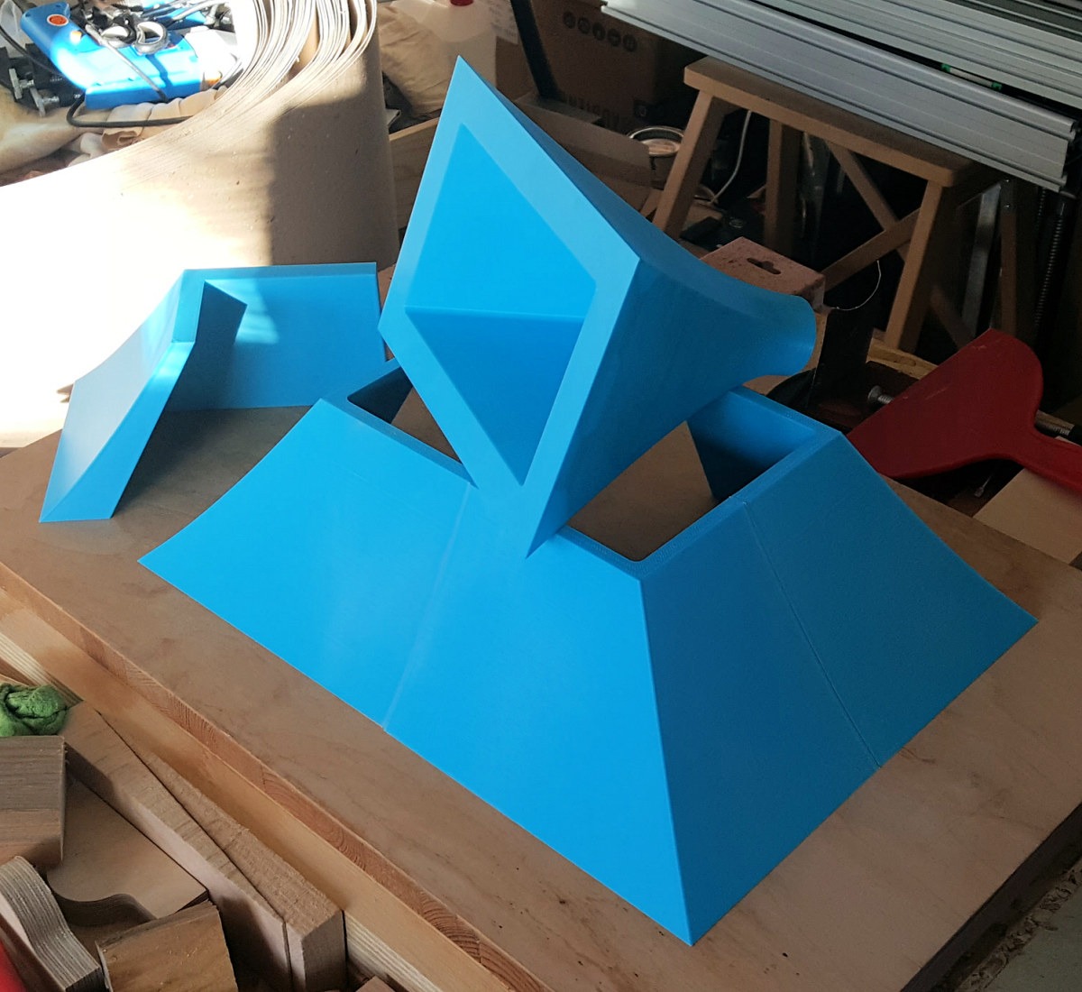

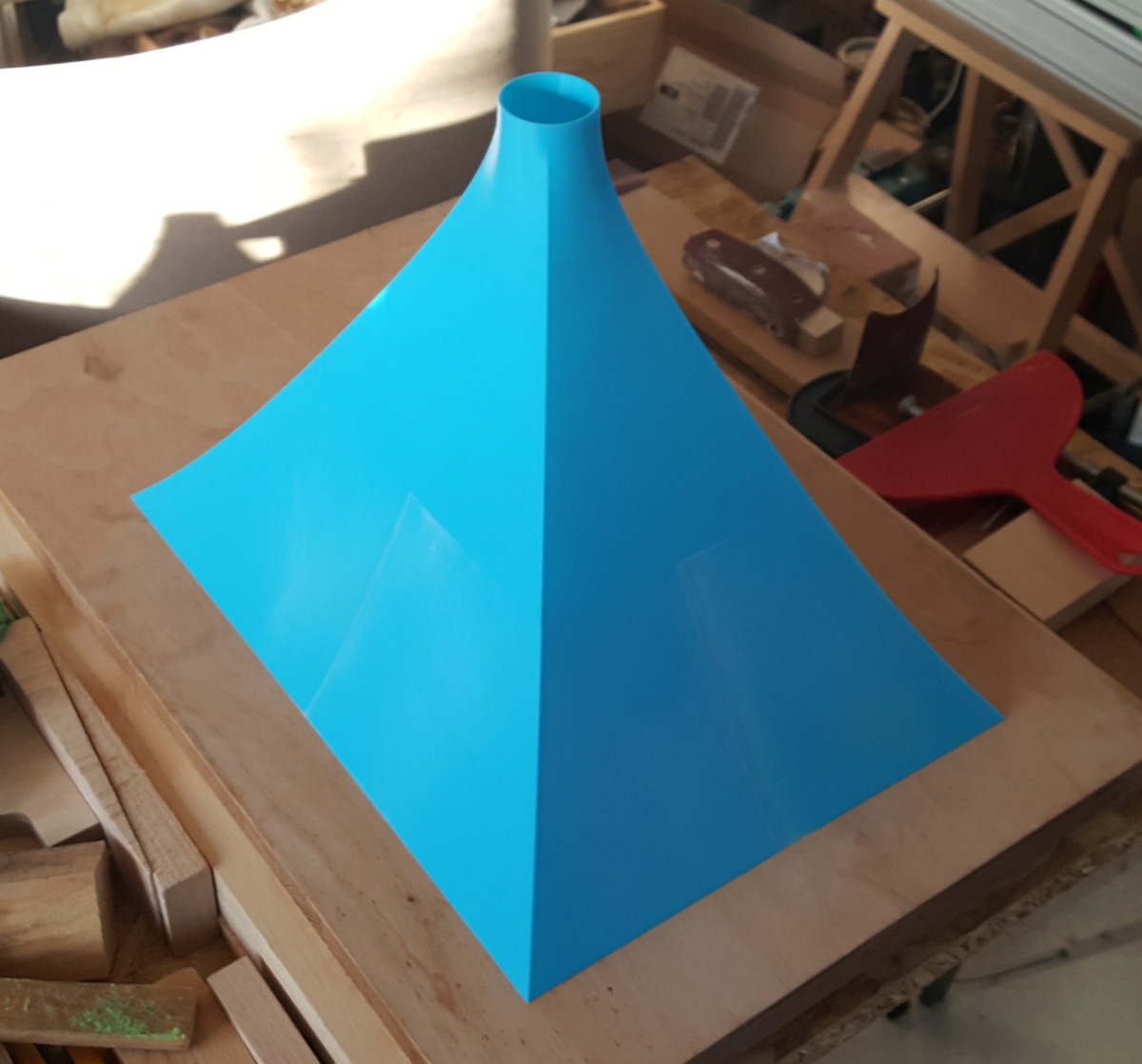

...and today working on the horn molds. I want to try concrete with these.Yesterday I could spend all day working on speakers 🙂
The printed parts are basically hollow shells to be filled - probably gypsum to keep the costs down.
(The blue one is not yet complete, the mouth layer is still being printed.)
These are 640 and 540 mm wide, 1.5" and 1.4" throats. The drivers at the moment are the ND4015Ti2 and HF1440.
Gypsum or concrete will make the job of course but heavy. From other side 3D printed structure allows very light and stiff structure. PLA+GF is about 35 euro/kg (Azoty). A way to go is PP+GF.
I actually think the molds could be just PLA, if printed with a denser infill. I wanted the print job quick (these are already rather large pieces) so these are basically hollow with only a very sparse gyroid infill to keep the shape during pouring. These were very easy to print, without any warping etc. I'm quite satisfied with the results so far.

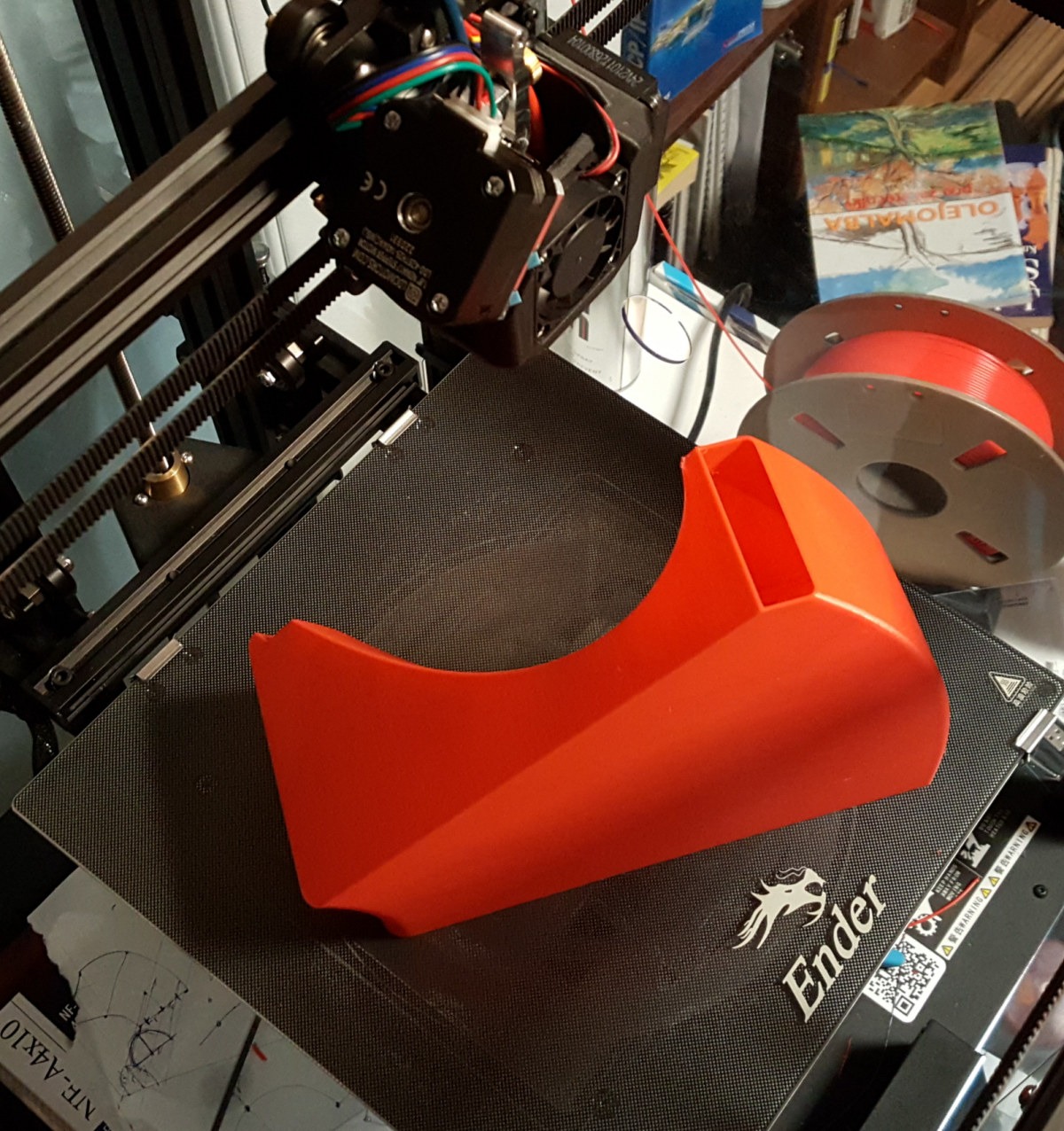

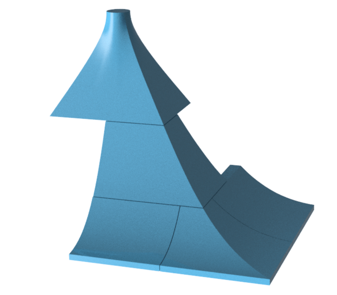

- This was about the biggest I could print on my Ender 6 (could be a bit larger but not much) 🙂:
A "bottom" mouth piece: http://at-horns.eu/img/timelapse_BASE_2x-C.mp4

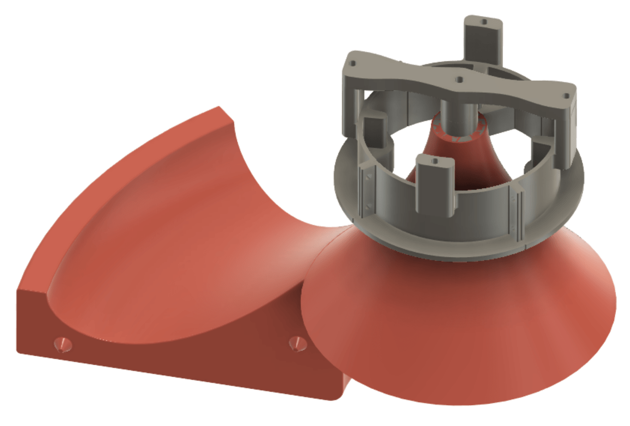

- The whole model (each part shown only once):
The blue one is 64 cm, the same width as the OB frame shown on the previous page. The red one is 10 cm smaller.

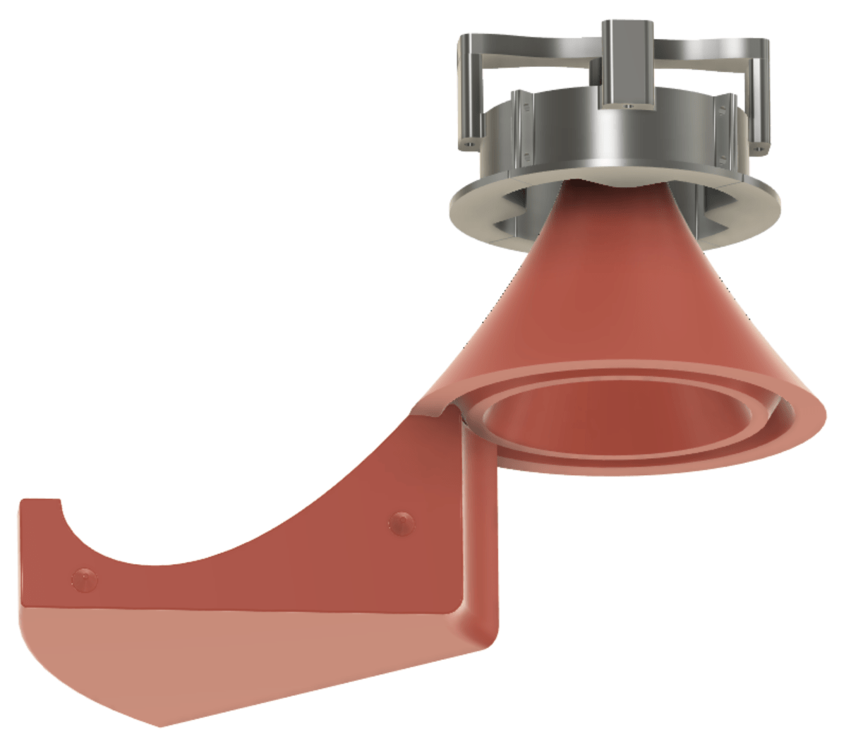

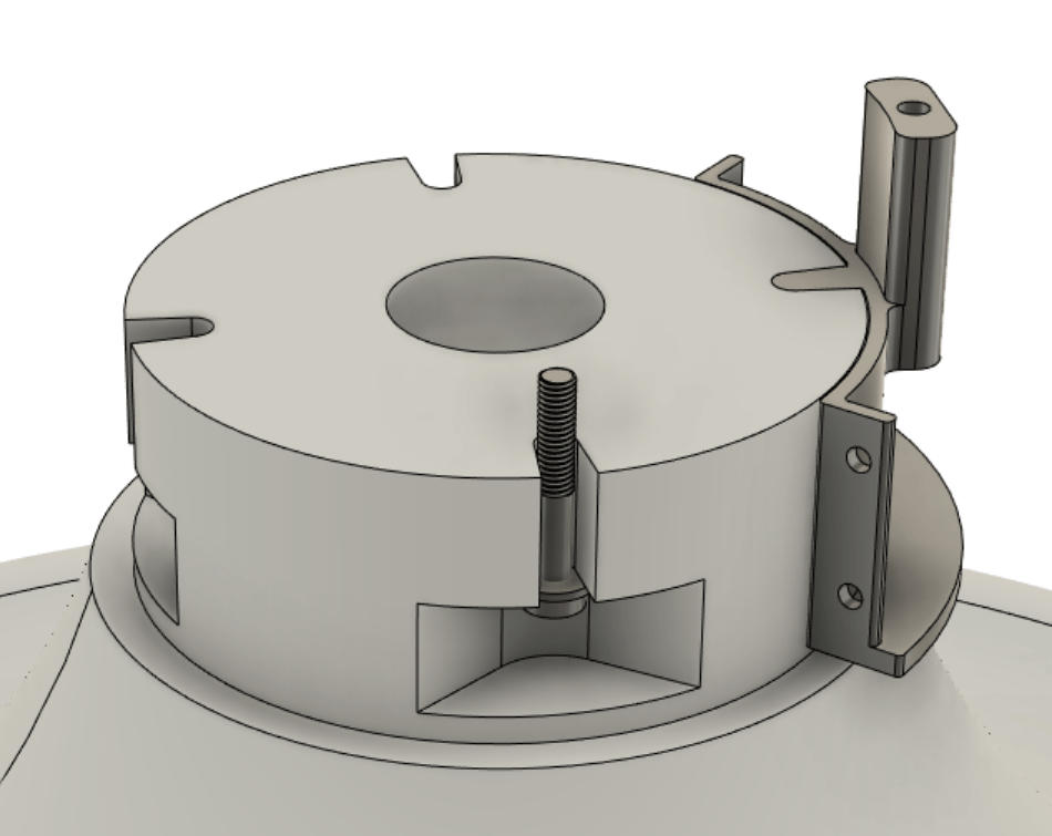

As one who has study resonant structure quite a bit, I'd find a way to brace the grey part into the waveguide. Cantilevering a heavy driver on a small ring is not such a great mounting.Not sure if it's clear from the pictures but this is the idea:
View attachment 1179108 View attachment 1179109
No additional mounting plates for the drivers should be necessary, only bolts.
The above shape:

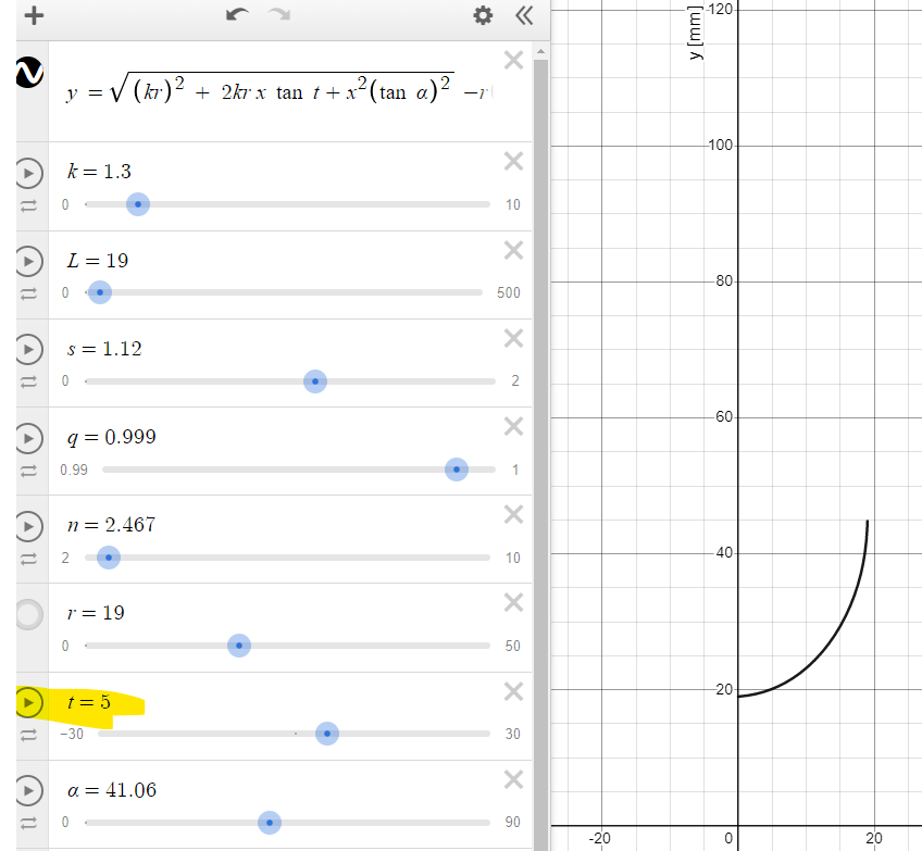

Code:OSSE = { ; #33/T34A-ROSSE r0 = 19 a0 = 41.06 a = 71.25 k = 1.3 L = 19 s = 1.12 n = 2.467 q = 0.999 }
Hi @mabat I'm trying to follow along with how each factor impacts the shape of the waveguide.
In an attempt to do, I'm using the inputs above and modeling them using the OSSE calculator you linked on your website.
I've attempted to populate what I can, but I know I'm obviously on the wrong path because there is no place for me to specify the "a=71.25" input and the "t=5" default input below doesn't tie to anything above.
Can you please help?
Use this one instead
https://www.desmos.com/calculator/3iswclzjzh
t is the same as a0, the opening angle of the throat which is or can be different from a which is the coverage angle (alpha symbol in desmos graph you linked).

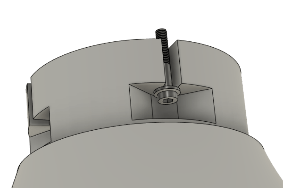

Earl, the grey structure is a part of the mold to make the bolt pockets as shown below. I really can't see how to make this better.As one who has study resonant structure quite a bit, I'd find a way to brace the grey part into the waveguide. Cantilevering a heavy driver on a small ring is not such a great mounting.

I won't cast the concrete but will work with a clay consistency instead, perhaps I wasn't clear on that:...and today working on the horn molds. I want to try concrete with these.
It's possible to make almost vertical walls that way even with a simple one-part mold.
