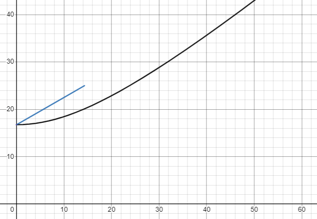

I ordered a pair (Radian 760NeoPB). These are strange drivers, hardly usable for anything else, IMHO, due to the extremely wide exit angle (60°). But when used directly from the phase plug with a more typical waveguide, they seem almost perfect. I say almost because the phase plug terminates at ~33mm (1.3") diameter. A little smaller would be even better.A nice candidate for a ring plug -

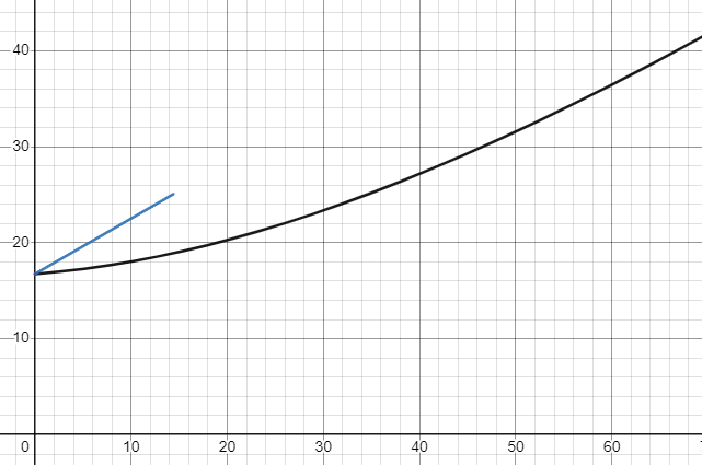

Yeah, I expect a plug version to be considerable smoother. Such a wide-angle exit section will form a concave contour with most of the available horns. That can't be a good thing.
This is what I'm going to use with the 760NeoPB. This time with a segmented/octagonal horn but that's still not fully implemented.
(The ring plug apparent on the left picture.)
Of course it could be made more flat. I'm still not convinced what's the better choice.

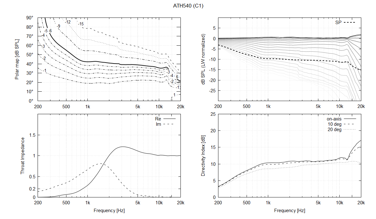

In this post I'd like to share some early results, comparing simulation to actual measurements.. I also have a question about an inconsistency in the ATH report.
After playing around with ATH a bit, I decided it was time to find out how well an ATH simulation holds up in practice. Although I've recently discovered that the R-OSSE functionality works really well, in the past - when I didn't have access to advanced simulation software like ATH - I always tried to break up the design process into the smallest possible steps. With fewer degrees of freedom, it's easier to narrow down cause-and-effect relationships. Therefore, the waveguide of the Dutch & Dutch 8c was first optimized in an infinite baffle, and only after that did I work on optimizing its interaction with the actual speaker baffle. I decided to take the same approach in validating ATH.
The waveguide we'll be looking at here, I designed about a month ago, presumably with ATH version 4.8.3 beta.
This is the ATH report I generated at the time:

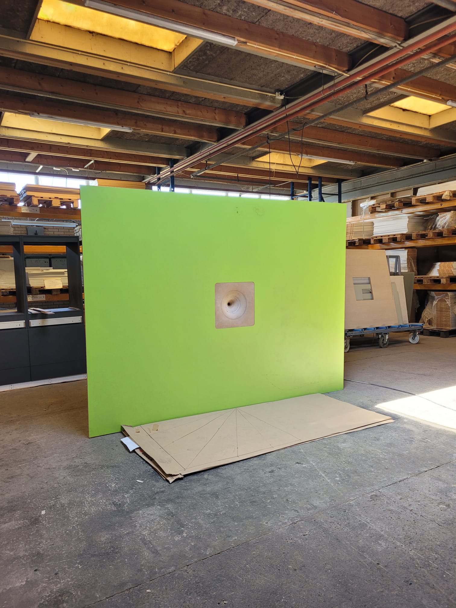

Yesterday I measured the WG in what is generally referred to as an infinite baffle. The mic distance was 1 meter.
These are the normalized results of the gated measurements, from 0 to 90 degrees in 15-degree steps. Please ignore the irregularity below about 2500 Hz in the 90 degrees measurement. It's caused by the relatively early and not perfectly gated-out reflection that results from diffraction at the closest edge of the not-quite-so-infinite baffle.
There are some small differences, but overall I'd say the measured response tracks the simulation very well. Great!

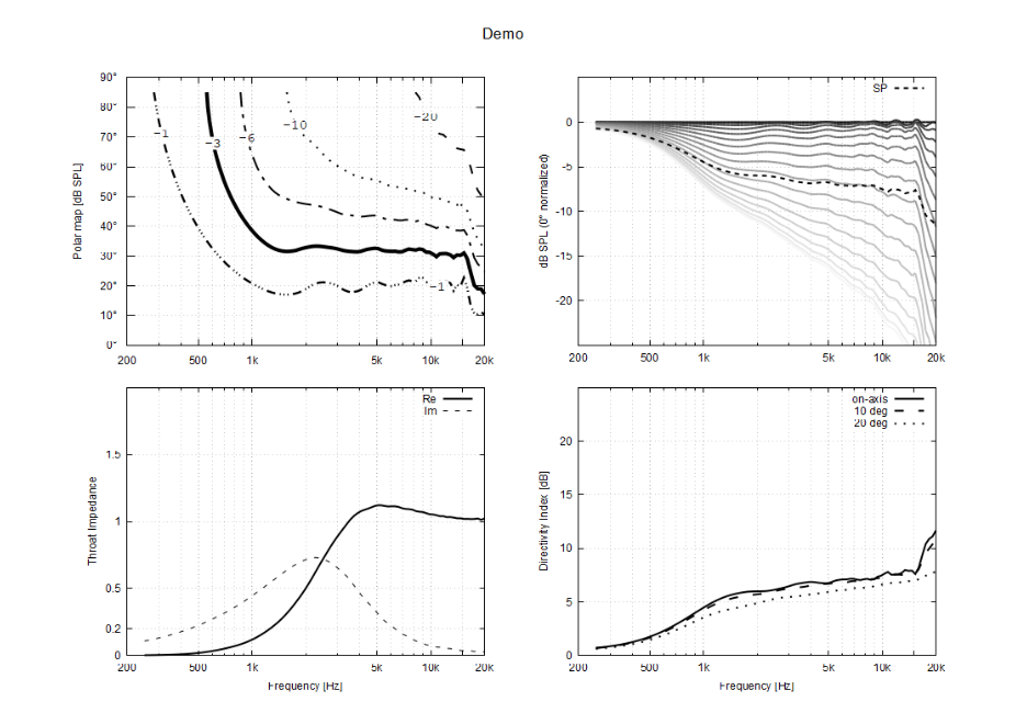

Now the funny thing. I simulated the same waveguide again with ATH 4.9.0 pre-230518, and now the report looks like this:
Everything seems to look the same, except for the directivity. It seems to be 3 dB higher across the board in the report I made today. I'm afraid I've overwritten the original config file I used to make the earlier report. Has the way directivity is calculated been changed, or did I change something in the config file?
This is the complete config file:

Thanks for sharing the data, the results look quite nice.
Yeah, we had a side discussion here recently about how is the DI defined for half-space conditions. Basically, a source radiating equally in all directions in a half space should have DI = 3 dB, according to the common definition (there's no right or wrong, it's just a matter of consensus). So I changed this in the latest versions and the DI curve is now shifted by 3 dB as a result (what was 0 dB is now 3 dB). Also, the values at high frequencies now agree to what you would get in a free field, which makes a better sense after all.

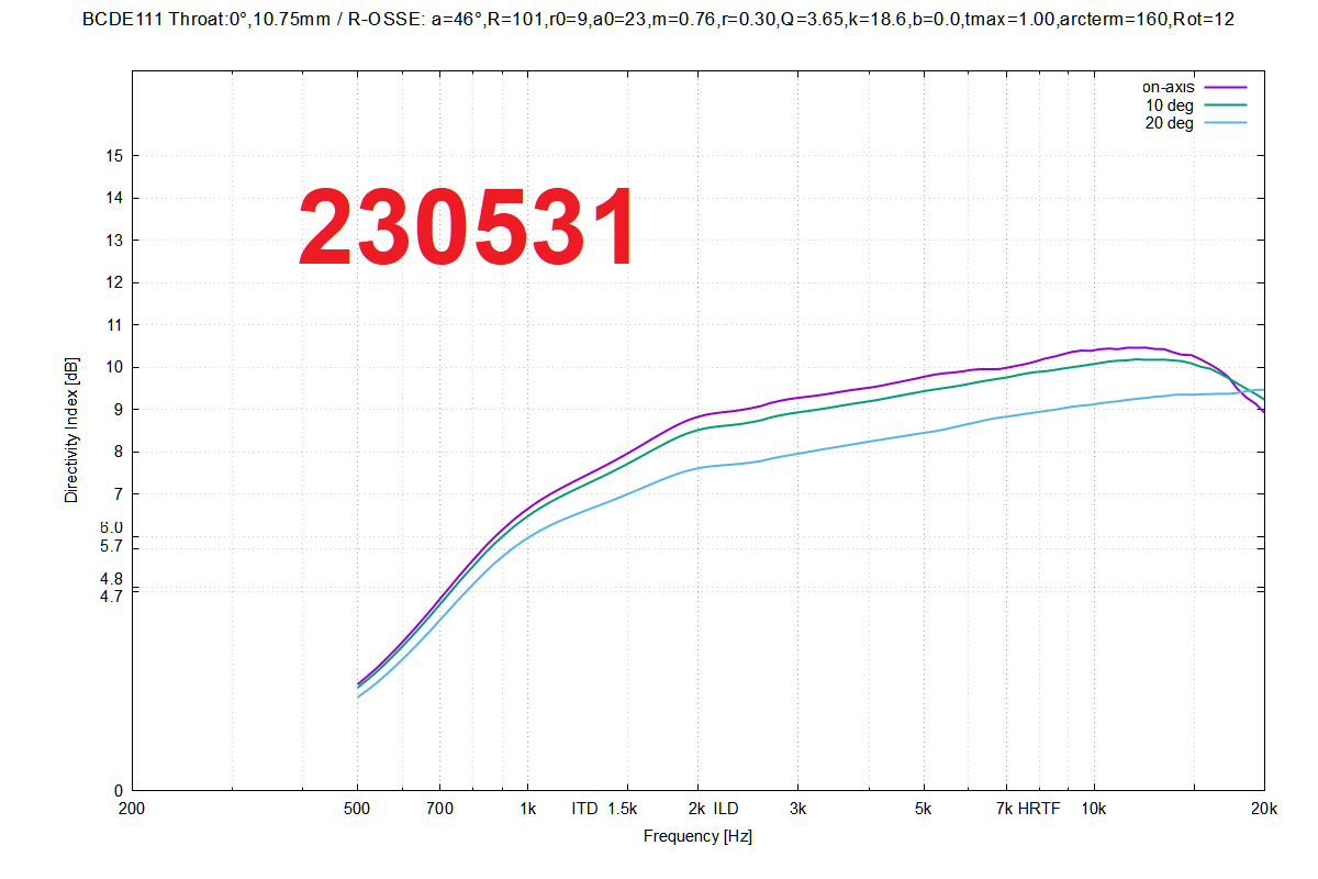

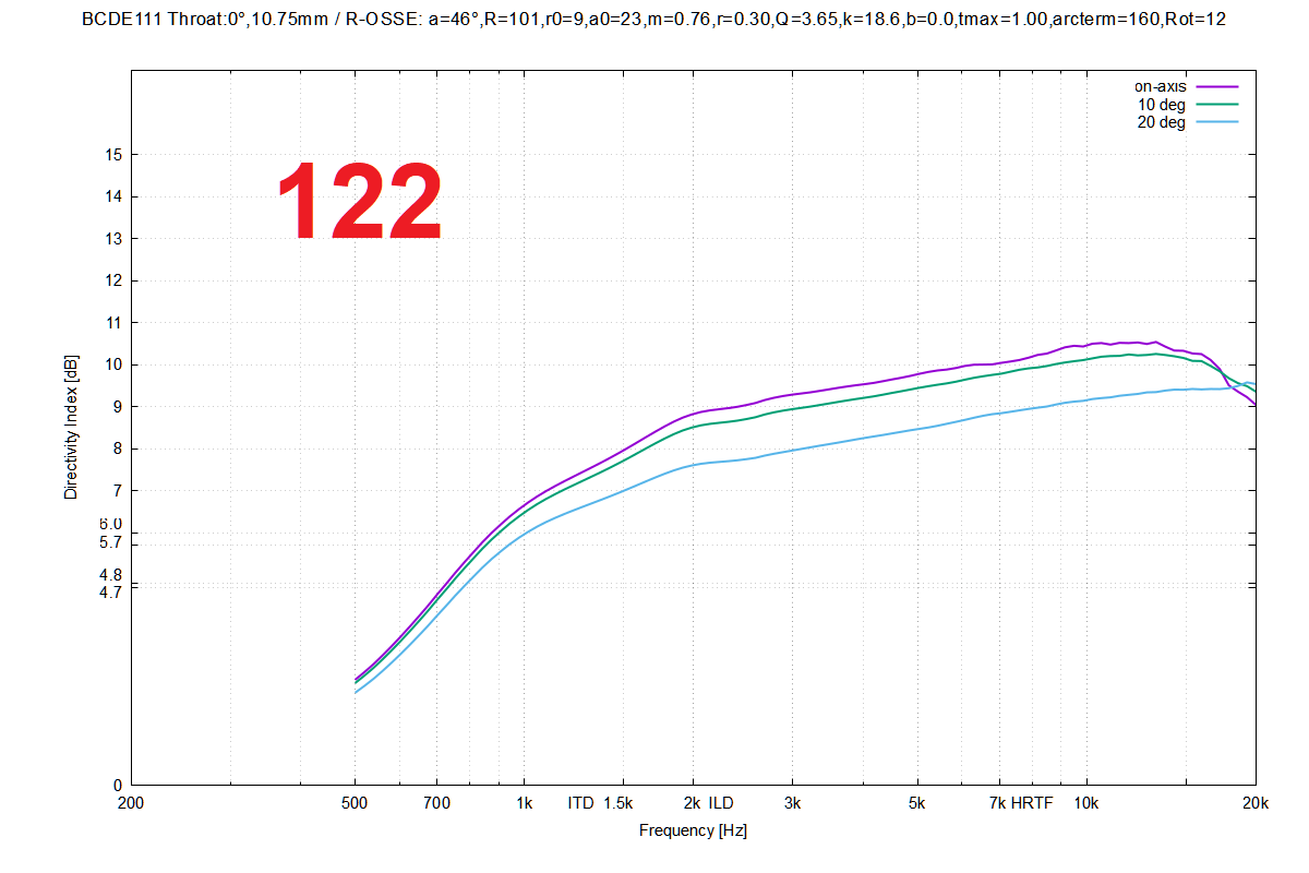

I generated two DI reports, one for ATH 490.122 and one for ATH 490.230531 in ABEC.SimType = 2 (free space) rather than 1 (infinite baffle). I see a small change in high frequency simulation as a result of the update.
Extremely small but since I generated the reports I thought I'd post them in case anyone else was curious about the update.
Also, the values at high frequencies now agree to what you would measure in a free field, which makes a better sense after all.
At some point I fixed a bug regarding the weighting of the last polar, maybe that's the difference.
Anyway, the more recent release, the better it should be 🙂
