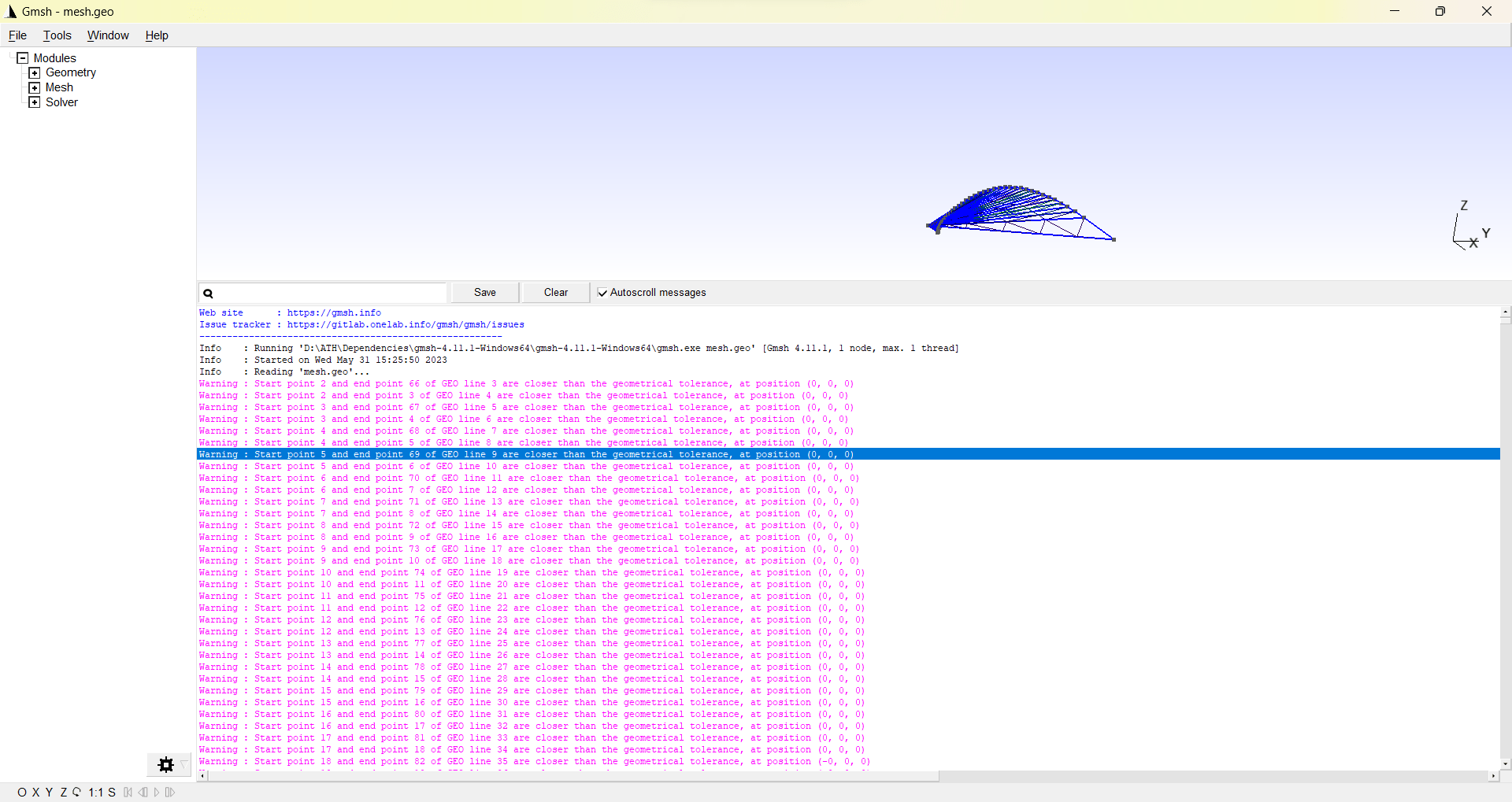

It seems as if CircSym (see 6.10 in the User Guide)is no longer supported in ATH 4.9 221115.
The ATH script gets stuck at the gmsh stage. There's a truckload of errors in gmsh, most of them of this type, with some more compex models I've had gmsh crash altogether:
When I put a semicolon in front of:
the script runs fine, but I'm back to long solving times in ABEC. Has the CircSym command been replaced by a new one?
Code:
ABEC.SimProfile = 0
Try the latest build, I remember I fixed some bugs: http://www.at-horns.eu/ext/ath-4.9.0-pre-230518.zip
CircSym is still the same. It's not possible to help without seeing the script...
I just tried it with 4.9.0 pre 230518, still the same result. Here's the script, it still runs without issue if I remove, or put a semicolon in front of "ABEC.SimProfile = 0".

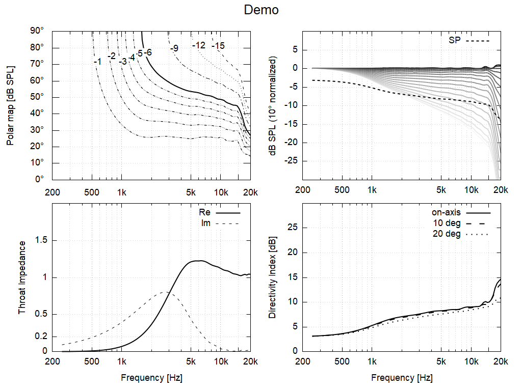

There must be some bug in the STL output. You don't need that...
I also recommend to delete/comment out the Offset in ABEC.Polars (zero will lead behind the baffle):

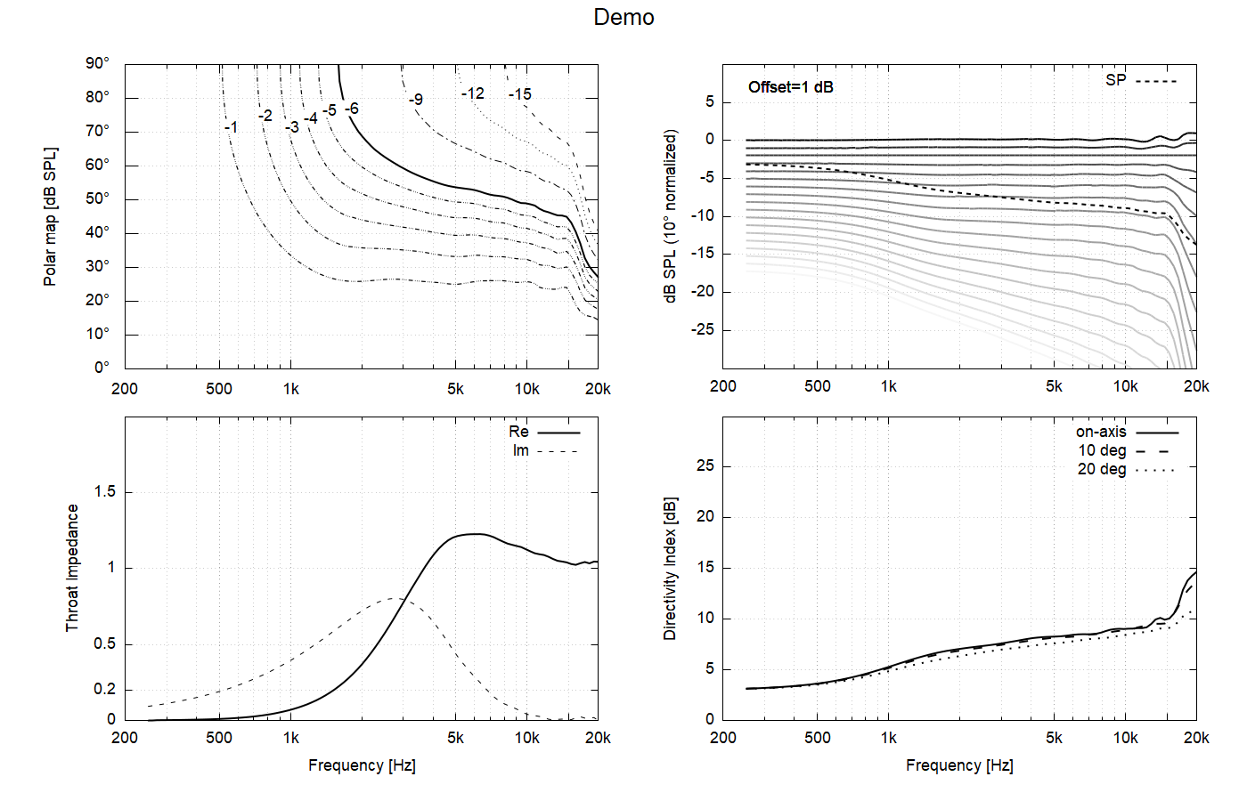

BTW, this is the result I get:

It's now possible to
1) Plot the FRs with increasing SPL offset to better visualize the individual polars
2) Use NormAngle = 1000 to normalize to a listening window average (<=20 deg off-axis)

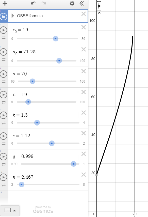

Sorry - quick related question. When I specify the script below in ATH input, I get a waveguide generated with an overall diameter of 186.49mm.
Output:
However, when I specify the same input in the desmos calculator linked above, I get an overall radius of 91.838 (or diameter of, 183.676):
Now, the delta between the ATH output of 186mm vs Desmos ouput of roughly 183mm is awfully small (spliting hair almost) - but just to confirm I'm not doing anything wrong - should they be exact?

That would be an awfully large delta if everything else was the same 🙂Now, the delta between the ATH output of 186mm vs Desmos ouput of roughly 183mm is awfully small (spliting hair almost)
The results should be the same to many decimal places...
Speaking of this, I should probably implement a diameter rounding to the nearest mm, e.g. by an automatic adjustment of q.

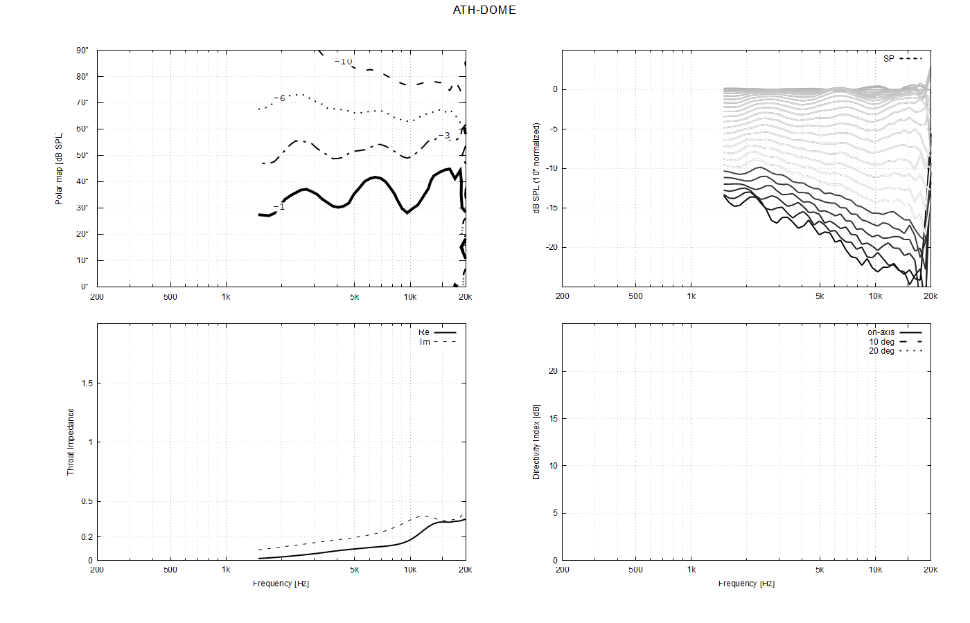

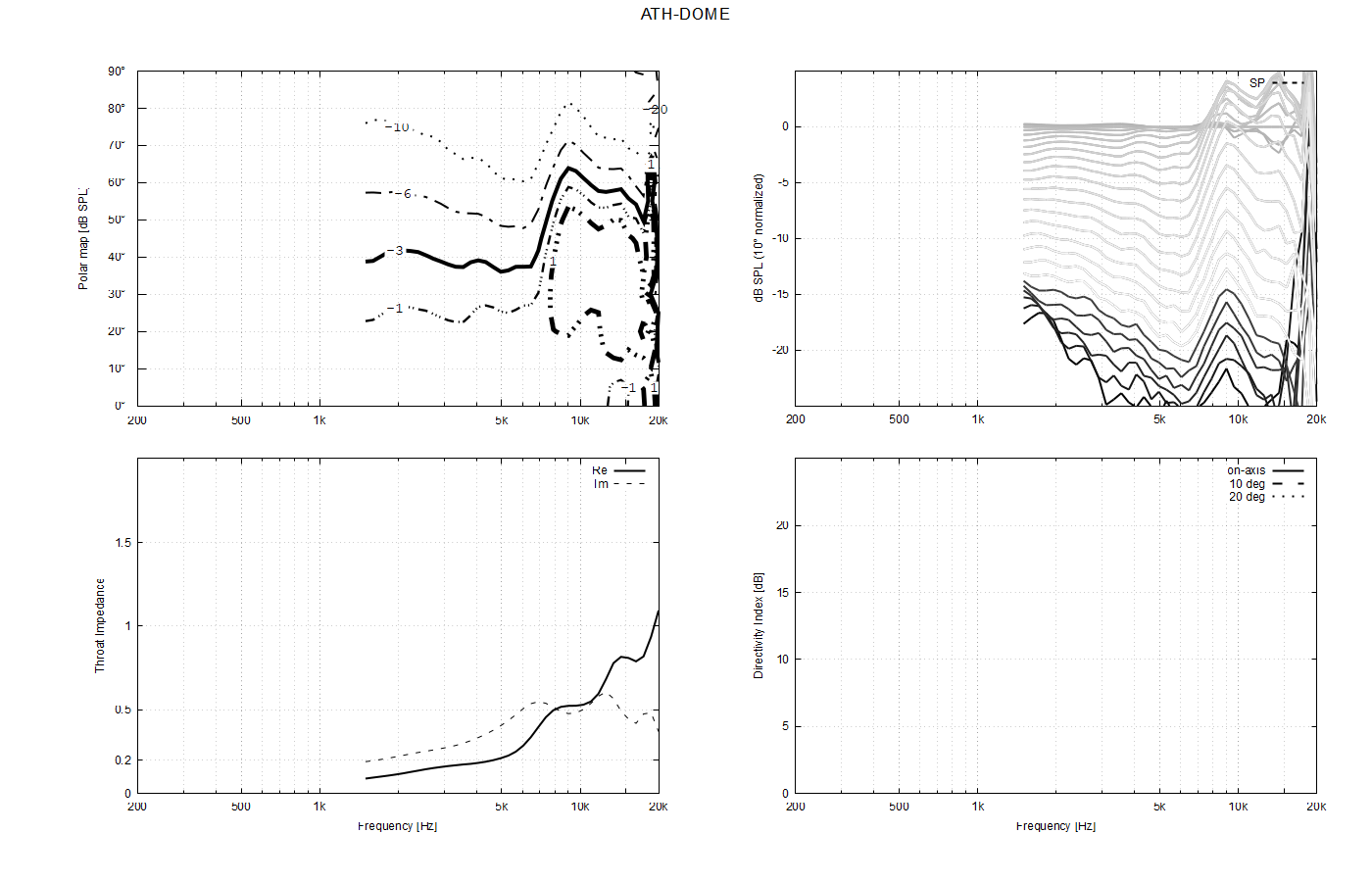

First as I tried in AKABAK, I need to set up somethings more, but in ABEC it was really smooth workflow. Even now I could find nice graphs I'd seen in this thread. However, I got some error that DI doesn't appear. I just used ATH-DOME-Template cfg by Fluid and Just F5, ctrl+F7 in ABEC3, cfg -r in ATH.
How could I solve this?
For these graphs to work properly I think it's necessary to have the polars 0-180/5 like this:
ABEC.Polars:SPL = {
MapAngleRange = 0,180,37
(With the ATH-DOME template I switched to -120->120 temporarily, but that was only because Purifi presented the data in that format. I also presented the data directly from VACS for that purpose...)
ABEC.Polars:SPL = {

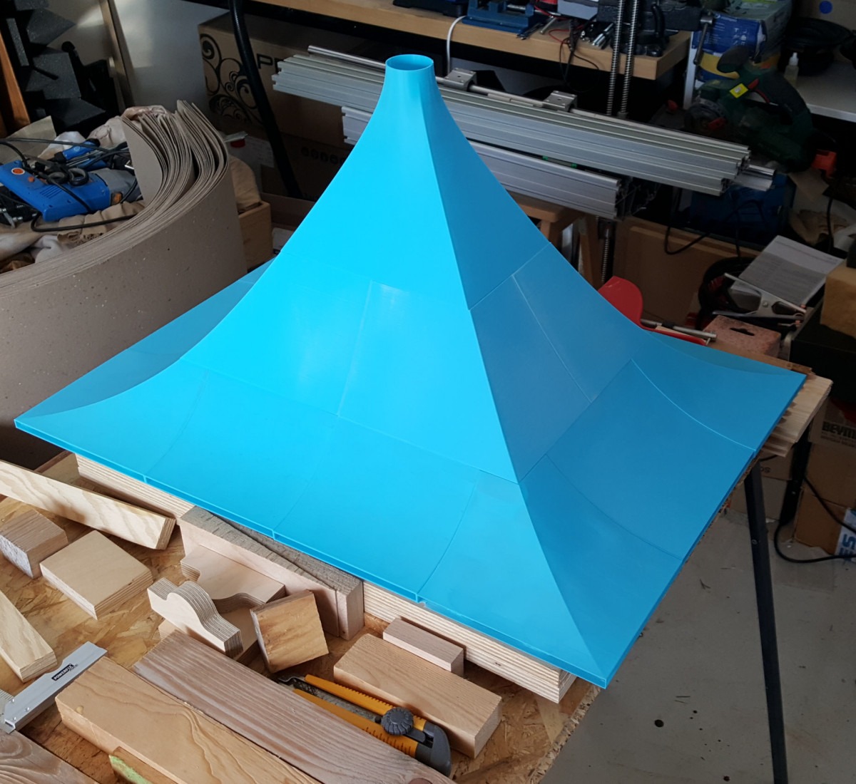

Phew! Printed.
640 x 476 x 340 mm (WxHxD)
This is the basic idea. We'll see how it goes -
Howcome you have opted for a 90° termination, I'm assuming it's just a size constraint?
So freakin cool!
