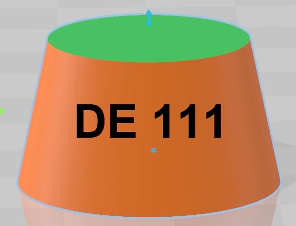

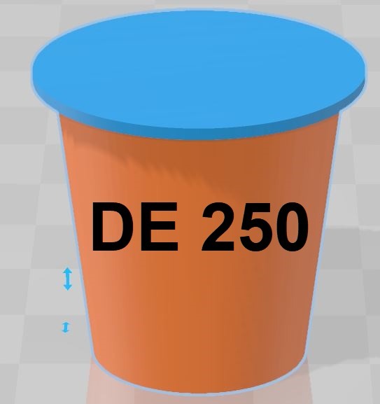

3D printed Internal Ring size dimensions that will fit into a B&C DE111 and DE250. This is not the exact shape of the conical exits, just a 3D print that fits snugly. Consequently, you will be able to safely fit your waveguide/internal ring design within these dimensions.
DE250: cone 24.5mm outside diameter, 102.08mm overall height (6.843° half angle). Cut to 25mm overall height. In addition, add a 28mm diameter 1mm tall spacer between the end of the plastic conical section and the flat surface of the compression driver. 25mm +1mm = 26mm overall height of cone and spacer. The DE250 uses a plastic conical section with three small internal ribs spaced about 8mm apart that rise ~0.25mm from the surface. That's why the cone O.D. is reduced from 25mm to 24.5mm. Also, you might be able to bore out the plastic conical section. The top part of the metal bore is 28mm diameter but I don't know if that diameter extends all the way to the phase plug.
DE111: cone 25mm outside diameter, 58.8mm overall height (12.002° half angle). Cut to 14mm overall height.

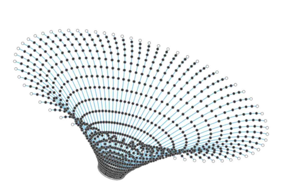

I've gotten at far as being able to create a full solid body for an axisymmetric horn using the "AthProfileImport" script and using Fusion's revolve function. This was well documented in @mabat 's following post: https://www.diyaudio.com/community/...-design-the-easy-way-ath4.338806/post-6499437 . This literally takes 1min to perform and works flawlessly.

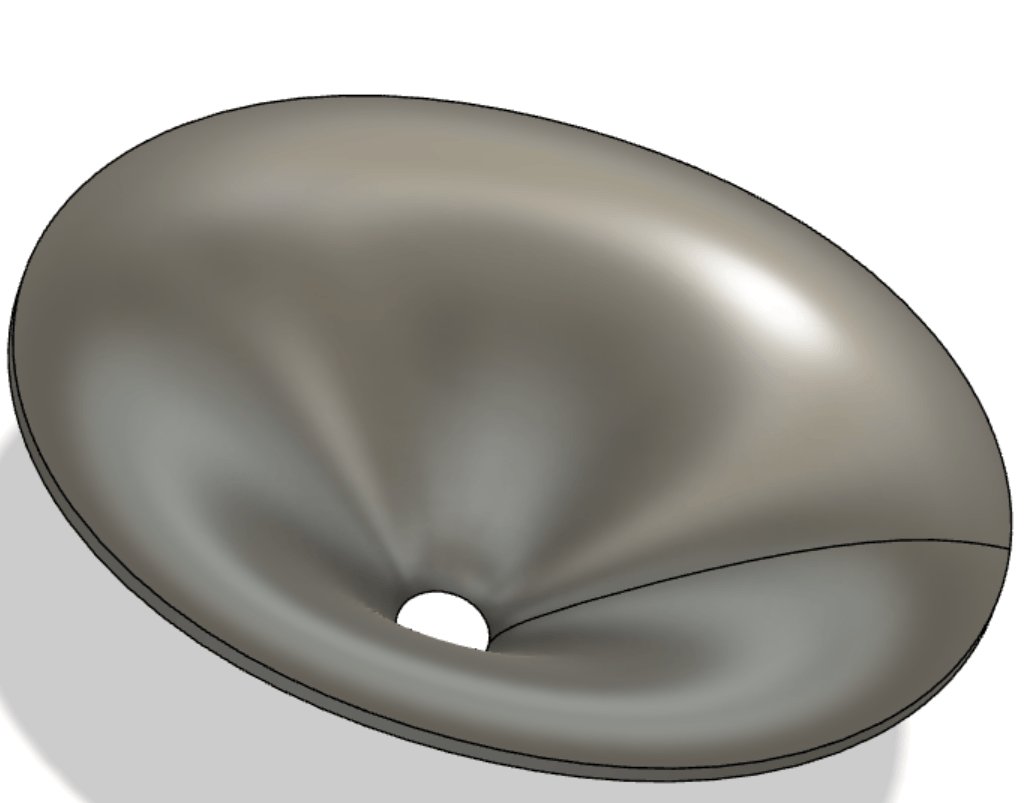

However - I'm totally lost on how to connect the "curves" or "surfaces" when importing non-axisymmetric horn ("demo2"), like the one below. I can't seem to "revolve" any of the profiles - and I know that not even the right approach here given its a non-axisymmetic design. I know this a Fusion360 question (and not an ATH questions) - but I would very much apprecaite if someone and explain how to convert the below to a solid object. Thanks,

You need to loft those curves to form a surface there is the Ath surface plugin for that
https://www.diyaudio.com/community/...-design-the-easy-way-ath4.338806/post-7318547
To turn the surface into a solid can be done with the thicken command which may not work very well or you can patch the top and bottom throat and mouth and stitch all the surfaces together to make a solid “plug” which you can then use to cut the waveguide shape out of a solid block.
You can also create your own profile for the rear section and stitch that to the waveguide surface to make a solid.

With the non-axisymmetric shapes you're entering the "power-user" area of Fusion where I can't help anymore, as I still continue with a trial & error approach myself...
(I would recommend to use the latest Ath release/build available on my website. Some bugs should be fixed.)

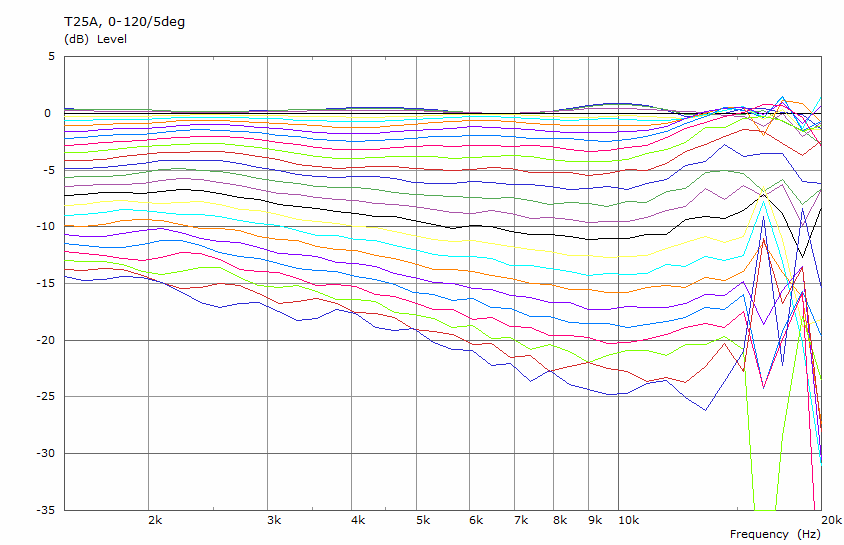

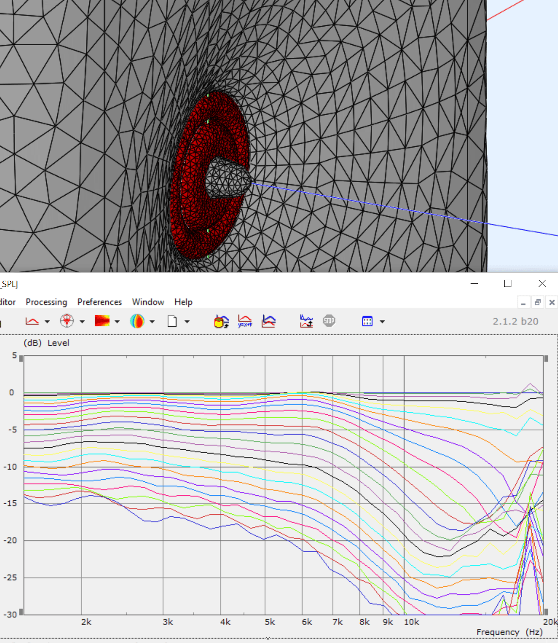

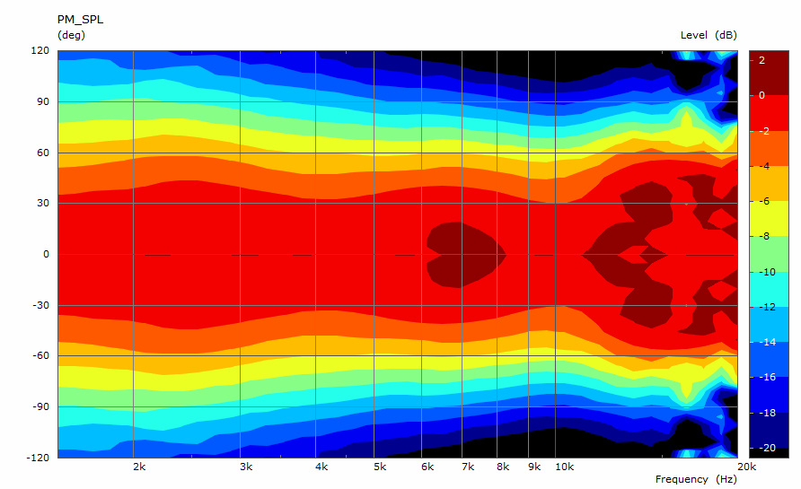

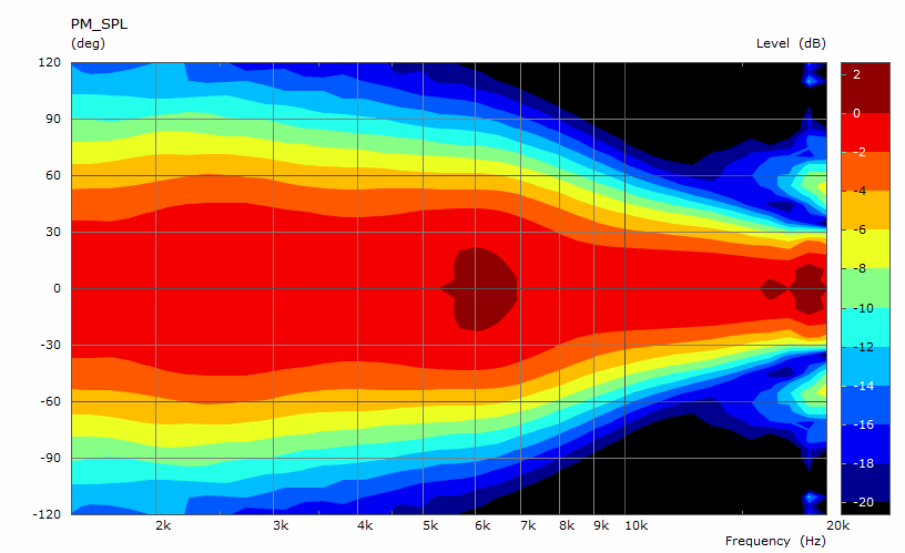

The ATH-DOME shape turns out to be pretty good. I tried to optimize it further but to no avail. Regarding DI, it's an ideal match to a cardioid-like midwoofer, which I think is something worth exploring, offering (an actual) constant directivity 200 - 20k even in a very small package. Above 10 kHz it depends on an actual source/tweeter but some preliminary simulations suggest it is nothing dramatic. To have some more tweeter models (even as the geometry only) would be nice.
Thank you mabat and others for all the hard work. I can provide a basic model of the XT25SC-40-04 ring radiator tweeter. It may match other models of XT25 as well. It sure beams, but it is very affordable and I hope the radiating surface doesn't change by frequency as much as it does for soft dome tweeters.

You can download the latest build from my website (ath-4.9.0-pre-230518.zip).
Below is a template project, including the above three tweeter definitions.
There's a new macro for a dome tweeter geometry (see the examples below, all dimensions in [mm]):
dome <edge_point_id> <VC_diameter> <dome_depth> <surround_width> <surround_depth> <dome_mesh_size> <surround_mesh_size>
