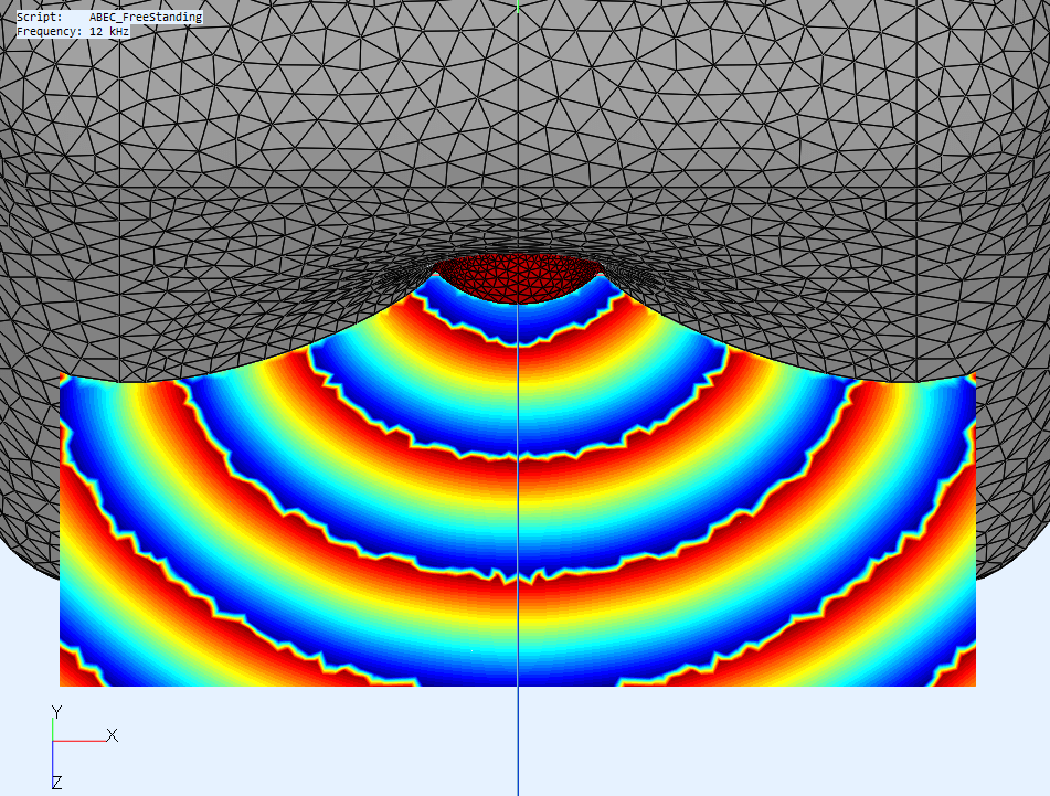

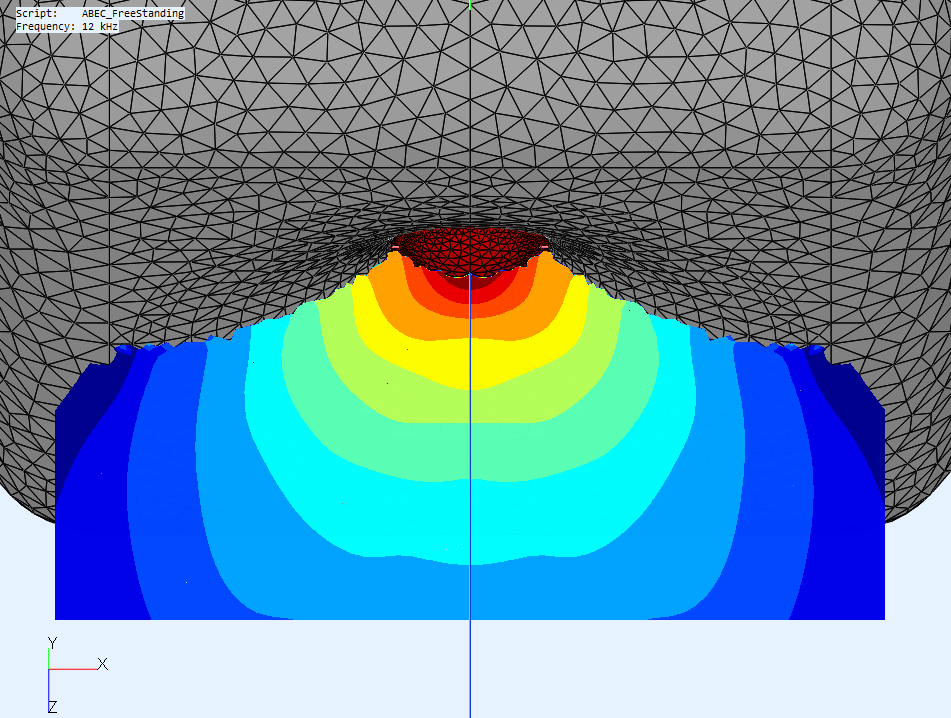

The exact mechanism of the waveguide widening above 10 kHz is still not completely clear to me, apart from a very vague intuitive understanding.
But it must be a coincidence (a local optimum), as the beamwidth does not increase further with the further widening of the waveguide.
mabat is spot on with his explanation, if the field meshes cross the surface boundaries it creates solving problems.
DonVK is quite conscientious with this (much more than I can be bothered with) an example of a mesh without tearing that I have to hand.

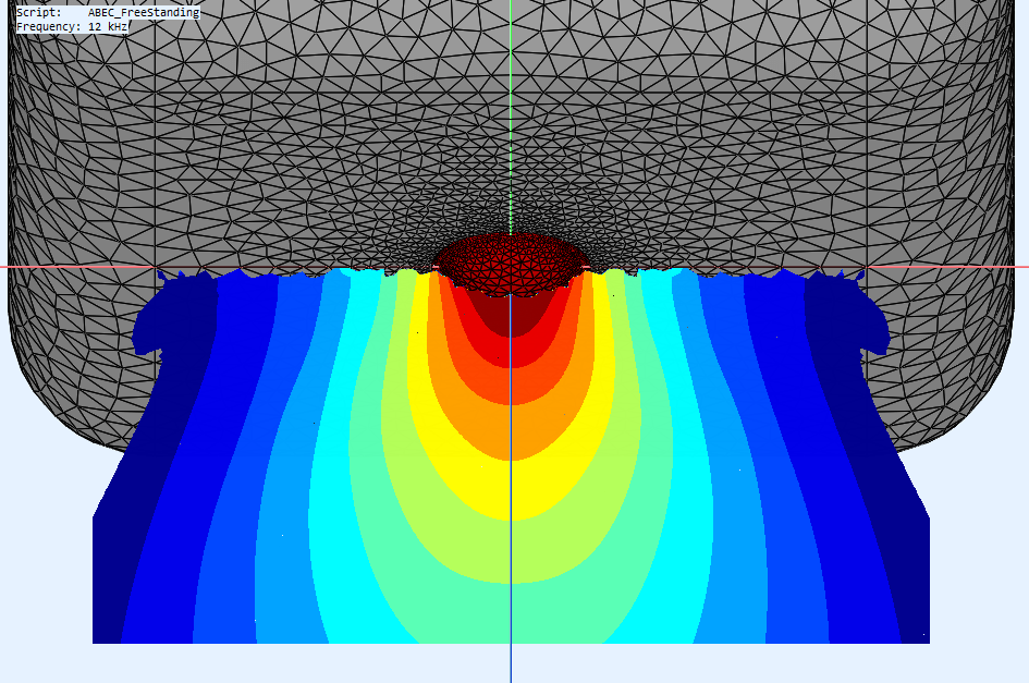

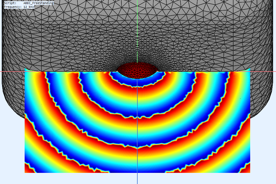

Closer to the source in more detail -
It is my understanding that the waveguide simply helps to build up the pressure towards the sides of the diaphragm, which alone is not capable of, due to its axial motion. With a waveguide there's less volume for the available velocity.
- But then I don't understand how exactly the on-axis pressure drops. So,... (maybe the diffractions off the WG walls reduce the axial pressure?)
The fact is that the waveguide widens the polar pattern considerably, compared to a flat baffle. But how exactly it does that, remains a mystery to me.
I would accept that "it's all diffraction" but then that's still very abstract.
We could assume its interference. On flat baffle, the on-axis is the only observation axis where sound from all points on the dome are relatively equidistant compared to wavelength, so sound from any point of the dome is relatively in phase. This makes relatively high pressure on-axis compared to off-axis where path lengths from various points of the dome spread out (compared to wavelnegth) and pressure averages out, beaming.
Since the dome on both your sims is the same, there must be something else to it, some other sound source that affects the interference.
Now lets choose one point on the dome and imagine how sound emanating from there would travel. Lets take for example sound form tip of the dome. Sound propagates to all directions, so sound from tip of the dome goes towards the baffle as well. Sound that propagates toward the baffle would reflect from it. When baffle is flat it would be a specular reflection with very high incident angle ( as dome doesn't protrude that much from the baffle ) and basically the sound just continues escaping the system somewhere close to 90deg off-axis angle.
Now when you start to fold in the baffle (waveguide) the reflection incident angle drops. When you have suitable angle / curvature to the profile this sound that would have escaped the system is now reflected back towards the listening window. Now it interferes with direct sound on-axis, perhaps out of phase reducing pressure while at some other angle its boosting some. This is our secondary sound source.
I think this is visible in the observation field of the waveguide sim, if you look exactly on-axis each color is either shrunk or bulged a bit, which to me looks like path length difference varying with angle.
Of course the waveguide is 3D, sound from any point of the dome would propagate to all directions, reflect to various angles with various path length differences and and the observation field is just 2D so its quite hard to actually imagine the whole system. But I think the basic thing is roughly that the high frequency sound is now reflected back toward the listening window instead of letting it escape toward 90deg off-axis with flat baffle, which makes interference.
Yeah sound is quite simple, it just propagates to all directions, reflects, diffracts and refracts. But, as the objects are 3D it gets quite complicated fast. This kind of simplifications to two dimensions are nice thought experiments and kind of help to see some of it, how it likely plays out.
