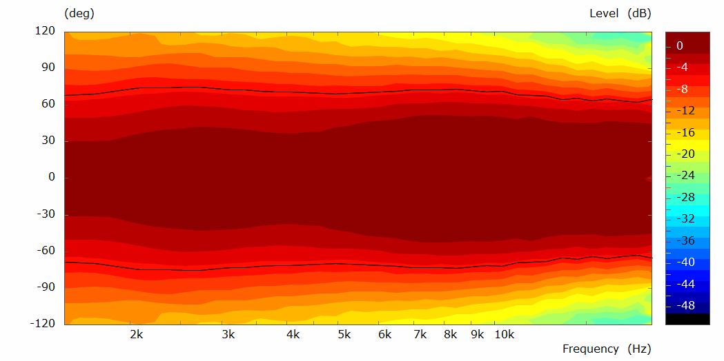

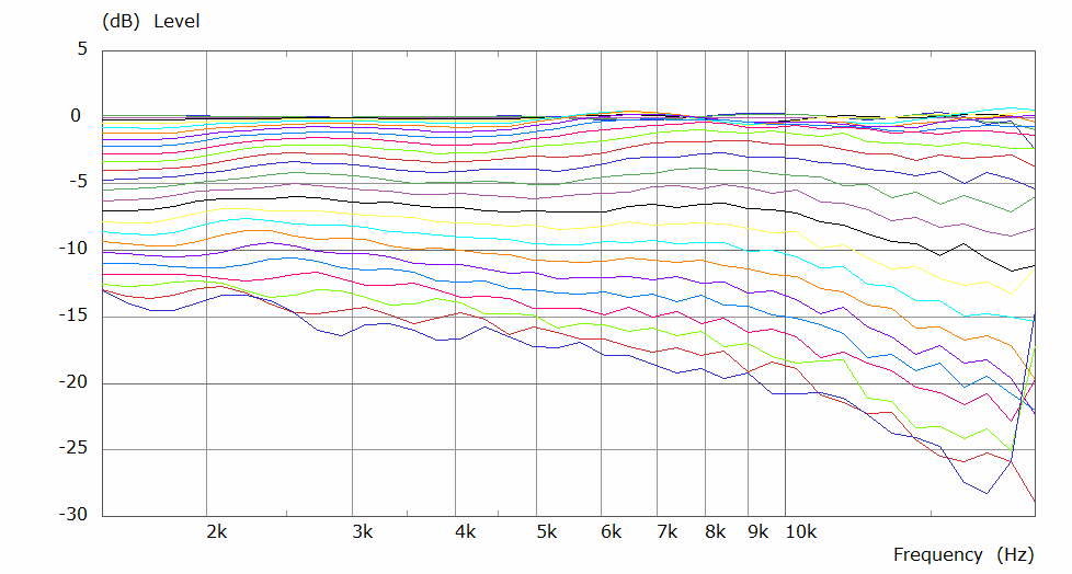

- I just wanted to see what beamwidth I'm able to get with an "ordinary" waveguide, as the Purify Audio guys showed +-70deg up to 20kHz recently, which is really not common...

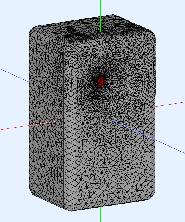

Any idea what I may be doing wrong? I'm using the latest build for ATH. I'm literally running the exact code included in the following post: 9,879
However, for me, the LF driver is not showing up in ABEC (See picture below) ? Is there something I need to enable to view in ABEC?
Apologies for the newbie questions I'll be (*have been) asking. I left this thread a while ago and its exploded since then (in a good way, of course). So many new features.
My near-term goal is to simulate a waveguide for the Peerless DA25TX with an 8" driver (like the Dayton Audio RS225-8).
The following is the code I'm starting with. Please note - there are many features I don't understand:
; ATH-DOME Template ; ------------------------------------------------------- ; Peerless DA25TX00-08 OSSE = { r0 = 16 a0 = 40 k = 0.7 a = 55 L = 26 s = 1.27 n = 2.15 q = 0.996 } Source.Contours = { dome WG0 26 5.6 3 1.5 4 1 } Source.Velocity = 2 ; axial motion Mesh.Enclosure = { Spacing = 90,70,90,350 Depth = 200 EdgeRadius = 35 ; 25 EdgeType = 1 FrontResolution = 8,8,16,16 BackResolution = 20,20,20,20 LFSource.Below = { Spacing = 10 Radius = 82 DrivingWeight = 1 SID = 1 } } Mesh.VerticalOffset = 80 Mesh.Quadrants = 14 ; =14 for 1/2 symmetry Mesh.LengthSegments = 24 Mesh.AngularSegments = 64 Mesh.ThroatResolution = 3 Mesh.MouthResolution = 9 Mesh.SubdomainSlices = Mesh.ZMapPoints = 0.3,0.2,0.7,0.9 ;Mesh.InterfaceResolution = 6 ;Mesh.RearResolution = 20 ; ------------------------------------------------------- ABEC.SimType = 2 ABEC.MeshFrequency = 1000 ; [Hz] ABEC.NumFrequencies = 40 ABEC.f1 = 1500 ; [Hz] ABEC.f2 = 20000 ; [Hz] ABEC.Polars:SPL = { MapAngleRange = 0,90,10 Distance = 2 ; [m] NormAngle = 0 } ; ------------------------------------------------------- Report = { Title = "ATH-DOME" NormAngle = 10 Width = 1400 Height = 900 } Output.STL = 0 Output.ABECProject = 1 |
Change "Below" to "B". That's my bad, I don't know why I changed that.
