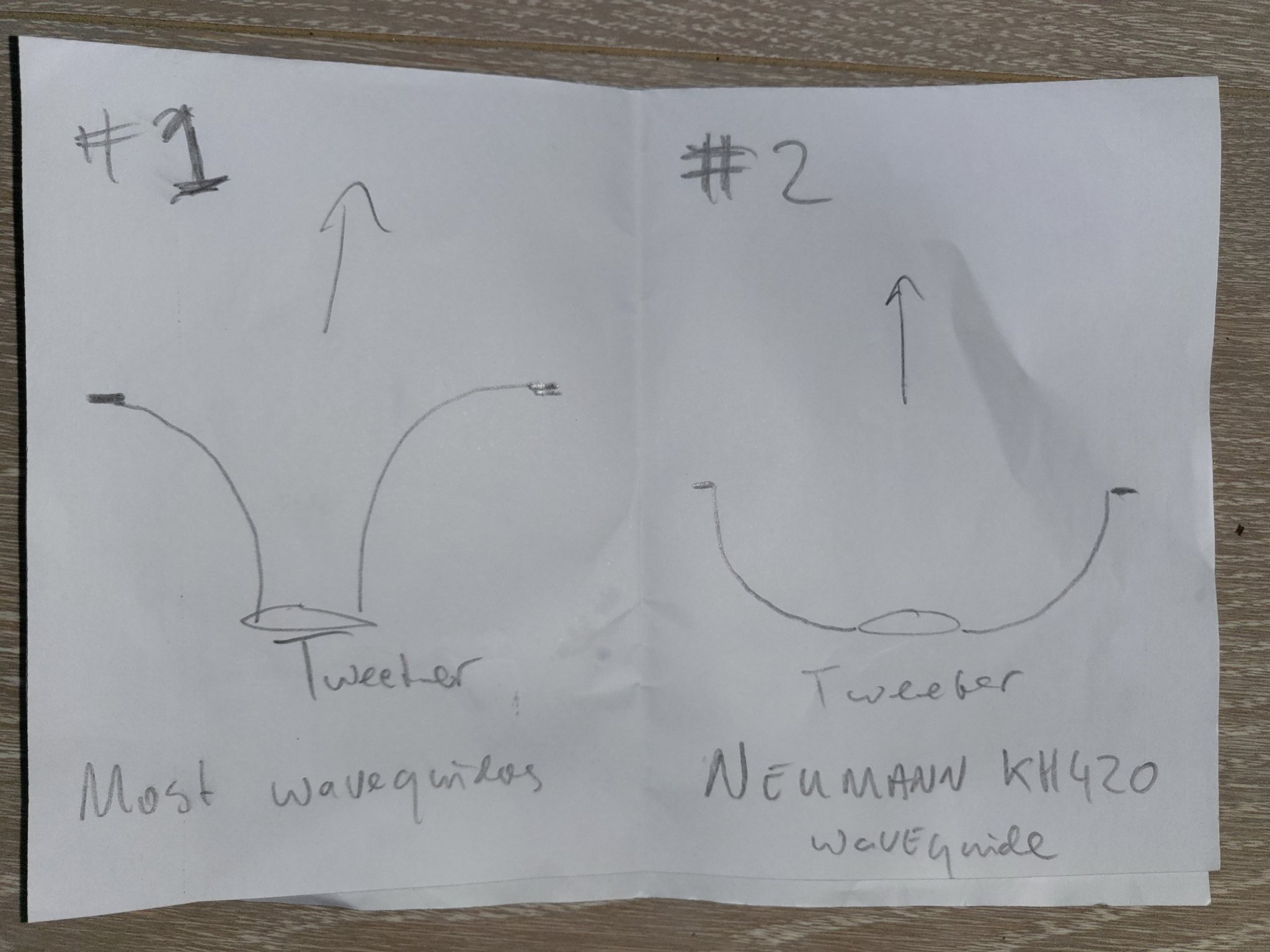

Waveguides in attached pic (well regarded and very well measured pro monitor Neumann KH420) are convex, right?
It might be concave in the end (only small portion of the waveguide, like you say to give a gradual termination in air), but it starts convex.
Has it been established how this kind of waveguide (convex) influences response and directivity VS a purely concave waveguide? (all other things being equal).
Yes, it is convex, all the way through. Seems to me as flat for the most part, with some simple mouth edge rounding.
But as was said, there are no "purely concave" waveguides, so I don't understand the question.

Thank you for trying to answer my question. It is clear I should get more educated and find a better way to ask.
From my drawing, #1 seems to be how most waveguides and tweeter horns are shaped (narrow start, widening towards the exit). Which I thought was called concave.
Drawing #2 seems to be the exception, a wide start with a narrowing angle towards the exit (which I thought was called convex). At least one reputable loudspeaker manufacturer seems to adopt this shape (Pic in my last post).
Because shape #1 and #2 are very different, I was wondering how their acoustical effects relate to each other. Because these effects are not always intuitive for laymen, I thought I should ask here. If I were to design my own loudspeaker, I wonder for which requirements I should use one shape over the other. With my current knowledge, that is the best way I can ask.

You seem to be under the impression that the Neumann waveguides are shaped like your #2 drawing - they aren't.Drawing #2 seems to be the exception, a wide start with a narrowing angle towards the exit (which I thought was called convex). At least one reputable loudspeaker manufacturer seems to adopt this shape (Pic in my last post).
Neumann has a downloadable 3D model of the KH80 on their site, for example. Opening that will reveal a waveguide that is almost conical (very slight flare) until the mouth roundover. The fact that they look the way you explain is a trick of the eye, not reality. I agree that it sort of looks that way though.

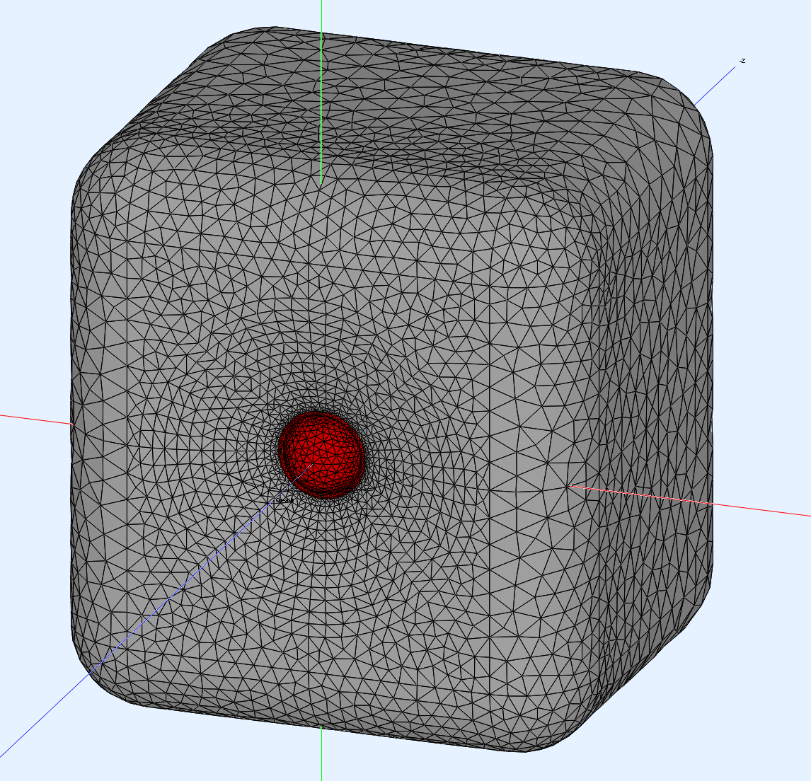

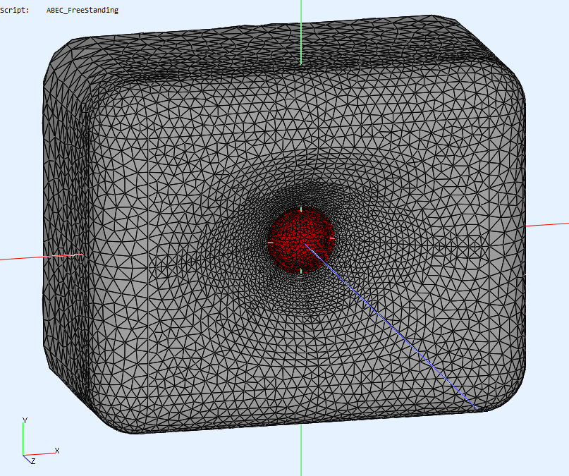

These are fantastic results Fluid! May i ask what the boundary conditions are here? Quarter or half symmetry in a box, perhaps an axisymmetrical freestanding waveguide?I have found something I quite like for the T34A, it is harder to get right than the B version. The simulation conditions seem to matter much more than I found previously.
I am asking because I've been going on and off for the past 2 years or so trying to make a waveguide for the Peerless DA32TX, but I can't seem to make it behave. My personal best guess is that the combination of a relatively large surround and tall dome is creating difficulties. I actually ended up scrapping the idea of using the DA32TX altogether and went for a T25B, which was much simpler to design for. I still have the DA32TX laying around, so I occasionally dabble in trying to make it work, without any luck.
Quarter symmetry free space.
Tall domes are tricky, I had a lot of trouble trying to find a good profile and had settled on a very shallow one. Turns out it needs to be very wide to work, which is not the direction I was trying.
